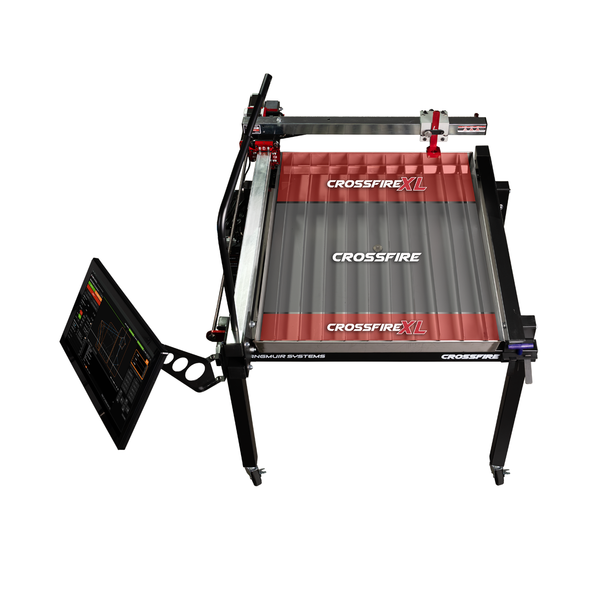

Go bigger from day one. The CrossFire XL Package takes everything in the CrossFire Basic Package and adds the XL Expansion Kit, giving you 44% more cutting area right out of the box. You get the CrossFire CNC Plasma Table extended to a 25.3" x 33.3" work envelope, plus a powered Z-axis with Automatic Torch Height Control, a 21.5" touchscreen control PC, X/Y limit switches for machine homing, and a stainless steel water table. Save versus buying each item separately and start cutting larger parts and longer sheets without a second upgrade later.
Bundle and Save: Purchased separately, these components total $3,689.90. Get them together in the CrossFire XL Package for $2,595.00 and save $1,094.90.

XL Expansion Kit: Adds 10" of travel to the Y axis for a total work area of 25.3" x 33.3", a 44% increase over the standard CrossFire. The kit is a direct bolt-on replacement for the standard tube rails and includes a powder-coated XL lower rail, a zinc-plated XL upper rail, and an XL lead screw. It installs with the same tools and in the same manner as the standard CrossFire assembly, and it fully utilizes the work area of the included water table, so nothing in this package goes unused.
