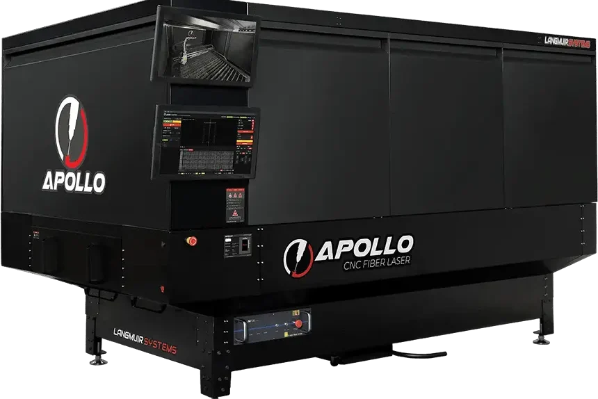

Imagine the possibilities with the Apollo CNC Fiber Laser

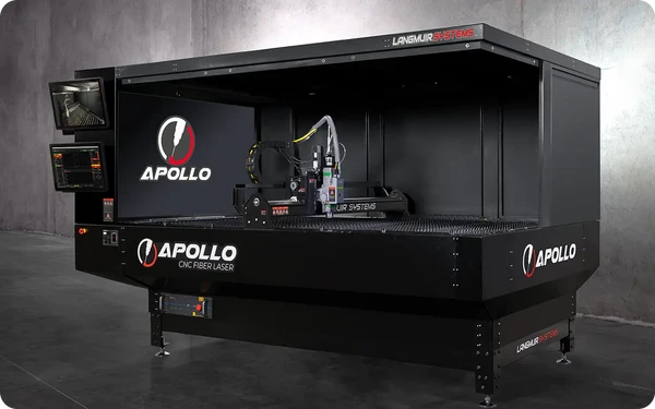

The Apollo CNC Fiber Laser is a fully enclosed 1.5kW 4' x 8' industrial-grade system that delivers exceptional speed, precision, and cut quality, all at an unbelievable value. Proudly engineered and assembled in Texas and backed by our dedicated in-house Technical Support Team, the Apollo makes it easier than ever to bring high-performance laser cutting to your shop.
Included:
What to Expect →
Apollo CNC Fiber Laser with Enclosure Complete CNC Fiber Laser
$19,995
1500W Fiber Laser Source by Max Photonics Industrial grade performance and durability
Manual Focus Laser Head Swiss engineered, by RayTools
MiniPC with HD Touchscreen Windows 11 Computer, 21.5" HD Touchscreen, and Wireless Control Pendant.
Water Chiller (non-Pro version) designed for 1500W of continuous Power

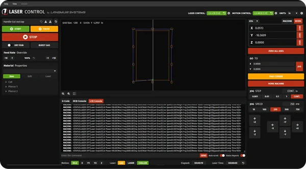

Software and Controls
  • LaserControl Software
  • 32-Bit integrated Electronics
  • Touchscreen and PC

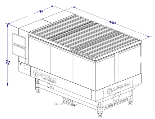

External Dimensions:
74" W x 77" H x 122" L
Travel Limits:
50" X, 98" Y, 4" Z

What software is used for the Apollo CNC Fiber Laser?
The Apollo CNC Fiber Laser uses our in-house engineered software, LaserControl.
LaserControl is brand consistent with our other software such as FireControl and CutControl ensuring familiarity for our users with this machine and our other products.

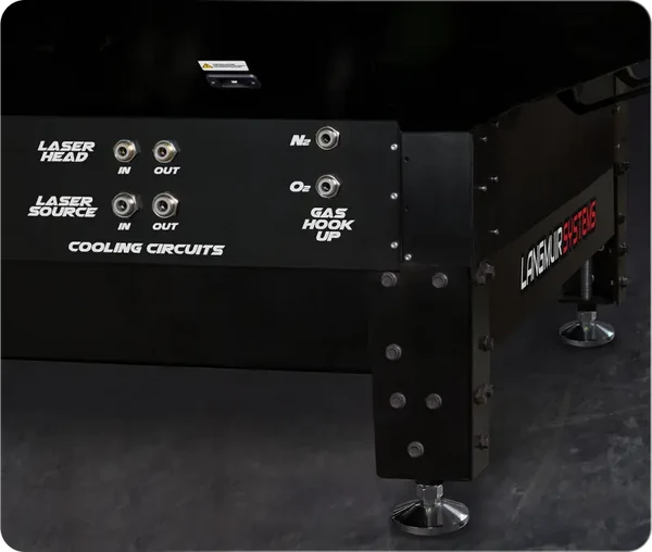

The Apollo CNC Fiber Laser comes with the laser source, a manual focus head (unless you have upgraded to the AutoFocus head), and a chiller. The unit also contains the hook-ups for O2 and N2 (or shop air) gas. We suggest you buy Connection Kit, which contains the N2 and O2 regulators, air lines, push-to-connect fittings, water lines, and more. The items included are as follows, if you wish to source your own components:
  1. 25 feet of 12mm OD x 8mm ID Firm Polyurethane Rubber Tubing, Clear. (Use McMaster PN 50315K73 for reference)
  2. 25 feet of 10mm OD x 6.5mm ID Firm Polyurethane Rubber Tubing, Clear. (Use McMaster PN 50315K72 for reference)
  3. 50 feet of 10mm OD x 8mm ID Hard Nylon Plastic Tubing, Semi-Clear White. (Use McMaster PN 50405K37 for reference)
  4. 1x Oxygen Regulator
  5. 1x Oxygen Flashback Arrestor
  6. 1x Fitting Adapter
  7. 2x Push to Connect Fittings for Air Lines
  8. 1x Nitrogen Regulator
  9. 2x Push to Connect Fittings for the Laser Source Cooling
  10. 2x Push to Connect Fittings for the Laser Head Cooling
