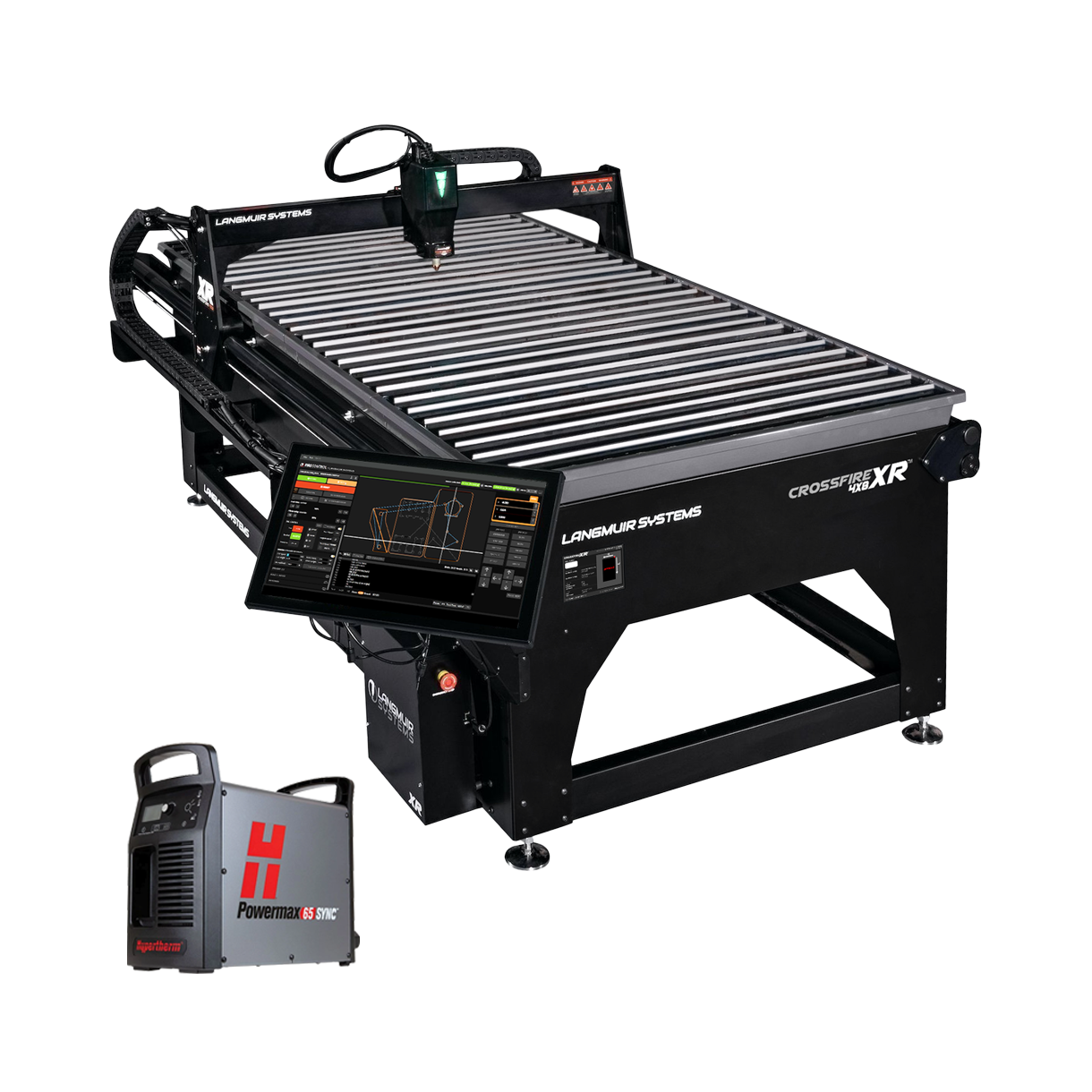

The most capable CNC plasma package Langmuir Systems offers. The CrossFire XR Hypertherm Powermax65 SYNC Package pairs the 4x8 CrossFire XR CNC Plasma Table with Hypertherm's next-generation 65-amp industrial plasma cutter, the plug-and-play Hypertherm CPC cable to integrate it, and the Remote Emergency Stop Kit. The XR already ships with a dedicated control PC, industrial touchscreen, wireless pendant, and LS-THC torch height control, so this package completes it with a production-grade cutter that handles up to 3/4" material with the consumable life, cut quality, and duty cycle that fabrication shops depend on. All at a lower price than buying the components separately. Add compressed air and a full sheet and you're cutting.
Bundle and Save: Purchased separately, these components total $11,464.90. Get them together in the CrossFire XR Hypertherm Powermax65 SYNC Package for $10,995.00 and save $469.90.
This Package Includes:
  • CrossFire XR CNC Plasma Table
  • Hypertherm Powermax65 SYNC with 25ft Mechanized Torch
  • Hypertherm CPC Cable (for CrossFire XR)
  • CrossFire XR Remote Emergency Stop Kit
CrossFire XR CNC Plasma Table: The foundation of the package. The CrossFire XR is a full 4x8 CNC plasma table that brings industrial-scale cutting to businesses and serious hobbyists at a fraction of the cost of traditional industrial machines. It ships complete with a dedicated control PC optimized for CNC operation, an industrial-grade touchscreen monitor for real-time control and monitoring at the machine, and a wireless control pendant that lets you jog and manage the machine from anywhere around the table. Langmuir Systems' LS-THC torch height control comes standard, actively maintaining torch height over wavy or warped sheet for consistent, precise cuts, and rapid speeds of up to 400 IPM keep production moving on large-format work.

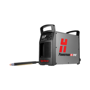

Hypertherm Powermax65 SYNC with 25ft Mechanized Torch: Hypertherm's next-generation air plasma system, engineered for advanced cutting and gouging on material up to 3/4" (20 mm). The Powermax65 SYNC features automated setup with RFID-enabled SmartSYNC technology that reads the installed cartridge and sets amperage and operating mode automatically, so there's no manual configuration between jobs. Its revolutionary single-piece cartridge consumable replaces five separate parts, installs in seconds, and tracks its own usage data for accurate life monitoring and simplified inventory management. The result is consistent, high-quality cuts with fewer interruptions, reduced downtime, and less rework, exactly what a 4x8 table running full sheets demands. Ships with a 25 ft mechanized torch ready for CNC mounting, and runs on Hypertherm SYNC cartridges available directly from Langmuir Systems.
Hypertherm CPC Cable for CrossFire XR: A 6 ft plug-and-play cable that connects the Powermax65 SYNC to the XR electronics. It plugs into the CPC port on the Hypertherm power supply and provides both the torch on/off signal and the arc voltage feed for the XR's LS-THC, with no splicing into trigger wires or raw voltage. Set the Powermax's voltage divider to 50:1 (the factory default) and it's ready to run.
CrossFire XR Remote Emergency Stop Kit: Relocates the XR's emergency stop from the electronics box to a mounting bracket directly above the touchscreen, putting it within immediate reach of the operator at the control station. The kit includes the extension cable assembly, a durable E-stop housing that guards against environmental exposure and accidental presses, the XR-specific mounting bracket, and all hardware. It's a small addition that makes a real difference in day-to-day safety on a machine this size.
Industrial Cutting at Full Scale: With the CrossFire XR Hypertherm Powermax65 SYNC Package, the 4x8 table, its integrated controls and torch height control, an industrial Hypertherm plasma system, its cabling, and an operator-accessible E-stop arrive together and are made to work as one system. The only thing left to supply is air and metal. To learn more about each component, visit the individual product pages linked above.
