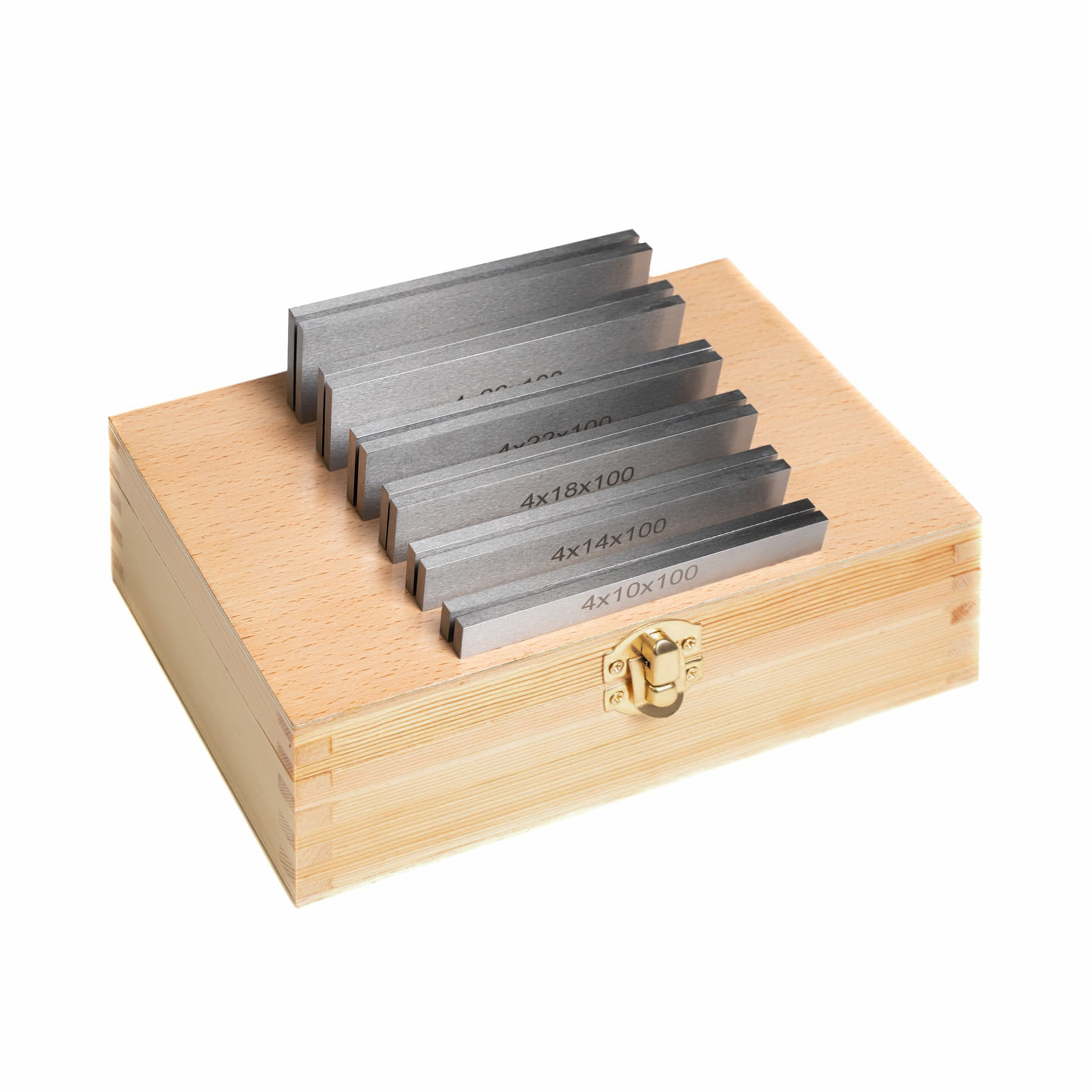

Includes:
  • 6 precision parallel pairs 100mm x 4mm and 10, 14, 18, 22, 26, and 30mm height
  • Protective storage case

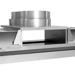

The vise parallel set is intended to be used in combination with the Langmuir Systems modular vise. Each parallel measures 100mm wide and is made out of 4mm thick tool steel. All surfaces are precision ground and the heights held to .01mm accuracy.
Parallels are used to space the workpiece off of the base of the vise. Parallels are particularly useful for holding parts that are subsequently flipped and machined for later operations. We recommend watching our machining videos to see how parallels are used with our modular vises – we use them constantly when machining parts.
