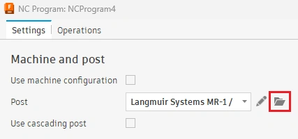

Install Post Processor
Follow the below instructions to install the CutControl Post Processor for Fusion360.
  1. Download the latest CutControl Fusion 360 Post from our Downloads page.
  2. Open Fusion 360 and switch over to the Manufacture workspace.
  3. Open the NC Program tab.
  4. Find the Post option and click the Select From Library command. 200
  5. Click on Import and choose the latest Fusion 360 Post downloaded in Step 1. Note: Fusion will remember this Post setting until you change it.
  6. Your programs will now be optimized for MR-1. Always double check your programs and slow down rapid movements when using a program for the first time. Note: Consider dry running the program first to verify correct movements and avoid collisions.
