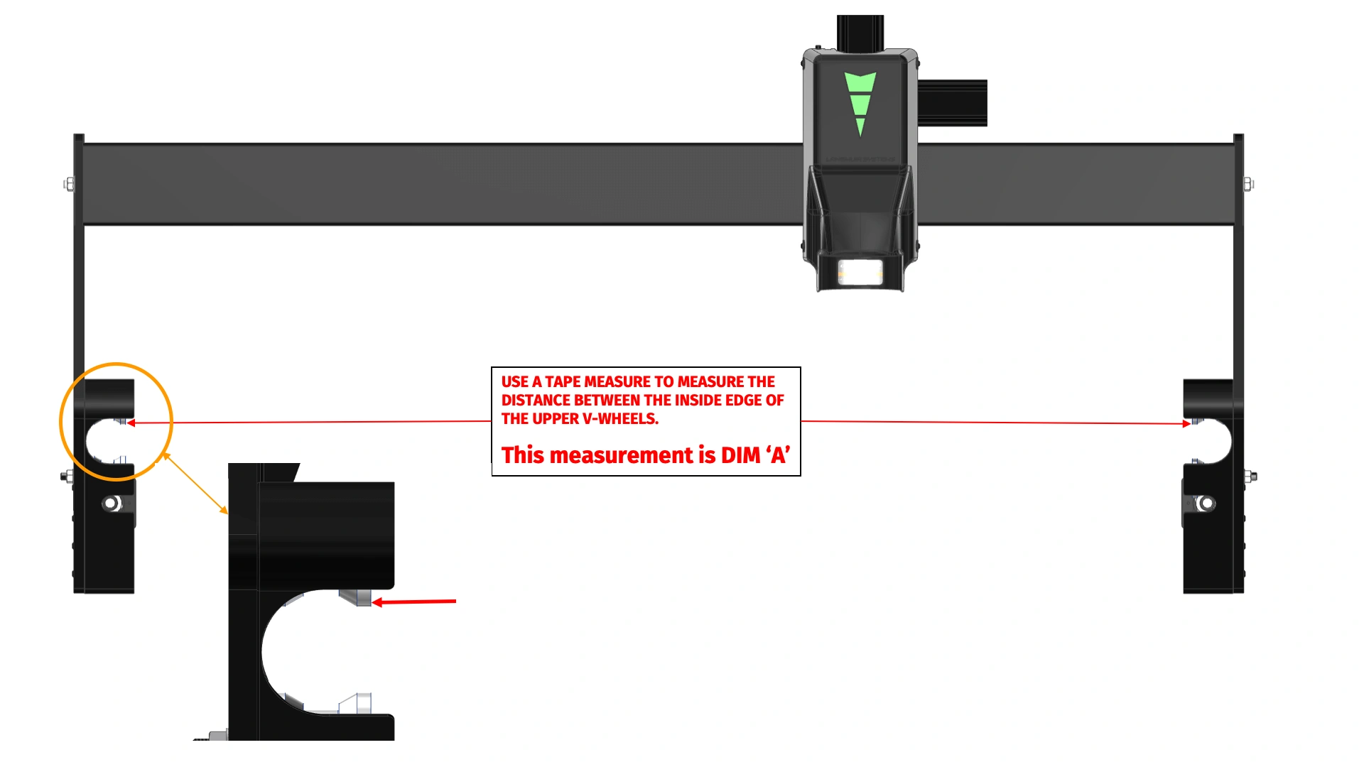

!STOP! Y-Axis Rail Alignment
CRITICAL: You must watch and understand the following video on the process of attaching the Y-Axis Rail to the machine accurately before proceeding with assembly. If you have printed out these instructions, do not continue on with assembly before watching and understanding the following video.
Materials
Parts
  • None
Hardware
  • None
Tools
  • TAPE MEASURE
  • PEN & PAPER
Instructions
  1. Using a Tape Measure, measure and record the distance between the inside edge of two upper v-wheels on opposite sides of the gantry. This measurement will be needed in a later step to set the rail-to-rail distance of the Y-Axis rails. As such, this measurement needs to be taken with great care. This dimension will be referred to as DIM ‘A’.

Rail Alignment
The goal of the following rail alignment steps is twofold:
  • to make the Y-Axis rails parallel to each other.
  • to make the distance between the rails match the wheel-to-wheel distance of the gantry V-Rollers (Dimension 'A').
All adjustments will be completed exclusively using the front and rear Y-Axis stabilizers and jam nuts on both rails that are circled in red. The central Y-Axis rail stabilizer jam nuts should remain backed out completely until the positions of both rails are set and the red circled jam nuts are tight. Failure to follow these rail alignment steps properly will likely result in your machine binding so we suggest understanding them completely first before proceeding.
  1. Working on the Lefthand rail first (when standing at the front of the machine this is the one on your left side), adjust the inner and outer M20 jam nuts until the distance between the inner rail surface and the nearest side of the front fascias is 1.25” at each end of the rail as shown in the diagram. The inner and outer jam nuts should be hand tight at this point so that the rail is rigid when taking your measurements. The measurement at the front should match the measurement at the back within 1/16”.
  2. Tigthen the nuts securing the rail making sure not to move the position of the rail when fastening. To do this, carefully place a wrench on the outer jam nut without rotating the nut. While keeping this wrench in a fixed position, use a second wrench to tighten the inner jam nut. Repeat this step for the rear stabilizer (circled in red).
  3. Next, we are going to tighten the remaining two Y-Axis Rail Stabilizers on the Lefthand rail. Start by hand seating the inner and outer jam nuts first against the frame surface and then place a wrench on the outer jam nut without rotating the nut. Tighten the inner jam nut to secure as performed in Step A2 above.

  1. In order to align the Righthand Rail, recall DIM ‘A’ that was recorded in our previous step. Take this dimension and add 1.75” to it and record this new number. This number will be the center-to-center rail spacing dimension that we will use to set our Righthand Rail in position.
  2. Working on the righthand rail, adjust the inner and outer M20 Jam Nuts at the front and rear (circled in red) until the center-to-center distance of the two rails matches the value that was calculated above. The easiest way to measure this distance is to use a tape measure and measure from the inner edge of the Lefthand rail to the outer edge of the Righthand rail as shown in the diagram. The inner and outer Jam Nuts should be hand tight at this point so that the rail is rigid when taking your measurements. In order to prevent binding and accuracy error, the rails must be parallel within 1/32”.
  3. Tigthen the nuts securing the rail, making sure not to move the position of the rail when fastening. To do this, carefully place a wrench on the outer jam nut without rotating the nut. While keeping this wrench in a fixed position, use a second wrench to tighten the inner jam nut. Repeat this step for the rear stabilizer (circled in red).
  4. Tighten the remaining two Y-Axis Rail Stabilizers on the Righthand Rail. Start by hand tightening the inner and outer jam nuts first and then place a wrench on the outer jam nut without rotating the nut. Tighten the inner jam nut to secure as performed in Step 2 above.

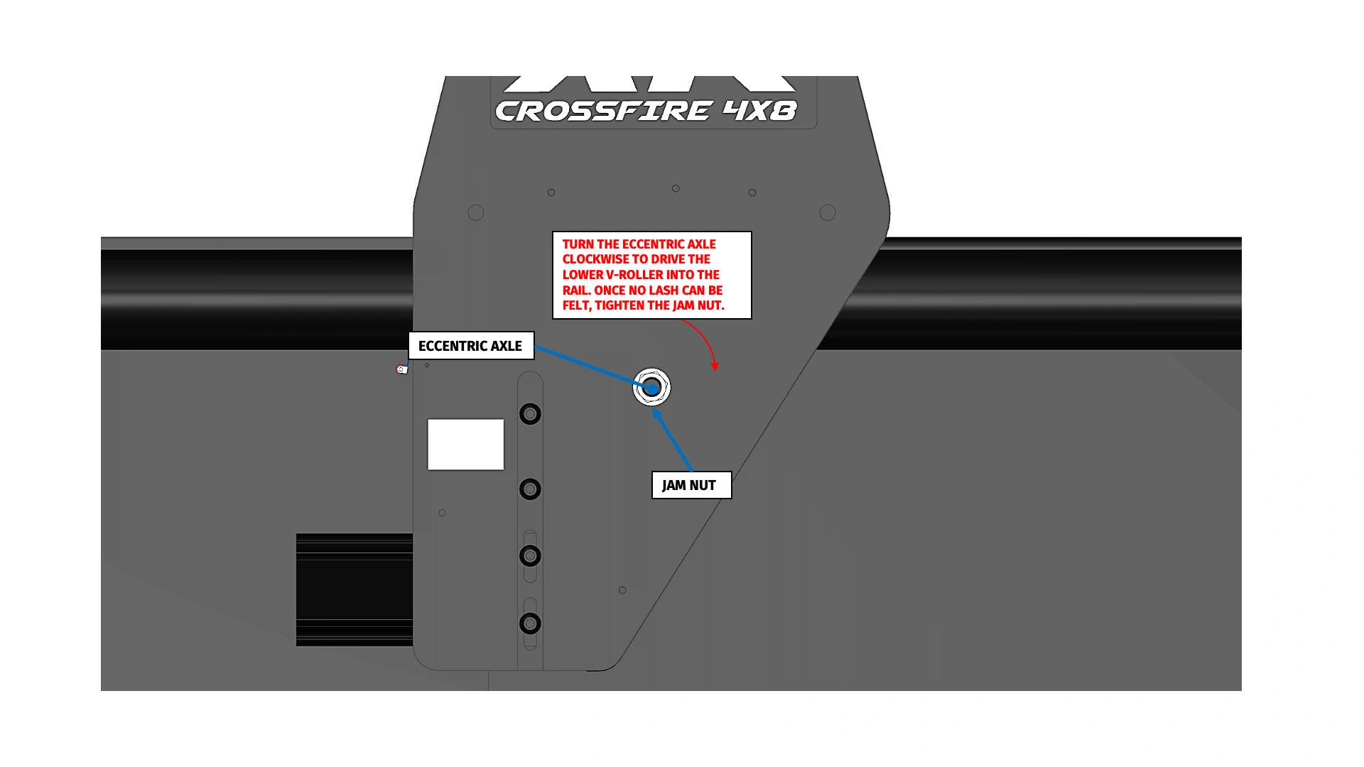

  1. The goal of this step is to adjust the lower V-Rollers on both sides so that no lash exists between the gantry and its rolling connection to the Y-Axis rails.
  2. Check to make sure that all 4 upper V-Rollers are in contact with the Y-Axis Rails. If rocking of the gantry on the rails can be observed, break loose and then re-tighten one of the nuts that is used to secure the gantry tube to the gantry uprights. The weight of the gantry will drive all four upper V-Rollers into simultaneous contact with the Y-Axis rails.
  3. With one hand, lightly snug the jam nut to remove play between the axle and the upright. With the other hand, turn the eccentric axle clockwise using a 5/16” wrench on the flats (do not use a crescent wrench here) until the V-Roller just contacts the underside of the Y-Axis Rail. Next, tighten the jam nut while holding the eccentric bolt at the same position with a wrench.
  4. Repeat Step D3 for the lower V-Roller on the other side of the gantry.
  5. Glide the gantry along the Y-Axis Rails and check to make sure the following conditions are met:
    • The gantry rolls freely. A small amount of resistance is acceptable but generally it should not be hard to push the gantry from one end to the other. If there is excessive rolling resistance, decrease the V-Roller preload and check again. Note: excessive preload of the eccentric bolt can cause binding issues if the gantry is too hard to move.
    • At all points of travel, there is no perceptible lash between the gantry and the rails. If lash can be felt, increase the V-Roller preload and check again.

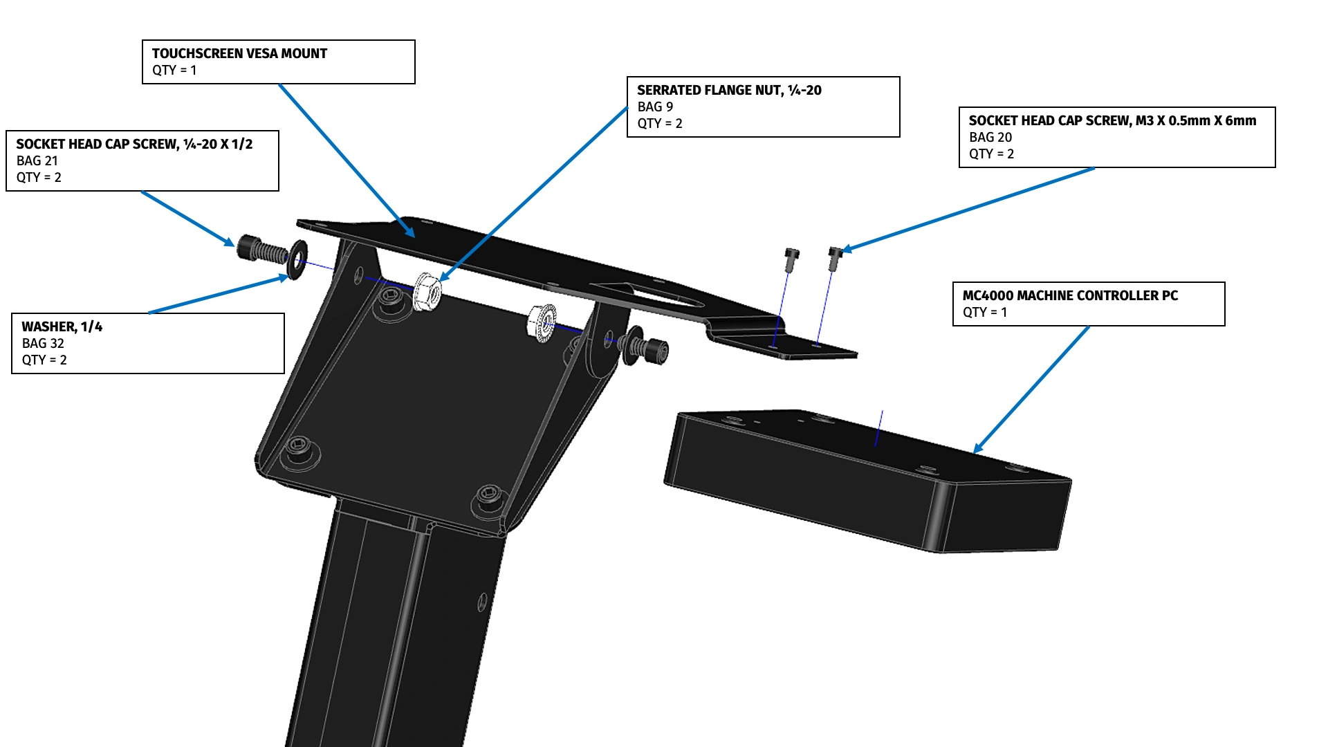

Materials
Parts
  • Machine (AS ASSEMBLED)
  • (1) Touchscreen VESA Mount
  • (1) MC4000 Machine Controller PC
Hardware
  • (2) BAG 21 SOCKET HEAD CAP SCREW, ¼-20 X 1/2"
  • (2) BAG 32 WASHER, ¼"
  • (2) BAG 9 SERRATED FLANGE NUT, ¼-20
  • (2) BAG 20 SOCKET HEAD CAP SCREW, M3 X 0.5MM X 6MM
Tools
  • 3/16” HEX
  • 2.5mm HEX
  • 7/16” WRENCH or SOCKET
Instructions
  1. Attach the Touchscreen Vesa Mount to the Touchscreen Pivot Bracket using the fasteners shown. The angle of the mount is adjustable to any angle between horizontal and vertical. A 45 degree mounting angle is a good initial setting and can be fine tuned later.
  2. Attach the MC40000 Machine Controller PC to the Touchscreen VESA Mount using the fasteners shown.

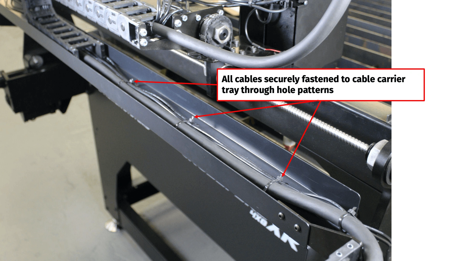

  1. With all the cables now installed, refer to the WIRE ROUTING TABLE, below, to begin staging the wires into the 3 distinct travel groups defined in the chart. Each set of cables will traverse a unique path until they collect at the Y-axis drag chain bracket for final feeding into the Y-axis Drag Chain. Be sure to identify each cable with colored tape or simple label near the connector end to simplify port location designation.
Wire Routing Table
X & Y-Axis Drag Chains X-Axis Tray & Y-Axis Drag Chain Y-Axis Drag Chain Only
Z-Axis Motor Cable Y2 Motor Cable Y1 Motor Cable
X-Axis Limit Switch Cable Y2 Limit Switch Cable Y1 Limit Switch Cable + Full Cable
X-Axis Motor Cable
Machine Status Cable
IHS Cable
Plasma Torch Lead
Instructions
  1. With each set of cables grouped and accounted for according to the wiring table above, bundle the cables together at the rear of the Z-Axis with zip ties using the following three steps:
    • 1. Use a Zip Tie to bundle together the Machine Status Cable, IHS Cable, Z-Axis Limit Switch Cable, and Z-a\Axis motor Cable as shown.

  1. Neatly secure all cables now spanning the X-Axis Cable Tray using zip ties through the hole patterns in the tray.
  2. Next, collect the Y1 motor and limit switch cables and bundle all cables together at the Y-Axis drag chain mount with a zip tie. Pass the bundle over the bracket to be staged for the Y-Axis chain.
