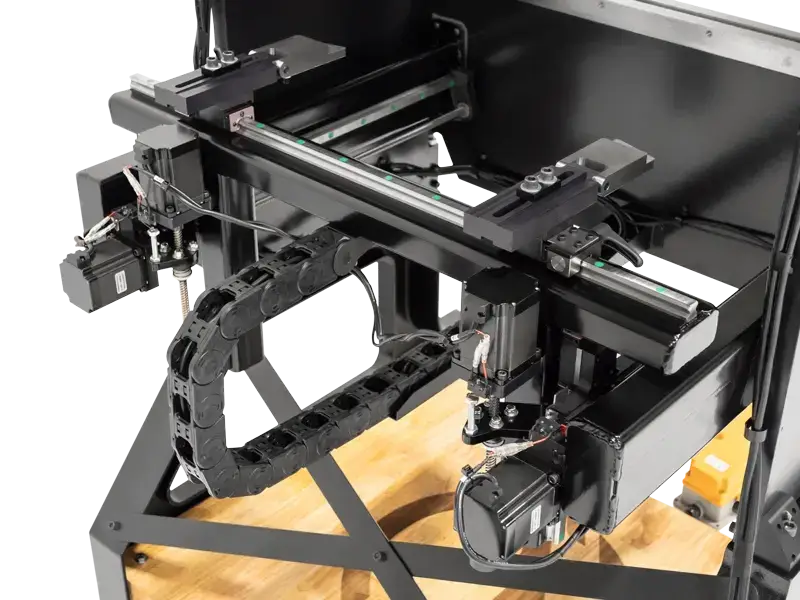

  • CrossFire XR
    2-Axis CNC Backgauge
    Never Miss a Bendline with Our Integrated 2-Axis CNC Backgauge, Includes One Pair of Adjustable Finger Stops, and Limit Switches for Dual Axis Auto-Squaring

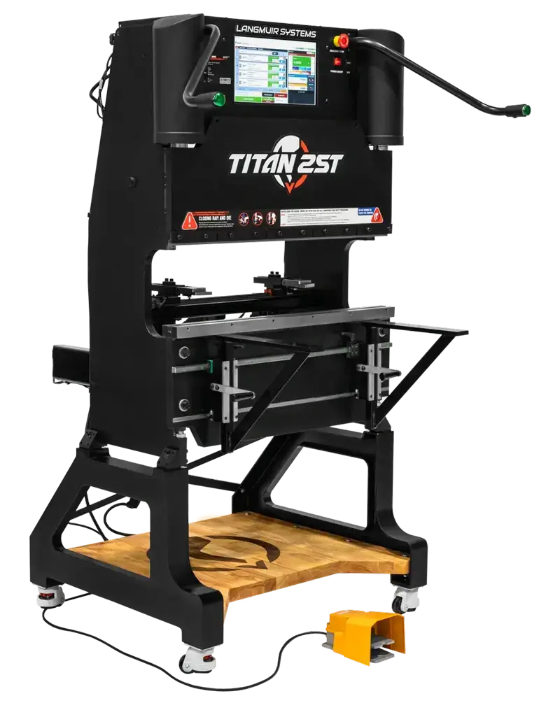

DISCOVER THE

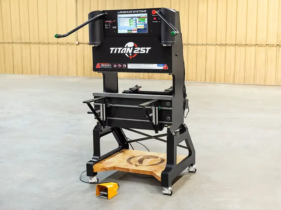

TITAN 25T
Introducing the Titan 25T, a versatile 25-Ton CNC Press Brake engineered by Langmuir Systems from the ground up to offer industrial bending capability for hobbyists and small businesses. Built with a focus on repeatability and precision, this machine offers professional-grade features at an unbeatable value. The Titan 25T combines ease-of-use with advanced capabilities, making it an ideal solution for those seeking to elevate their metalworking projects without breaking the bank. Reliable, efficient, and user-friendly, the Titan 25T sets a new standard in CNC press brake technology for small-scale operations.
EXPLORE POSSIBILITIES
INDUSTRIAL PERFORMANCE
CrossFire XR
Compact Size, Serious Bending
Maximize precious floor space in your shop without sacrificing capability
CrossFire XR

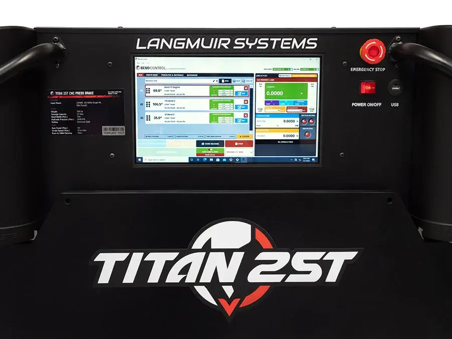

Conversational Programming with BendControl
Program and bend parts right at the touchscreen without the need for extra software
CrossFire XR

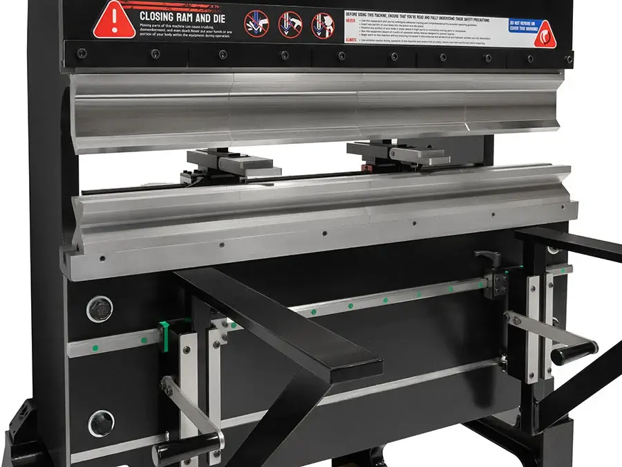

Verasitile Tooling Options
Accepts American-Style Press Brake Punches and Dies
CrossFire XR
HIGH PERFORMANCE
PRECISION & REPEATABILITY
Experience precision and power with the Titan 25T, featuring a 25-ton capacity and a 33-inch bend width. Achieve accurate, reliable bends with ease, thanks to its user-friendly interface that eliminates the need for external software. The Titan 25T makes advanced bending effortless, repeatable, and accessible.
CrossFire XR
FULLY SYNCHRONIZED
MOTION
The Titan 25T is equipped with dual-hydraulic rams synchronized through AC Servo Motors and glass scale positional feedback, meticulously engineered to maintain perfect stroking harmony. Put full load on one end of the table, and watch the other side stroke within 0.001”. These features were once only available on machines costing over $100K - now available to you.
CrossFire XR
CrossFire XR
NO EXTERNAL SOFTWARE
NEEDED
Ensure safe and efficient operations with the Titan 25T, equipped with a built-in LCD touchscreen and our user-friendly bending software, BendControl. Seamlessly program your bends using Conversational Programming without the hassle of a separate computer or complex software, putting control at your fingertips. Complete Manual Control is also available.
VERSATILE TOOLING
ON A SERIOUS BUDGET
Elevate your possibilities with a resilient array of tooling options, designed for durability and strength. Titan 25T will be available from the get-go with a variety of punches & dies that will accomplish 80% of your bending needs right out of the gate. Like everything that we do at Langmuir Systems, these tools will be offered at unbeatable pricing.
CrossFire XR
CrossFire XR
DESIGNED FULLY
IN-HOUSE
The Titan 25T has been engineered in-house from the ground up including our own purpose-built electronics, software, hardware, and controller system. True to form, we benchmarked the industrial offerings to arrive at a product that packs a professional punch at a fraction of the cost— all without sacrificing accuracy and precision.
INDUSTRIAL-GRADE
ADD-ON OPTIONS
Unlock limitless bending possibilities with the 2-axis CNC Backguage option for the Titan 25T. Take the guesswork out of material positioning and ensure precise bends at every stage of your production process. Making a thousand copies of one part is now as easy as programing the part once and letting Titan do the rest.
CrossFire XR
CrossFire XR
DEPENDABLE
TECH SUPPORT
Your Titan 25T comes with exclusive access to our Titan 25T technical support team. Whether its quick troubleshooting to get you back up and cutting or help with your particular program, Langmuir Systems is here for you.
CrossFire XR
RECEIVE THE TITAN
FULLY ASSEMBLED
The Titan 25T base machine arrives fully assembled and ready to start bending parts right out of the box. No time-consuming or complicated assembly required - just unpack the Titan, program your parts, and start bending! Plese note that certain add-ons and accessories require user assembly.
CrossFire XR
TITAN 25T
SPECIFICATIONS
CrossFire XR
Input Power:
240VAC, 50/60Hz Single Ph., 20A (Fused), Plug Style NEMA, 6-50P
Weight:
1100 lb, Fully Optioned
Tonnage Capacity (Max.):
25 Tons
Hydraulic Pressure (Max.):
3000 PSI
Hydraulic Oil Capacity (Max.):
1 Gallon
Recommended Hydraulic Oil:
ISO Grade 32
Bend Width (Max.):
33 in
Distance Between Frames:
29 in
Ram Stroke Speed (Max.):
15 in/min
Ram-to-Table Opening (Max.):
9 in
Backgauge Travel Limits:
17 in (X-axis), 4.8 in (R-Axis)
Table Width:
2.4 in
Floor Space Required (Min.):
36 in (W) x 40 in (D)
Hydraulic Pressure Transducer:
Piezoresistive Ceramic, Each Cylinder
Ram Positional Feedback:
Glass Scale Linear Encoder, Each Cylinder
Ram Positional Resolution/Repeatability:
0.0002 in / 0.0006 in
Tool Mounting:
American Style (0.5" Tang Width)
Ram Stroke Limit (Max.):
4 in
Backgauge Positional Resolution/Repeatability:
0.0005 in / 0.001 in
Backgauge Travel Speed (Max.):
100 in/min
