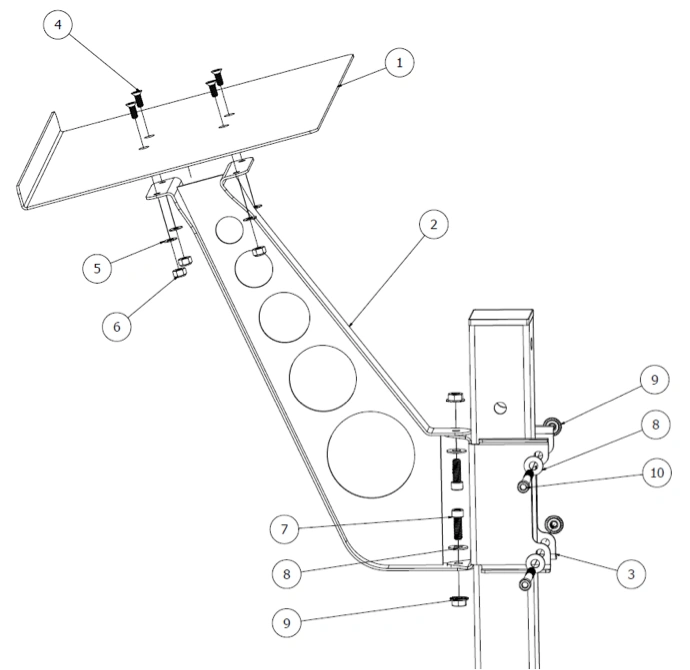

6: Torch Mount and Tube Cap Installation
Install the Torch Mount, Tube Caps, Cable Support Tube, Torch Height Stand-off Shims, and T-Handle Hex Key.
Materials
Parts and Hardware
  • 16x Tube Caps
  • Cable Support Tube
  • Torch Mount V-Blocks
  • Vertical Torch Slide
  • 1/16" Shim
  • 1/8" Shim
  • T-Handle Wrench
  • Hardware Bag 10: Torch Slide Hardware
Tools
  • Mallet
  • 5/32" Allen Wrench

Laptop Stand Assembly
Use these installation instructions to assemble and install your laptop stand.
Materials
Parts and Hardware
  1. 1x Tray
  2. 1x Vertical Support
  3. 1x Leg Mounting Bracket
  4. 4x Phillips Flat Head #10-24 x 1/2"
  5. 4x Flat Washer #10
  6. 4x Hex Nylock Nut #10-24
  7. 2x Socket Head Cap 1/4"-20 x 3/4"
  8. 4x Flat Washer 1/4"
  9. 4x Serrated Flange Nut 1/4"-20
  10. 2x Socket Head Cap 1/4"-20 x 2.5"
Tools
  • Phillips head screw driver
  • 7/16" wrench
  • 3/16" Allen key
Installation Step laptopstand
Installation Steps:
  1. Fasten Leg Mounting Bracket (#3) to the front left CrossFire Leg tube using two long Socket Head Cap Screws (#10), two Washers (#8), and two serrated Flange Nuts (#9).
  2. Fasten Vertical Support (#2) to Leg Mounting Bracket (#3) using two short socket head cap screws (#7), two Washers (#8), and two Serrated Flange Nuts (#9). Note: The amount of swivel resistance can be adjusted by tightening or loosening fasteners to the desired resistance.
  3. Fasten Tray (#1) to Vertical Support (#2) using four Phillips Flat Head Screws (#4), four Washers (#5), and four Nylock Nuts (#6).
