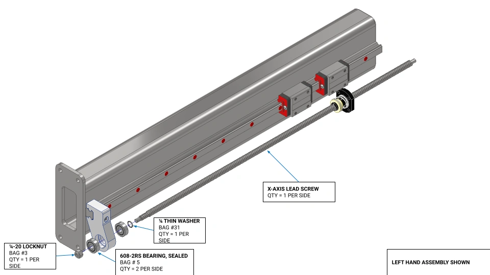

Materials
Parts
  • (1) X-Axis Lead Screw
Hardware
  • (2) 608-2RS BEARING, SEALED
  • (1) ¼-20 LOCKNUT
  • (1) ¼ THIN WASHER
Tools
Backgauge_Assembly_Guide
Instructions
  1. Install the 608-2RS Bearings into the counterbores of the X-Axis Bearing Mount as shown.
  2. While holding the bearings in their respective counterbores, slide the ¼ thin washer on to the threaded end of the X-Axis Lead Screw and insert the threaded end of the lead screw through both bearings.
  3. Install the ¼-20 locknut to the threaded end of the X-Axis Lead Screw. Leave the locknut loose for now (about ¼ turn from hand tight), these will be tightened later in step H1.

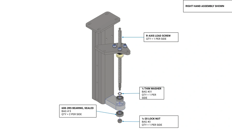

Materials
Parts
  • (1) R-Axis Lead Screw
Hardware
  • (1) ¼ THIN WASHER
  • (2) ¼-20 LOCK NUT
Tools
RIGHT_HAND_ASSEMBLY
Instructions
  1. Install the 608-2RS Bearings into the counterbores of the R-Axis Bearing Mount as shown.
  2. While holding the bearings in their respective counterbores, slide the ¼ thin washer on to the threaded end of the R-Axis Lead Screw and insert the threaded end of the lead screw through both bearings.
  3. Install the ¼-20 locknut on to the threaded end of the R-Axis Lead Screw. Leave the locknut loose for now (about ¼ turn from hand tight), these will be tightened later in step H1.

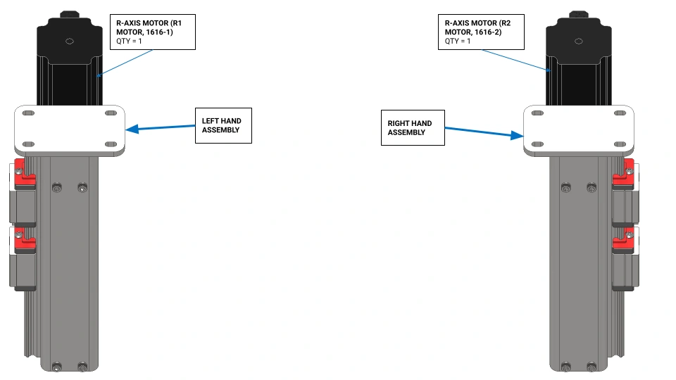

Materials
Parts
  • (1) Motor Coupler
  • (1) R-Axis Motor (R2 Motor, 1616-2)
Hardware
  • (4) SOCKET HEAD CAP SCREWS, 10-24 X 0.5”
Tools
  • 5/32” Hex Key
R-Axis_Motor_R2_Motor
Instructions
  1. Slide the Motor Coupler on to the non-threaded end of the lead screw.
  2. While holding the Motor Coupler on the lead screw, slide the R-Axis Motor shaft in to coupler and install the R-Axis Motor on to the mount as shown.

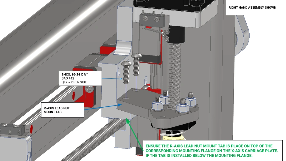

Materials
Parts
Hardware
  • (4) BUTTON HEAD CAP SCREW, 10-24 X ⅝”
Tools
  • ⅛” Hex Key
X-Axis_Carriage_Plate
Instructions
  1. Slide the R Axis Tube Assembly such that the R-Axis Lead Nut Mount Tab rests on the X-Axis Carriage Plate, rotating the R-Axis Lead Nut as necessary such that the mounting holes align with the corresponding mounting holes on the X-Axis Carriage Plate. Ensure the R-Axis Lead Nut Mount Tab is installed above the corresponding mounting flange on the X-Axis Carriage Plate. If the Mount Tab is incorrectly installed below the mounting flange, the R-Axis Limit Switch Screws will not be able to reach the limit switch.
  2. Fasten the R-Axis Lead Nut Mount Tab to the X-Axis Carriage Plate as shown.

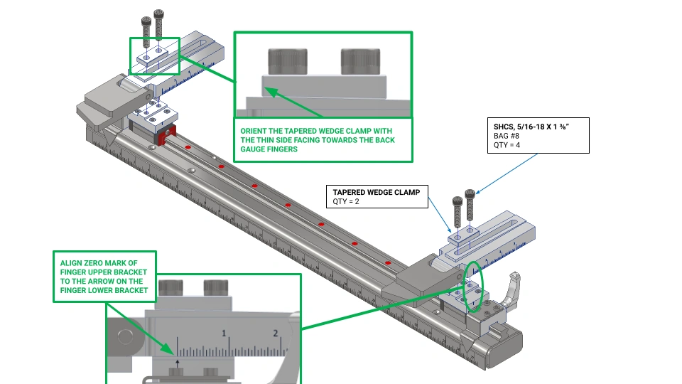

Materials
Parts
  • (2) Tapered Wedge Clamp
Hardware
  • (4) SOCKET HEAD CAP SCREW, 5/16-18 X 1 ⅜” (2 per side)
Tools
  • ¼” Hex Key
Tapered_Wedge_Clamp
Instructions
  1. Attach the Backgauge Finger Assemblies to the Finger Lower Brackets using the fasteners and Tapered Wedge Clamps as shown. Attach the Backgauge Finger Assemblies to the Finger Lower Brackets using the fasteners and Tapered Wedge Clamps as shown. Orient the angled face of the Tapered Wedge Clamp down towards the Finger Upper Brackets, with the thin side of the clamp facing towards the Backgauge Finger. When installed correctly, the socket head cap screws will rest flat on the upper surface of the clamp, as shown.
  2. Adjust to position of the Finger Upper Brackets such that the arrows on the Finger Lower Brackets points to the zero marks on the Upper Brackets.

Instructions
  1. Locate the 4 motor wires (connector/plug end) that install into the back of the Titan 25T Electronics Enclosure.
  2. Each of the four motors are labeled with a unique part number. Similarly, this part number is applied to a label adjacent to the plug at the end of the cable. Use the ‘Motor Part Numbers’ table to determine which ports on the back of the electronics enclosure these motor cables must be connected to. For example, a cable with part number LS-PBRK-1616-2 belongs to the R2 motor and therefore should be plugged into the R2 Motor Port.
    Note
    The plugs are directional and have a built in keyway to determine the orientation of the connector.
  3. Locate the X-Axis limit switch cable and insert the connector end into the electronics enclosure plug.
  4. Repeat step G3 for the R-axis Limit Switch cable.
  5. Ensure the wiring is installed correctly to the electronics enclosure and that the limit switch pigtails are matched by colors (Red to Red & Black to Black) when installing them onto the end of the cable.

Instructions
  1. Jog the Backgauge back until the R-Axis Lead Nut Mount Tabs are within ⅛” of the X-Axis Motor mounts.
  2. Loosen the fasteners securing the X-Axis Limit Switch Tabs and slide them forward, until both X-Axis Limit Switches are just barely triggered on both sides. At the trigger point on the limit switches, there should be an audible click. Tighten the fasteners securing the X-Axis Limit Switch Tabs. Note: It is very important that the X-Axis Limit Switch Tabs are secured in the exact location that triggers the limit switch. If this is not done accurately, it will reduce the positioning accuracy of the back gauge.
  3. Jog the Backgauge forward such that both X-Axis Limit Switches are no longer triggered.
