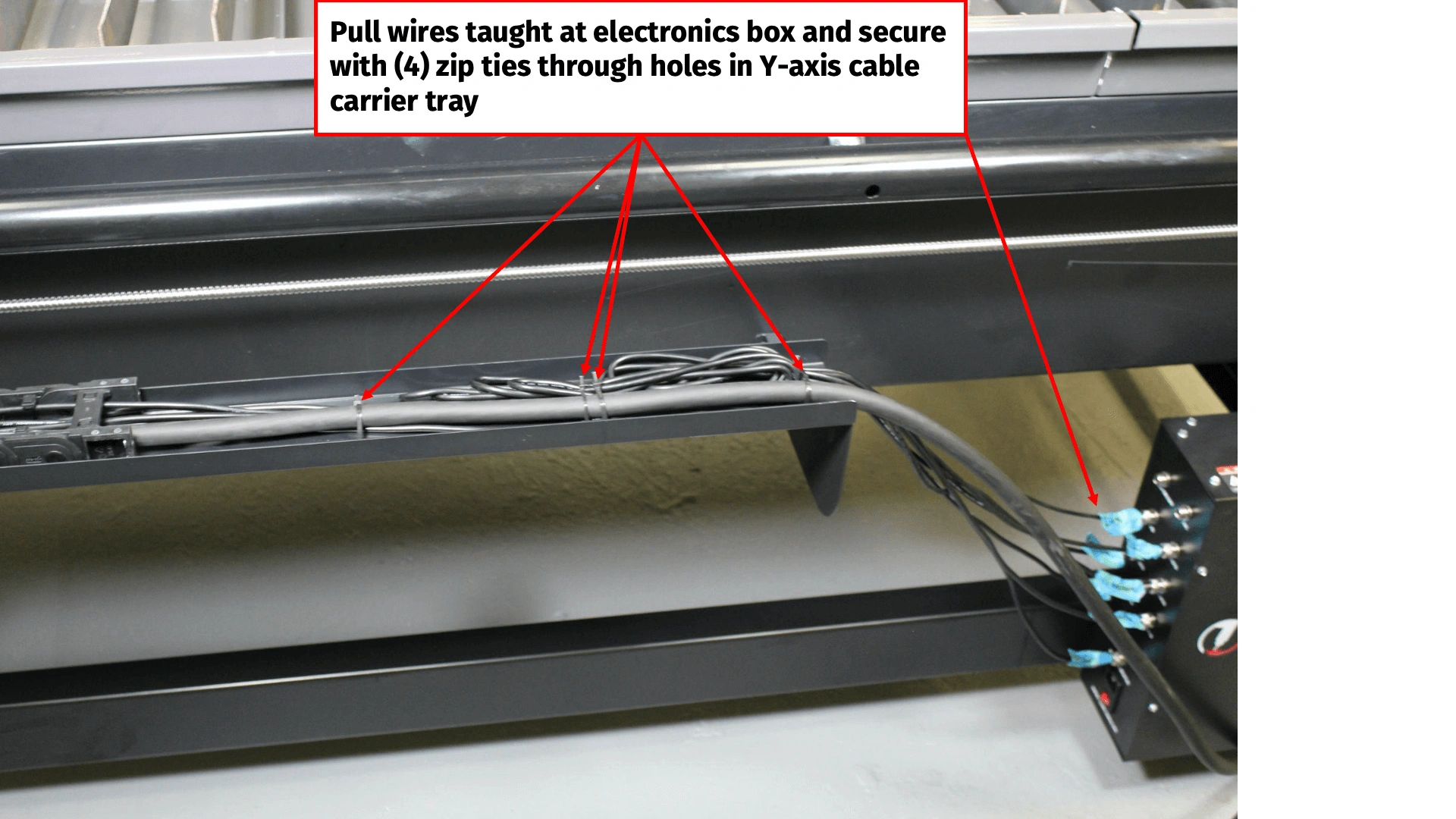

  1. Mount the Y-Axis drag chain over the cables to the bracket as shown. Pass the cables through the chain and reinstall the remaining chain links as done previously on the X-axis Drag Chain. Secure the drag chain end to the Y-Axis mounting bracket using (4) BAG 25 SHCS and (4) BAG 15 Flange Nuts.
y_axis_carry_tray
Instructions
  1. With all cables previously identified and labeled, simply connect each cable to the corresponding connector port on the back side of the electronics box. Remove any additional slack from the cables by pulling them taught at the box and zip tying the excess length looping back to the Y-Axis carrier tray as shown.
