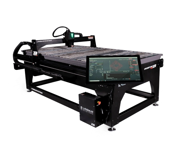

25” (X) x 23” (Y) x 3.0" (Z) |
25” (X) x 33” (Y) x 3.0" (Z) |
48” (X) x 33” (Y) x 3" (Z)+ (IHS) Initial Height Sensing |
48" x 48" (X & Y) x 3" (Z)+(IHS) Initial Height Sensing |
48" (X) x 96" (Y) x 2.5" (Z) |
| Support | |||||
| Support |
FREE LIFE TIME Phone and Email SUPPORT, Access to the online portal, and Forum |
Dedicated XR Support appointment system via phone, video, and email. Also includes Support Portal and Forum |
| Water Table | |||||
| Water Table |
Optional Stainless Steel Water Table |
Included 2 in Stainless Steel Water Table |
Included 3.5in Powder Coated Steel Water Table |
Included Reinforced Structural 65 Gallon Water Table |
| Torch Height Control | |||||
Manual Torch Height Adjustment, Optional Powered Z-Axis |
Powered Z Axis with Floating Head Hand Torch Mount with available Machine Torch Mount |
Powered Z Axis with Floating Head Machine Torch Mount |
| Initial Height Sensing | |||||
Available with Z-Axis Upgrade |
Included |
Included |
Included |
| Automatic THC | |||||
| Automatic THC |
Available Z-Axis & LS-THC Upgrade |
LS-THC Optional Add-On |
LS-THC Optional Add-on |
Included |
| Limit Switches | |||||
| Limit Switches |
Available Limit Switch Kit |
Included |
| Max Cut Speed | |||||
| Max Cut Speed |
300 IPM |
300 IPM |
300 IPM |
300 IPM |
400 IPM |
| Weight Capacity | |||||
| Weight Capacity |
1/2" Plate |
1/2" Plate |
1/2" Plate |
1" Plate |
1" Plate |
| Machine Weight | |||||
| Machine Weight |
130 LB |
130 LB |
223 LB |
290 LB |
750 LB |
| Machine Footprint | |||||
| Machine Footprint |
44.2" x 42.5" |
44.2" x 52.5" |
54.2" x 69.5" |
69” x 69.5” |
5.2' x 9.0' (6.6' x 11.3' with Mounted Touchscreen) |
| Gantry | |||||
| Gantry |
Cantilevered Gantry for ease of access |
Supported Gantry for extra stability |
Large Profile supported gantry beam with gusseted uprights |
| Drive System | |||||
| Drive System |
3/8”-8 4-Start ACME Lead Screws and Acetal Anti-Backlash Lead Nuts |
3/8”-8 4-Start ACME Lead Screws and Acetal Anti-Backlash Lead Nuts, 1/2” 5-Start Lead Screw (X) |
Upgraded 1/2”-8 4-Start ACME Lead Screws and Acetal Anti-Backlash Lead Nuts, 1/2” 5-Start Lead Screw (X) |
1/2" Ball Screws, Driven Rotating Ball Nut System |
| Motion Accuracy | |||||
| Motion Accuracy |
0.002" per 12" |
0.002" per 12" |
0.002" per 12" |
0.002" per 12" |
0.002" per 12" |
| Step Resolution | |||||
| Step Resolution |
0.0005" |
0.0005" |
0.0005" |
0.0005" |
0.0007” |
| Motion Controller | |||||
| Motion Controller |
LS Gen2 Motion Control |
LS XR Motion Control |
| Control Software | |||||
| Control Software |
FireControl |
FireControl |
FireControl |
FireControl (PRO MAX) |
FireControl XR with enhanced machine positioning, soft limits, and homing |
| Control Computer | |||||
| Control Computer |
Available Electronics Kit – 21.5" HD Touchscreen with Integrated Windows miniPC |
Included Electronics Kit – 21.5" HD Touchscreen with Integrated Windows miniPC |
| Torch Status LED | |||||
| Torch Status LED |
Unavailable |
Unavailable |
Unavailable |
Unavailable |
Included |
| Cable Management | |||||
| Cable Management |
Cable Support Tube |
Dual Drag Chain |

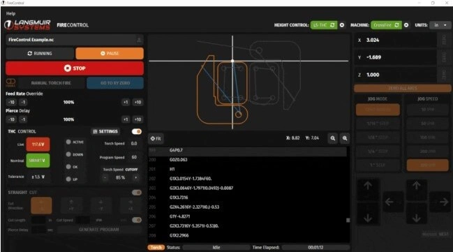

Run your CrossFire with FireControl, our free machine controller software with tons of features that make cutting even easier. We’ve developed FireControl to be easy to use, efficient, and robust with features like: Pattern, Scale, Rotate, Run From line, Dry Run, and Straight Cut Generation. FireControl is Cross platform and runs on Windows and MacOS.
Explore FireControl →
