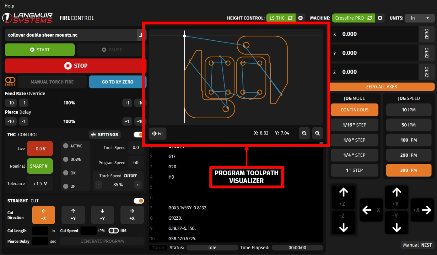

Program Toolpath Visualizer
Location of Visualizer in FireControl
The Program Toolpath Visualizer is used in FireControl to display the toolpath of a loaded program as well as the current torch position in relation to the cutting program. Cutting toolpaths are shown in orange color, rapid moves are shown as blue lines, and the current torch position is shown as a white crosshair. The visualizer will be blank until a cutting program is loaded into FireControl.
Below the visualizer window are three buttons; Fit, Zoom-in, and Zoom-out. The toolpath visualizer can be panned around the window by left clicking and holding while moving the mouse around. To zoom the visualizer in and out, click the zoom-in and zoom-out magnifying glass icon buttons below the Toolpath Visualizer. If you have a mouse with a scroll wheel click, the visualizer window and scroll up on the scroll wheel to zoom in and scroll down to zoom out. The ‘Fit’ button is used to reset the toolpath view size to fit the window if it was previously changed or moved.
The toolpath visualizer is a useful tool when running programs to verify that everything is correct with your program before and during a cutting cycle. We suggest that after zeroing a program, you manually jog the torch around the machine bed to verify that your cutting program will fit within your available material by following the crosshairs on the screen.

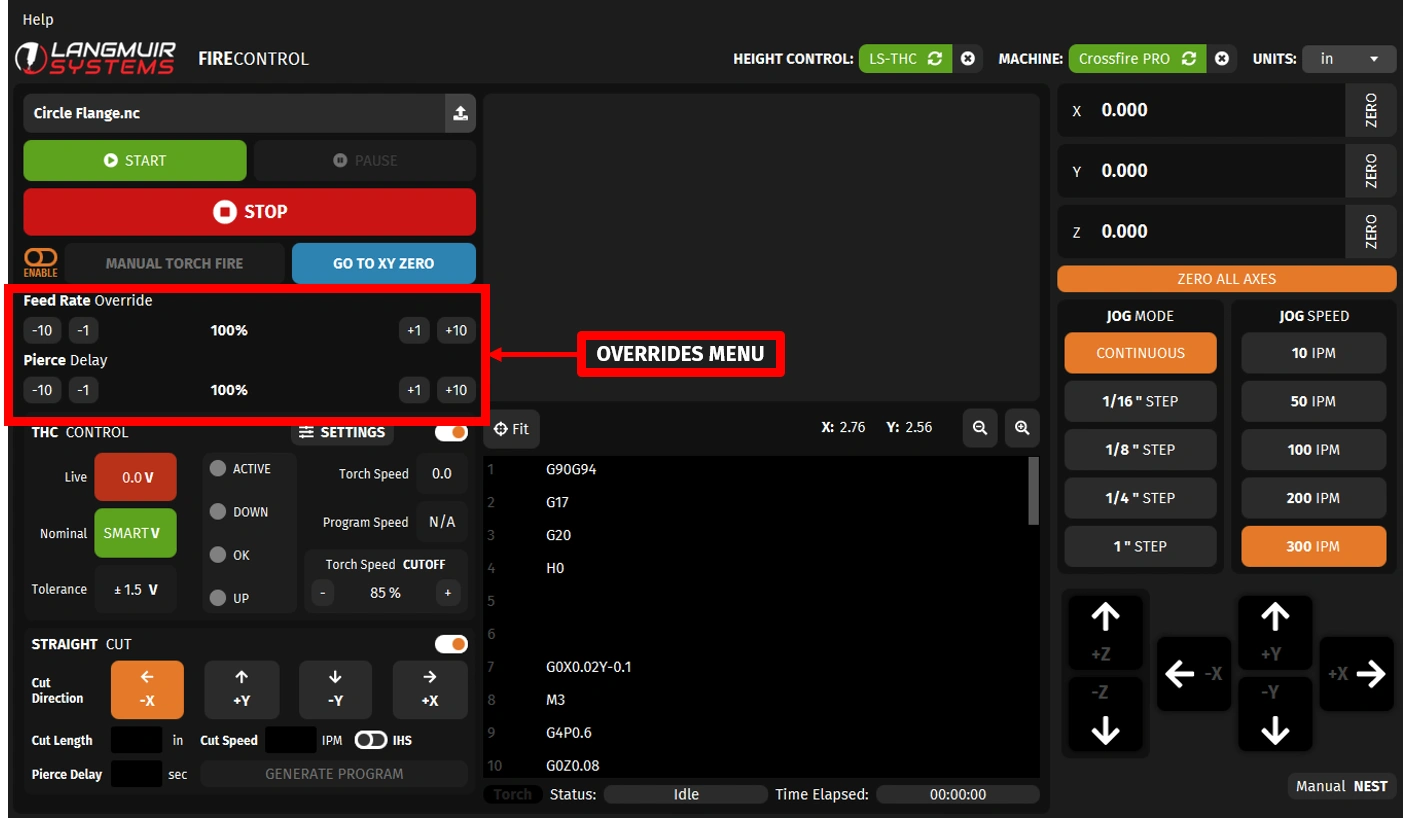

Real-time Overrides Menu
Real-time overrides
Location of Real-time overrides in FireControl
The Real-time Overrides menu is used to make adjustments to your cutting program while the program is currently running. The two Real-time Overrides are Feed Rate Override and Pierce Delay Override. Feed Rate override is used to slow down or speed up the feed rate of a program while it is cutting. The Pierce Delay Override is used to increase or decrease the pierce delay duration while a program is running. The overrides can be reset back to default by clicking the reset icon to the right of the current override percentage.

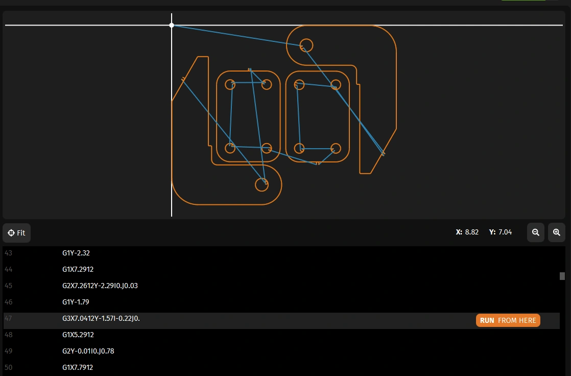

Run From Here mode can be used to start a program from a point point other than the beginning of the program. This can be useful if you need to pick up a cut in the middle of a program without having to start at the very beginning. To execute Run From Here mode, highlight the line of G-code in the program that you wish to run the program from and click the orange ‘RUN FROM HERE’ button next to the highlighted line (see below).
Run From Here
Location of 'Run From Here' option in the G-code viewer of FireControl
Since a cut program cannot start in the middle of a cut loop, FireControl will automatically determine the start of the cutting loop for the line that you have selected and ask you to confirm this start point. After confirming, FireControl will load the new program starting with the cutting loop that you highlighted in the previous step. You will notice from the visualizer that the program now excludes cutting loops before the line you selected with ‘Run From Here’ indicating that you are in the middle of the cutting program (see below).
'Run from here
Result of 'Run from here' without the first loops
