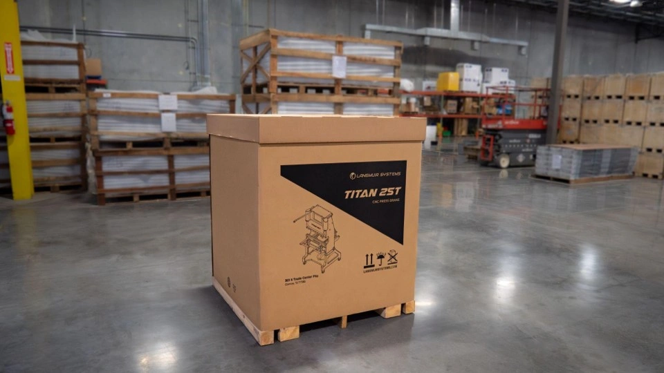

0: Uncrating/Unboxing

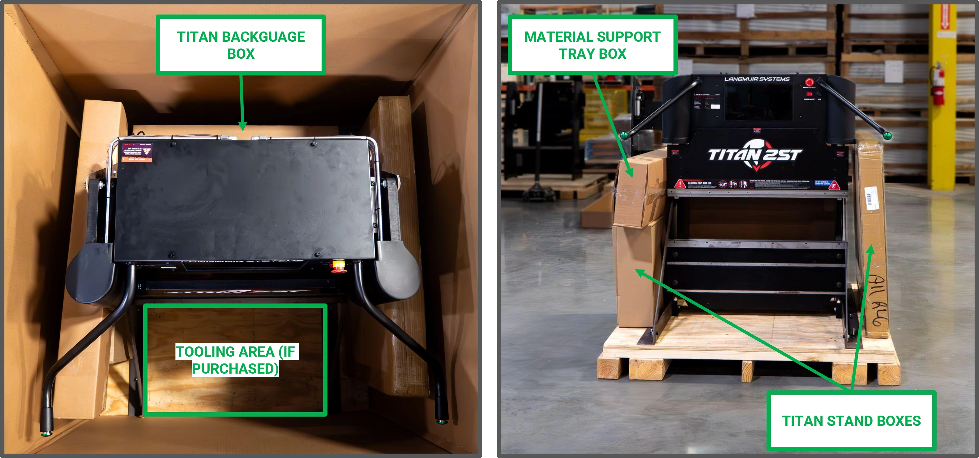

The Titan 25T base unit is delivered fully assembled on a singular skid. An in depth description of what is inside is provided here. Please use this as a reference for the rest of the assembly.
Main Box
  • (1) Fully assembled Titan 25T
  • (1) Foot Pedal
  • (1) Power Cord
  • (1) Tooling Sub Box
  • (1) Punch Clamp Box
1: Add-on Unboxing
At the time of purchase, if any Titan add-ons were selected, they will be shipped nested within the Titan 25T boxing.
Note
THE FOLLOWING ITEMS ARE CONSIDERED ADDITIONAL ACCESSORIES AVAILABLE FOR PURCHASE IN OUR ONLINE STORE. IF YOU DID NOT P URCHASE ANY ADD-ONS WHEN ORDERING YOUR TITAN 25T, YOUR PALLET WILL NOT INCLUDE ADDITIONAL BOXING ASIDE FROM THE FOOT PEDAL AND POWER CORD.
Backguage Add-on Box
  • METAL TUBE WELDMENTS SUB BOX
  • (1) LINEAR BEARING AND LEAD SCREW SUB BOX
  • (1) DRAG CHAIN
  • (1) MISC PARTS SUB BOX
  • (1) BACKGUAGE ELECTRONICS BOX
  • (1) MISC HARDWARE BOX

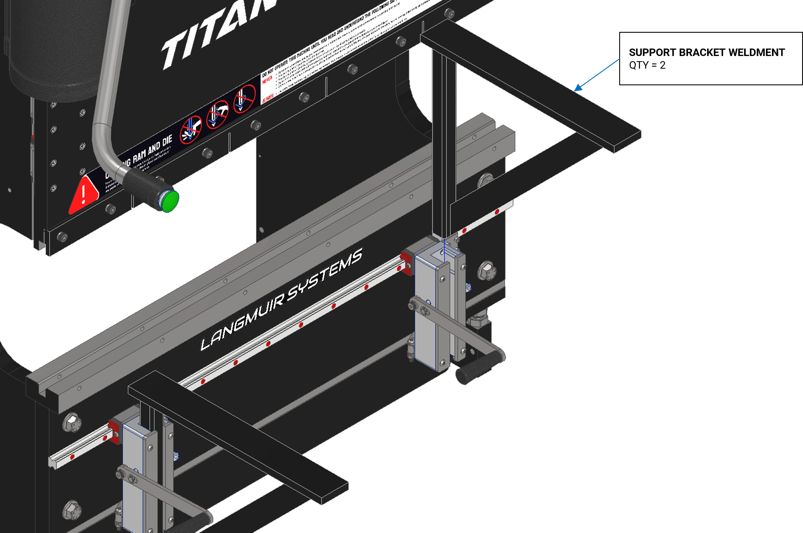

Material Support Tray Add-on Box
  • (1) LINEAR BEARING AND RAIL ASSEMBLY
  • (2) SUPPORT BRACKET WELDMENTS
  • (2) MISC PARTS SUB BOX
Press Brake Stand Add-on Boxes(2)
  • (1) LH CAST SIDE SUPPORT
  • (1) RH CAST SIDE SUPPORT
  • (1) MATERIAL STORAGE TRAY
  • (1) ADJUSTABLE CASTER BOX
  • (1) PRESS BRAKE STAND FOOT SUB BOX
  • (2) STAND DIAGONAL BRACE
Titan Lift Plate Add-on Package
  • (2) TITAN LIFT PLATES
  • (2) HARDWARE SUB BAG
Leveling Foot Kit Add-on Box
  • (4) LEVELING FEET
  • (4) LEVELING FOOT MOUNT
  • (1) HARDWARE BAG

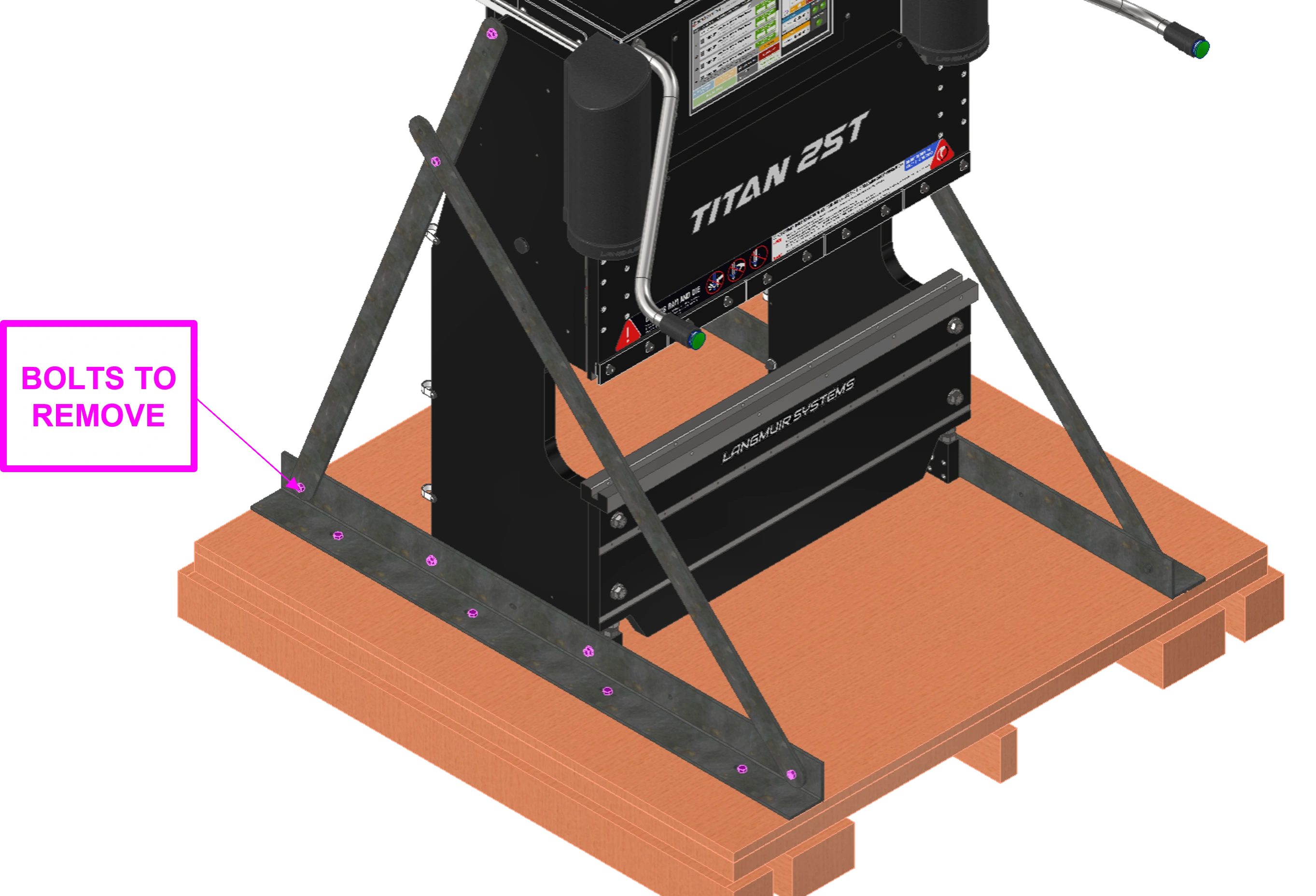

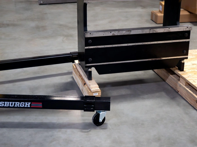

2. Removing the Shipping Support Arms and Wood Support Blocks
The first step in removing Titan from the pallet is to remove the support arms and angle iron from the unit. The wooden support blocks between the Ram and Table should also be removed before attempting to turn on and move the Rams on the Titan. The wooden blocks can either be hammered out or removed with a saw.
Materials
Parts
  • None
Hardware
  • None
Tools
  • (2) ½” Box End Wrenches
  • (1) 9/16” Socket Wrench
  • (1) Pry Bar (Optional)
Instructions
Note: Titan 25T arrives bolted to a metal bracing to ensure safe shipping. This bracing must be removed prior to moving and operating the Titan 25T. Failure to remove the metal structure prior to operation can damage the Titan 25T.
IMPORTANT
PRIOR TO BEGINNING THIS STEP, ENSURE THE TITAN PALLET IS PLACED IN AN OPEN AREA THAT IS EASILY ACCESSIBLE BY FORKLIFT OR SHOP CRANE FROM ALL SIDES OF THE PALLET. SPACE REQUIREMENT WILL VARY BASED ON MAKE AND MODEL OF LIFTING EQUIPMENT.
  1. Using two ½” Box End Wrenches, loosen and remove all bolts highlighted in magenta on the shipping bracing from both sides. Then, using a 9/16” Socket Wrench, remove the nuts securing the angle iron to the Titan 25T Pallet. Remove bracing from the pallet.
Note: If removal of the bolts that attach the angle iron to the bottom of the Titan 25T proves to be a challenge, using a pry bar to slightly elevate the Titan off pallet will remove vertical loading on the bolts for easy removal.

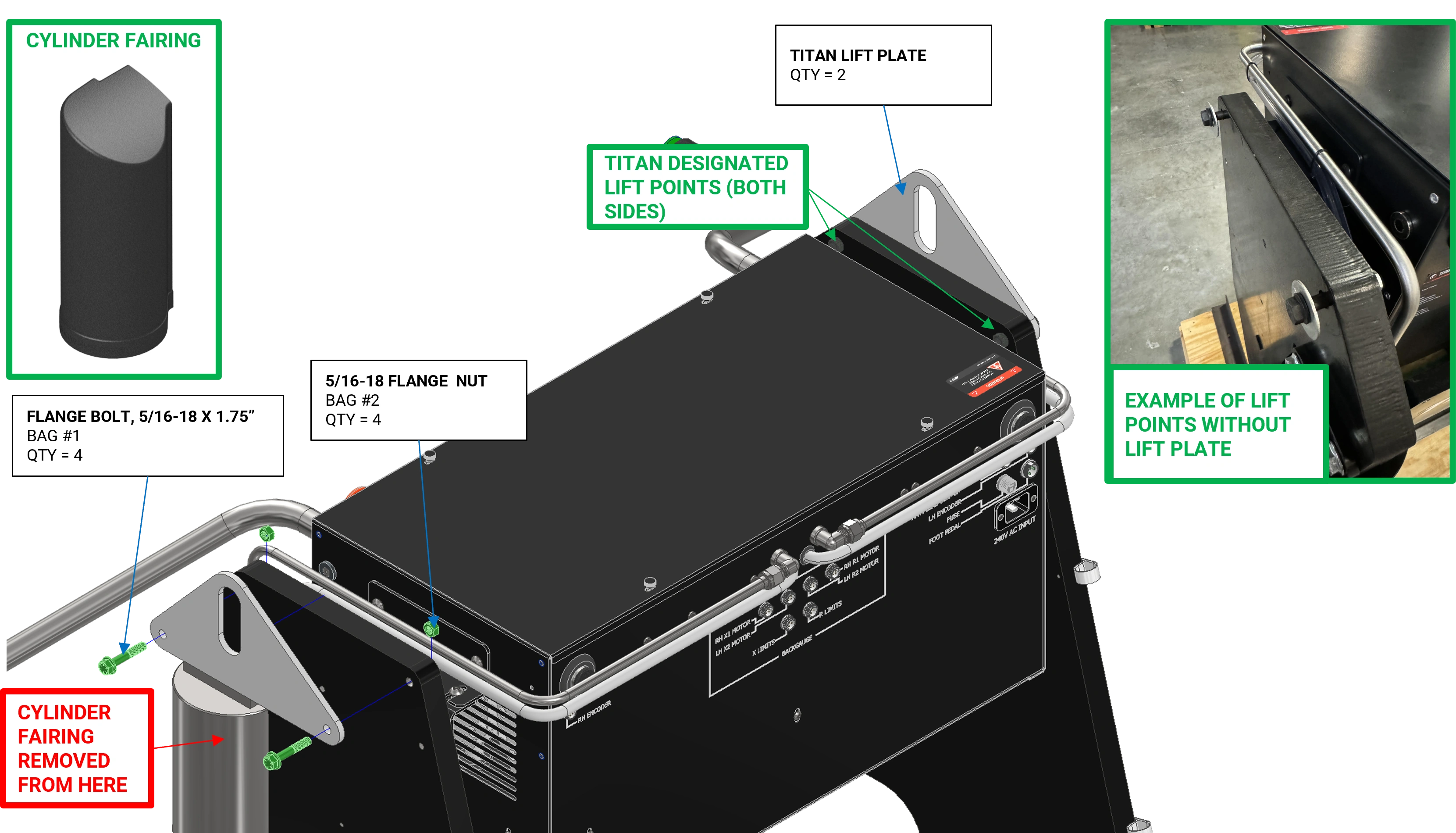

3: Preparing to Lift The Titan 25T
The second step to remove the Titan 25T from its pallet is to prepare the designated lift points.
Materials
Parts
  • (2) Titan Lift Plate
Hardware
  • (4) 5/16-18 x 1 ¾ Hex Head Flange Bolt
  • (4) 5/16-18 Flange Nut
Tools
  • None
Instructions

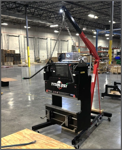

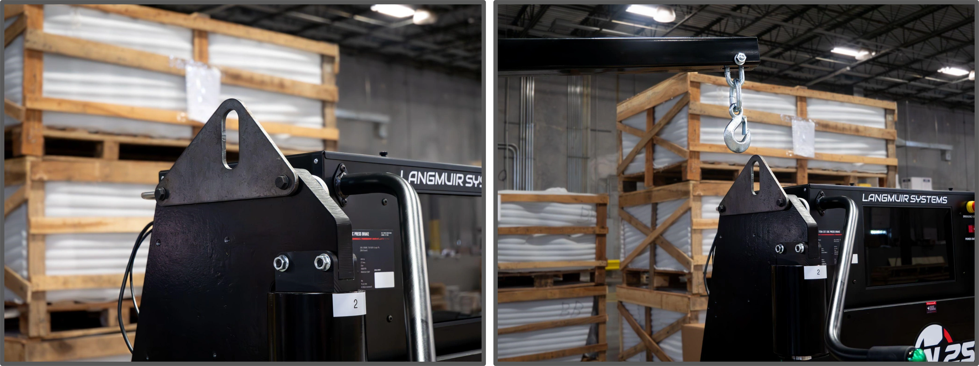

WARNING SYMBOL: TITAN 25T LIFT POINTS
WARNING
WARNING: Titan 25T has built-in, designated lift points for safe lifting of the unit. Failure to utilize the designated lift points can result in permanent damage to the Titan 25T and a serious risk to your safety that may result in injury or death. Do NOT under any circumstances attempt to lift the Titan 25T from any point other than the designated lift points.
Note
THE FOLLOWING STEPS OUTLINE LIFTING PROCEDURES UTILIZING THE TITAN LIFT PLATE KIT. IF YOU DID NOT PURCHASE THE TITAN LIFT PLATE KIT, YOU WILL NEED TO SOURCE GRADE 8, 5/16-18 BOLTS WITH ENOUGH LENGTH TO ATTACH LIFTING CHAIN OR STRAPPING. IT IS RECOMMENDED TO UTILIZE OVERSIZED WASHERS AS A BACKSTOP ON THE SOURCED BOLTS TO PREVENT THE CHAIN OR STRAPPING FROM SLIPPING OVER THE BOLT HEAD DURING LIFTING OF THE UNIT.
  1. The Titan 25T comes equipped with two hydraulic cylinder fairings that cover one of the designated lift points. To gain access to the lift point, remove the fairings from their magnetic connectors by pulling them vertically off of the Titan 25T. Set aside for reinstallation at a later time.
  2. Install and orient the Titan Lift Plates with the provided fasteners as shown.
Note
FAILURE TO ORIENT THE TITAN LIFT PLATE CORRECTLY WILL CAUSE THE UNIT TO LEAN FORWARD SIGNIFICANTLY WHEN LIFTING AND CREATE UNSAFE LIFTING CONDITIONS CAPABLE OF DAMAGING THE TITAN.
INFO SYMBOL : LIFTING EQUIPMENT
Note

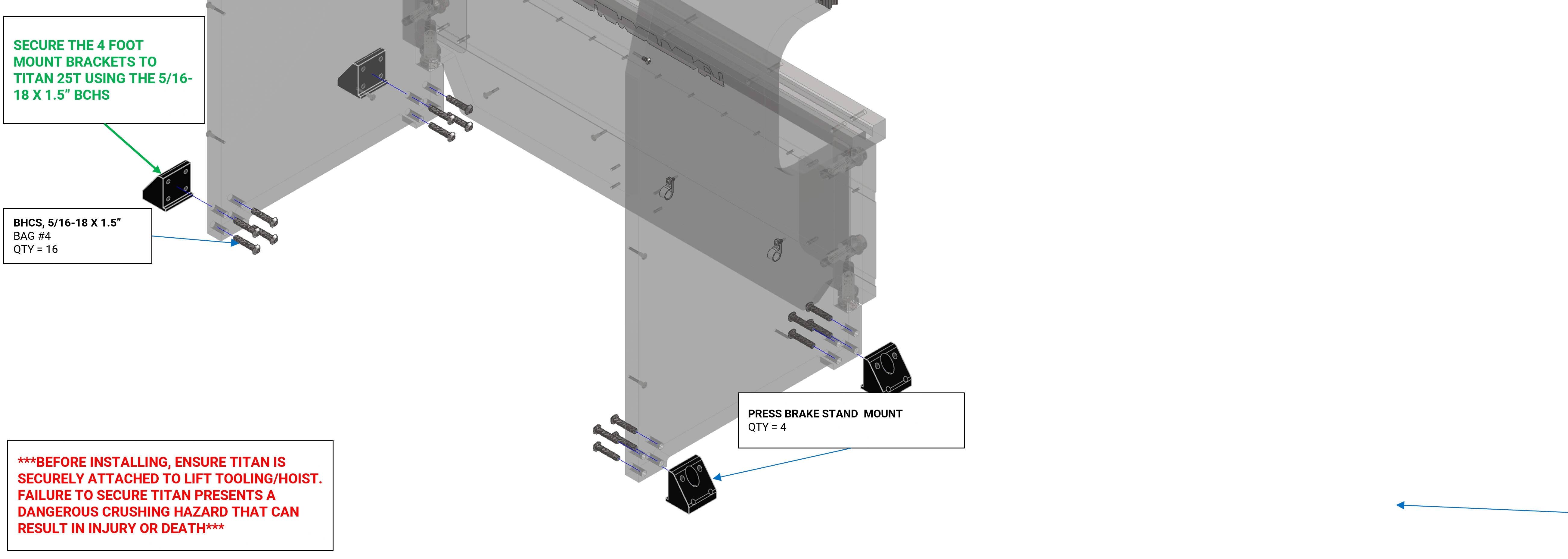

IF YOU BOUGHT AND ARE PLANNING TO INSTALL THE TITAN 25T ON TO THE PRESS BRAKE SUPPORT STAND ADD-ON, YOUR SHOP HOIST/CRANE MUST BE CAPABLE OF LIFTING THE TITAN 25T UNIT ~30 INCHES FROM THE FLOOR.

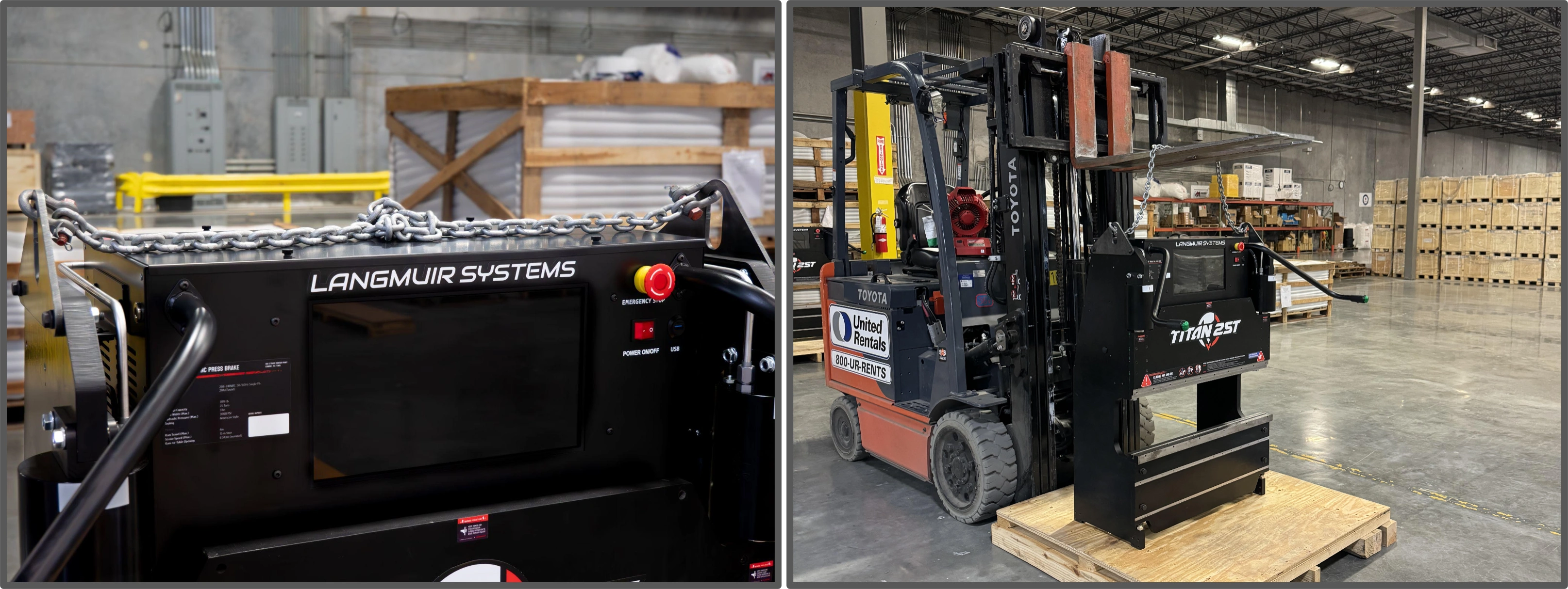

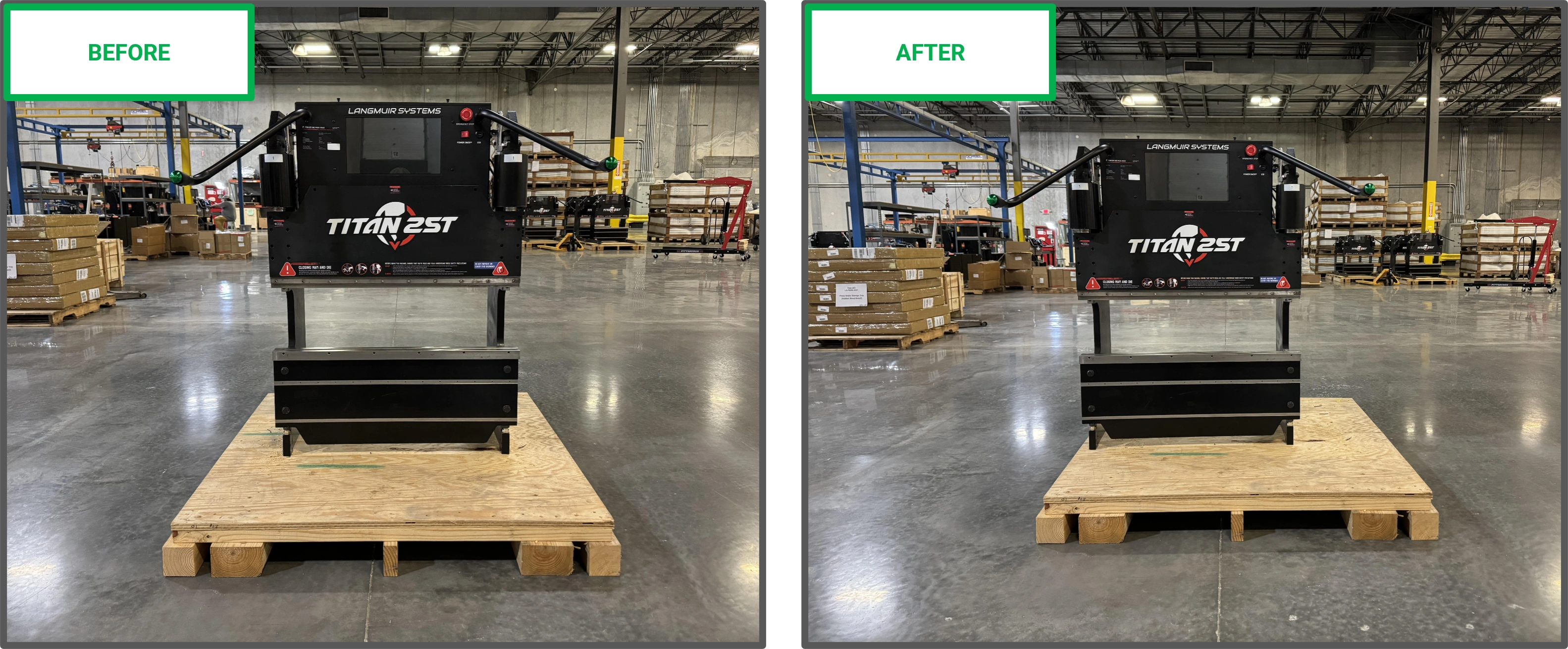

4: Maneuvering the Titan on the Pallet
Before lifting with an Engine Hoist/Shop Crane, the Titan must be maneuvered so that the Hoist can be properly positioned.
Materials
Parts
  • None
Hardware
  • None
Tools
  • Angle Grinder or Bolt Cutter
Instructions

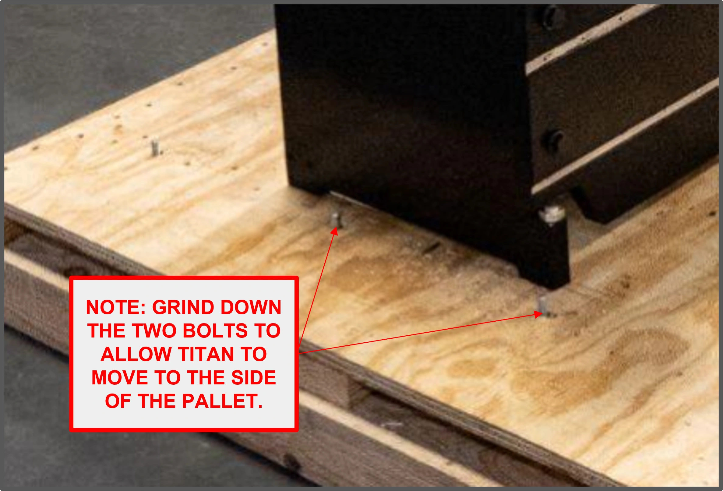

The Titan 25T can be secured to the pallet with lag bolts from the top or hex bolts from the bottom. If your Titan is secured to the pallet with hex bolts from the bottom, they will need to be removed to allow free movement of Titan across the pallet.
WARNING SYMBOL: PERSONAL PROTECTIVE EQUIPMENT
WARNING
The process of maneuvering the TITAN 25T presents various risks from material ejection, crush hazard, and pinch points. It is recommended that for all steps outlined in maneuvering the Titan 25T that eye protection, steel toe boots, and safety gloves be worn. If at any point the Titan 25T begins to tip or fall, be prepared to back away from the unit. Do NOT under any circumstances place appendages under the Titan 25T as this could lead to serious or fatal injury.
  1. Using an angle grinder, grind down the two studs protruding from the pallet shown.

Note
The Titan 25T must be moved to one side of the pallet as shown before it can be lifted with the shop hoist.

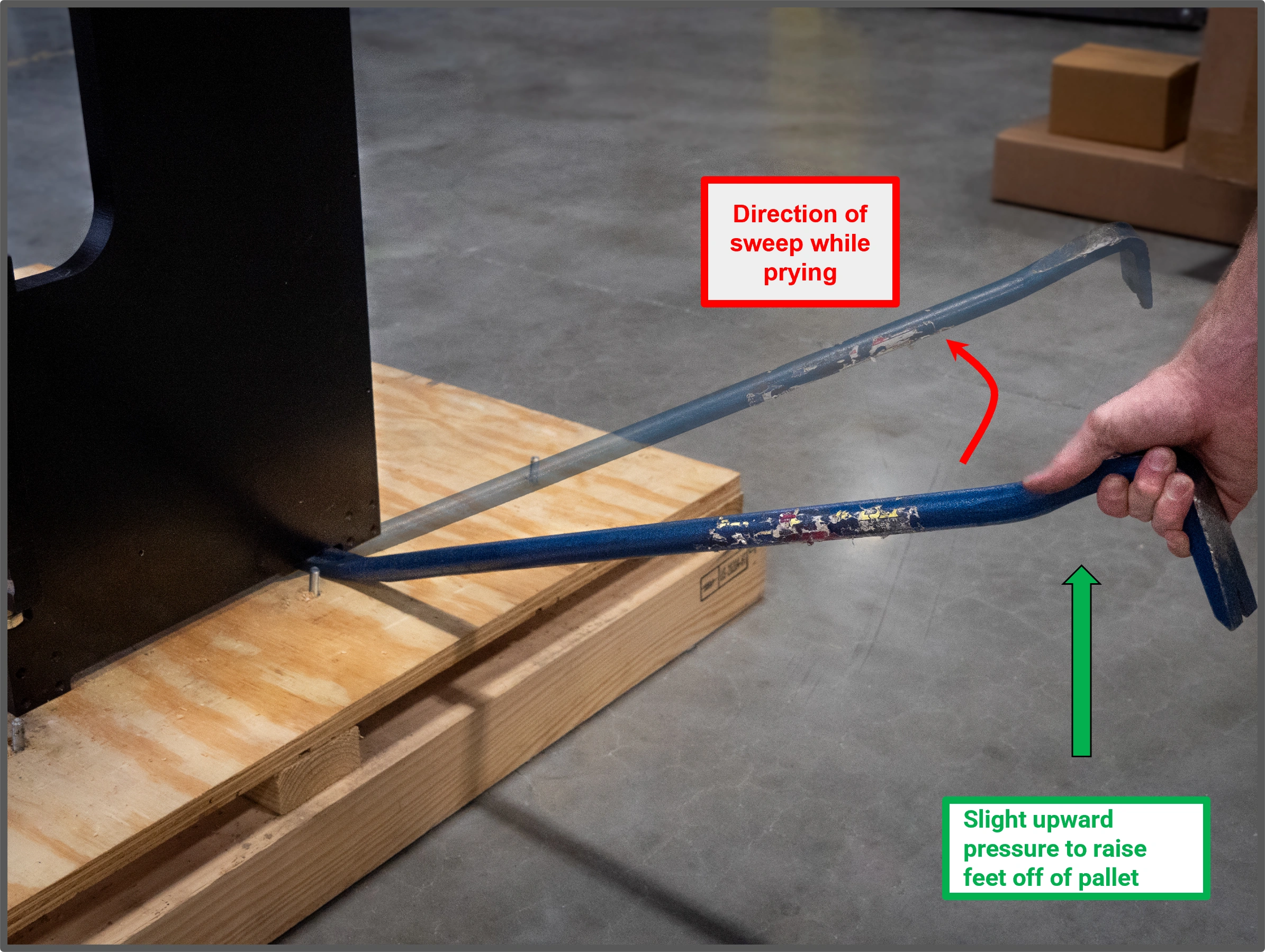

  1. Locate a pry bar to assist with maneuvering the Titan 25T. We recommend a length of 2 ft minimum for easy maneuverability.
  2. Position the end of the pry bar such that it sits in the relief between the feet of one of the uprights as shown.
  3. WARNING SYMBOL: FALLING/TIPPING HAZARD
    WARNING
    TITAN 25T CAN BE EASILY TIPPED IF NECESSARY CAUTION IS NOT TAKEN DURING PRYING. GO SLOW AND PRY IN SMALL INCREMENTS.
  4. With the pry bar positioned as shown, begin by prying Titan slightly off the pallet (~0.125”) until both feet are raised up.
  5. Next, sweep the pry bar to the right such that Titan moves in an arced path. If done correctly, the foot closest to the pry bar should now be closer to the far end of the pallet and Titan will be sitting at an angle on the pallet.
  6. On the same side of the unit, position the pry bar next to the opposite foot and repeat the process outlined in steps B2-B4, but sweep the pry bar in the opposite direction.
Materials
Parts
Hardware
Tools
  • Pry Bar (24in+ Recommended)
Instructions
    Note
    Providing slight forward pressure to the top of the unit as shown will provide some forward momentum to aide in walking the Titan Unit.
  1. Continue to pry and walk the Titan until the upright closest to the pallet’s perimeter is within 1.5”- 2” from the edge.

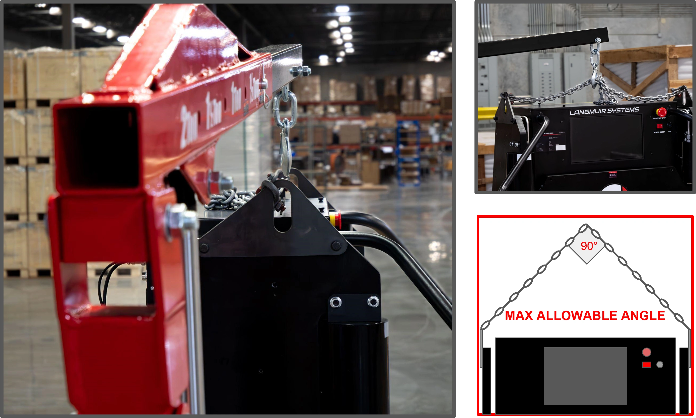

5: Lifting with a Shop Crane/Engine Hoist
The next step is to utilize your shop crane to access the final lift point.
Materials
Parts
  • (1) Titan Lift Plate (Optional Purchase)
Hardware
  • (2) 5/16 x 1 ¾ Hex Head Flange Bolts
  • (2) 5/16 Flange Nuts
Tools
  • Shop Crane/Engine Hoist
  • Pry Bar
Instructions
Note
IF YOU HAVE NOT ALREADY ATTACHED THE TITAN LIFT PLATES TO THE DESIGNATED LIFT POINTS, DO SO NOW.
INFO
If you did not purchase the Titan Lift Plate Kit, substitute lifting equipment should provide a hook point that is positioned approximately 3.5” back from the screen side of the electronics enclosure.
WARNING SYMBOL: LIFTING EQUIPMENT
WARNING
Ensure that your shop crane/hoist is rated for AND adjusted to support a 1000 lb load. Failure to use and adjust properly rated lifting equipment can result in serious injury or death.
  1. With the Lift Plate or Substitute lifting equipment in place, position the hook of your shop crane so that the hook can be attached to the lift plate as shown.
  2. Lift the side of the Titan approximately 0.125” off the pallet. The majority of Titan’s weight will still be supported by the pallet on the other side of the unit.
  3. Next, using the same pry bar method to walk the Titan 25T to the edge of the pallet in the maneuvering step, begin walking Titan off of the pallet. You will need to pry and then move the shop hoist backwards to walk the Titan off of the pallet.
  4. Continue to walk the Titan 25T until the feet still on the pallet approach the edge of the plywood surface.
WARNING
Be extremely careful as Titan approaches the edge of the pallet and ensure enough buffer is provided to prevent Titan from falling off of the pallet.

  1. Using blocking material, fill the void under the Titan 25T that is suspended in air as shown. Blocking material should be approximately 5 ¾” tall to maintain a surface even with the top of the pallet.
  2. Slowly lower the suspended Titan 25T until the full weight of the unit is distributed between the blocking material and the pallet.
  3. Remove the Shop Crane/Hoist from the hook point.
Materials
Parts
Hardware
  • 9/32 Trade Size Lifting Chain
  • (Optional) Chain Shackles
Tools
  • (1) Shop Crane/Engine Hoist
Instructions
  1. Span the lifting chain between the slots found on the Titan Lift Plates.
  2. Note 1
    YOUR CHAIN MAY VARY IN LENGTH SO LONG AS THE HOOK POINT DOES NOT EXCEED A 90 DEGREE ANGLE AS SHOWN. AN ANGLE GREATER THAN 90 DEGREES CAN PUT DAMAGING LOADS INTO THE TITAN FRAME.
    Note 2
    IF YOU REQUIRE MORE LIFT HEIGHT (SUCH AS TO LOAD TITAN ONTO THE STAND), A SPREADER BAR WITH SUFFICIENT LOAD CAPACITY MAY BE USED.
  3. Reposition your shop crane such that the hook point rest at the midpoint of your chain span as shown and connect the chain to the hook.
  4. Lift your Titan 25T fully off of the pallet.
WARNING SYMBOL: CRUSH HAZARD
WARNING
Do NOT under any circumstances place any appendage or part of your body beneath the TITAN 25T while it is suspended in air. Failure to adhere to safe lifting practices can result in fatal injury or death.
Materials
Parts
  • None
Hardware
  • None
Tools
Instructions
FLAG SYMBOL

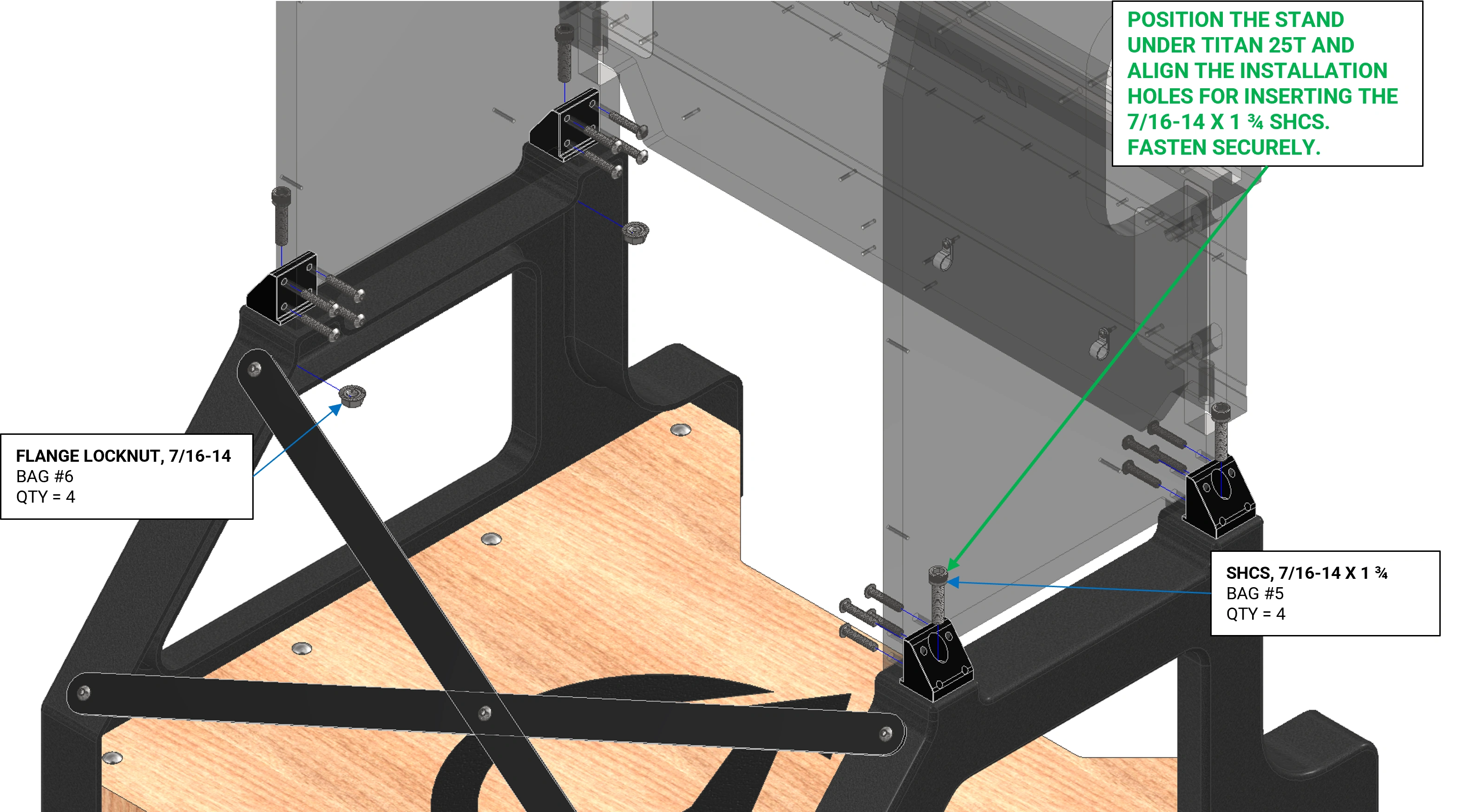

IF YOU PURCHASED THE TITAN 25T SUPPORT STAND ADD-ON, SEE THE PRESS BRAKE STAND ASSEMBLY GUIDE →
  1. With Titan off the pallet, you may position the unit in your shop where desirable.

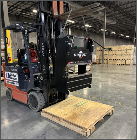

6: Lifting with a Forklift
The next step is to prepare and lift the Titan 25T with a forklift.
Materials
Parts
  • (2) Titan Lift Plate (Optional Purchase)
Hardware
  • 9/32 Trade Size Lifting Chain (4ft Length)
Tools
Instructions
FLAG SYMBOL
IF YOU ARE LIFTING WITH A FORKLIFT, PROCEED TO THE NEXT STEP. OTHERWISE, SKIP IT →
NOTE
THE SPAN OF CHAIN NECESSARY FOR LIFTING TITAN MAY VARY BASED ON THE SPECIFICATIONS OF YOUR FORKLIFT AND FORKS.
  1. Span the lifting chain between the slots found on the Titan Lift Plates or between the 5/16-18 Bolts with oversized washer.
  2. Prior to lifting, ensure the chain is in line with the slot features of the Titan Lift Plate or ~3.5” back from the screen side of the electronic enclosure as shown.
  3. Begin lifting Titan 25T off of the pallet.
WARNING
Materials
Parts
Hardware
Tools
Instructions
FLAG SYMBOL
  1. With Titan off of the pallet, you may position the unit in your shop where desirable.

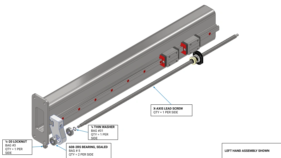

Material Tray Support Assembly Guide
Images in this Guide
The assembly drawings and pictures included in this guide can be expanded to full-screen and zoomed to provide more detail on a given step.

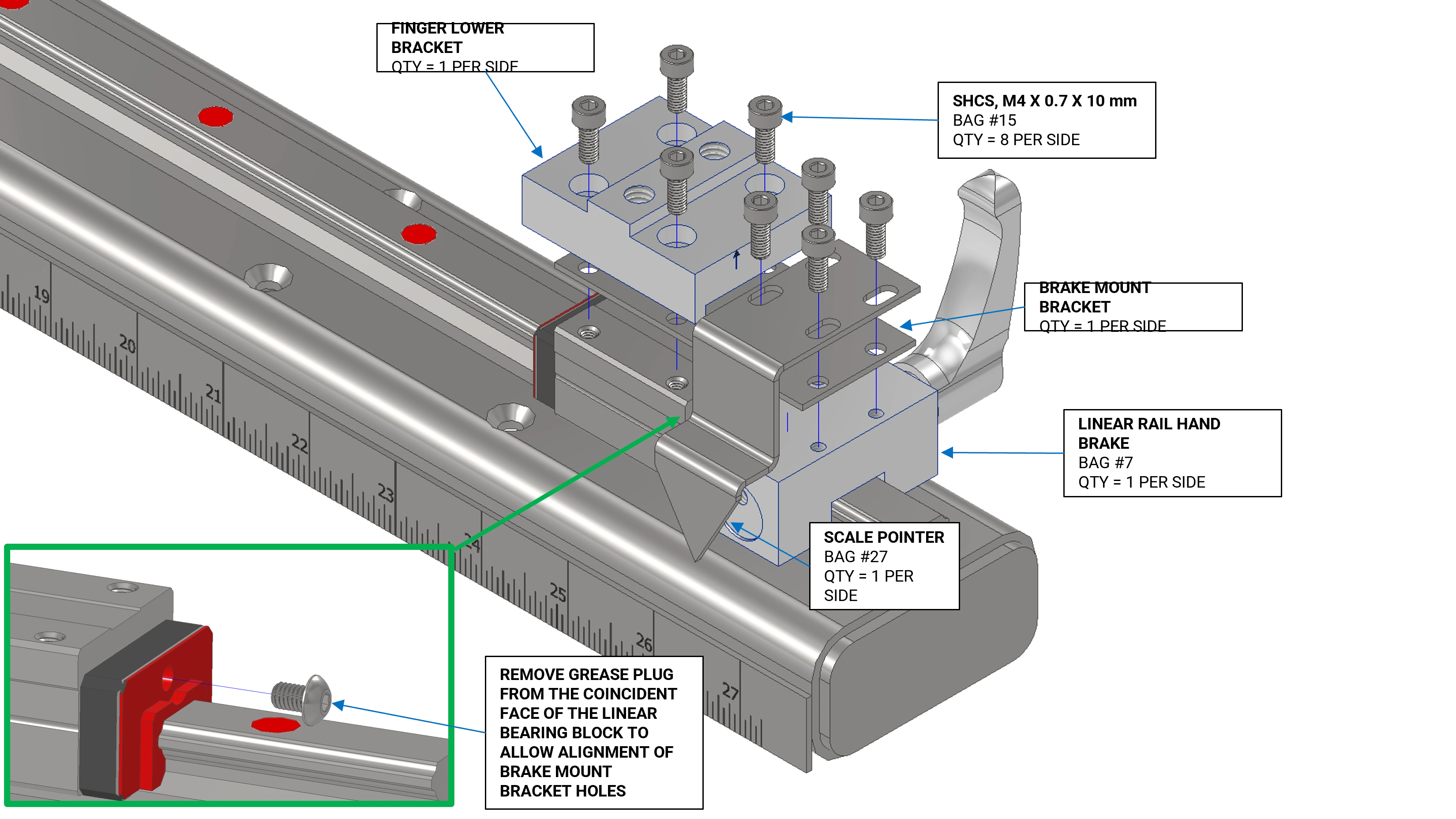

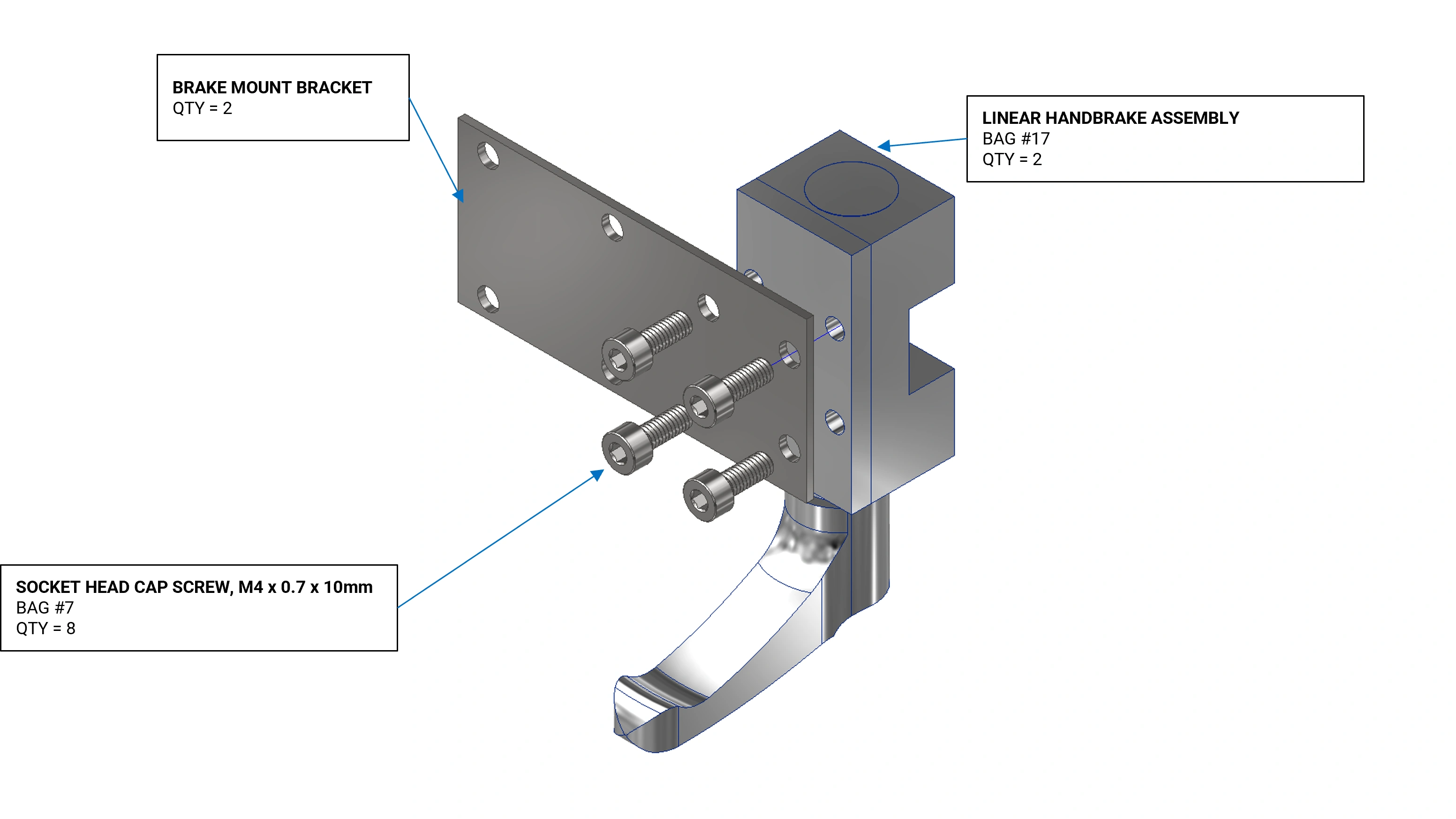

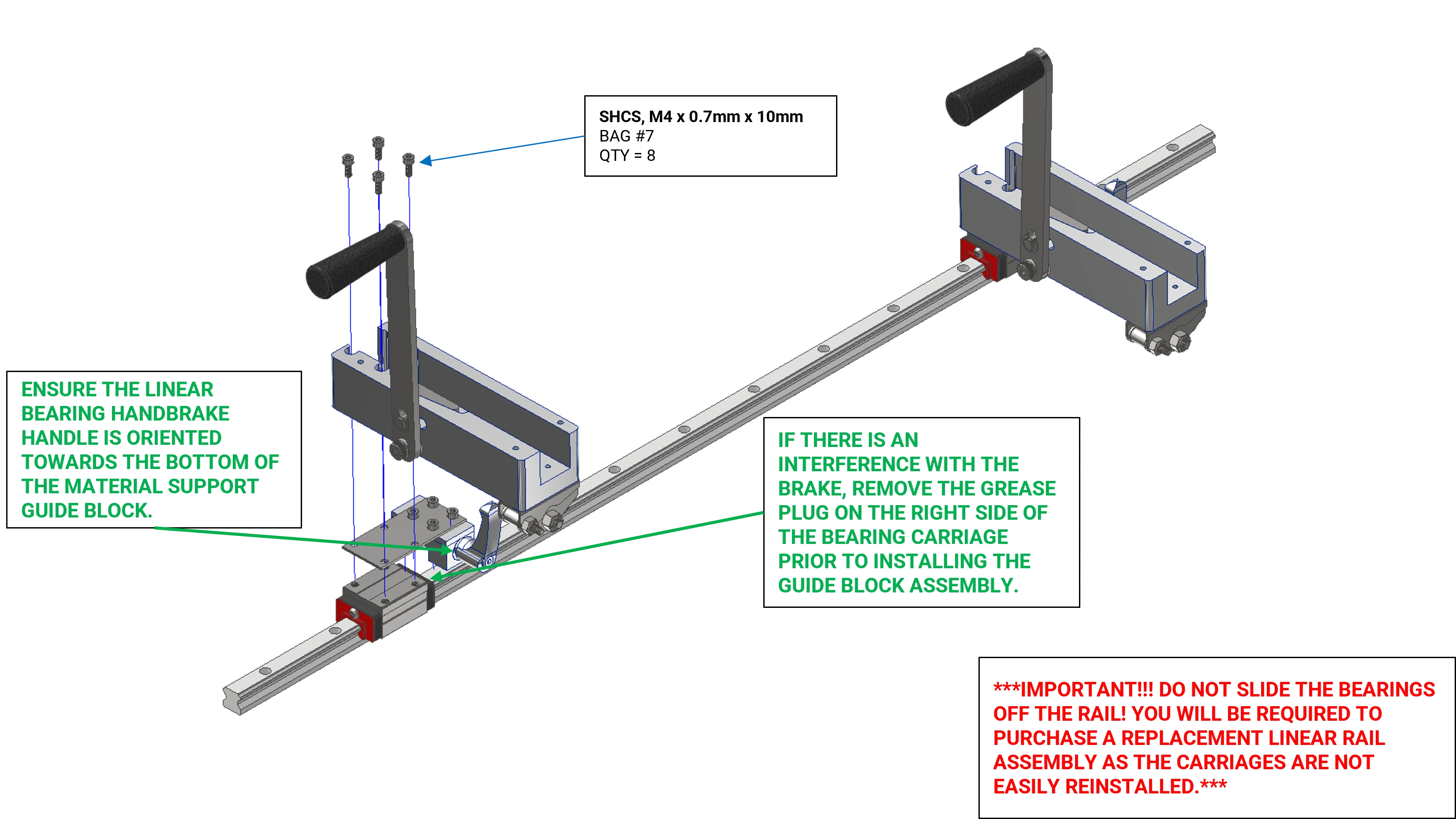

1: Preparing The Handbrakes
The first step is to mate the linear brakes with the brake mount brackets.
Materials
Parts
  • (2) Linear Rail Handbrake
  • (2) Brake Mount Bracket
Hardware
  • Socket Head Cap Screw, M4 x 0.7mm x 10mm
Tools
  • 3 mm Hex Key
Instructions
  1. Locate both Linear Rail Hand Brake Assembly and Brake Mount Brackets.
  2. Orient the Hand Brakes such that the lever faces down and the brake mount bracket extends to the left of the handbrake.
  3. Using the fasteners shown, loosely secure the brake mount bracket to the linear handbrake.
  4. Set aside for later use.

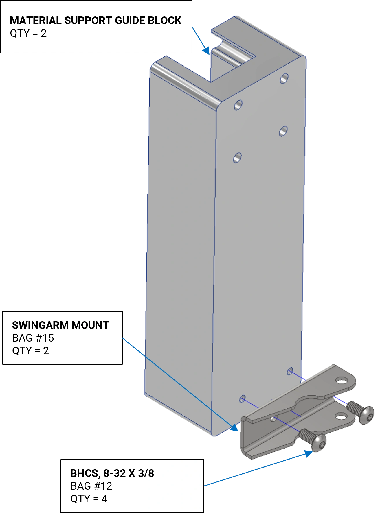

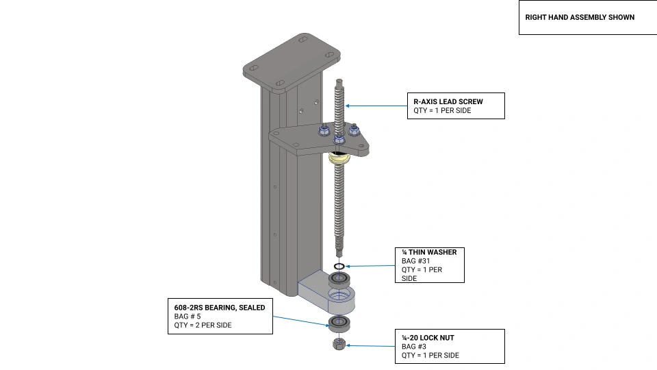

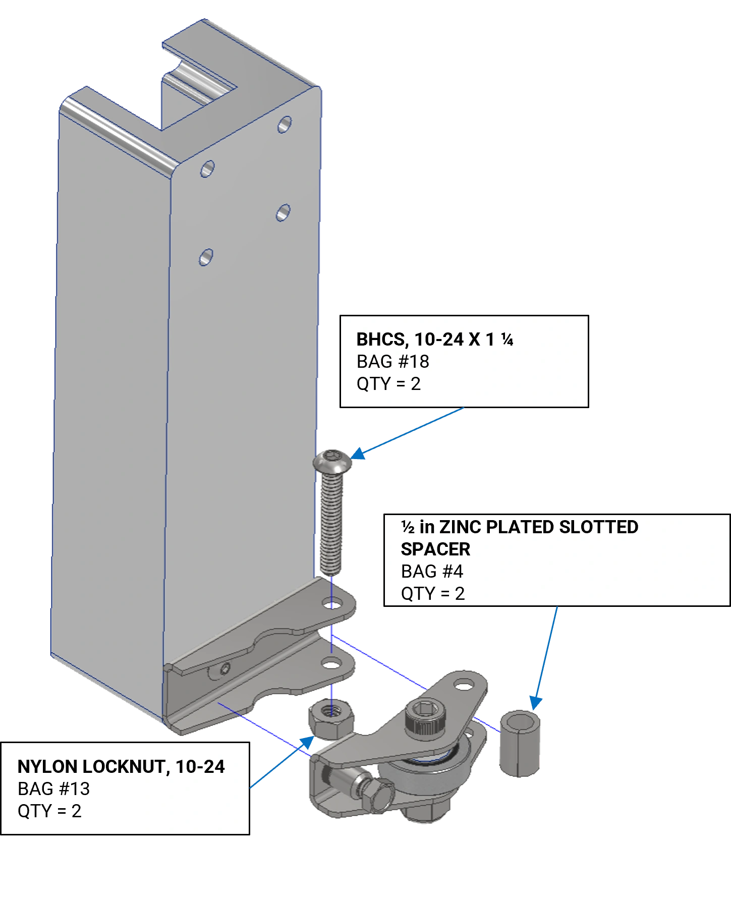

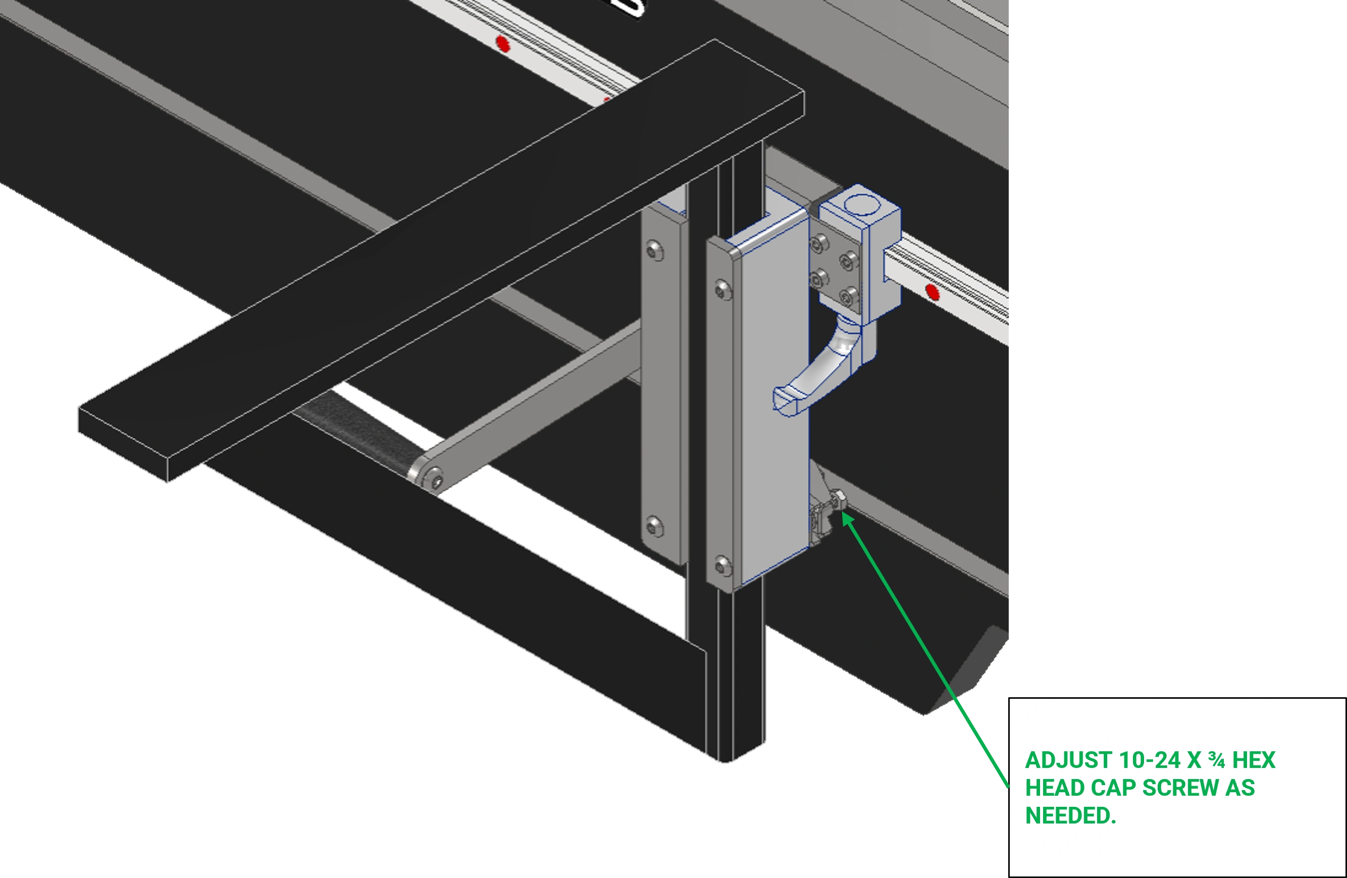

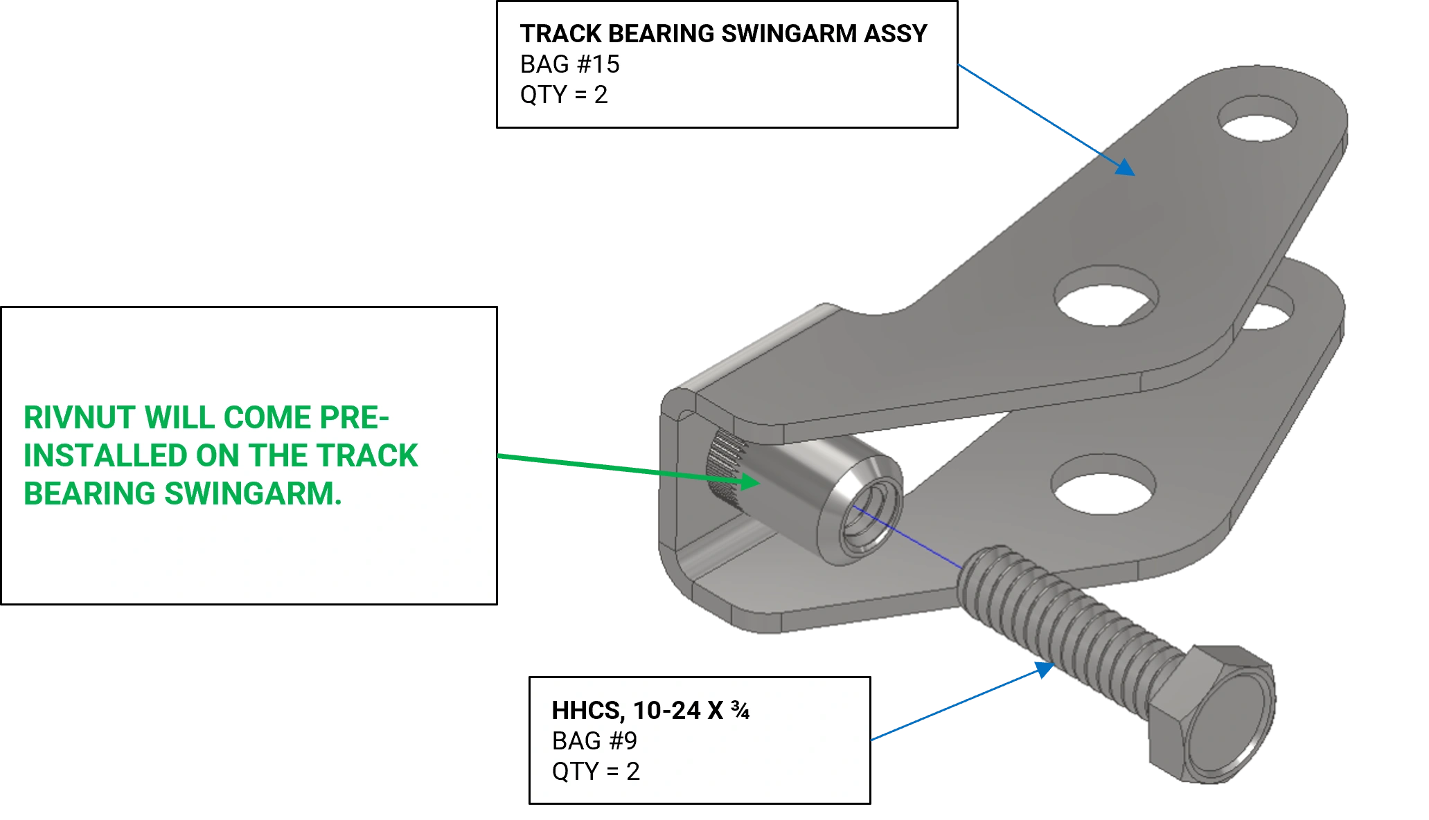

2: Swingarm Assembly
The next step in the assembly process is to assemble the guide block swingarms.
Materials
Parts
  • (2) Track Bearing Swingarm Assembly
Hardware
  • (2) Hex Head Cap Screw, 10-24 x ¾
Tools
  • None
Instructions
  1. Locate a Track Bearing Swingarm Assembly.
  2. Install the 10-24 x ¾ Hex Head Cap Screw into the pre-installed rivnut until the fastener protrudes slightly out the back of the rivnut. This screw will be adjusted later.
  3. Repeat steps A1 & A2 for the remaining Track Bearing Swingarm Assembly.

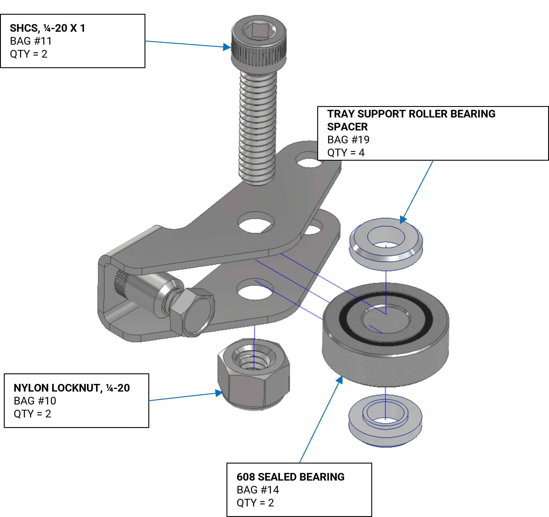

Materials
Parts
  • (4) Tray Support Roller Bearing Spacer
  • (2) 608 Sealed Bearing
Hardware
  • (2) Socket Head Cap Screw, ¼-20 x 1
  • (2) Nylon Locknut, ¼-20
Tools
  • 3/16 Hex Key
  • 7/16 Box End Wrench
Instructions
  1. Locate 1x 608 Sealed Bearing.
  2. Install a Tray Support Roller Bearing Spacer on both sides of the sealed bearing and insert between the flanges of the Track Bearing Swingarm Assembly.
  3. Install the ¼-20 x 1 Socket Head Cap Screw through the Center bores of the track bearing swingarm assembly, bearing spacers, and bearing.
  4. Loosely secure the bearing in place with the ¼-20 nylon lock nut using the 3/16 Hex Key and 7/16 box end wrench. Do not tighten these fasteners. Tightening will be done in a later step.
  5. Repeat Steps B1 through B4 for the remaining Track Bearing Swingarm Assembly.
3: Mounting The Swingarms
The next step is to mount the swingarms to the guide blocks.
Materials
Parts
  • (2) Material Support Guide Block
  • (2) Swingarm Mount
Hardware
  • (4) Button Head Cap Screw, 8-32 x 3/8
Tools
  • 3/32 Hex Key
Instructions
  1. Locate the Material Support Guide Block and Swingarm Mount.
  2. Install the Swingarm Mount to the threaded holes located on the back of the Material Support Guide Block using the fasteners shown.
  3. Repeat steps A1 and A2 for the remaining Material Support Guide Block.
Materials
Parts
  • Track Bearing Swing Arm Assembly (Previously Assembled)
Hardware
  • (2) Button Head Cap Screw, 10-24 x 1 ¼
  • (2) Nylon Locknut, 10-24
  • (2) ½ in Zinc Plated Slotted Spacer
Tools
  • ⅛ Hex Key
  • ⅜ Box End Wrench
Instructions
  1. Locate the ½” Zinc Plated Slotted Spacer and position it between the remaining holes in the Track Bearing Swingarm Assembly.
  2. Insert the Track Bearing Swing Arm Assembly with Slotted Spacer between the flanges of the Swingarm mount.
  3. Insert the 10-24 x 1 ¾ Button Head Cap Screw into the aligned hole locations such that the Track Bearing Swingarm Assembly can pivot about the screw.
  4. Secure the 10-24 BHCS in place using the fastener shown. Tighten the locknut until lash is removed and the swingarm can still rotate.
  5. Once the 10-24 BHCS is sufficiently tightened, you may proceed to tighten the ¼-20 SHCS that extends through the ball bearing.
  6. Repeat steps B1 through B4 on the remaining Track Bearing Swingarm Assembly.

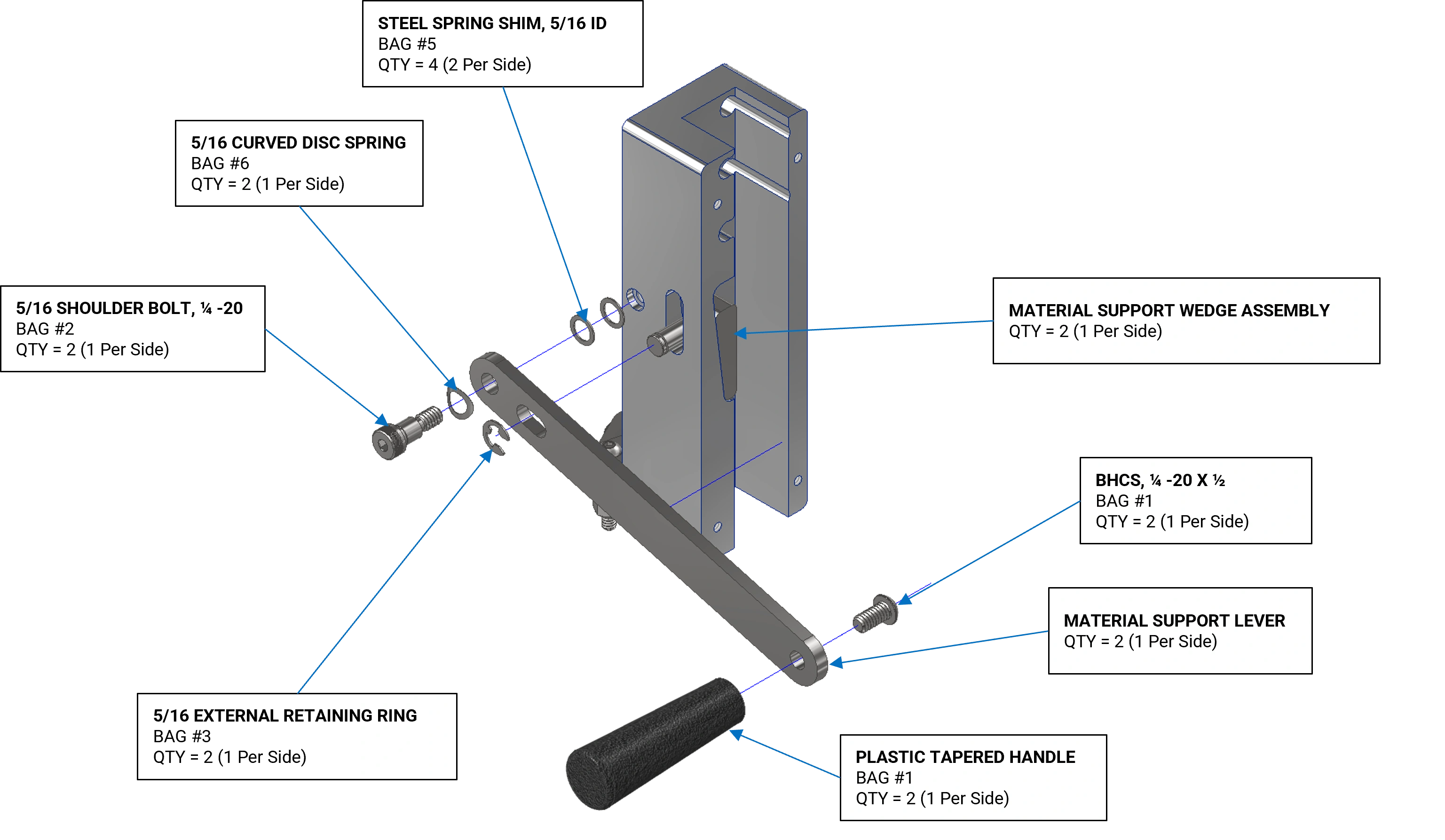

4: Lever Actuator Assembly
The next step is to assemble and install the material support lever.
Materials
Parts
  • (2) Material Support Wedge Assembly
Hardware
  • None
Tools
  • None
Instructions

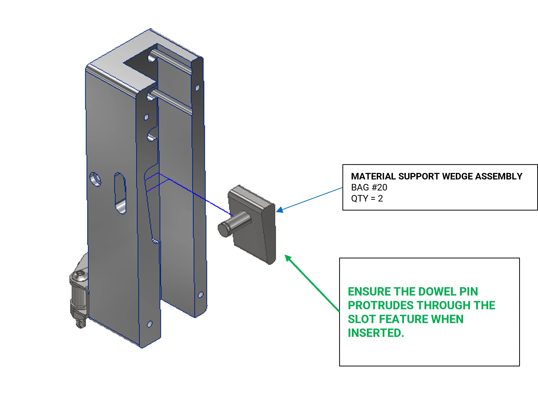

  1. Insert the Material Support Wedge Assembly Into the angled slot located on the material tray guide block so that the dowel pin protrudes from the slot feature.
  2. Repeat A1 for remaining Material Support Wedge.
Materials
Parts
  • (2) Material Support Lever
  • (2) Plastic Tapered Handle
  • (2) Material Support Wedge Assembly (Previously Assembled)
Hardware
  • (4) Spring Steel Shim, 5/16 ID
  • (2) 5/16 Curved Disc Spring
  • (2) 5/16 Shoulder Bolt, ¼-20
  • (2) 5/16 External Retaining Ring
  • (2) Button Head Cap Screw, ¼-20 x ½
Tools
  • 5/32 Hex Key
  • Needle nose pliers (Optional)
Instructions
  1. Locate the Material Support Lever.
  2. Install the Material Support Lever with the ¼-20 shoulder screw and 5/16th Curved Disc Spring shown. Ensure the 2 Steel Spring Shims ,5/16 ID are placed between the Material Support Lever and the Material Support Guide Block. Do not overtighten the screw as the handle should still move with slight resistance.
  3. Align the Material Support Lever slot feature with the 5/16th dowel pin on the Material Support Wedge Assembly. Insert the 5/16 Dowel pin through the slot and secure in place with the External Retaining Ring.
  4. Install the plastic tapered handle using the fasteners shown such that the handle is located on the left hand side of the Material Support Lever.
  5. Repeat steps B1 through B4 for the remaining Guide block assembly.

  • (2) Linear Handbrakes with Brake Mount Brackets (Previously Assembled)
Hardware
  • (8) Socket Head Cap Screw, M4 x 0.7mm x 10mm
Tools
  • 3mm Hex Key
  • 2.5mm Hex Key
Instructions
  1. Locate the Material Support Bracket Linear Bearing Assembly and remove zip ties running through railing holes.
  2. Warning Symbol: LINEAR RAIL BEARINGS
    Important Note
    Do not either deliberately or accidentally remove the linear bearings from the linear rail. It is nearly impossible without specialized tools to reinstall a linear bearing once removed. The replacement cost of the linear rail assembly will not be covered by warranty.
  3. Locate both Linear Handbrake Assemblies with Brake Mount Brackets attached.
  4. Note
    IF THE LINEAR HANDBRAKE’S PROXIMITY TO THE BEARING CARRIAGE HAS INTERFERENCE, IT MAY BE NECESSARY TO REMOVE THE GREASE PLUG LOCATED ON THE RIGHT SIDE OF THE BEARING CARRIAGES FOR PROPER FIT AND FUNCTION OF THE HANDBRAKES. THIS PLUG CAN BE LEFT OPEN OR THE FASTENER MAY BE REPLACED WITH A M4 X 0.7 mm X 6 mm SET SCREW.
  5. Ensure that the Brake Mount Bracket is located between the linear bearings and guide block assemblies.
  6. Install both Guide Block Assemblies to the linear bearings using the fasteners shown.
  7. Once fastened to the linear bearing, tighten the M4 x 0.7 x 10mm screws that secure the linear handbrakes to the brake mount bracket.

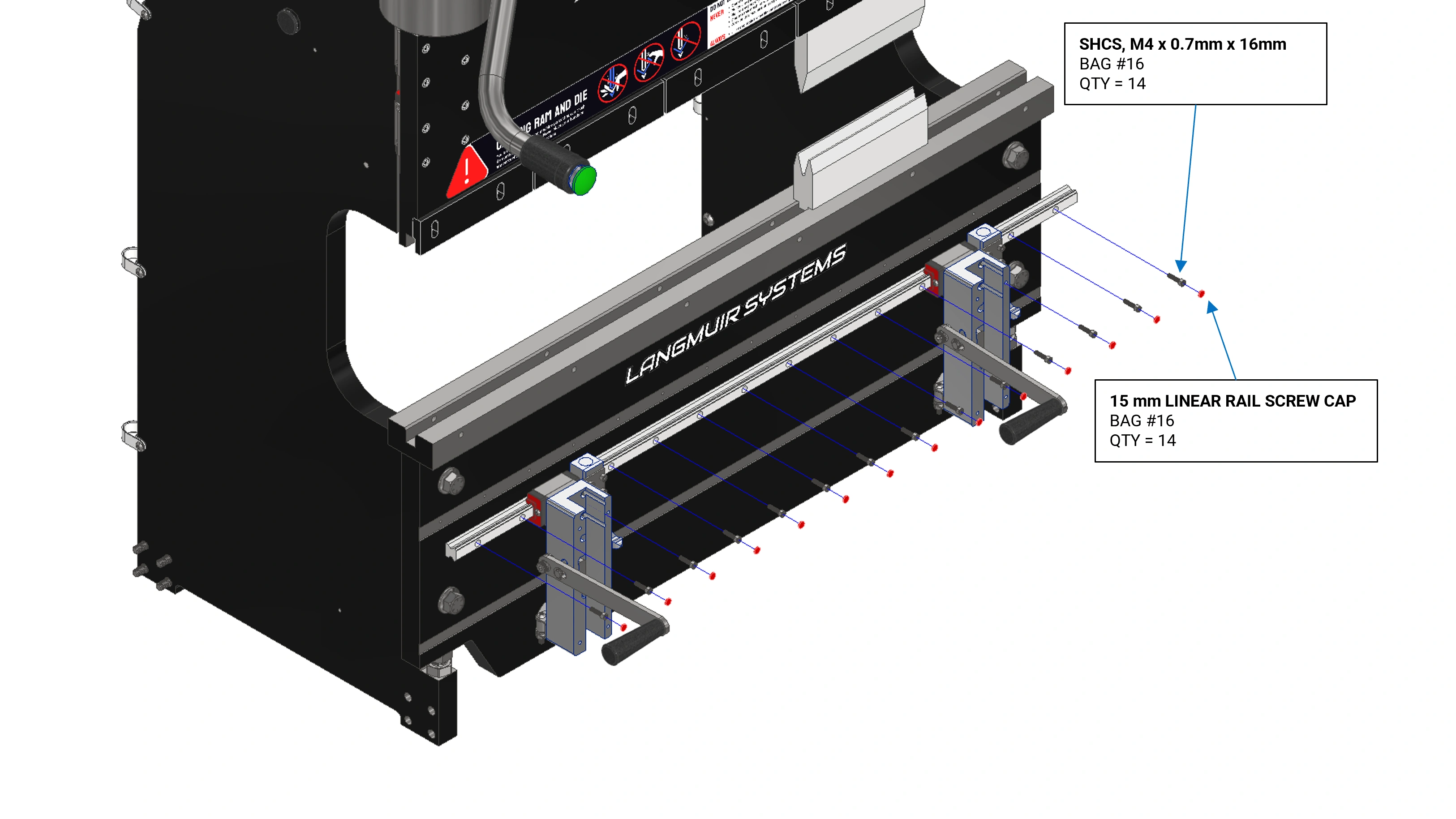

6: Mounting The Linear Bearing Assembly
The next step is to install the Linear bearing on to the Titan.
Materials
Parts
  • (1) MATERIAL SUPPORT BRACKET LINEAR BEARING ASSY (Previously Assembled)
Hardware
  • (14) SOCKET HEAD CAP SCREW, M4 x 0.7mm x 16mm
  • (14) 15 mm LINEAR RAIL SCREW CAP
Tools
  • 3mm Hex Key
  • Small Hammer/Mallet
Instructions
  1. Thoroughly clean the mounting surfaces on the front surfaces of the table as well as the bottom surface of the linear rails.
  2. Install and tighten the Material Support Bracket Linear Rail using the fasteners shown.
  3. Using a small mallet/hammer, lightly tap one mounting hole cap into each mounting hole. The goal is to only insert the cap until it is flush to the surface of the linear rail. Verify that each linear bearing can glide across the mounting holes without resistance.

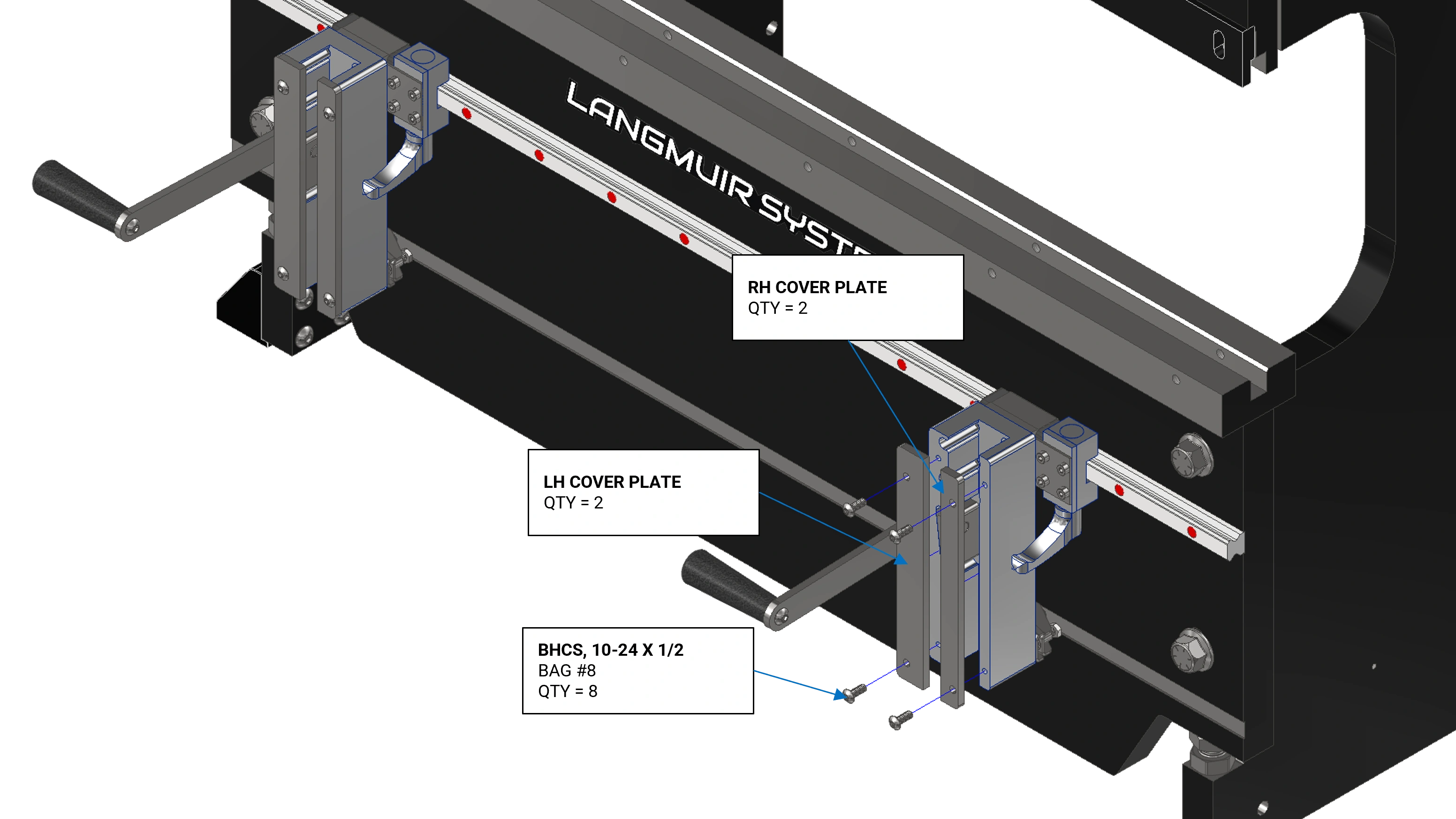

7: Installing The Cover Plates
The next step is to install the guide block covers and connect to the handbrakes.
Materials
Parts
  • (2) RH Cover Plate
  • (2) LH Cover Plate
Hardware
  • (8) Button Head Cap Screw, 10-24 x ½
Tools
  • ⅛ Hex Key
Instructions
  1. Locate the LH Cover Plate and the RH Cover Plate.
  2. Install both cover plates on both guide block assemblies using the fasteners shown.
8: Insert the Material Tray Weldments
The next step in the assembly process is to insert the tray weldments.
Materials
Parts
  • (2) Support Bracket Weldment
Hardware
  • None
Tools
  • None
Instructions
  1. Using the installed Material Support Lever, pull up to disengage the Material Support Wedge Assembly.
  2. With the Material Support Wedge disengaged, feed the Square tubing end of the Support Bracket Weldment into the guide block from the top face. Repeat for both sides.
  3. Ensure the assembled support tray is functional by adjusting the height of the Support Bracket Weldments and locking it into place actuating the Material Support Lever.
Note
SQUARE TUBING OF THE SUPPORT BRACKET WELDMENTS CAN BE LIGHTLY GREASED IF NEEDED FOR FREE ACTION.
Note
IF YOUR PROJECT REQUIRES ADDITIONAL CLEARANCE, THE SUPPORT BRACKET WELDMENTS CAN BE REMOVED AND STORED AS NEEDED.
9: Adjusting The Swingarm
The final step in the assembly process is to adjust the Track Bearing Swingarm.
Materials
Parts
  • None
Hardware
  • None
Tools
  • 5/16” Box End Wrench
Instructions
  1. Using a 5/16” Box End Wrench, adjust the bolt on the track bearing swingarm until the roller bearing makes contact against the machined channel, then rotate the 10-24 screw an additional whole rotation to apply ample preloading to the assembly.
  2. Repeat step A1 for both 10-24 cap screws.

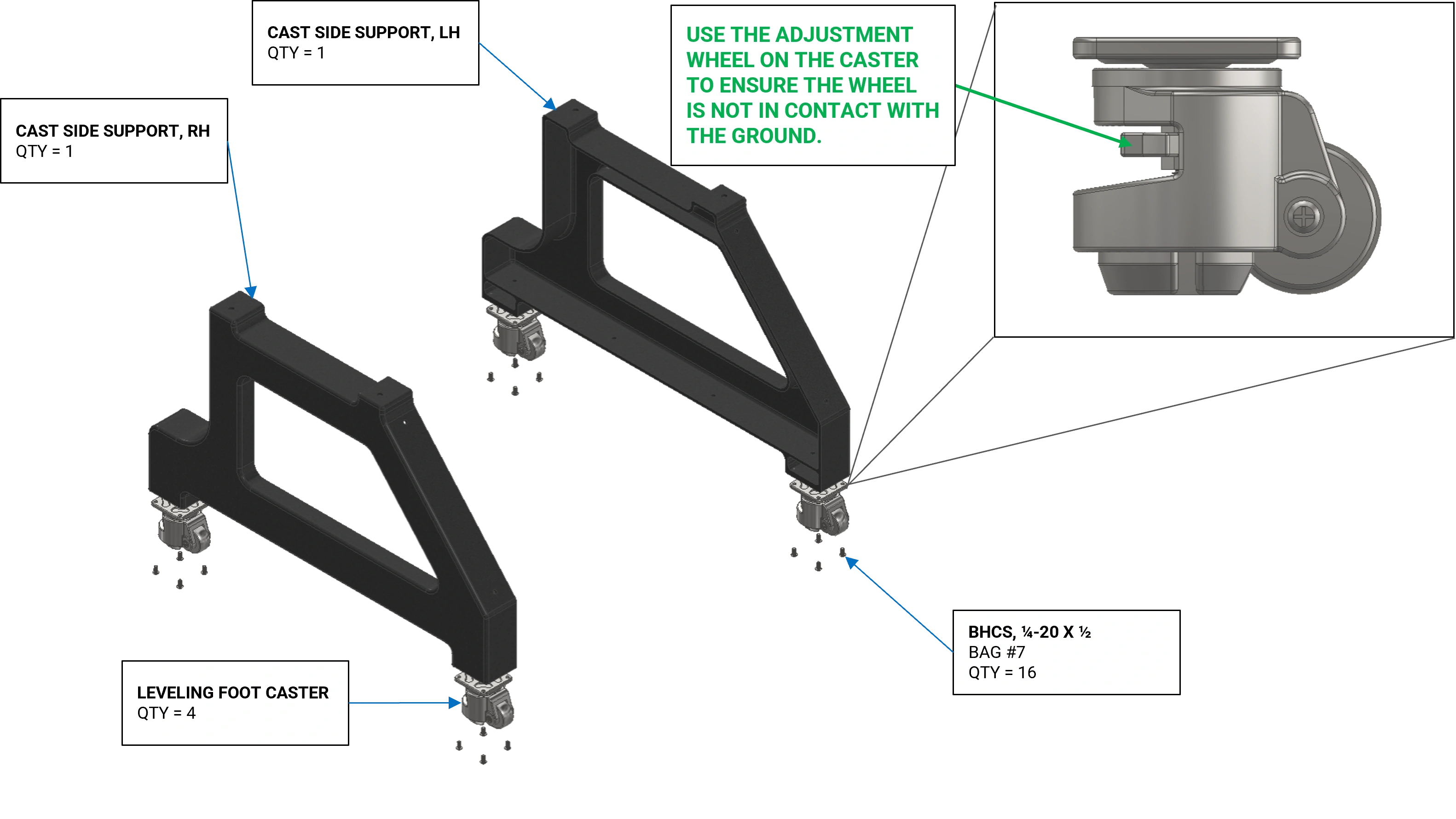

1: Leveling Casters
The first step in the assembly process is to bolt the caster wheels to the stand frame supports.
Materials
Parts
  • (1) Cast Side Support, RH
  • (1) Cast Side Support, LH
  • (4) Leveling Foot Casters
Hardware
  • (16) BUTTON HEAD CAP SCREW, ¼ -20 X ½
Tools
  • 5/32 Hex Key
Instructions
  1. Locate the Cast Side Support, RH and Cast Side Support, LH stand components as well as all 4 of the Leveling Foot Casters.
  2. Using your hand, adjust each Leveling Foot Caster such that the foot pad extends beyond the wheel and prevents rolling during assembly of the stand.
  3. Install each Leveling Foot Caster on to the bottom of the right and left Cast Side Support using the fasteners shown.

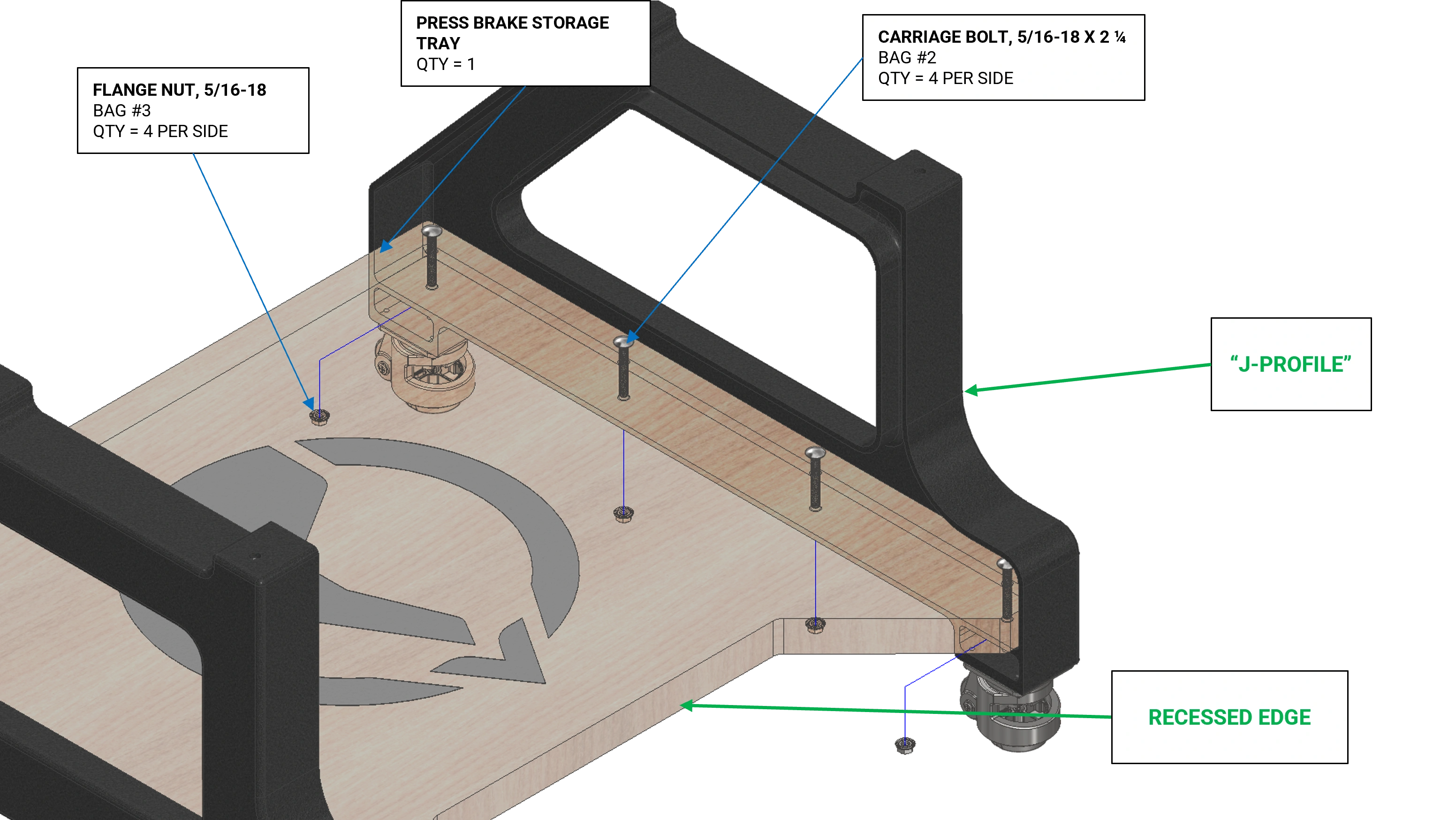

2: Material Storage Tray
Materials
Parts
  • (1) Press Brake Storage Tray
Hardware
  • (8) Carriage Bolt, 5/16-18 x 2 ½
  • (8) Flange Nut, 5/16-18
Tools
  • ½ in Socket or Box-End Wrench
Instructions
  1. Orient the Left and Right Cast Side Supports such that the “J-Profile” is on the same side as the recessed edge on the Press Brake Storage Tray.
  2. Slot the Press Brake Storage Tray into the bottom cavity of one of the Cast Side Supports.
  3. Install 4 of the 5/16-18 x 2 ½ Carriage Bolts into the pre-drilled holes and fasten with 5/16-18 flange nut. Do not tighten the bolts. Leave all bolts loose until the Titan 25T is fully mounted.
  4. Repeat steps A2 & A3 for the remaining Cast Side Support.

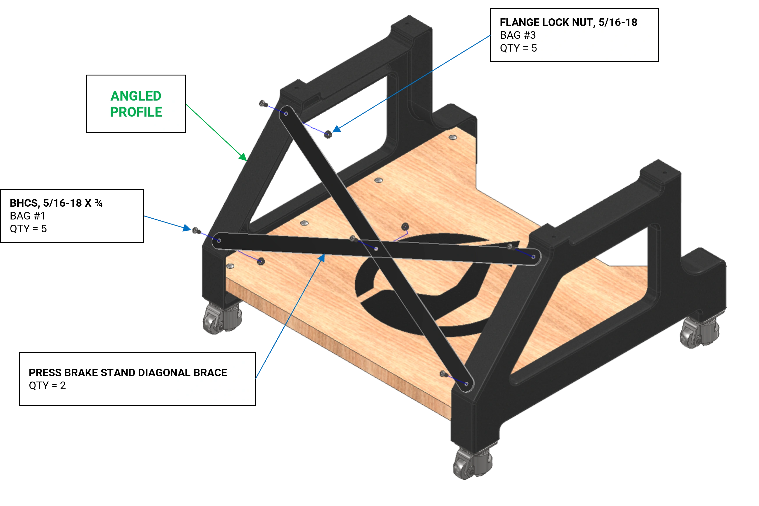

3: Diagonal Brace
The next step is to install the diagonal bracing on the back of the stand.
Materials
Parts
  • (2) Press Brake Stand Diagonal Brace
Hardware
  • (5) BUTTON HEAD CAP SCREW, 5/16-18 X ¾
  • (5) FLANGE LOCK NUT, 5/16-18
Tools
  • 3/16 Hex Key
  • ½ Box-End Wrench
Instructions
  1. Locate both Press Brake Stand Diagonal Braces.
  2. Using the fasteners shown, install the diagonal bracing in an X-pattern across the angled profile of the Cast Supports. Do not tighten any bolts. Nuts should be threaded on but left loose.
  3. Insert and loosely fasten the final fastener at the intersection of the bracing.
4: Mounting to the Titan 25T
The next step of the assembly process is to attach the frame to your unit using the provided foot mounts.
Materials
Parts
  • (1) Suspended Titan 25T
  • (4) Press Brake Stand Mount
Hardware
  • (16) BUTTON HEAD CAP SCREW, 5/16-18 x 1.5”
Tools
  • 3/16 Hex Key
Instructions
FLAG SYMBOL
BEFORE PREPARING TO ATTACH THE STAND OR STAND MOUNTS, FOLLOW THE OUTLINED PROCEDURES FOR LIFTING THE TITAN 25T FOUND IN THE UNCRATING GUIDE HERE
  1. While the TITAN is suspended in the air, locate the 4 Press Brake Stand Mounts and install them to the TITAN 25T using the 5/16-18 x 1.5” BHCS fasteners shown.
Materials
Parts
  • (1) Press Brake Stand (Previously Assembled)
Hardware
  • (4) SOCKET HEAD CAP SCREW, 7/16-14 x 1 ¾ “
  • (4) FLANGE LOCK NUT, 7/16-14”
Tools
  • ⅜ Hex Key
  • 11/16 Box End Wrench
Instructions
  1. With casters adjusted to free roll, position the assembled Press Brake Stand beneath the unit.
  2. Once in position, slowly lower the TITAN 25T until the foot mounts are resting on the stand with nearly the full weight still suspended by your lifting equipment.
  3. Using the 7/16-14 x 1 ¾ SHCS shown, attach the Press Brake Stand Mount to the stand.
  4. Note
    YOU MAY NEED TO MANIPULATE THE STAND TO OVERCOME FASTENER CLEARANCES SO THAT THE 7/16-14 SHCS ALIGN WITH THE MOUNTING HOLES.
  5. Once aligned, fully tighten and secure the stand to the Titan 25T.
  6. With the TITAN 25T securely mounted to the stand, Fully tighten and secure all fasteners left loose during previous stand assembly steps.
  7. Lower the Titan 25T such that the full weight of the Unit rests upon the stand. Remove any and all lifting equipment utilized.

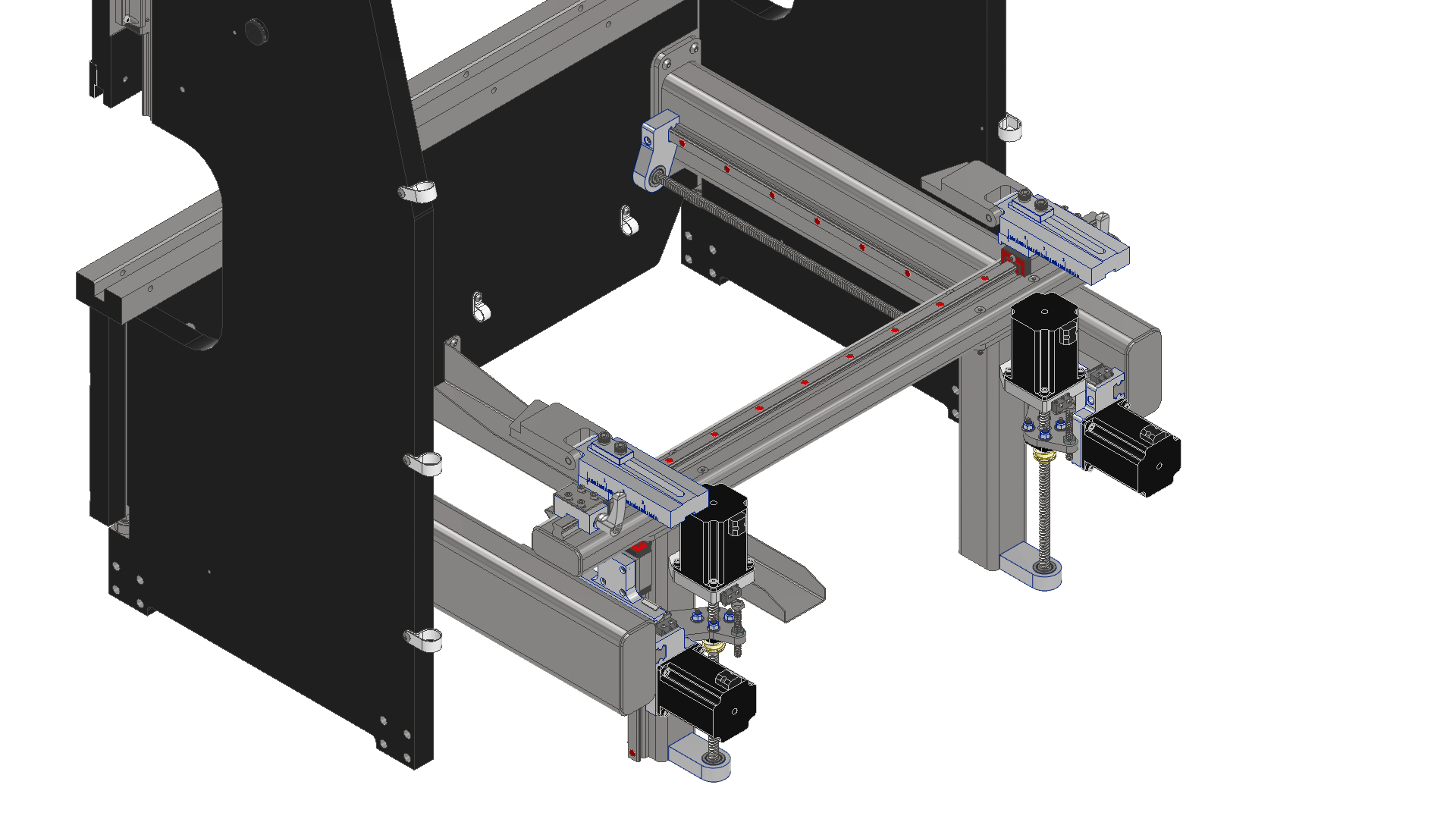

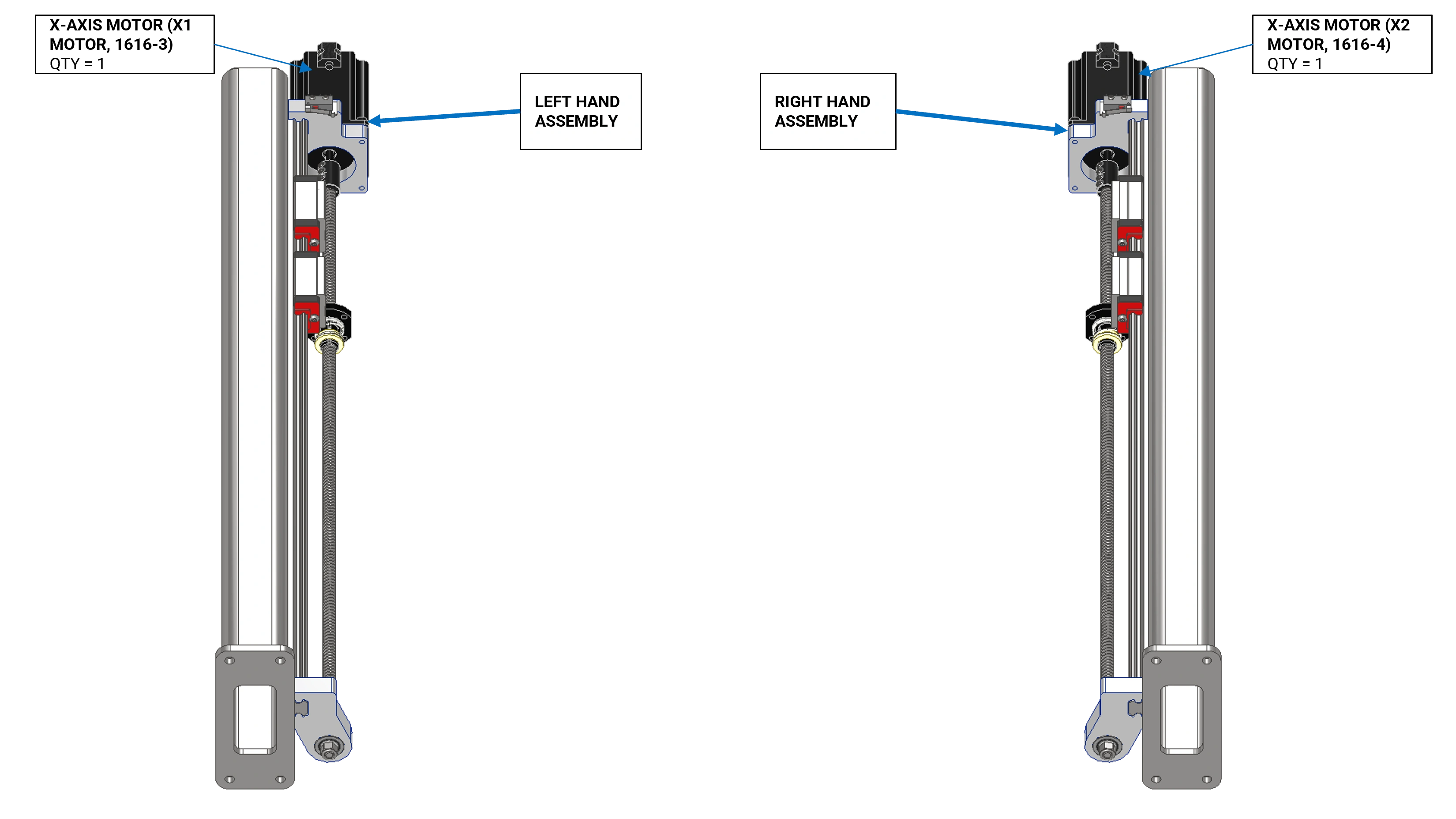

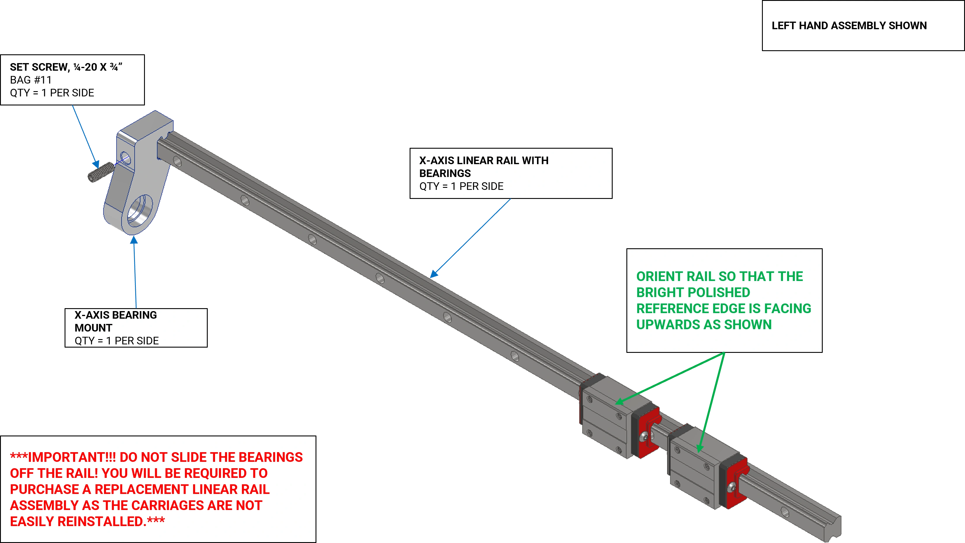

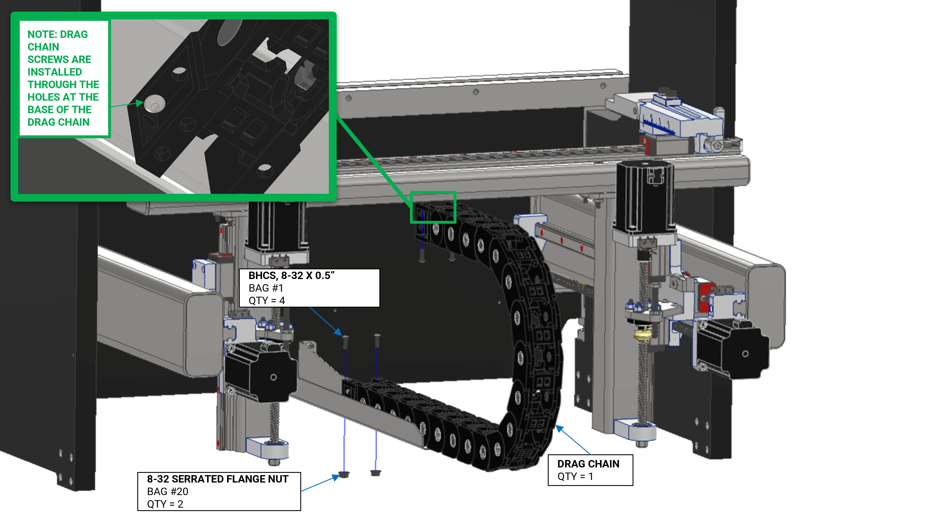

1: X-Axis Motion
The first step in the assembly process is to assemble all components necessary for X-axis motion.
Materials
Parts
  • (1) X-Axis Bearing Mount
  • (1) X-Axis Linear Rail with Bearings
Hardware
  • (1) SET SCREW, ¼-20 X ¾”
Tools
  • ⅛” Hex Key
Instructions
  1. Slide the X-Axis Bearing Mount on to one end of the X-Axis Linear Rail With Bearings as shown. The bearing mount should sit flush with the end of the linear railing.
  2. Ensure the bright polished reference edges are oriented as shown, relative to the X-Axis Bearing Mount.
  3. Install one ¼-20 set screw as shown into each X-Axis Bearing Mount and tighten until the assembly is secured in place.

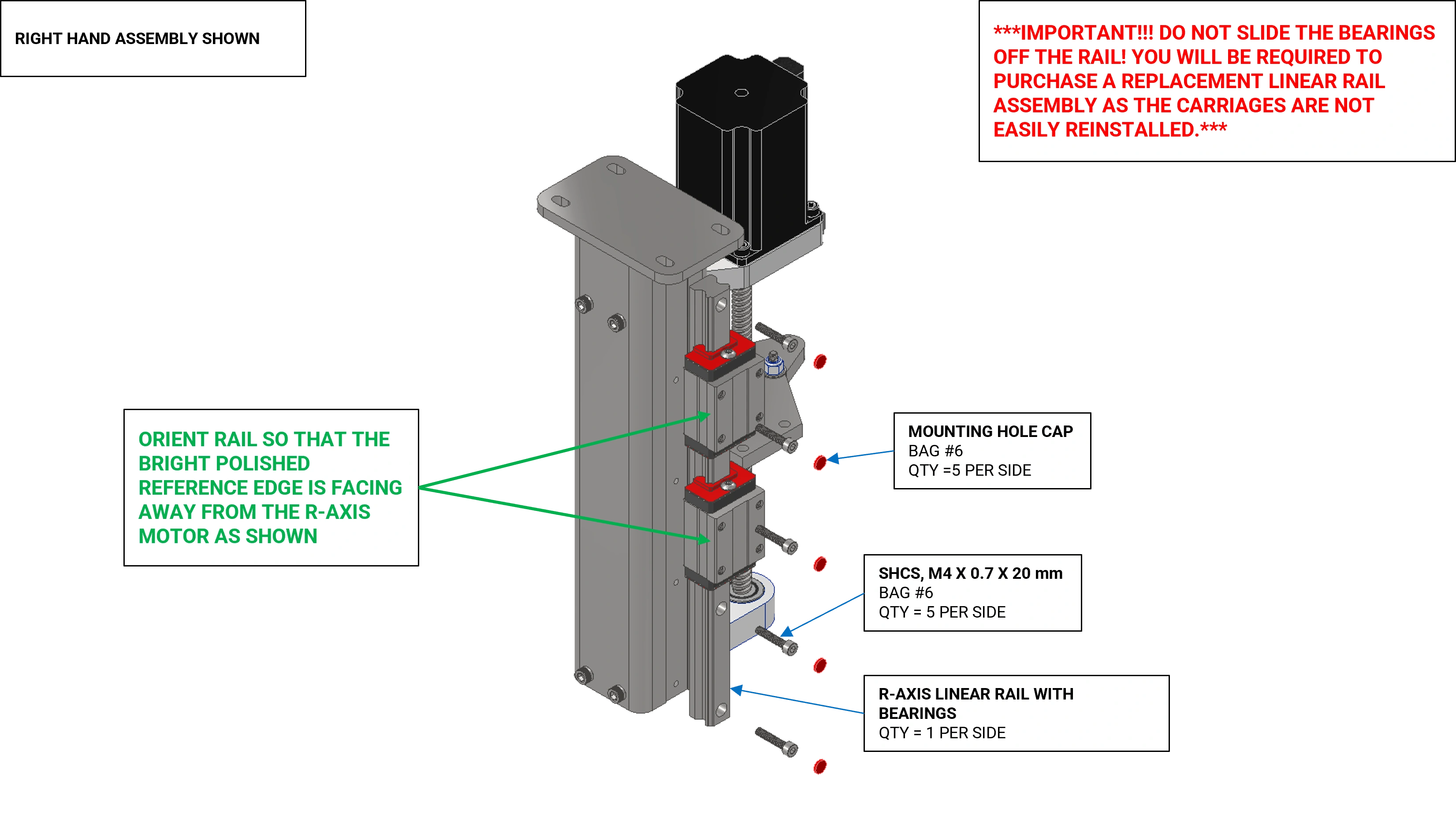

Materials

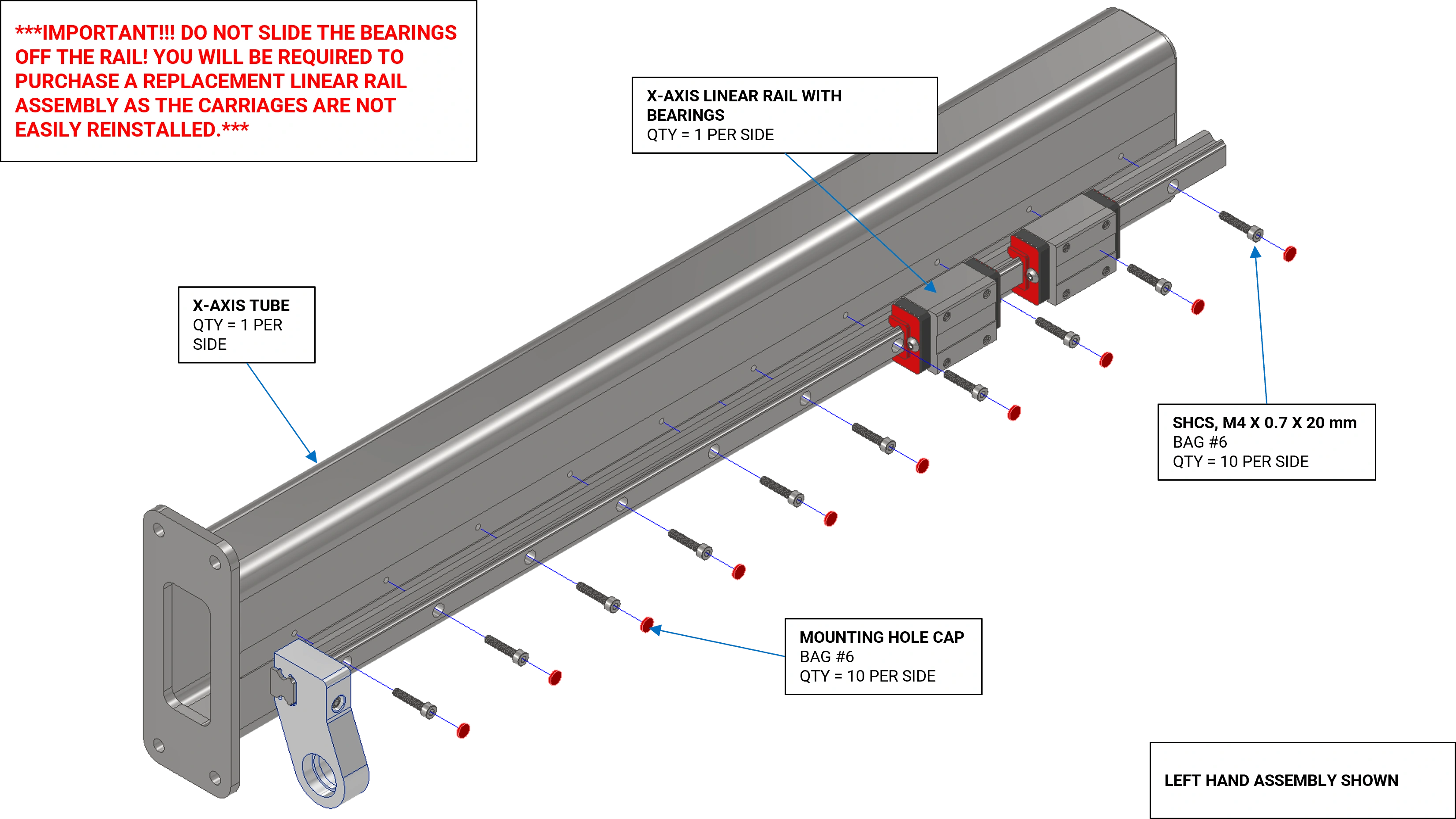

Parts
  • (10) Mounting Hole Cap
  • (1) X-Axis Tube
Hardware
  • (10) SOCKET HEAD CAP SCREW, M4 X 0.7 X 20 mm
Tools
  • 3mm Hex Key
Instructions
  1. Locate the X-Axis Linear Rail and Bearing assemblies. Note that the X-Axis Linear Rails are 24” in length. Be sure to install the correct ones.
    Important Note
  3. Thoroughly clean and brush the X-Axis Tube mounting surfaces as well as the bottom surface of the linear rails. Any debris in these critical joints will decrease the accuracy of the backgage.
  4. Install the X-Axis Linear Rail using the fasteners shown.
  5. Warning Symbol: LINEAR BEARING ORIENTATION
    WARNING
    Be sure to double check that the orientation of the Linear Rail Bearings are correct before inserting the mounting hole caps. Once installed the mounting hole caps cannot be removed without destroying them.
  6. Using a small mallet, lightly tap one mounting hole cap into each mounting hole. The goal is to only insert the cap until it is flush to the surface of the linear rail. Verify that each linear bearing can glide across the mounting holes without resistance.

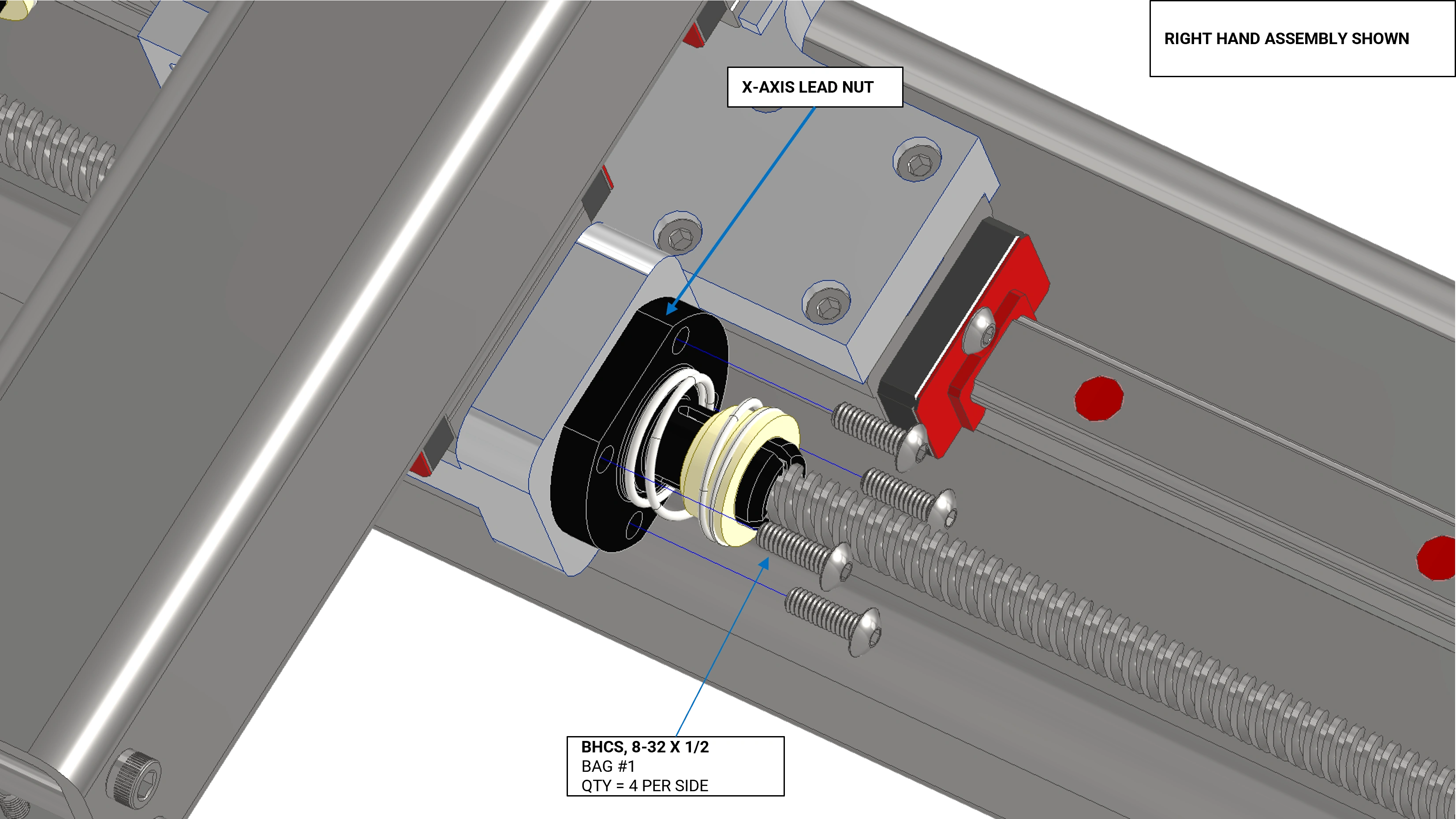

Materials
Parts

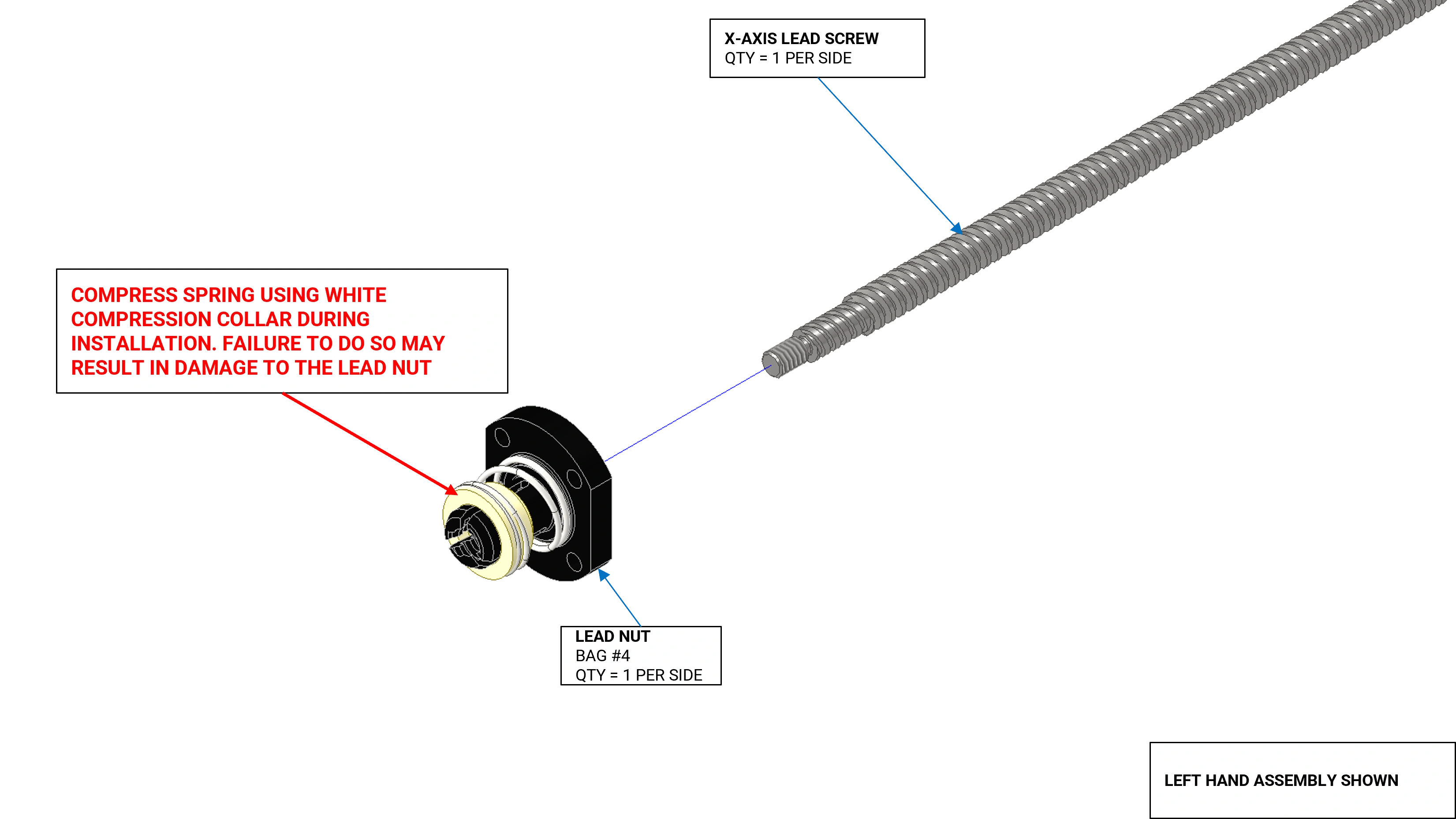

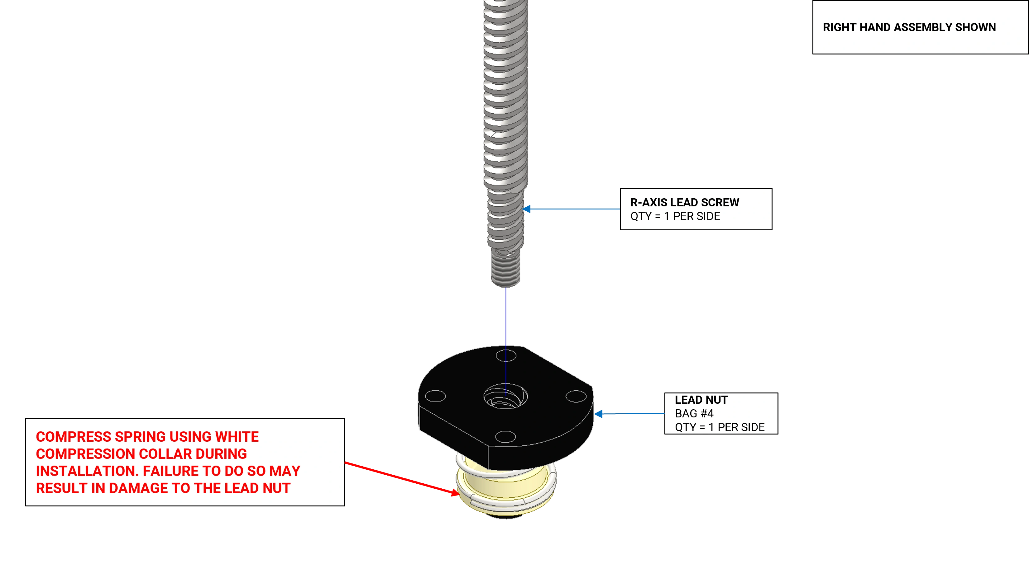

  • (1) Lead Nut
  • (1) X-Axis Lead Screw
Hardware
Tools
Instructions
  1. Use the white compression collar to compress the spring on the Lead Nut.
  2. With the spring held in the compressed position, thread the Lead Nut on to the threaded end of the X-Axis Lead Screw, with the flange of the Lead Nut oriented as shown.
  3. Continue to compress the Lead Nut spring and thread the Lead Nut until it is approximately halfway up the X-Axis Lead Screw.

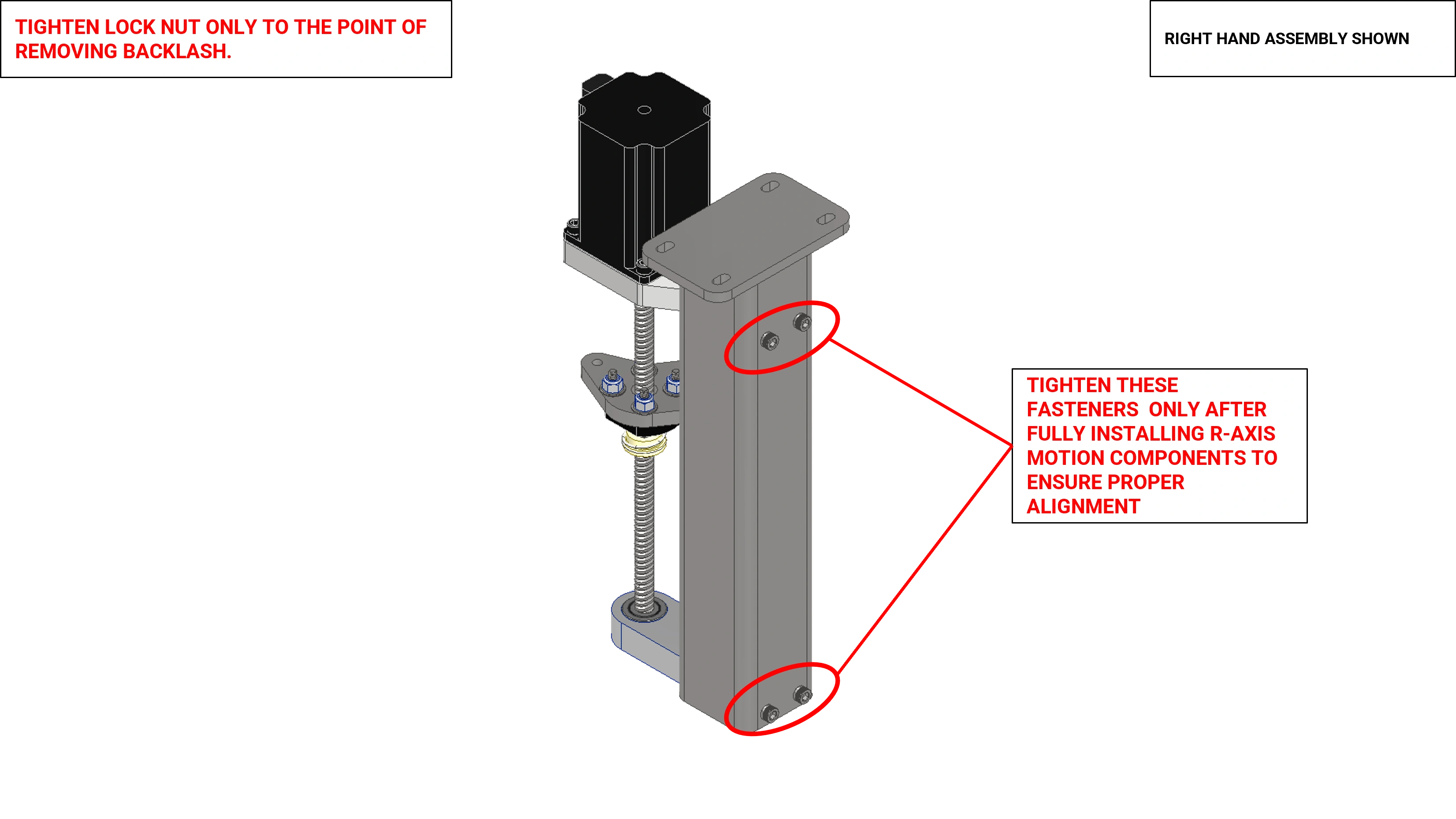

Materials
Parts
Hardware
  • (2) 608-2RS BEARING, SEALED

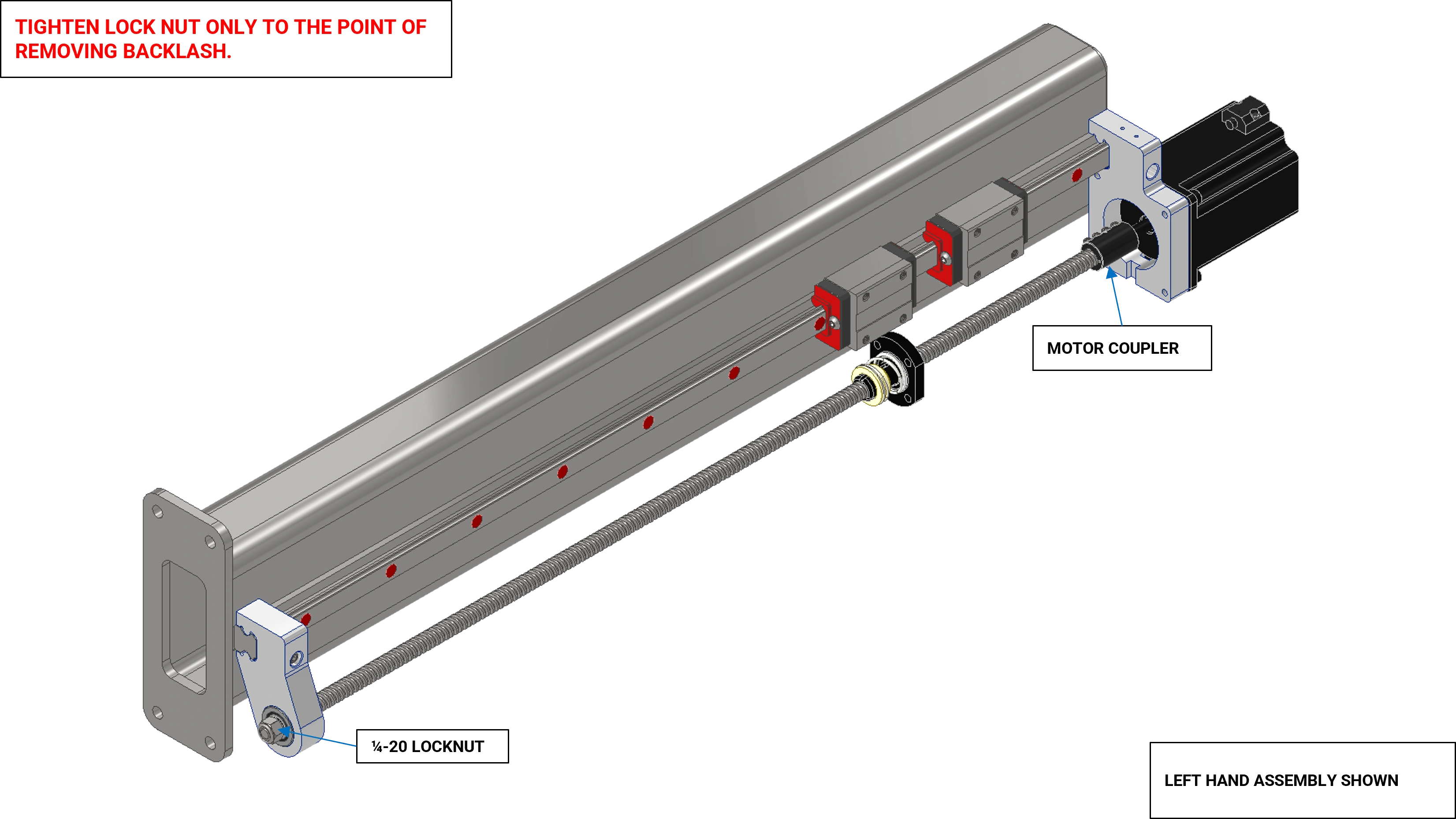

  • (1) ¼-20 LOCKNUT
  • (1) ¼ THIN WASHER
Tools
Instructions

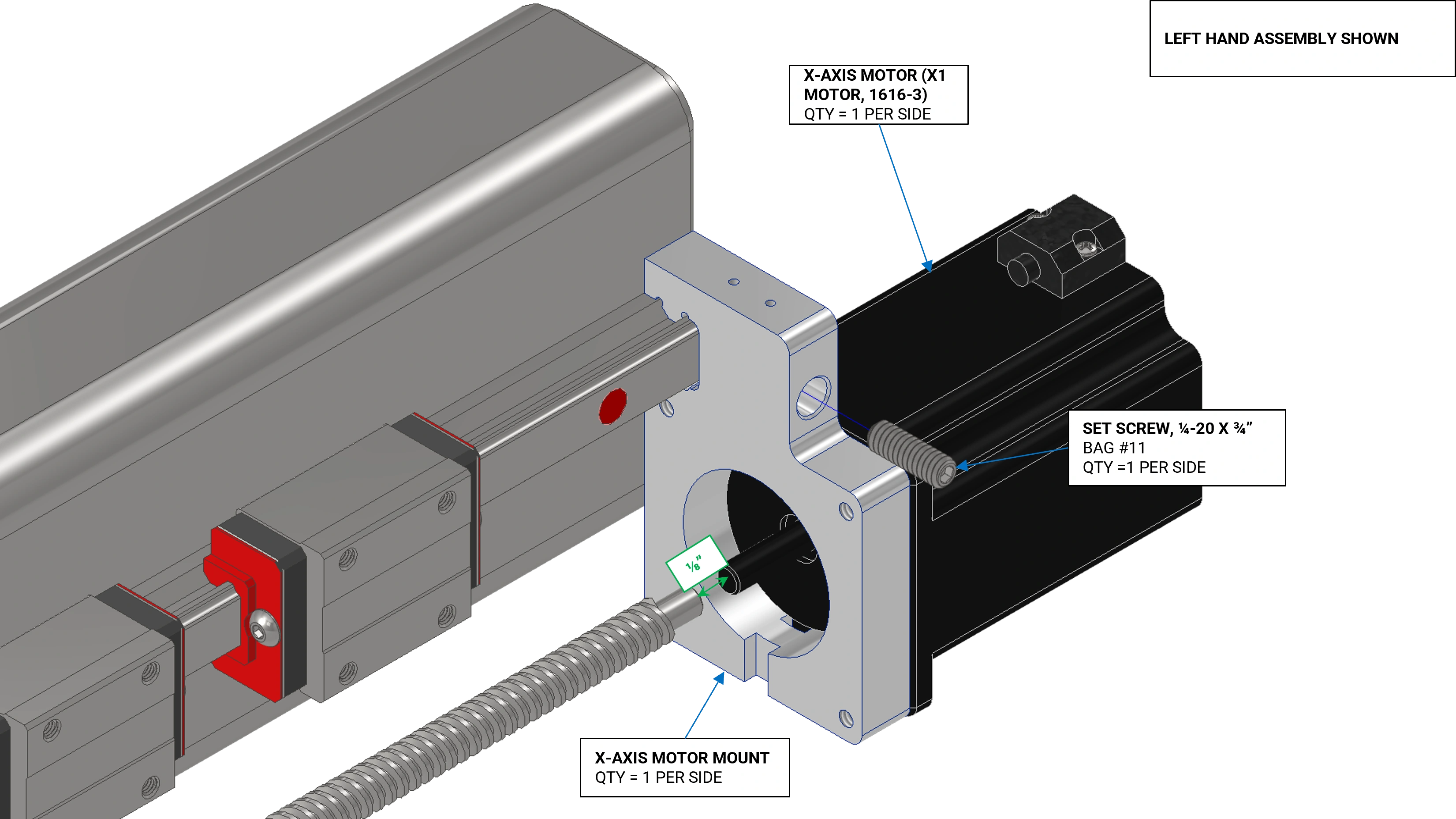

  1. Install the 608-2RS Bearings into the counterbores of the X-Axis Bearing Mount as shown.
  2. While holding the bearings in their respective counterbores, slide the ¼ thin washer on to the threaded end of the X-Axis Lead Screw and insert the threaded end of the lead screw through both bearings.
  3. Install the ¼-20 locknut to the threaded end of the X-Axis Lead Screw. Leave the locknut loose for now (about ¼ turn from hand tight), these will be tightened later in step H1.

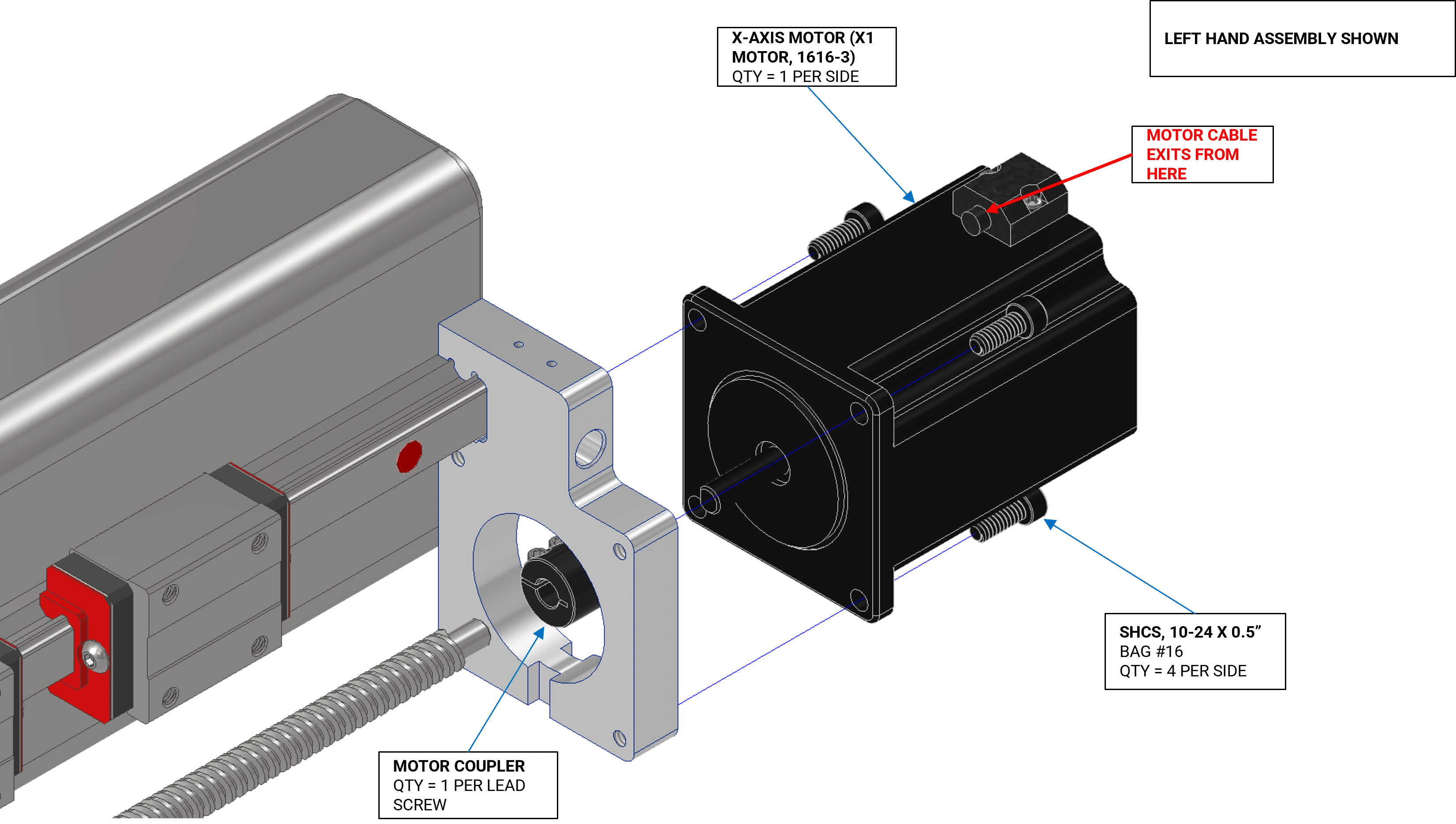

Materials
Parts
  • (1) X-Axis Motor Mount
  • (1) X-Axis Motor (1616-3)
Hardware
Tools
  • ⅛” Hex Key
Instructions

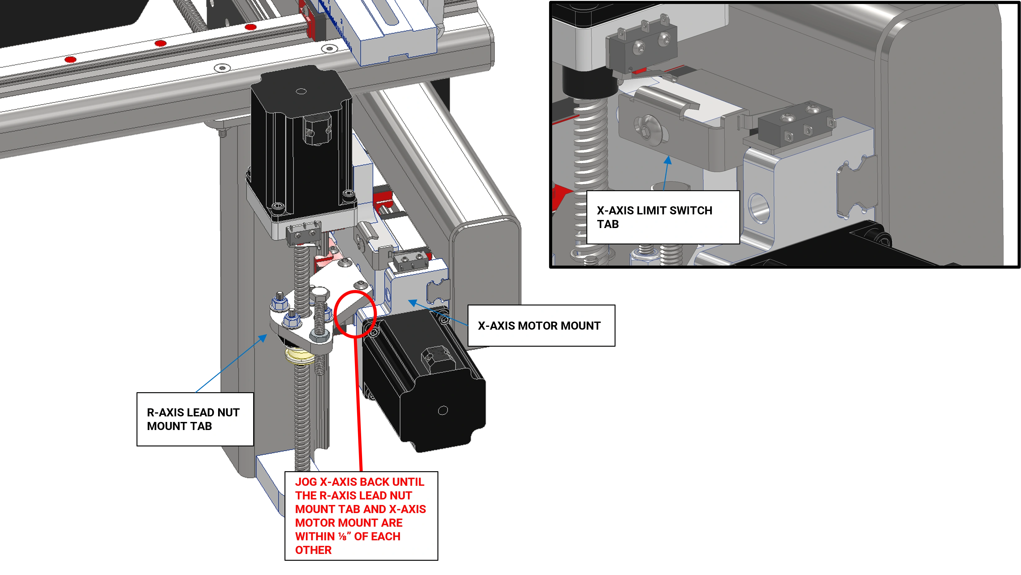

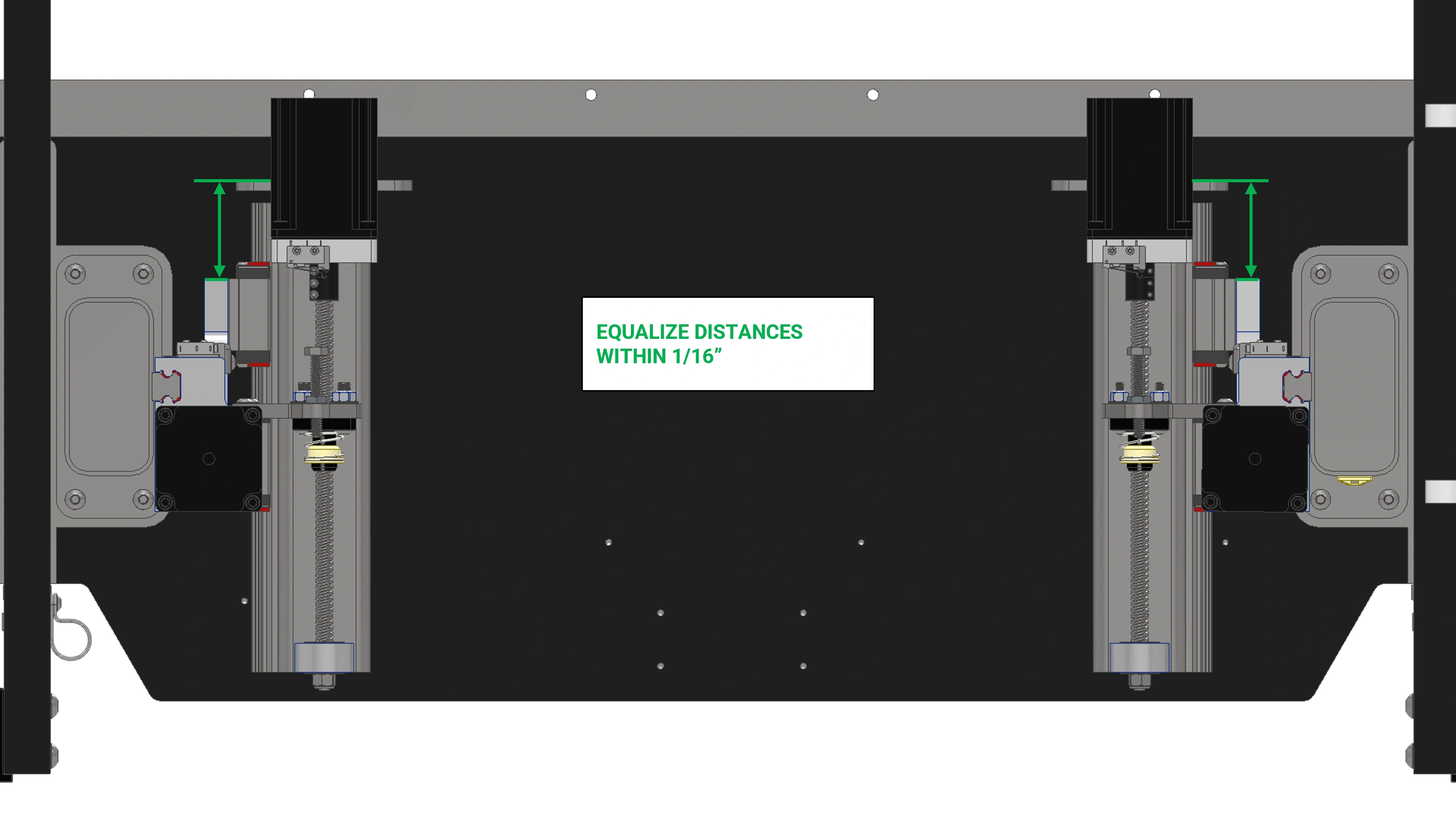

  1. Slide the X-Axis Motor Mount on to the end of the linear rail closest to the non threaded end of the lead screw.
  2. With one hand, hold the motor in place, as it would be installed into the mount. With the other hand push the lead screw back into the 608 2RS Bearings and align it concentric with the X-Axis Motor Shaft.
  3. Slide the X-Axis Motor Mount forwards or backwards until the distance between the end of the motor shaft and the lead screw is approximately ⅛”.
  4. Remove the X-Axis Motor from the X-Axis Motor Mount, taking care not to shift the motor mounts position, and install the ¼-20 x ¾” set screw. Tighten the set screw until the motor mount stays firmly in place.

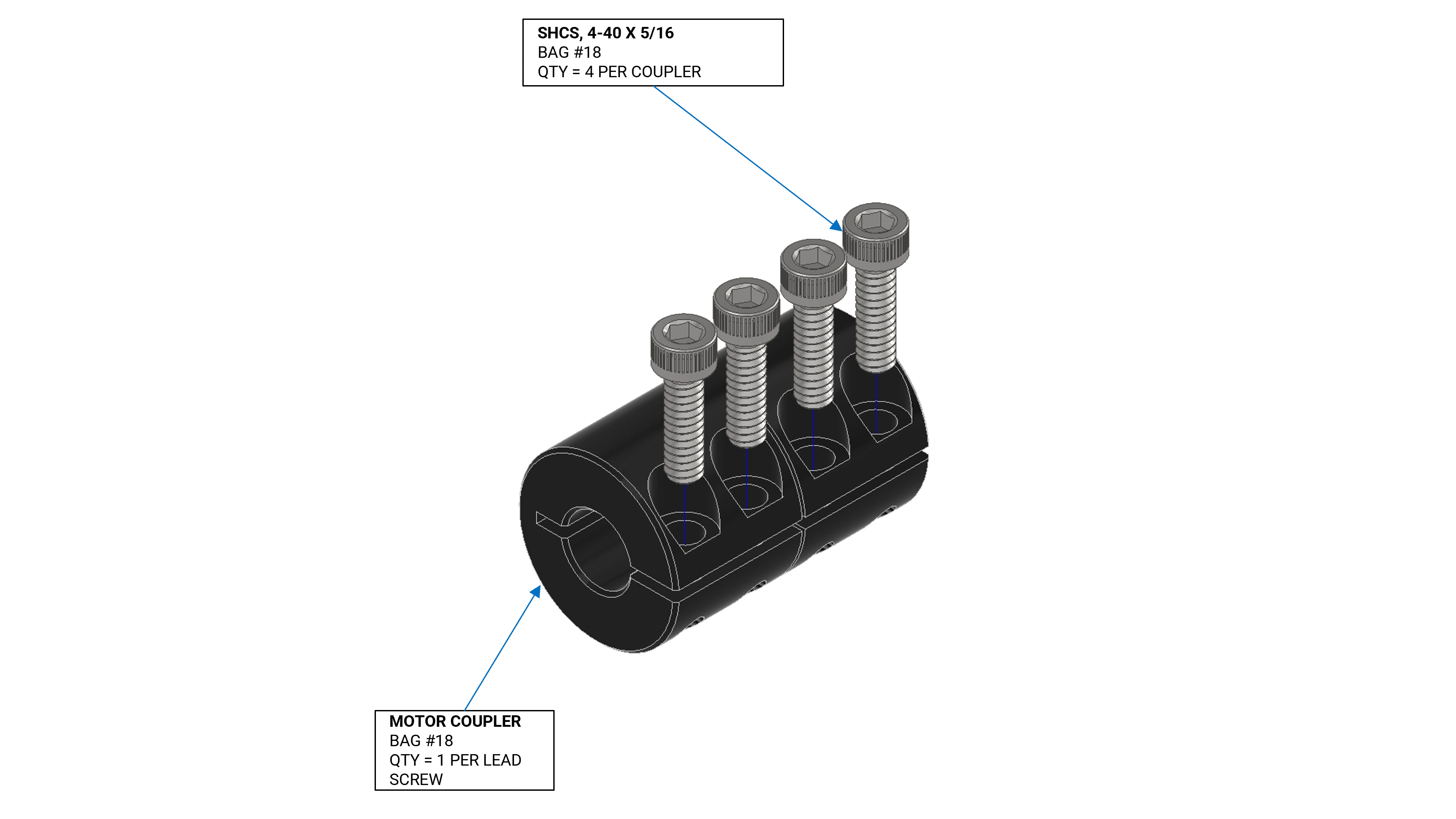

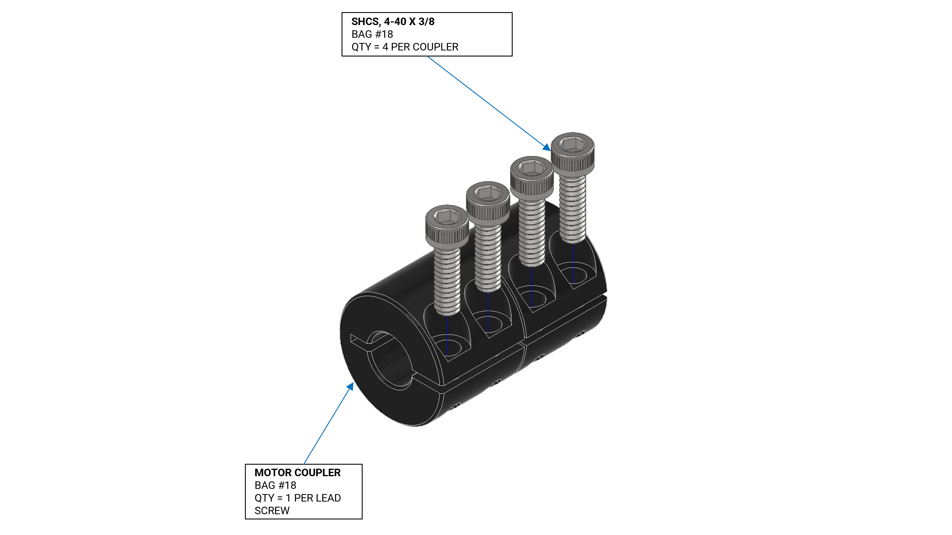

Materials
Parts

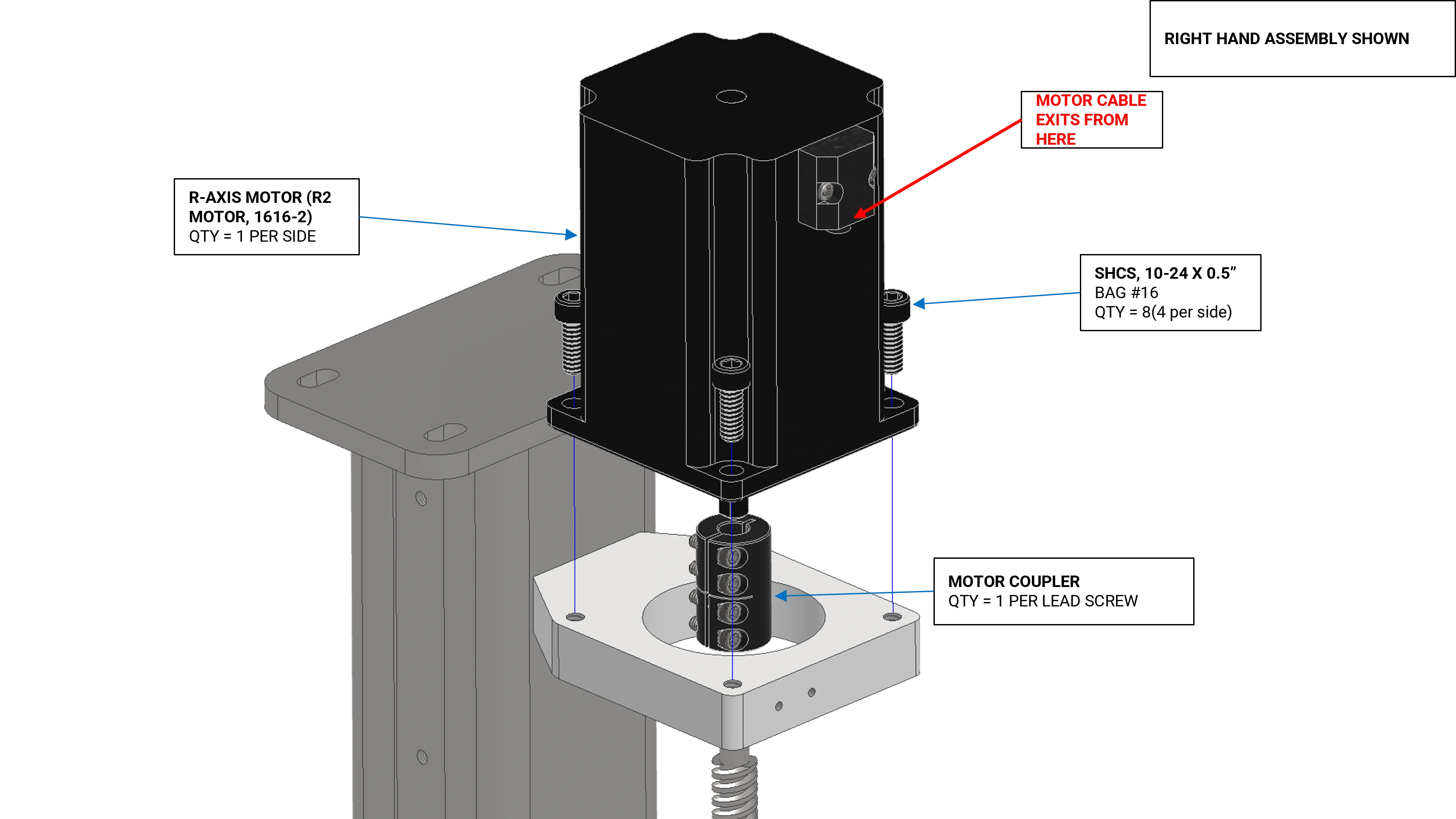

  • (1) Motor Coupler
Hardware
  • (4) SOCKET HEAD CAP SCREW, 4-40 X 5/16
Tools
  • 3/32” Hex Key
Instructions
  1. Loosely install the socket head cap screws into the 4 threaded holes.
Materials
Parts
  • (1) Motor Coupler
  • (1) X-Axis Motor
Hardware
  • (4) SOCKET HEAD CAP SCREWS, 10-24 X 0.5”
Tools
  • 5/32” Hex Key
Instructions
  1. Insert the Motor Coupler onto the end of the lead screw.
  2. Insert the X-Axis Motor shaft into the coupler and install the X-Axis Motor on to the mount as shown.

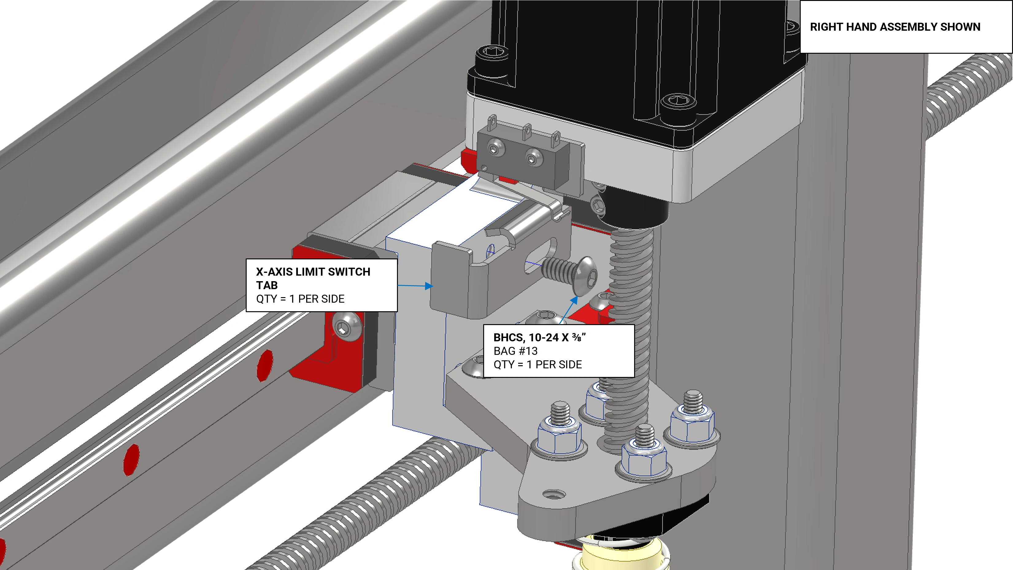

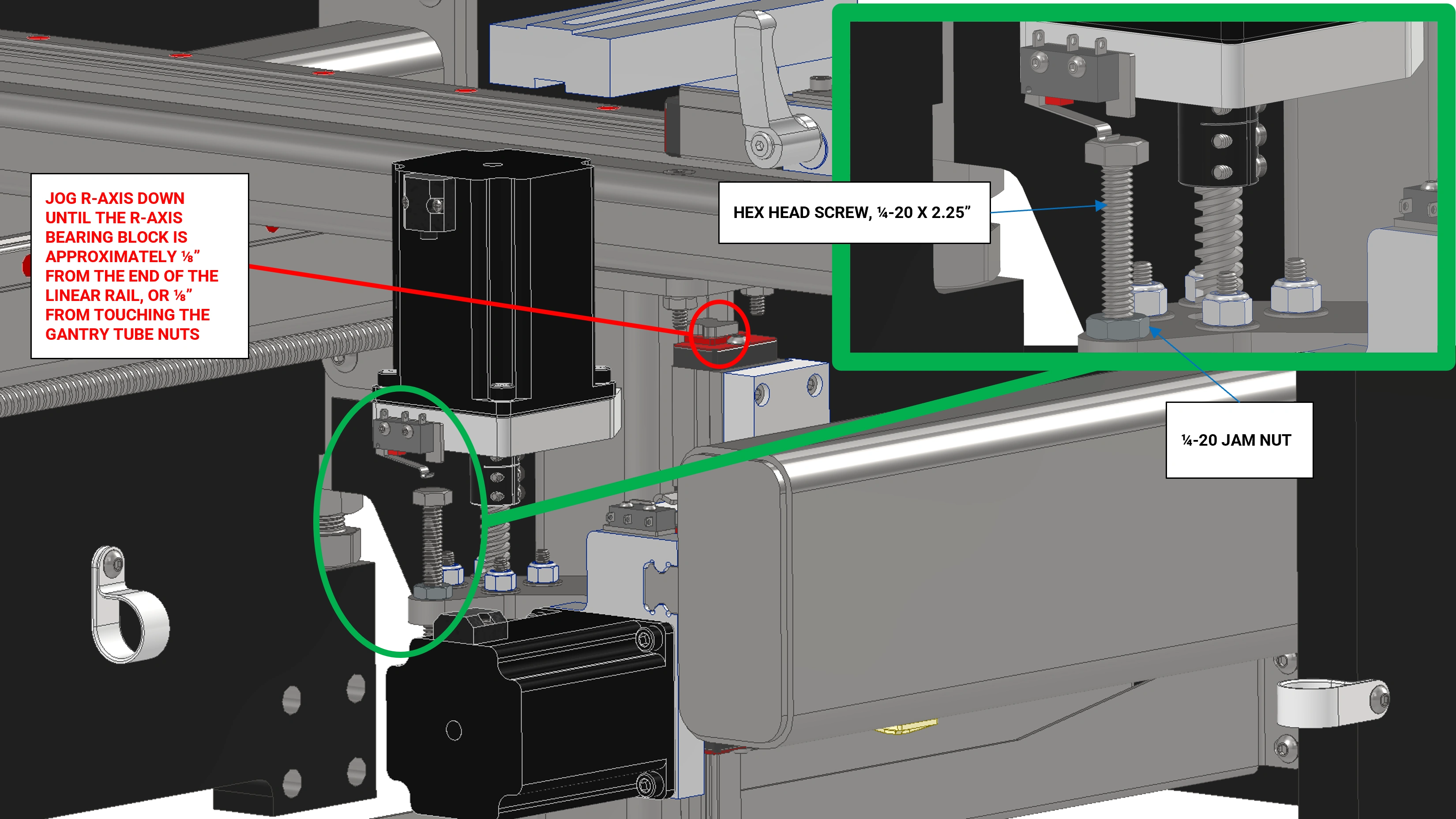

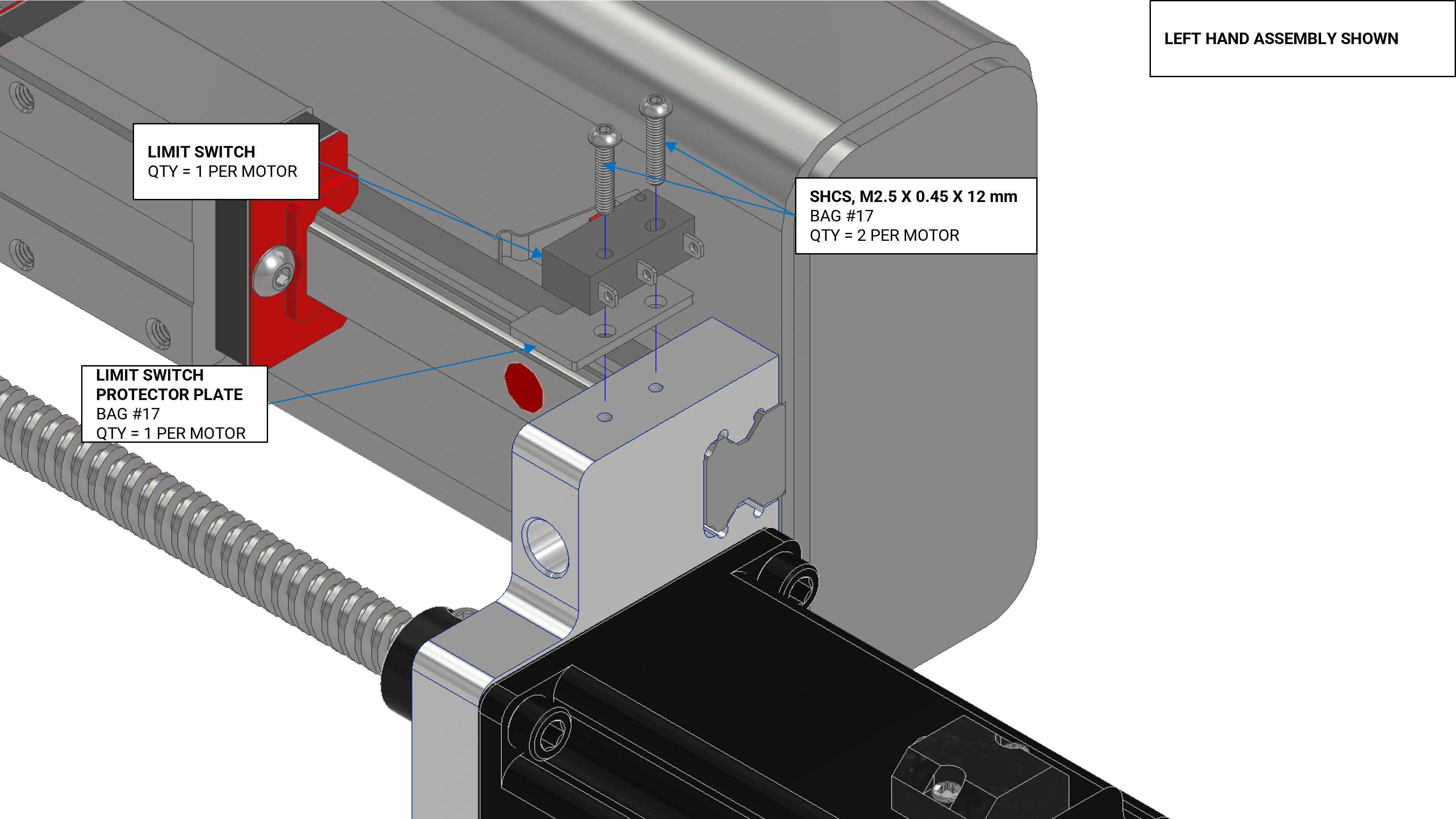

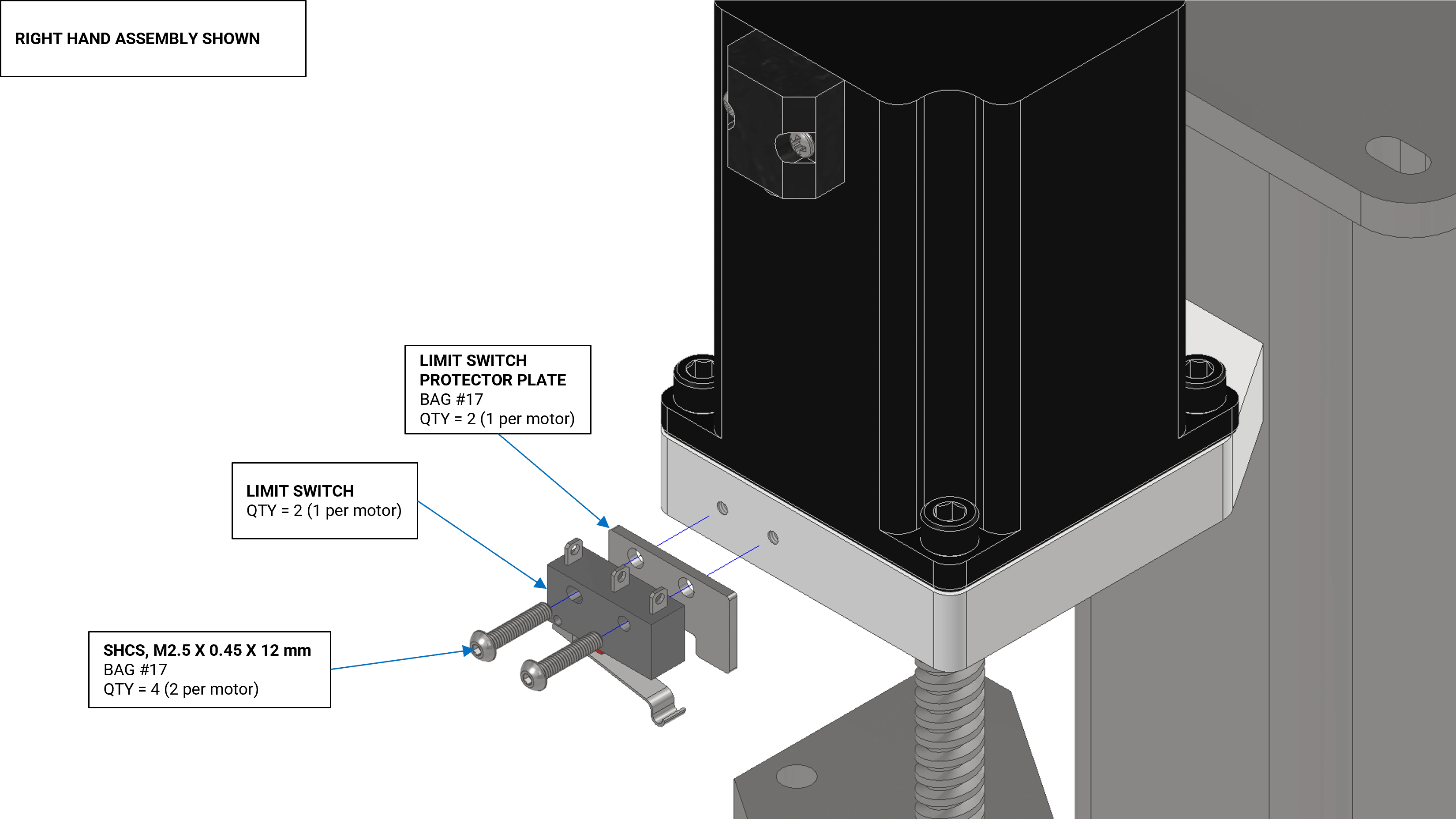

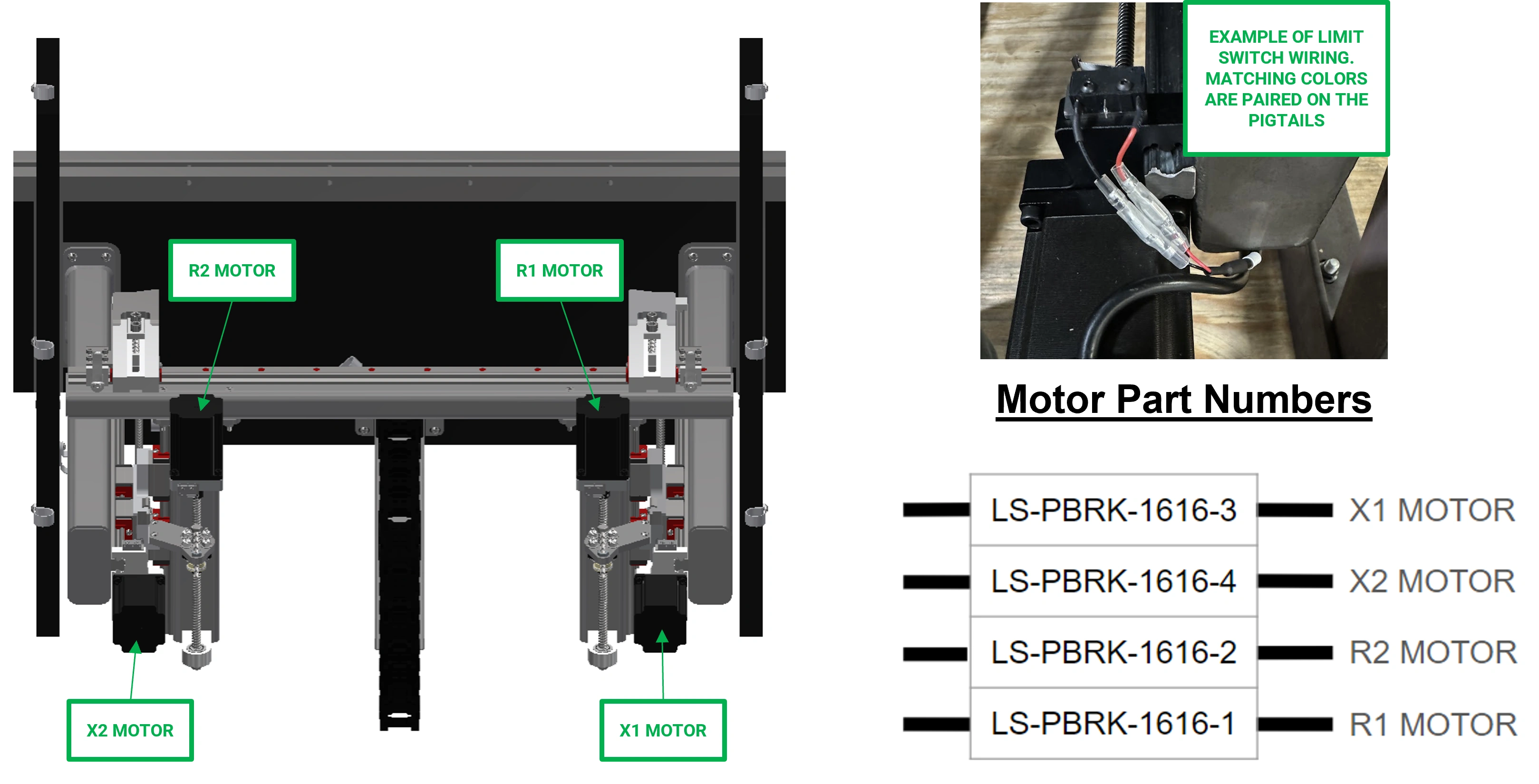

Materials
Parts
  • (1) Limit Switch
  • (1) Limit Switch Protector Plate
Hardware
  • (2) SOCKET HEAD CAP SCREWS, M2.5 X 0.45 X 12 mm
Tools

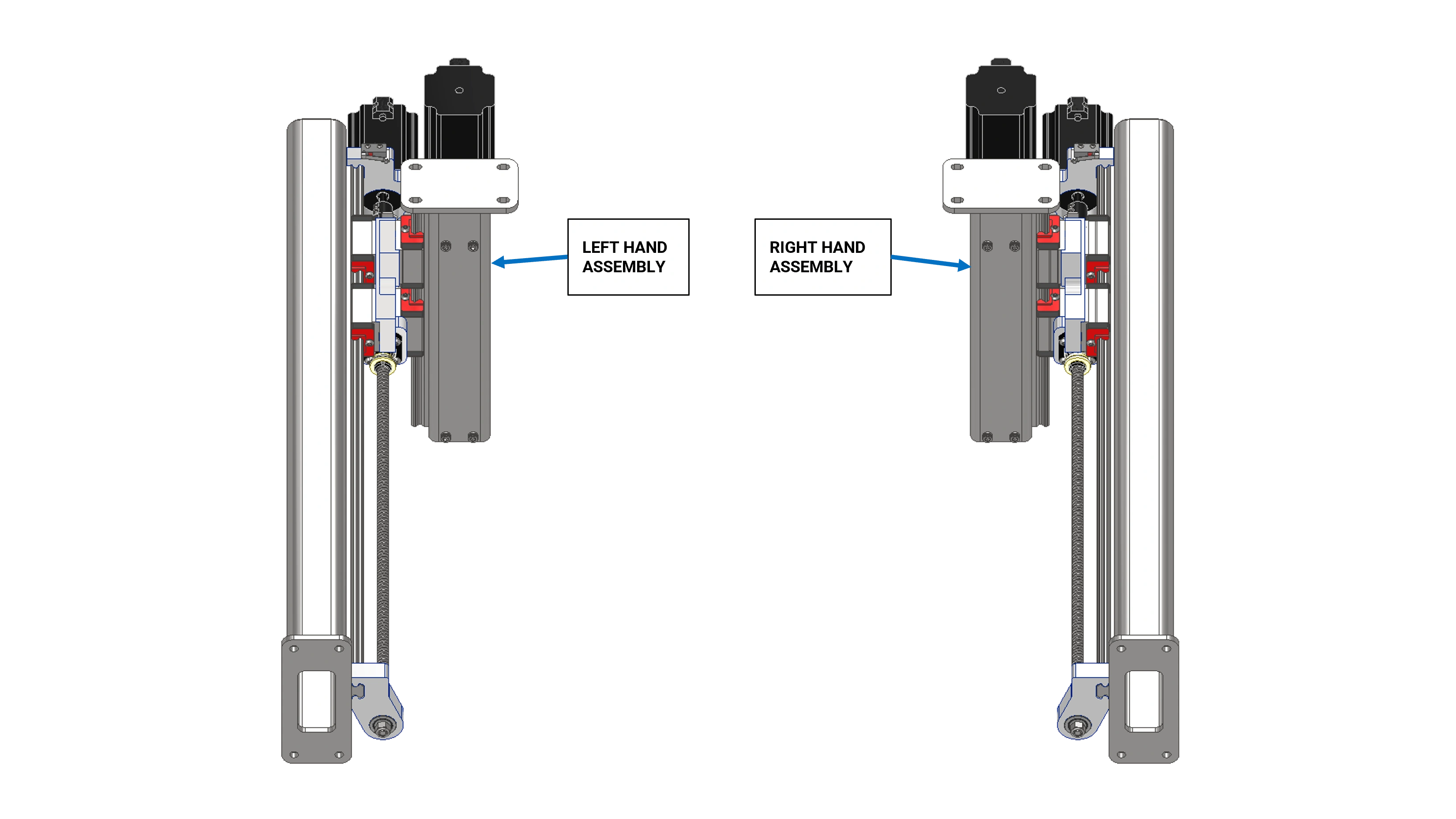

  1. Repeat Steps A1-I1 for the Right Hand X-Axis Assembly. Note that the Right Hand X-Axis Assembly is a mirror of the previously assembled Left Hand X-Axis Assembly. The Right Hand X-Axis Assembly will use the X2 motor, 1616-4.

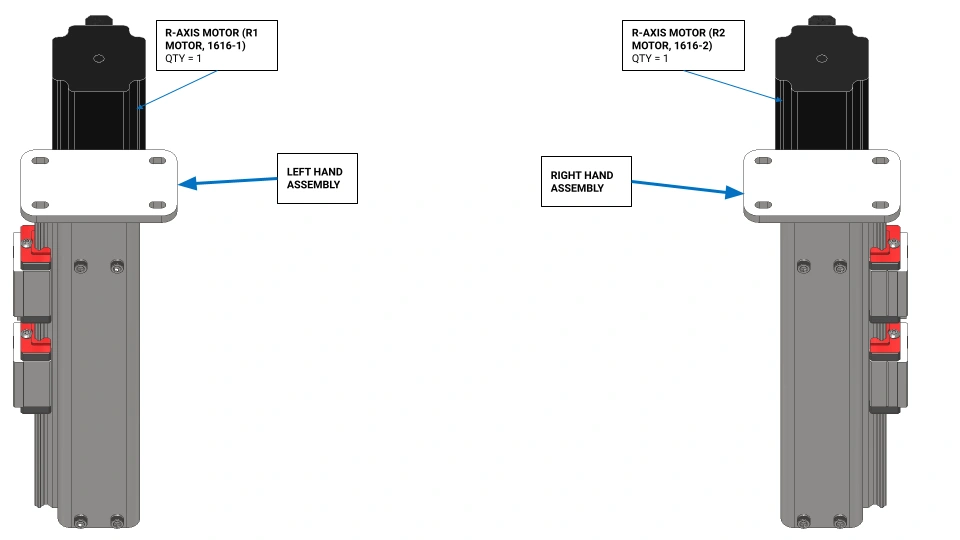

2: R-Axis Motion
The next step in the assembly process is to assemble all components necessary for R-axis motion.

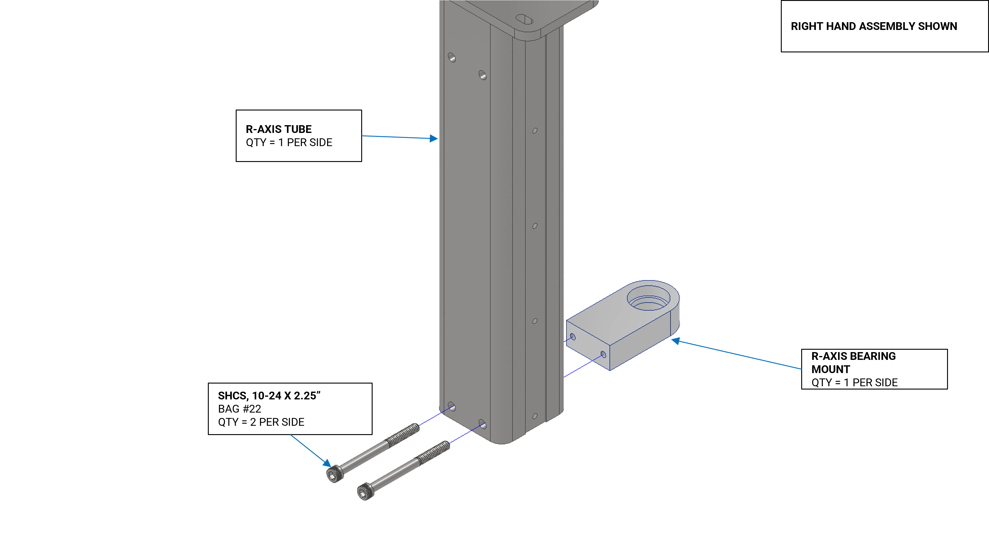

Materials
Parts
  • (1) R-Axis Bearing Mount
  • (1) R-Axis Tube
Hardware
  • (2) SOCKET HEAD CAP SCREWS, 10-24 X 2.25”
Tools
  • 5/32” Hex Key
Instructions
  1. Bolt the R-Axis Bearing Mount to the R-Axis Tube, taking care to orient the linear rail slot as shown. Leave the 10-24 Screws approximately ¼ turn from tight, these will be tightened later in step H2.

  • (1) Lead Nut
  • (1) R-Axis Lead Screw
Hardware
Tools
Instructions
  2. With the spring held in the compressed position, thread the Lead Nut on to the threaded end of the R-Axis Lead Screw, with the flange of the Lead Nut oriented as shown.
  3. Continue to compress the Lead Nut spring and thread the Lead Nut until it is approximately halfway up the R-Axis Lead Screw.

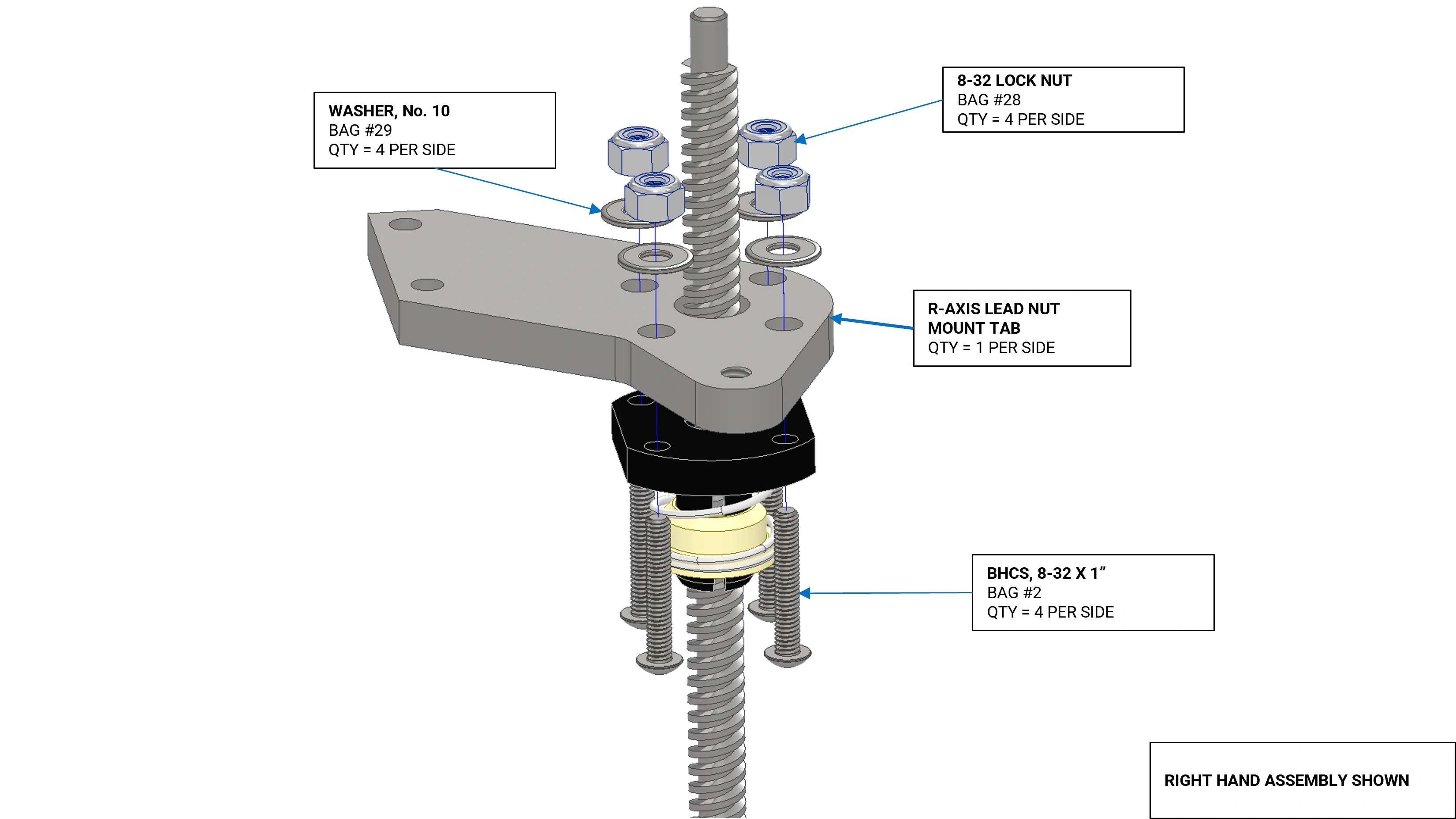

Materials
Parts
  • (1) R-Axis Lead Nut Mount Tab
Hardware
  • (4) WASHER, No. 10
  • (4) 8-32 LOCK NUT
  • (4) BUTTON HEAD CAP SCREW, 8-32 X 1”
Tools
  • 3/32 Hex Key
Instructions
  1. Slide the R-Axis Lead Nut Mount Tab on to the non threaded end of the R-Axis Lead Screw.
  2. Bolt the R-Axis Lead Nut Mount Tab to the Lead Nut as shown. Leave the 8-32 cap screws ¼ turn from tight, these will be tightened later in section 5 step O3.
Materials
Parts
Hardware
  • (1) ¼ THIN WASHER
  • (2) ¼-20 LOCK NUT
Tools
Instructions
  1. Install the 608-2RS Bearings into the counterbores of the R-Axis Bearing Mount as shown.
  2. While holding the bearings in their respective counterbores, slide the ¼ thin washer on to the threaded end of the R-Axis Lead Screw and insert the threaded end of the lead screw through both bearings.
  3. Install the ¼-20 locknut on to the threaded end of the R-Axis Lead Screw. Leave the locknut loose for now (about ¼ turn from hand tight), these will be tightened later in step H1.

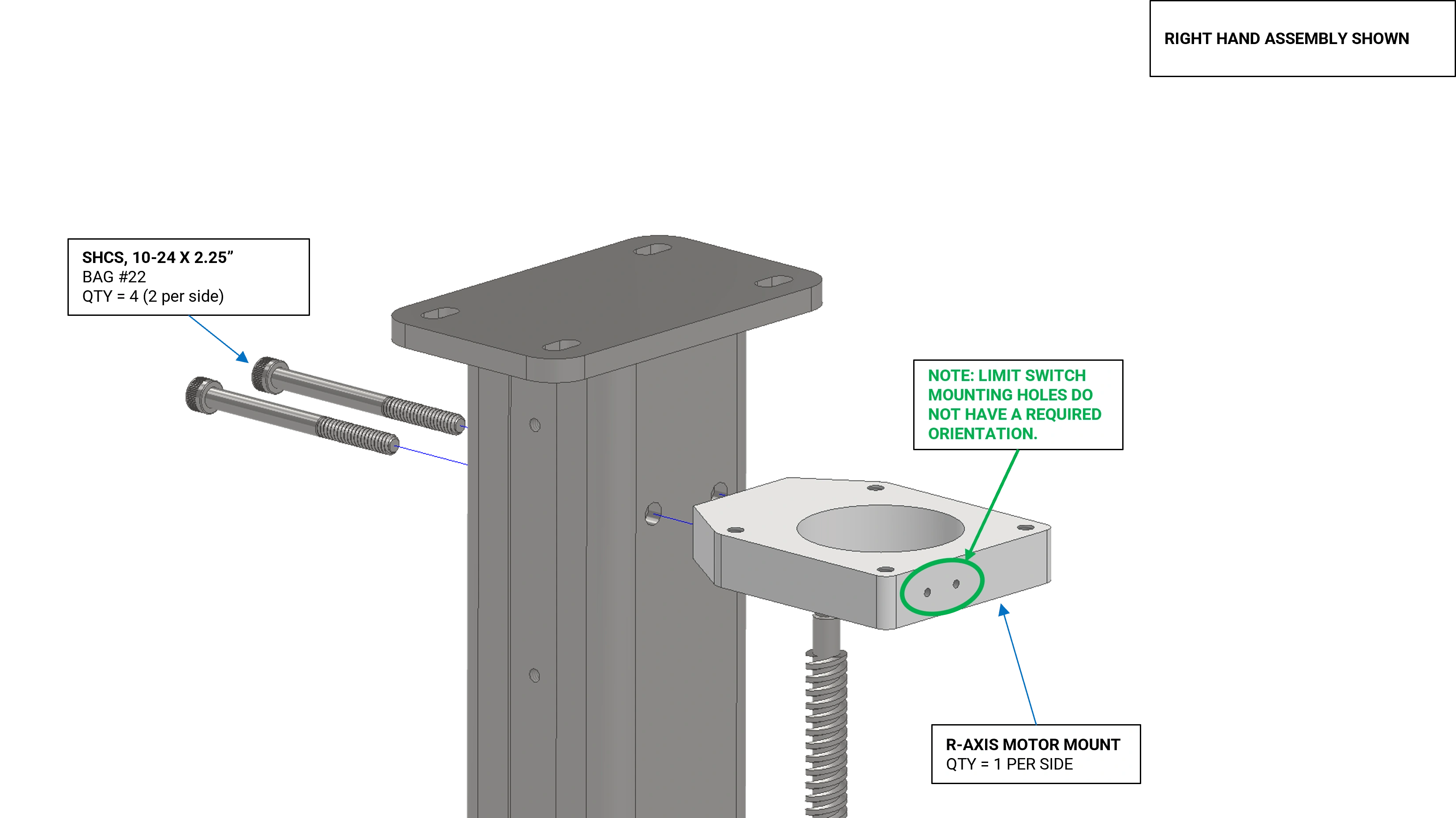

Materials
Parts
  • (1) R-Axis Motor Mount
Hardware
Tools
  • 5/32” Hex Key
Instructions
  1. Bolt the R-Axis Motor Mount to the R-Axis Tube, taking care to orient the linear rail slot as shown. Leave the 10-24 Screws approximately ¼ turn from tight, these will be tightened later in step H2.
Materials
Parts
  • (1) Motor Coupler
Hardware
Tools
  • 3/32” Hex Key
Instructions
Materials
Parts
  • (1) Motor Coupler
  • (1) R-Axis Motor (R2 Motor, 1616-2)
Hardware
Tools
  • 5/32” Hex Key
Instructions
  1. Slide the Motor Coupler on to the non-threaded end of the lead screw.
  2. While holding the Motor Coupler on the lead screw, slide the R-Axis Motor shaft in to coupler and install the R-Axis Motor on to the mount as shown.
Materials
Parts
Hardware
Tools
  • Padded Pliers
  • 3/32” Hex Key
  • 5/32” Hex Key
  • 7/16” Wrench
Instructions
  1. Using pliers with protection on the jaws, grip the R-Axis Lead Screw thread next to the R-Axis Bearing Mount to prevent the screw from rotating. The objective when tightening the lock nut is to remove all backlash without excessively preloading the bearings. If done correctly, the lead screw should be able to rotate freely with no observable axial play when pushing/pulling on the screw.
  2. Tighten the middle two screws of the Motor Coupler. Next, tighten the outboard screws. Again, further tighten the middle two screws followed by the outboard screws.
  3. Tighten the 10-24 cap screws securing the R-Axis Motor and Bearing mounts.
Materials
Parts
  • (1) Limit Switch
Hardware
Tools
  • 1.5 mm Hex Key
Instructions
  1. Install the Limit Switch and Limit Switch Protector Plate as shown.

  • (1) R-Axis Linear Rail with Bearings
  • (5) Mounting Hole Cap
Hardware
  • (5) SOCKET HEAD CAP SCREW, M4 X 0.7 X 20 mm
Tools
  • 3mm Hex Key
Instructions
  1. Locate the R-Axis Linear Rail and Bearing assemblies. Note that the R-Axis Linear Rails are 10” in length. Be sure to install the correct ones.
    Important Note
  3. Thoroughly clean and brush the R-Axis Tube mounting surfaces as well as the bottom surface of the linear rails. Any debris in these critical joints will decrease the accuracy of the backgage.
  4. Install the R-Axis Linear Rail using the fasteners shown.
  5. [Warning Symbol] LINEAR BEARING ORIENTATION
    WARNING

  1. Repeat Steps A1-J4 for the Left Hand R-Axis Assembly. Note that the Left Hand R-Axis Assembly is a mirror of the previously assembled Right Hand R-Axis Assembly. The Left Hand R-Axis Assembly will use the R1 Motor, 1616-1.

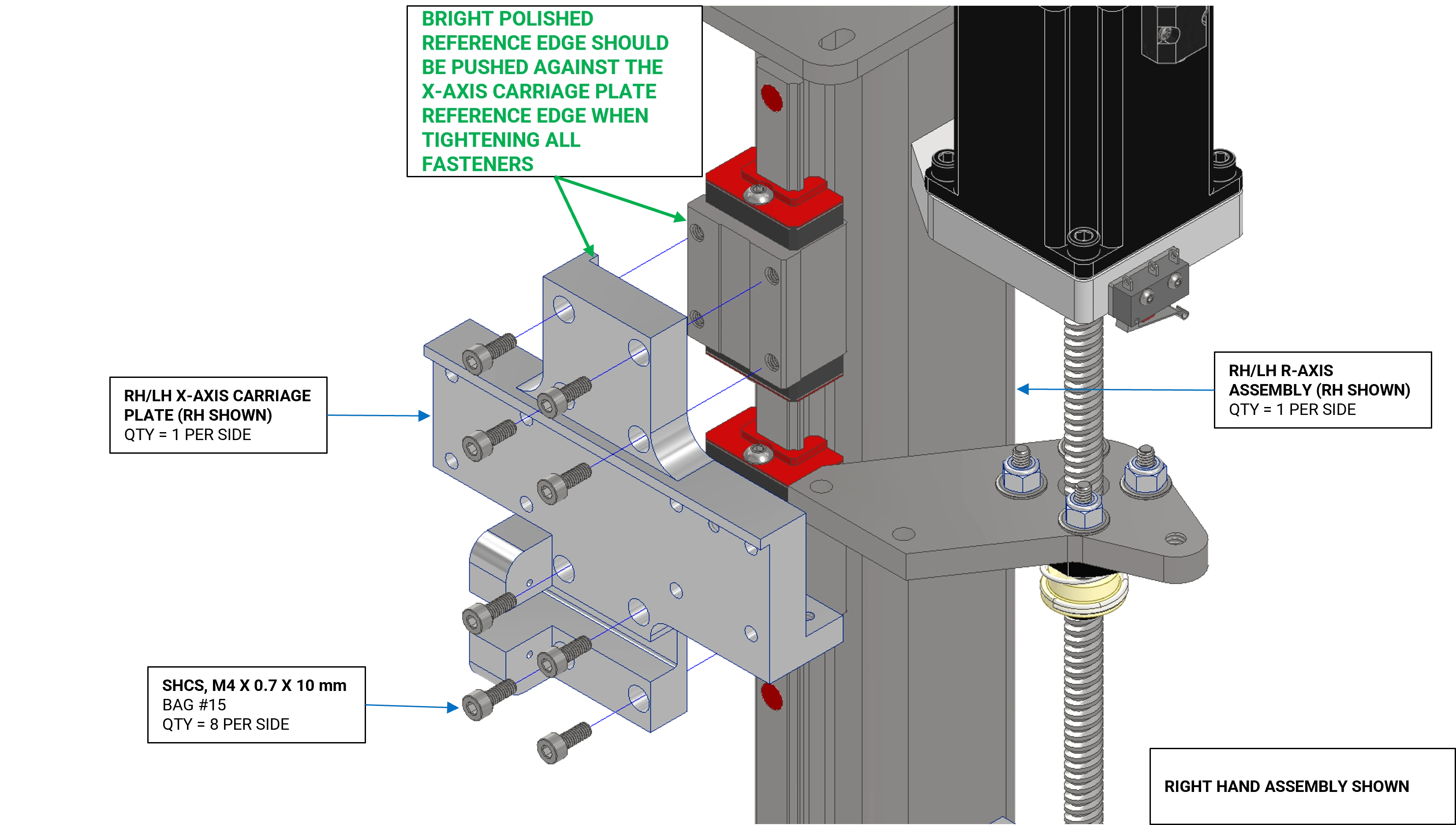

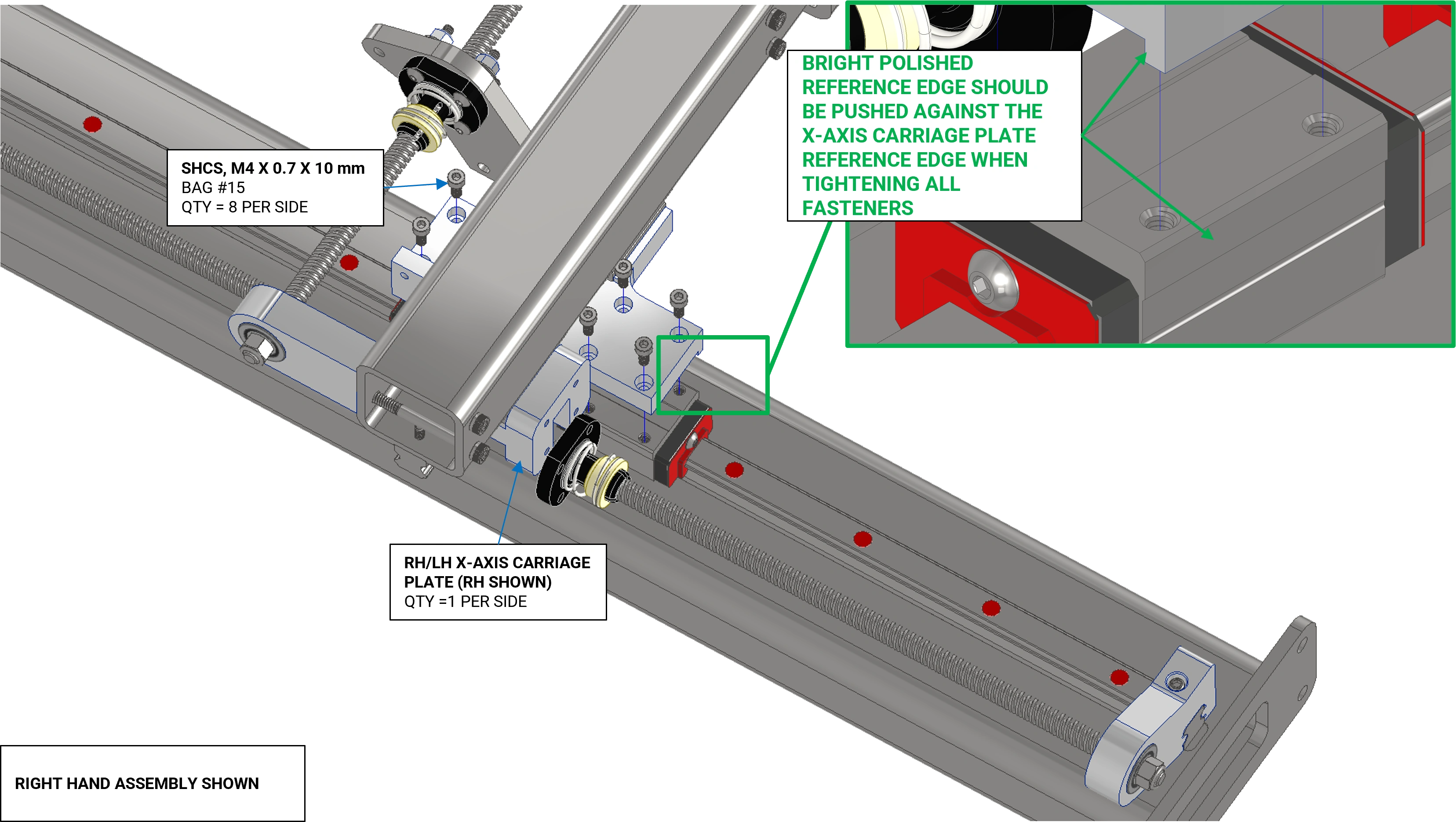

  • (1) RH X-AXIS CARRIAGE PLATE
Hardware
  • (8) SOCKET HEAD CAP SCREW, M4 X 0.7 X 10 mm (8 per side)
Tools
  • 3mm Hex Key
Instructions
  1. Locate the Right Hand X Axis Carriage Plate and the RH R-Axis Assembly(previously assembled).
  2. Loosely Install the RH X-Axis Carriage Plate using the fasteners as shown.
  3. Push the edge of the RH X-Axis Carriage Plate against the reference edges of the linear bearing blocks and tighten the M4 cap screws.

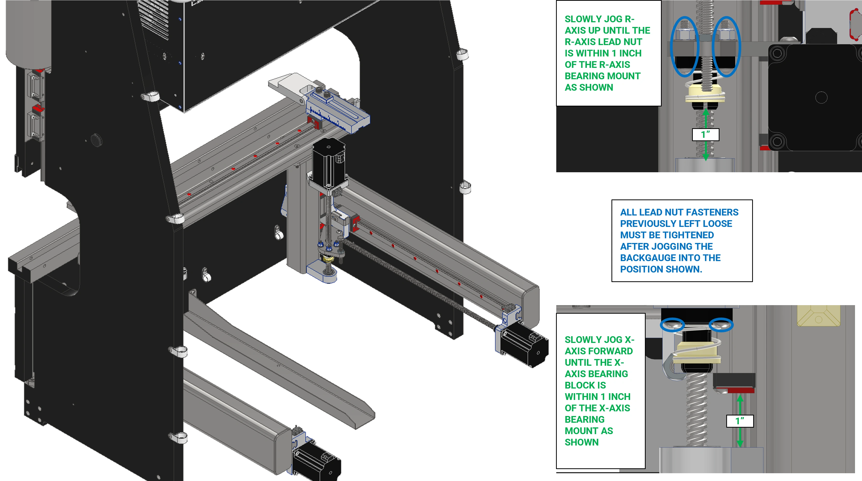

  1. Slide the X-Axis Carriage Plate up against the X-Axis Lead Nut, rotating the Lead Nut as necessary such that the mounting holes align with the corresponding mounting holes on the X-Axis Carriage Plate.
  2. Fasten the X-Axis Lead Nut to the X-Axis Carriage Plate as shown. Leave the 8-32 cap screws ¼ turn from tight, these will be tightened later in section 5 step O3.
Materials
Parts
Hardware
  • (4) BUTTON HEAD CAP SCREW, 10-24 X ⅝”
Tools
  • ⅛” Hex Key

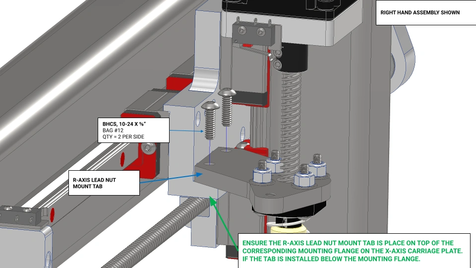

Instructions
  1. Slide the R Axis Tube Assembly such that the R-Axis Lead Nut Mount Tab rests on the X-Axis Carriage Plate, rotating the R-Axis Lead Nut as necessary such that the mounting holes align with the corresponding mounting holes on the X-Axis Carriage Plate. Ensure the R-Axis Lead Nut Mount Tab is installed above the corresponding mounting flange on the X-Axis Carriage Plate. If the Mount Tab is incorrectly installed below the mounting flange, the R-Axis Limit Switch Screws will not be able to reach the limit switch.
  2. Fasten the R-Axis Lead Nut Mount Tab to the X-Axis Carriage Plate as shown.
Materials
Parts
  • (1) X-Axis Limit Switch Tab
Hardware
  • (1) BUTTON HEAD CAP SCREW, 10-24 X ⅜”
Tools
  • ⅛” Hex Key
Instructions
  1. Fasten the X-Axis Limit Switch Tab on to the X-Axis Carriage Plate as shown. Ensure the tab is pushed to the back of the slot such that it sits flat against the X-Axis Carriage.

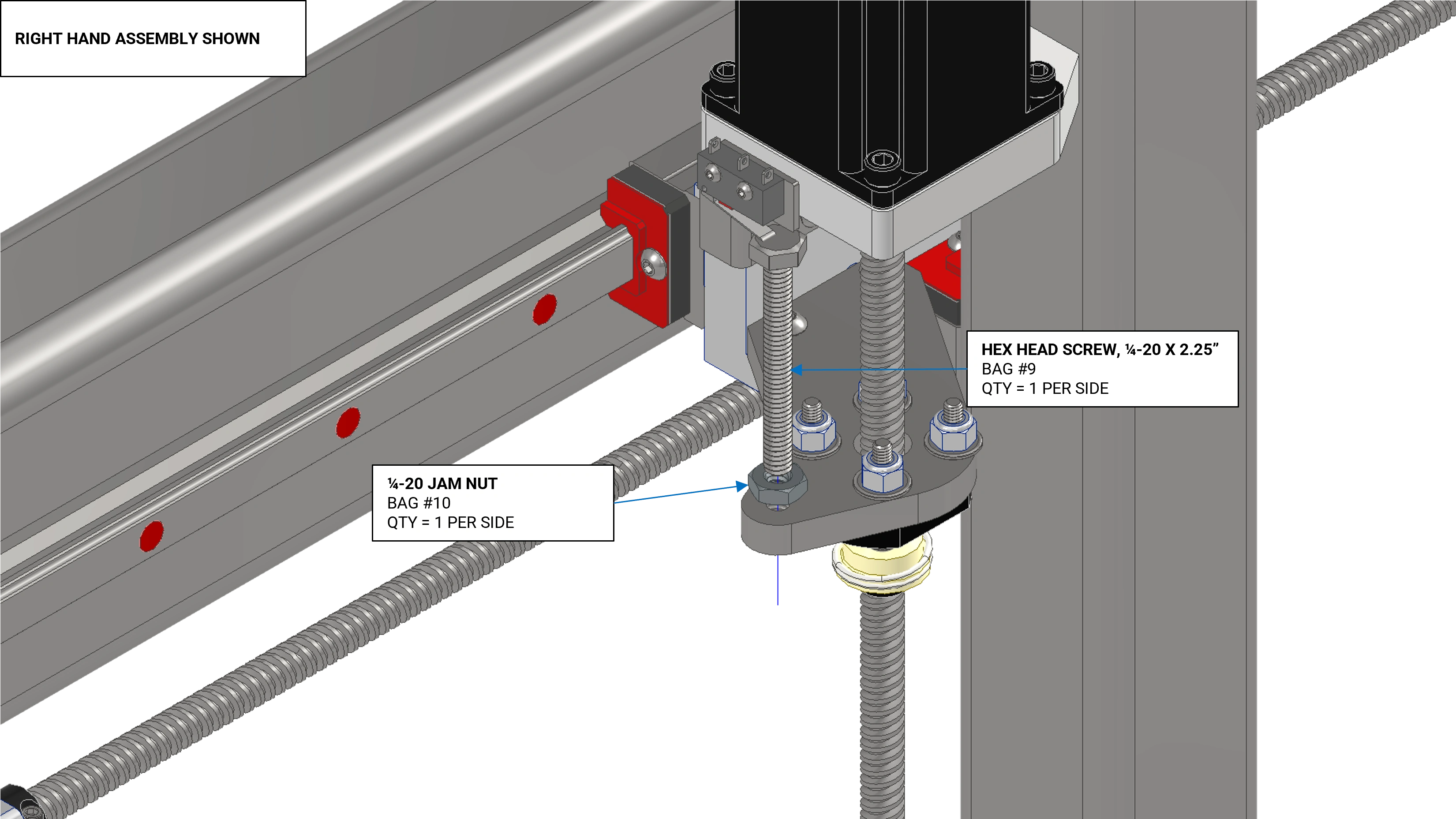

Materials
Parts
Hardware
  • (1) HEX HEAD SCREW, ¼-20 X 2.25”
  • (1) ¼-20 JAM NUT
Tools
  • 7/16 Wrench
Instructions
  1. Thread the ¼-20 jam nut approximately 1.5” up the hex head screw.
  2. Thread the hex head screw into the R-Axis Lead Nut Mount Tab as shown. At Least 1” of thread should protrude from the bottom of the mount tab.

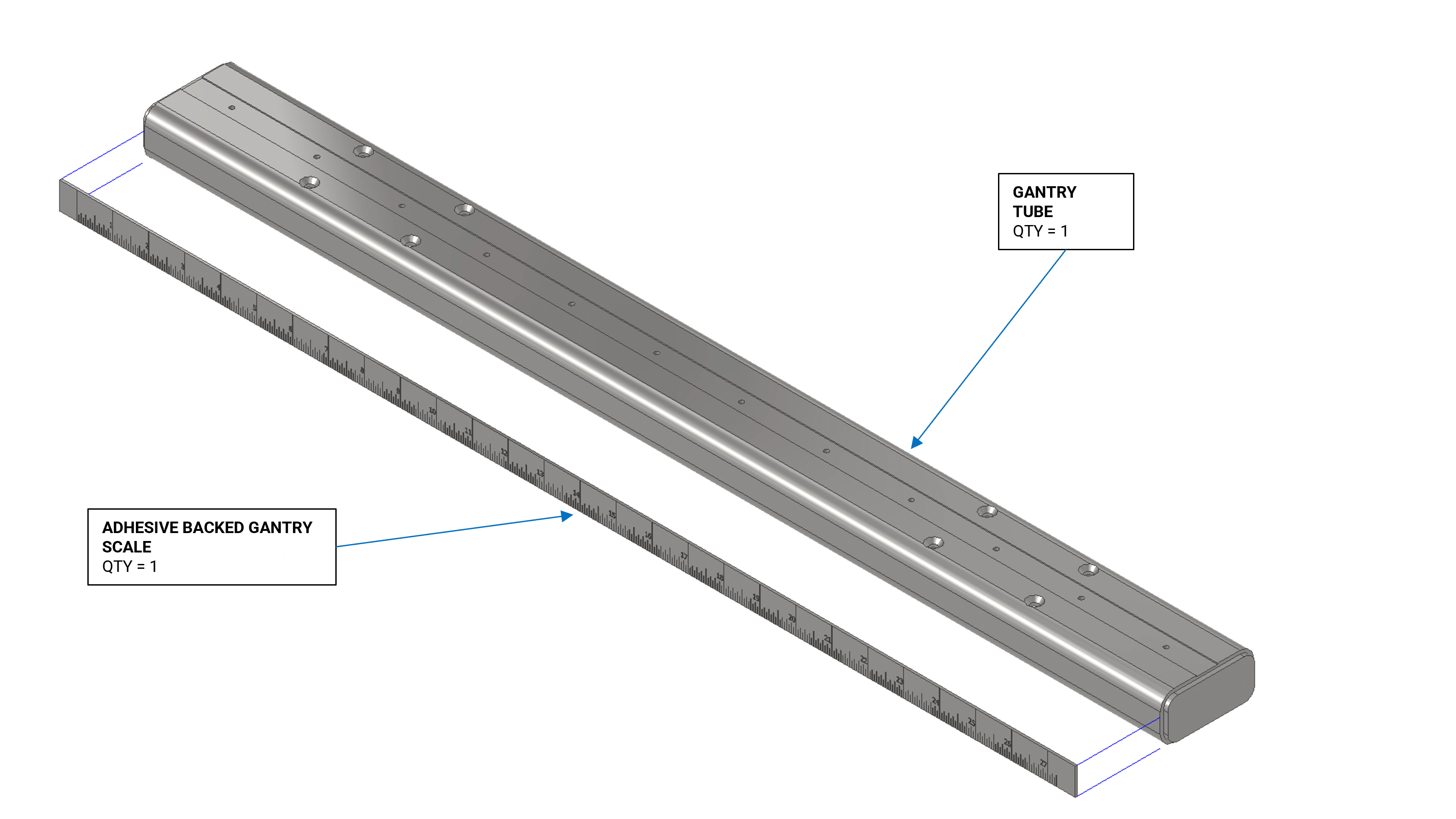

  • (1) Gantry Tube
  • (1) Adhesive Backed Gantry Scale
Hardware
Tools
  • Scissors or Tin Snips
  • Towel or paper towel
  • Rubbing alcohol
Instructions
  1. Cut of the excess blank section at the beginning of the Adhesive Backed Gantry Scale then cut to a length of 28-¼”.
  2. Wipe down the Gantry Tube with rubbing alcohol to remove any oil that may affect adhesion of the scale.
  3. Remove the protective film from the back of the Adhesive Backed Gantry Scale.
  4. Attach the Adhesive Backed Gantry Scale to the Gantry Tube as shown. Ensure the Scale is vertically and horizontally centered on the side face of the Gantry Tube. Apply firm pressure along the entire scale to ensure good adhesion to the tube.

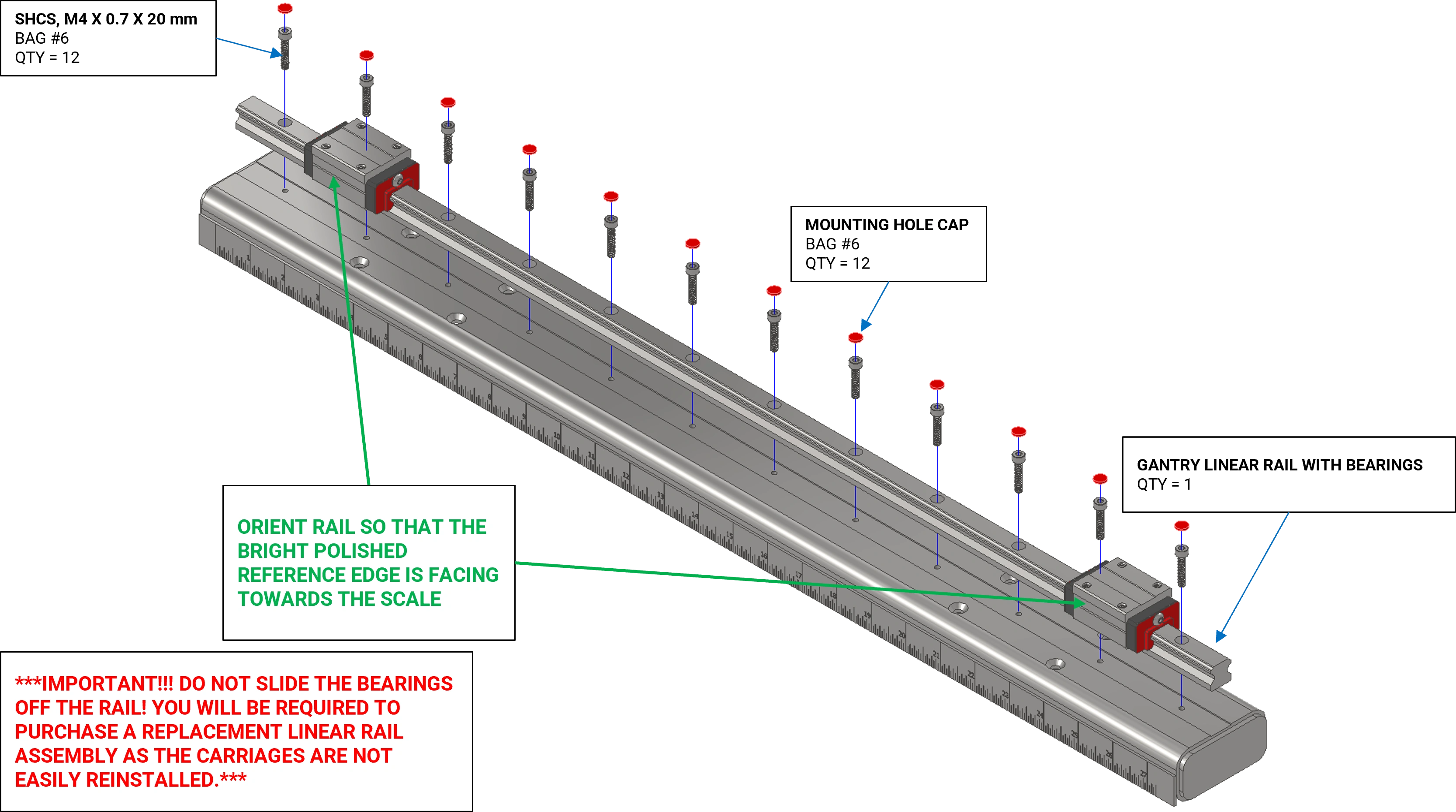

Materials
Parts
  • (1) Gantry Linear Rail with Bearings
  • (12) Mounting Hole Cap
Hardware
  • (12) SOCKET HEAD CAP SCREW, M4 X 0.7 X 20 mm
Tools
  • 3mm Hex Key
Instructions
  1. Locate the Gantry Linear Rail and Bearing assembly. Note that the Gantry Linear Rail is 28.25” in length. Be sure to install the correct one.
    Important Note
  3. Thoroughly clean and brush the Gantry Tube mounting surface as well as the bottom surface of the linear rail. Any debris in these critical joints will decrease the accuracy of the backgage.
  4. Install the Gantry Linear Rail using the fasteners shown.
    WARNING
Materials
Parts
  • (2) Finger Lower Bracket
  • (2) Scale Pointer
  • (2) Linear Rail Hand Brake
Hardware
  • (16) SOCKET HEAD CAP SCREW, M4 X 0.7 X 10 mm (8 per side)
Tools
  • 3mm Hex Key
  • 2.5mm Hex Key
Instructions
  1. Remove one grease plug from each Linear Rail Bearing Block, on the face that will sit coincident with the Linear Rail Hand Brake.
  2. Slide the Linear Rail Hand Brakes onto the linear rail until they are coincident with the sides of the Linear Rail Bearing Blocks.
  3. Install the Finger Lower Brackets, Brake Mount Brackets, and Scale Pointers on to the linear bearing blocks and brakes using the fasteners as shown.

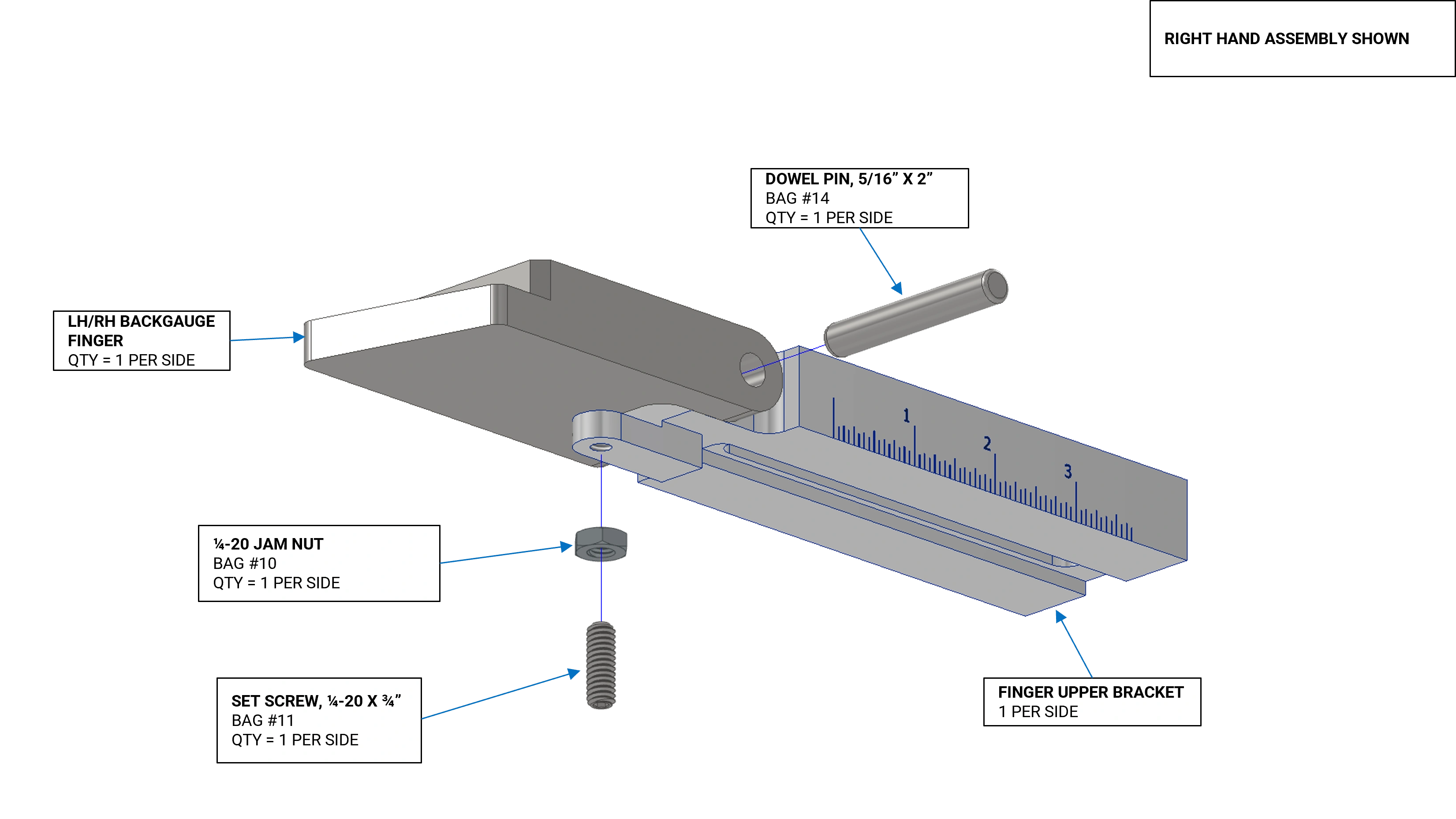

Materials
Parts
  • (2) Finger Upper Bracket
  • (1) Left Hand Backgauge Finger
  • (1) Right Hand Backgauge Finger
Hardware
  • (2) SET SCREW, ¼-20 X ¾”
  • (2) ¼-20 JAM NUT
  • (2) DOWEL PIN, 5/16” X 2”
Tools
  • 7/16” Wrench
  • ⅛” Hex Key
Instructions
  1. Thread the jam nut on to the set screw.
  2. Thread the set screw into the Finger Upper Bracket as shown.
  3. Line up the mounting hole on the Finger Upper Bracket and the Right Hand Backgauge Finger as shown.
  4. Insert the dowel pin in to the Finger Upper Bracket and Backgauge Finger mounting holes, as shown, to attach the Backgauge Finger to the Finger Upper Bracket.
  5. Adjust the set screw such that the Backgauge Finger is level with the Backgauge Finger Upper Bracket.
  6. Tighten the jam nut to lock the set screw into position.
  7. Repeat steps 1-6 for the Left Hand Finger Assembly.

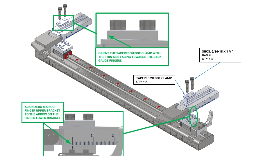

Materials
Parts
  • (2) Tapered Wedge Clamp
Hardware
  • (4) SOCKET HEAD CAP SCREW, 5/16-18 X 1 ⅜” (2 per side)
Tools
  • ¼” Hex Key
Instructions
  1. Attach the Backgauge Finger Assemblies to the Finger Lower Brackets using the fasteners and Tapered Wedge Clamps as shown. Attach the Backgauge Finger Assemblies to the Finger Lower Brackets using the fasteners and Tapered Wedge Clamps as shown. Orient the angled face of the Tapered Wedge Clamp down towards the Finger Upper Brackets, with the thin side of the clamp facing towards the Backgauge Finger. When installed correctly, the socket head cap screws will rest flat on the upper surface of the clamp, as shown.
  2. Adjust to position of the Finger Upper Brackets such that the arrows on the Finger Lower Brackets points to the zero marks on the Upper Brackets.

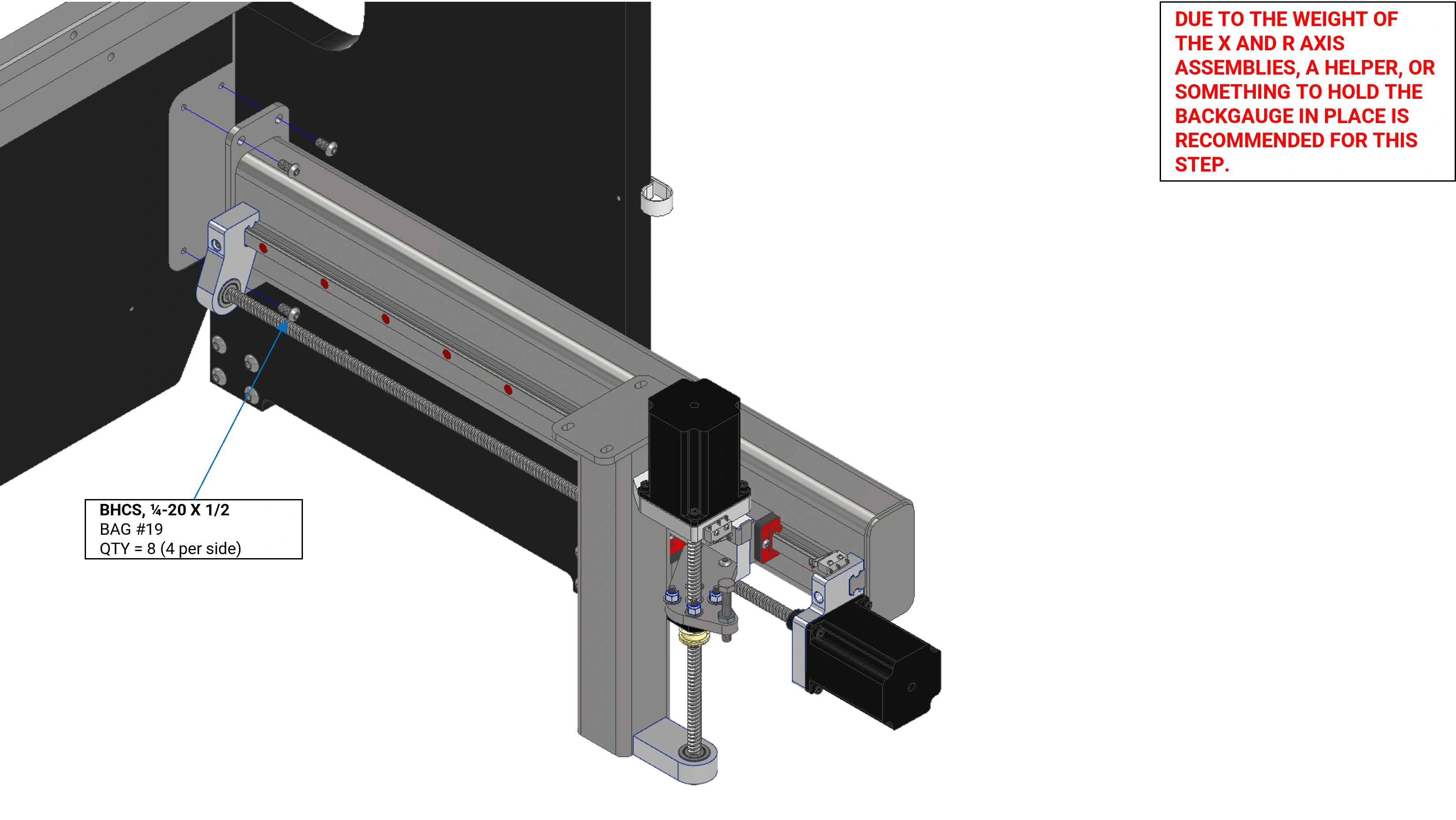

5: Backgauge Installation and Wire Management
The next step in the assembly process is to attach the Backgauge to the TITAN 25T and install the wire management.
Materials
Parts
  • (1) Backgauge X-axis R-axis and Gantry Assemblies (Previously Assembled)
Hardware
  • (8) BUTTON HEAD CAP SCREW, ¼-20 X ½” (4 per side)
Tools
  • 5/32 Hex Key
Instructions
  1. Attach the Left Hand X and R-axis Assemblies to the Press Brake with the fasteners as shown, leaving the cap screws ¼ turn from tight.
  2. Repeat step 1 for the Right Hand X and R-Axis Assemblies.

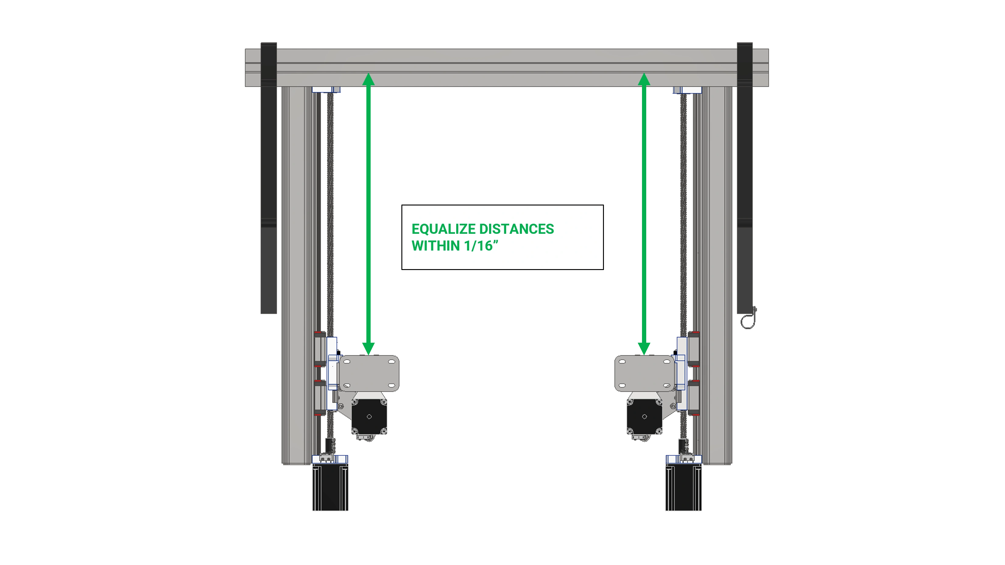

Materials
Parts
  • N/A
Hardware
  • N/A
Tools
  • Tape Measurer
  • 7/16” Wrench
Instructions

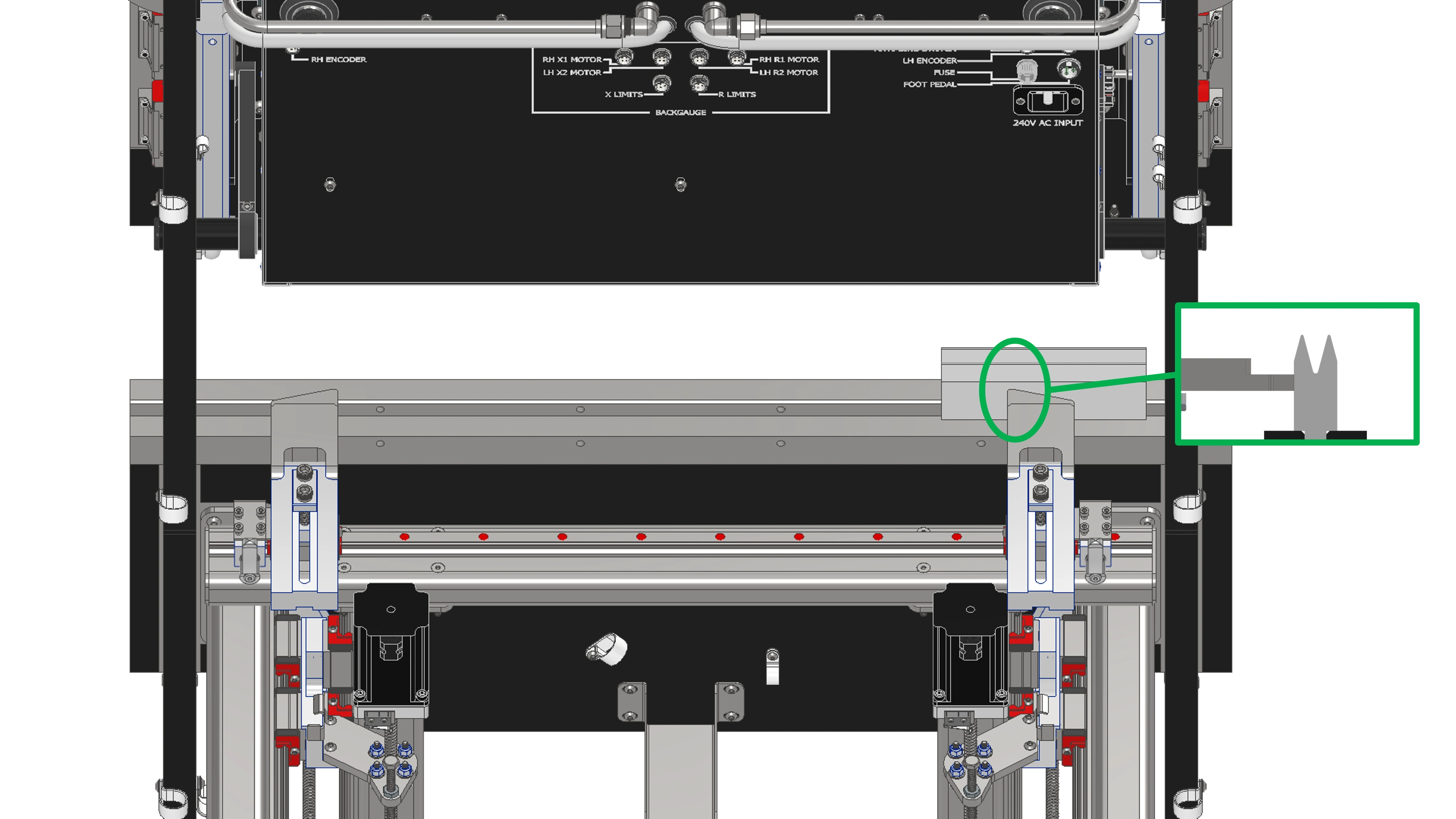

  1. Equalize the distance from the front edge of each R-Axis Plates to the rear edge of the table slot within 1/16” by rotating the ¼-20 lock nut on the X-Axis Lead Screws.
Materials
Parts
  • N/A
Hardware
  • N/A
Tools
  • Tape Measurer
  • 7/16” Wrench
Instructions

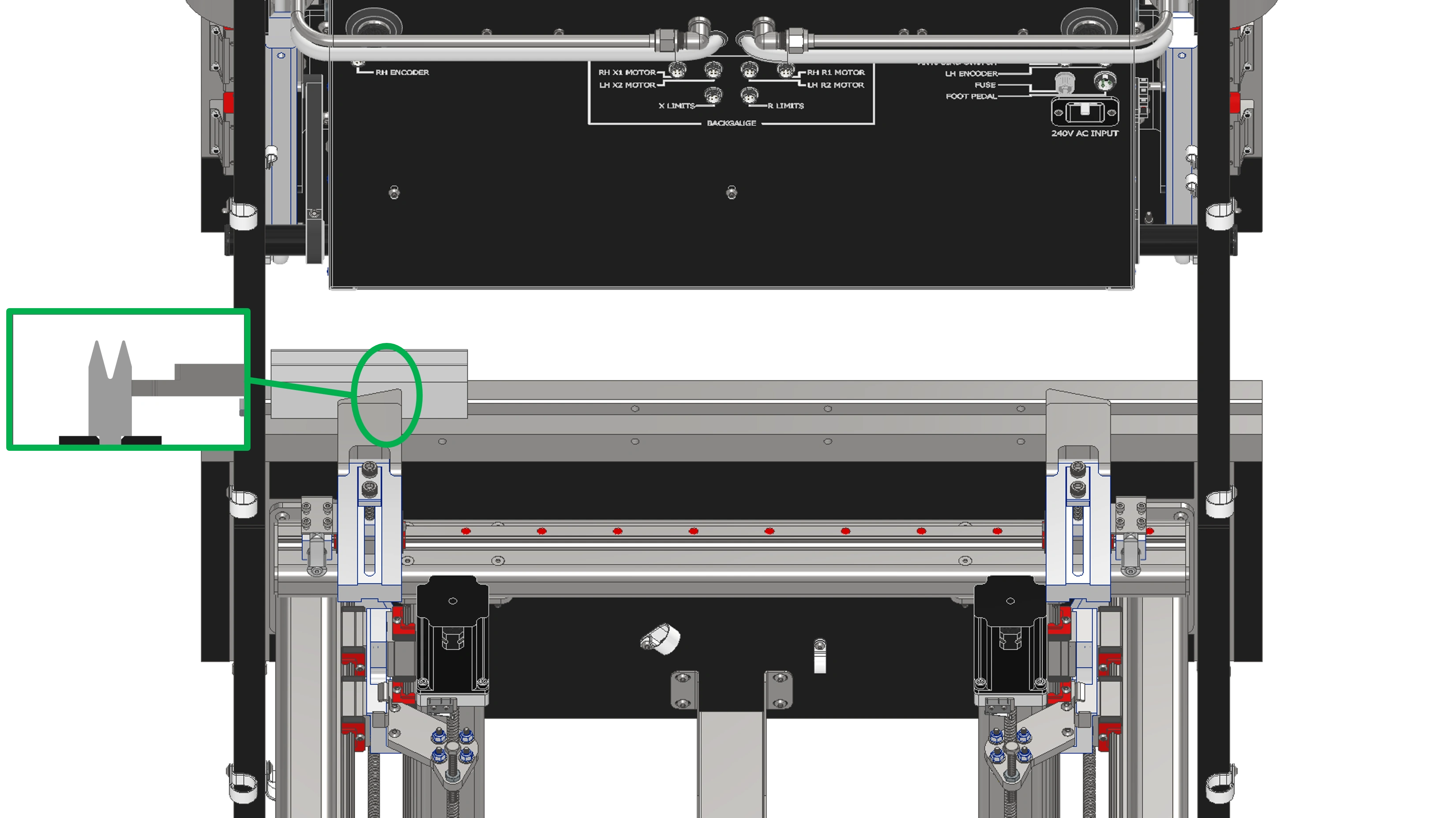

  1. Equalize the distance from the top face of each R-Axis Plates to the top face of the X-Axis Carriage Plate slot within 1/16” by rotating the ¼-20 lock nut on the R-Axis Lead Screws.
Materials
Parts

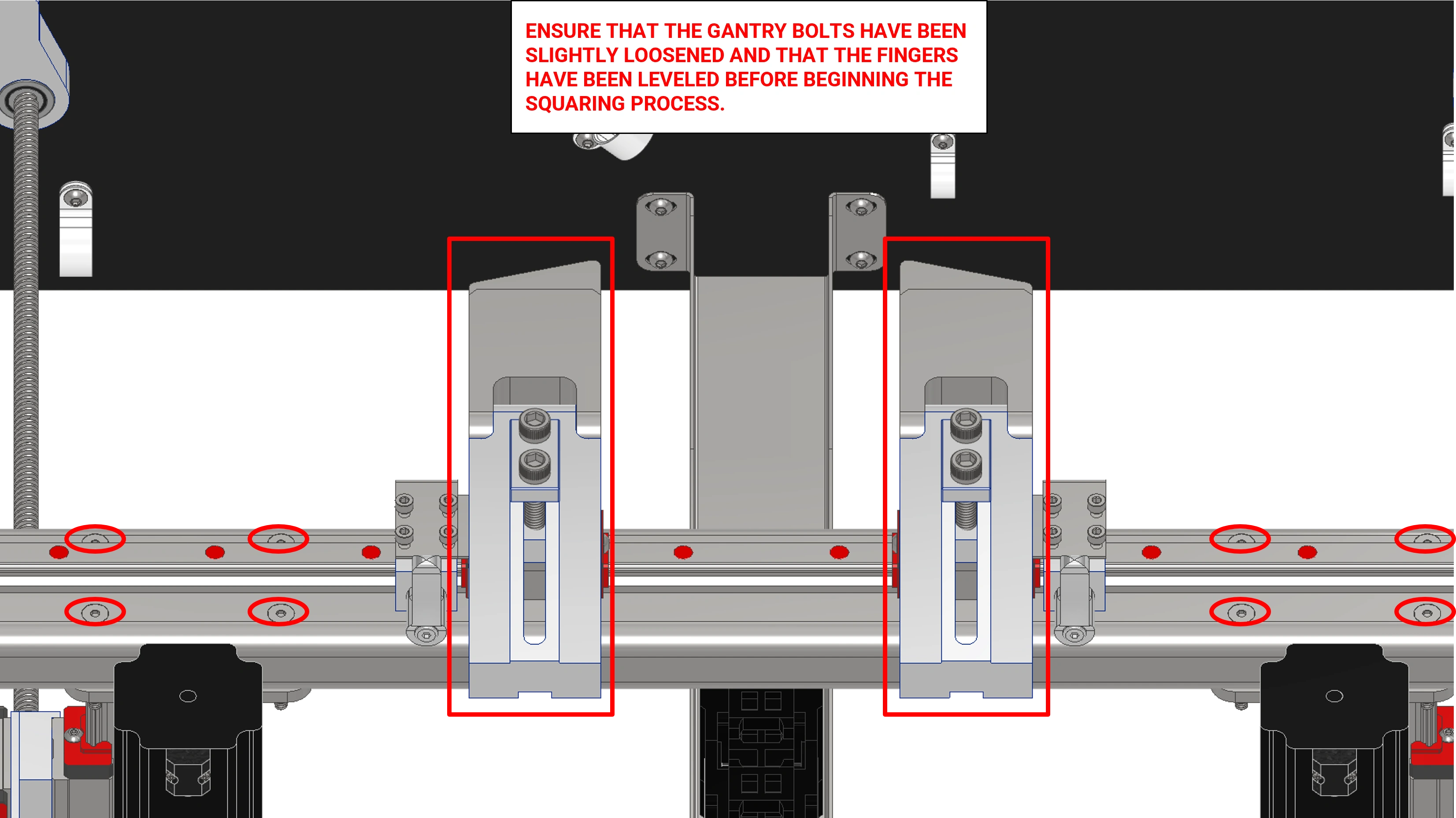

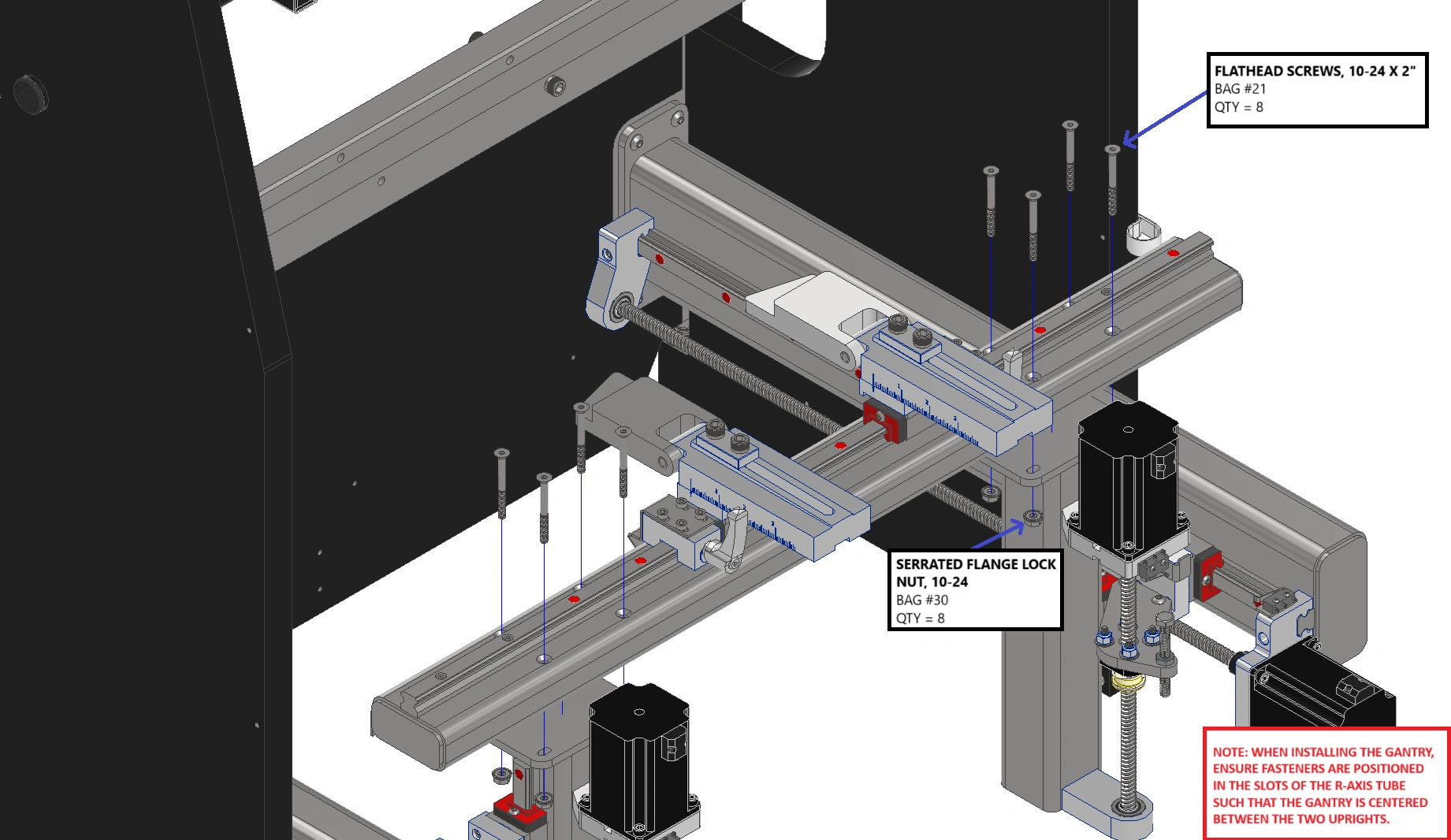

  • (1) Gantry Tube Assembly (Previously Assembled)
Hardware
  • (8)FLATHEAD SCREW, 10-24 X 2.25”
  • (8)10-24 SERRATED FLANGE NUT
Tools
  • 1/8” Hex Key
Instructions
  1. Install Gantry Tube onto R-Axis Tube as shown. Ensure the Adhesive Backed Gantry Scale is oriented such that the fingers point towards the table and the scale will be visible when operating the machine.
  2. Tighten the 8, 10-24 socket head screws securing the X-Axis Tubes to the table of TITAN.
  3. Only after completing D2, break loose the flathead screws that were previously tightened in D1, these will be tightened later in section 6 Step C4.

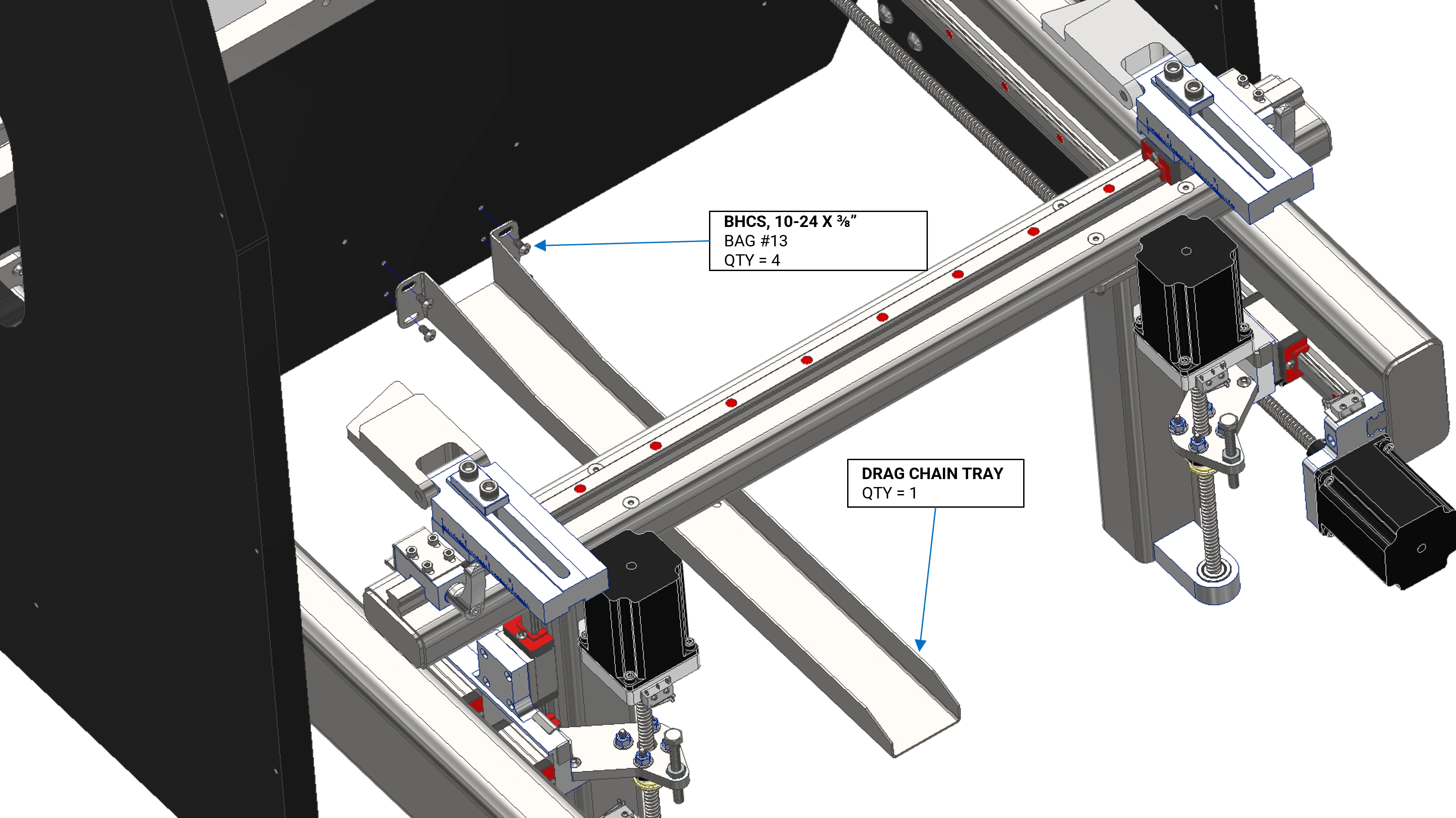

  • (1) Drag Chain Tray
Hardware
  • (4) BUTTON HEAD CAP SCREW, 10-24 X ⅜”
Tools
  • 1/8 Hex Key
Instructions
  1. Attach the Drag Chain Tray to the Press Brake with the fasteners as shown.
Materials
Parts
  • (1) Drag Chain
Hardware
  • (4) BUTTON HEAD CAP SCREW, 8-32 X 0.5”
  • (2) 8-32 SERRATED FLANGE NUT
Tools
  • 9/64 Hex Key
Instructions

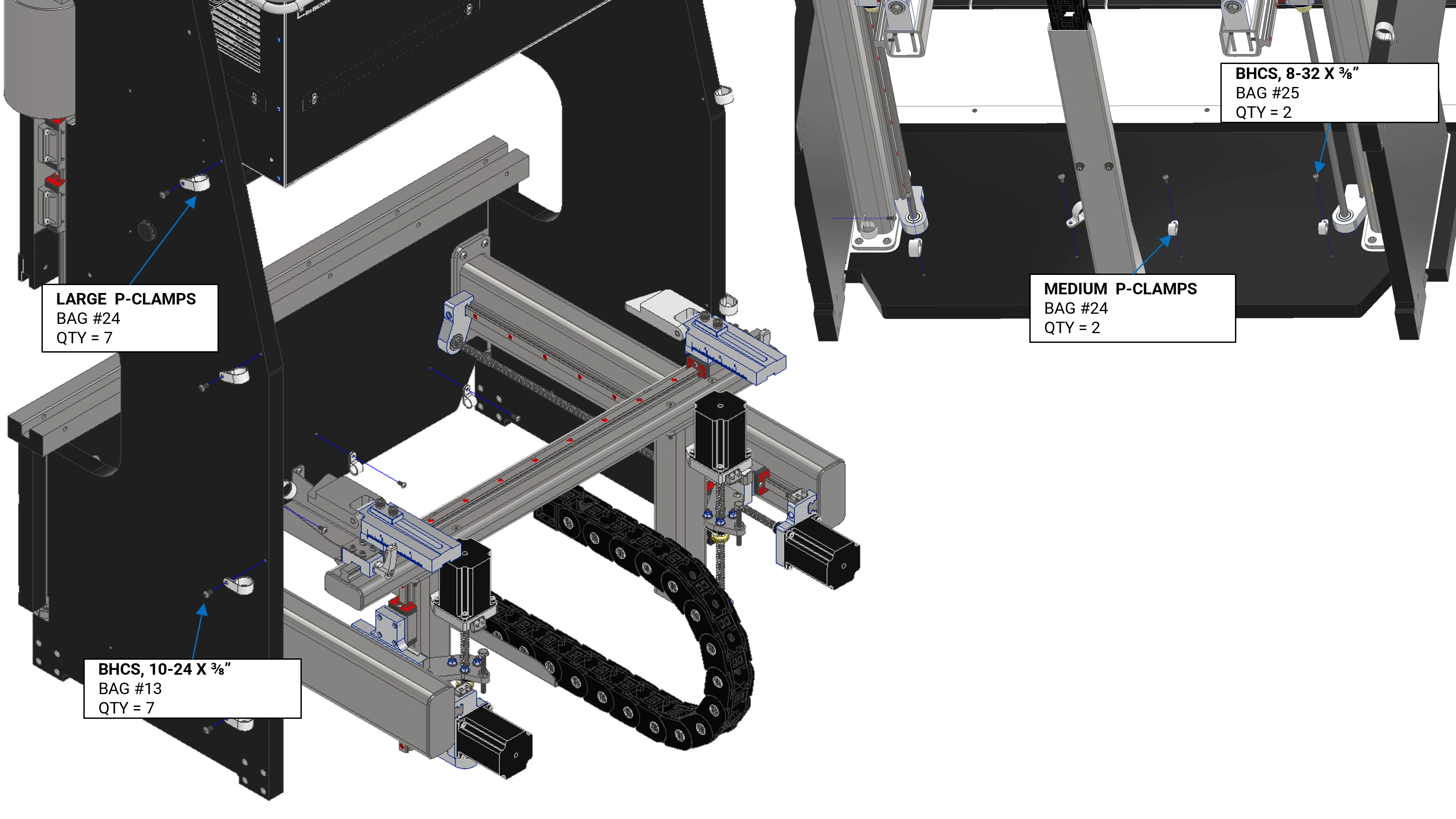

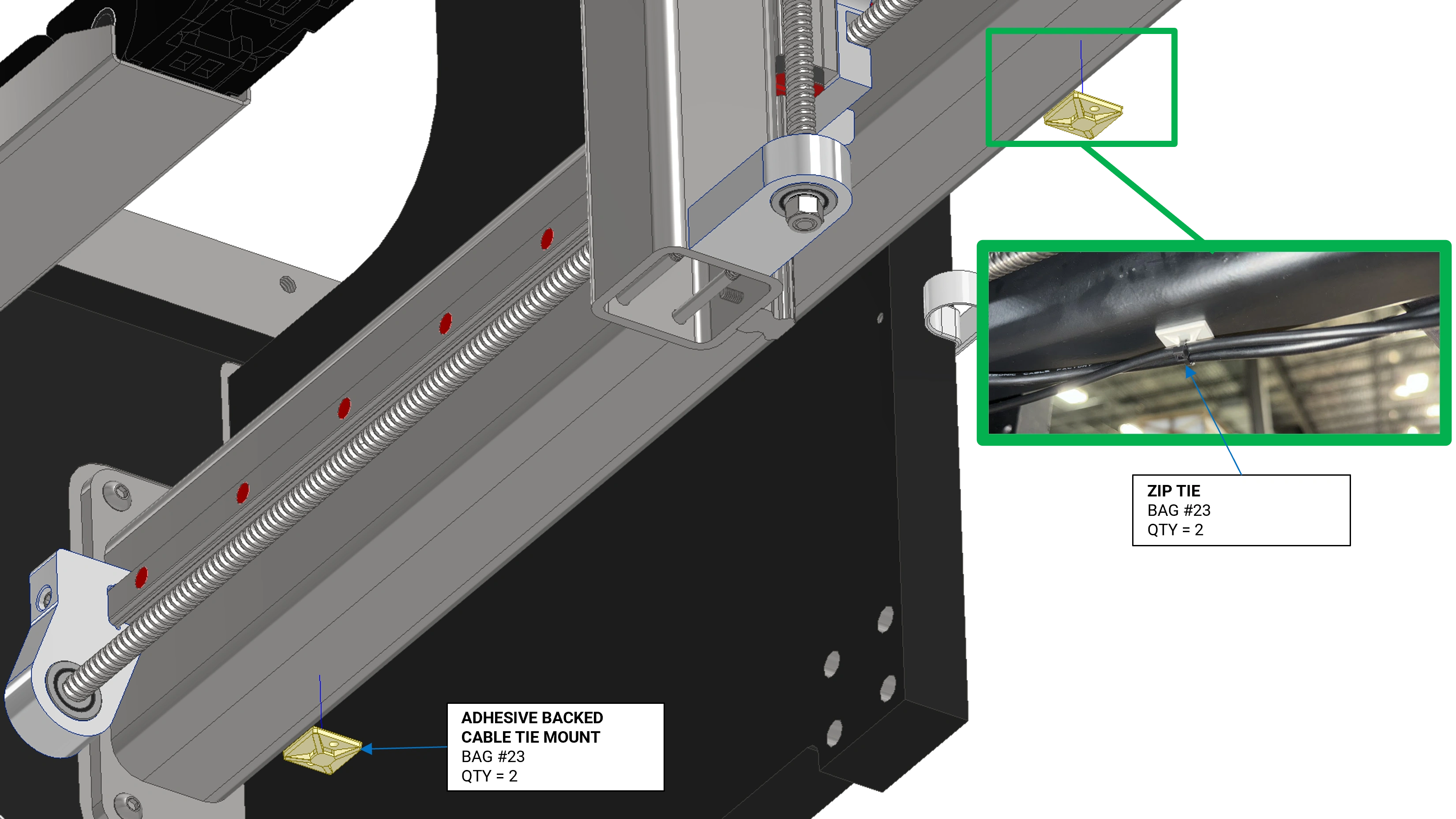

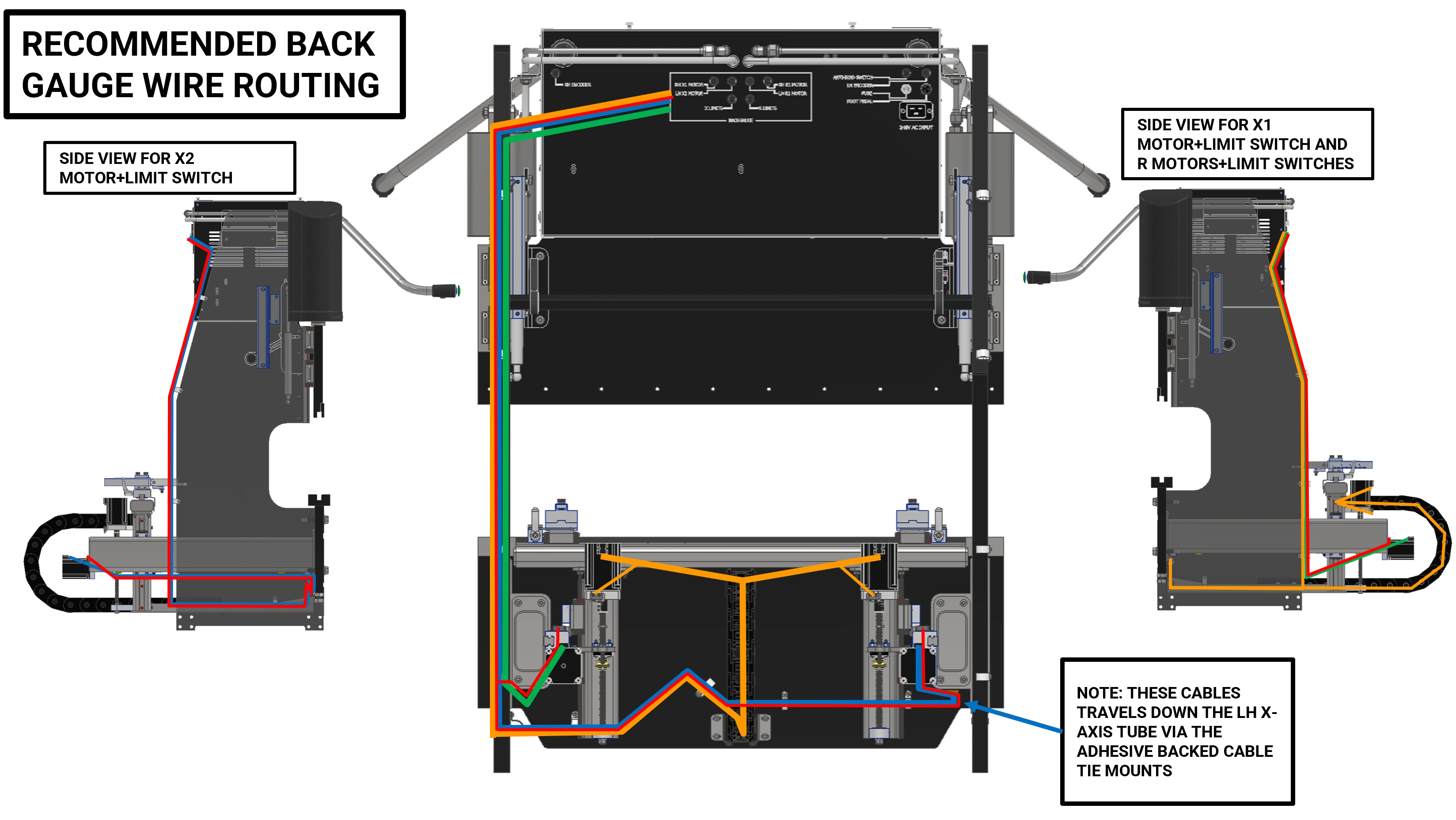

  1. Run all wires from the Backgauge R-axis motors and R-axis limit switches, through the Drag Chain and out into the Drag Chain Tray
  2. Attach the Drag Chain to the Press Brake and Backgauge with the fasteners as shown.

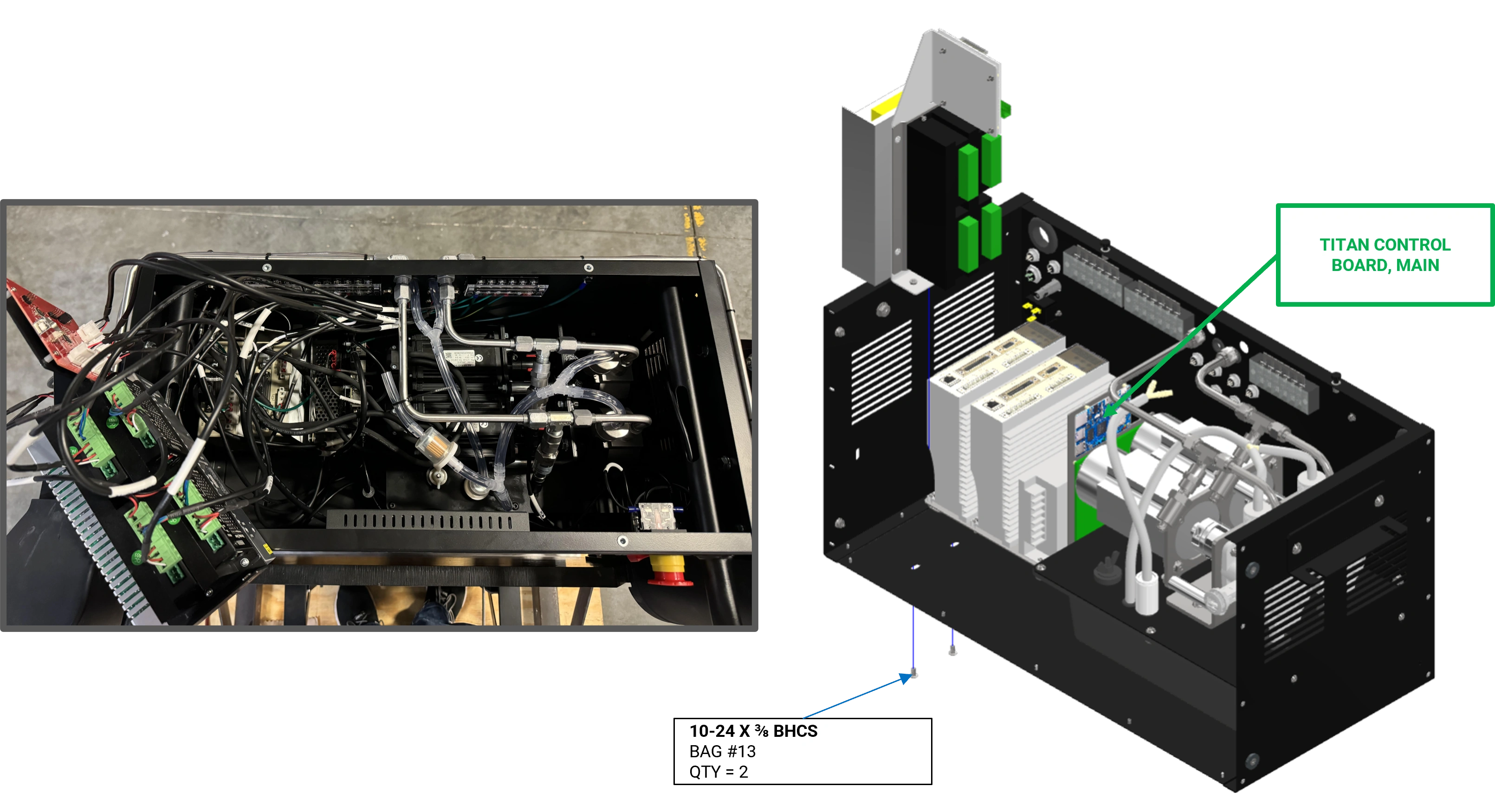

Materials
Parts

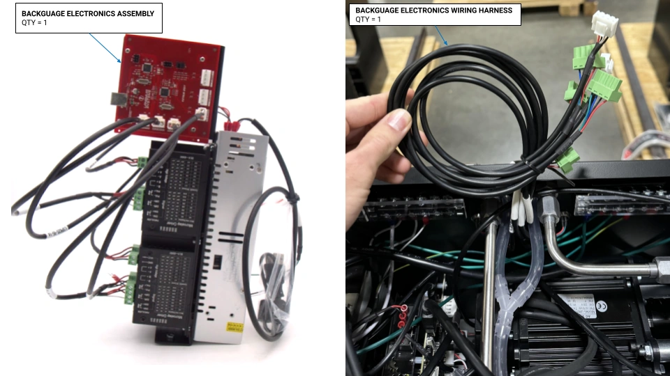

  • (1) Backguage Electronics Assembly
Hardware
Tools
Instructions
WARNING SYMBOL: ELECTRIC SHOCK
Important Note
The Titan 25T should be powered off with the power cable completely disconnected prior to beginning this step. Failure to remove power from the Titan 25T while working in the electronics enclosure can result in electric shock that may cause serious injury or death.
  1. Locate the Backgauge Electronics Assembly and remove the Zip tie securing the USB A to USB B cable to the unit. Set the bagged cable aside for later installation.
  2. Remove the lid from Titan’s Electronic enclosure by removing the 4 thumb screws located on top of the enclosure.
Materials
Parts
  • (Pre-Installed) Backguage Electronics Wiring Harness
Hardware
  • (4) M15 THIN
    HEX NUT
Tools
  • M15
    Wrench

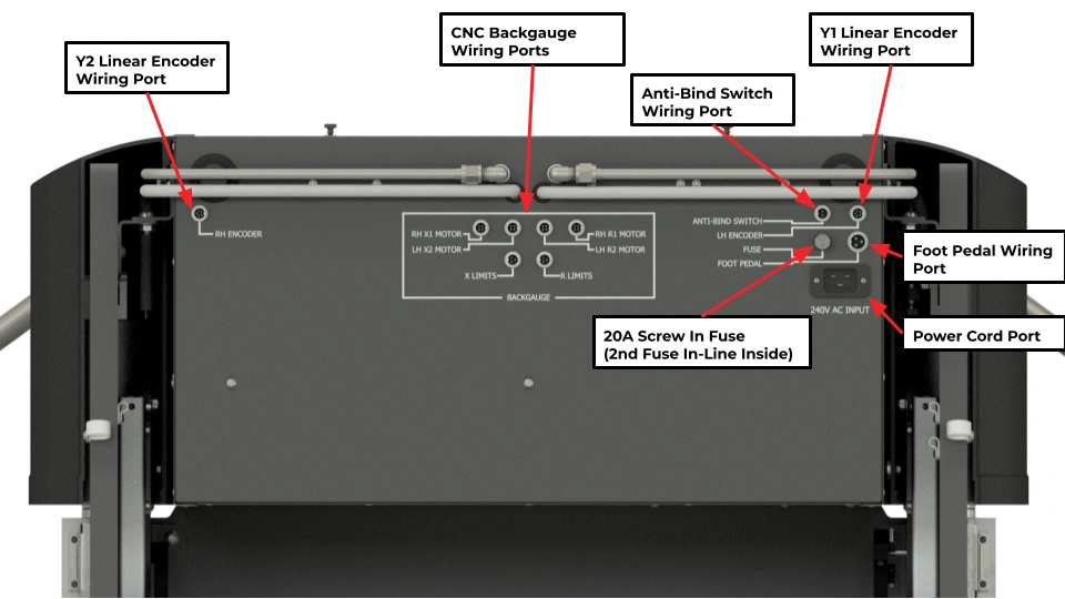

Instructions

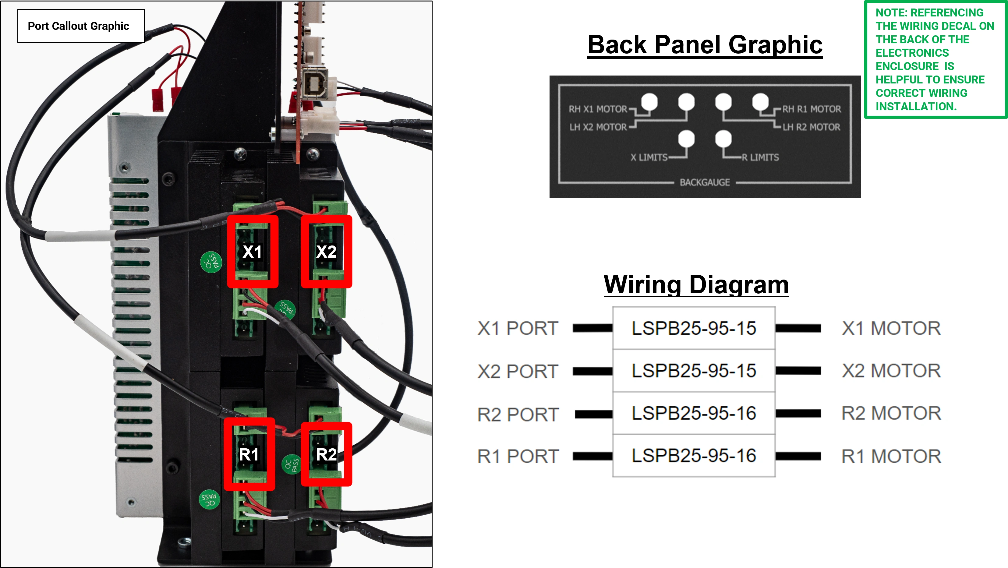

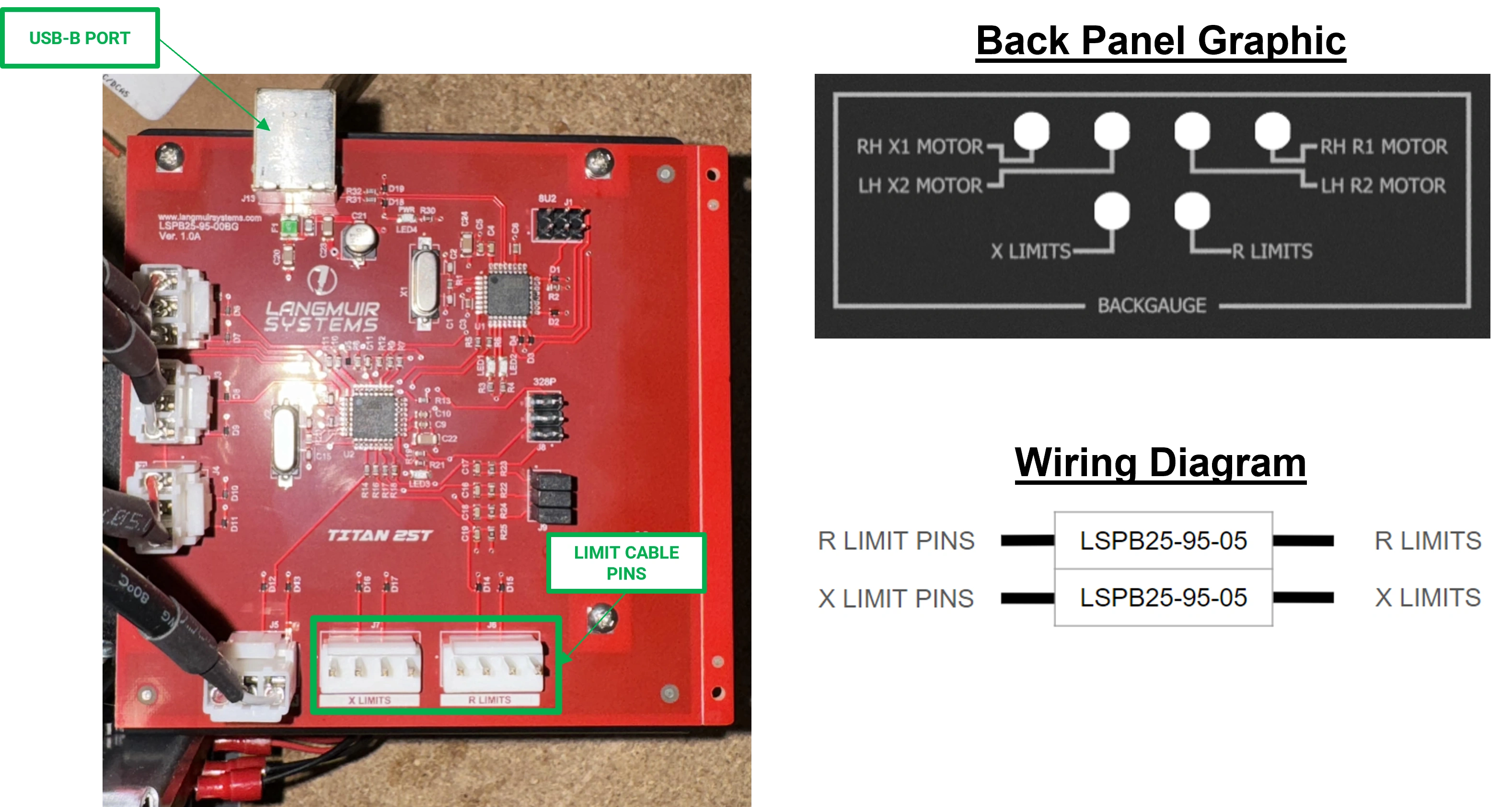

  1. Locate wires LSPB25-95-15 (2x) and LSPB25-95-16 (2x) for the Backguage Electronics Wiring Harness.
  2. Using the provided wiring diagram and the port callout graphic insert the panel interconnects into the corresponding cutouts on the back of the Electronics Enclosure.
  3. Secure each panel interconnect by threading one M15 THIN HEX NUT on to each interconnect.
  4. Using the provided wiring diagram and the port callout graphic insertthe green plug connectors into their respective ports on the Backgauge Electronics Assembly.

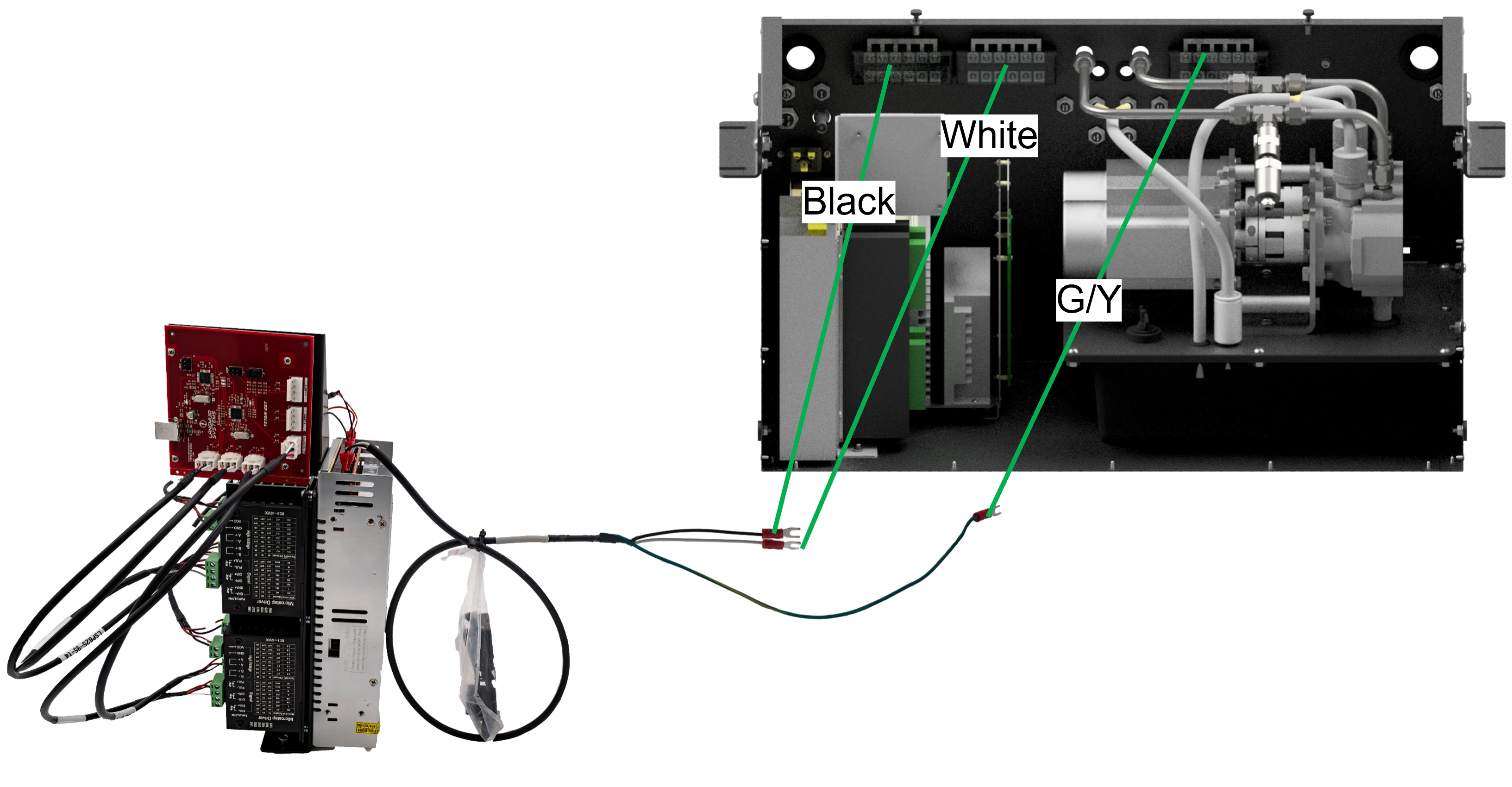

Note
The graphic located on the back panel of the Titan 25T Electronics Enclosure is especially helpful to reference during this step to ensure that the correct motor corresponds to the correct port on the Backguage Electronics.
Materials
Parts
Hardware
  • (2) M15 THIN
    HEX NUT
Tools
  • M15
    Wrench
Instructions
  1. Locate the two LSPB25-95-05 (2x) wires for the Backguage Electronics Wiring Harness.
  4. Using the provided wiring diagram, install the white cable connectors onto the respective labeled pins located on the Backgauge Assembly's control board.

  1. Orient the Backguage Electronics Assembly vertically such that the metal mounting flange aligns with the mounting slot features located on the underside of the Titan 25T electronics enclosure as shown.
  2. Slowly lower the wired Backguage Electronics Assembly into the electronics enclosure and secure in place using the provided 10-24 x ⅜ BHCS.
  3. At this time, locate the USB-A to USB-B cable that came with the Backguage Electronics Assembly. Inside the Titan 25T electronics enclosure, locate the main Titan control board and identify the remaining available USB-A port located on the board.
  4. Install the USB-A to USB-B cable that came with your backguage electronics assembly into the USB-A port located on the main Titan control board and into the USB-B port located on the Backguage Electronics Assembly Board such that the two boards are connected via the cable.
Materials
Parts
Hardware
Tools
  • Phillips Head Screwdriver
Instructions
  1. Locate the LSPB25-95-12 cable on the Backgauge Electronics Assembly.
  2. Remove the clear plastic covers located on the three terminal blocks at the back of the electronics enclosure.
  3. On each of the exposed terminal blocks, locate an unused terminal and back out the screw until the spade fork from the Backguage Electronics Assembly can fit into the terminal.
  5. Install each of the spade forks into their respective terminals as shown and tighten the down the terminal. If done correctly, all other wires in the terminal blocks will be the same color as the wire installed into each respective terminal block.
  6. Reinstall the clear plastic covers onto the terminal blocks.
Materials
Parts
  • (4) Motor Cables - 4 Pin Connector End
  • (2) Limit Switch Cables - 3 Pin Connector End
Hardware
Tools
Instructions
  1. Locate the 4 motor wires (connector/plug end) that install into the back of the Titan 25T Electronics Enclosure.
  2. Each of the four motors are labeled with a unique part number. Similarly, this part number is applied to a label adjacent to the plug at the end of the cable. Use the ‘Motor Part Numbers’ table to determine which ports on the back of the electronics enclosure these motor cables must be connected to. For example, a cable with part number LS-PBRK-1616-2 belongs to the R2 motor and therefore should be plugged into the R2 Motor Port.
  3. Note
    The plugs are directional and have a built in keyway to determine the orientation of the connector.
  4. Locate the X-Axis limit switch cable and insert the connector end into the electronics enclosure plug.
  5. Repeat step G3 for the R-axis Limit Switch cable.
  6. Ensure the wiring is installed correctly to the electronics enclosure and that the limit switch pigtails are matched by colors (Red to Red & Black to Black) when installing them onto the end of the cable.
Materials
Parts
  • (7) Large P-Clamps
  • (2) Medium P-Clamps
Hardware
  • (7) BUTTON HEAD CAP SCREW, 10-24 X 3/8”
  • (2) BUTTON HEAD CAP SCREW, 8-32 X ⅜”
Tools
  • ⅛ Hex Key
  • 3/32 Hex Key
Instructions
  1. Insert the Backgauge wires into the P-Clamps and install using the fasteners as shown.
Materials
Parts
  • (2) Adhesive Backed Cable Tie Mount
Hardware
  • (2) ZIP TIES
Tools
  • Scissors or wire cutters
  • Rubbing alcohol
Instructions
  1. Wipe down the bottom surface of the Left Hand X-Axis Gantry Tube with rubbing alcohol.
  2. Remove the protective backing from the Adhesive Backed Cable Tie Mounts.
  3. Apply one Adhesive Backed Cable Tie Mount to each end of the bottom surface of the Left Hand X-Axis Gantry Tube. Exact placement of these mounts is not important as long as there is sufficient space between the mounts.
  4. Gather all wires that travel down the Left Hand X-Axis Tube to the P-Clamps and secure them to the Cable Tie Mounts with zip ties, as shown.

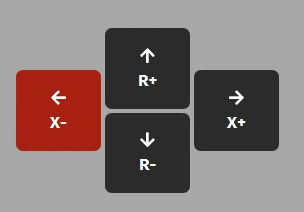

  1. Ensure Backgauge Wiring is complete and the machine can be jogged as detailed in the TITAN Quickstart guide.
  2. Jog the Backgauge forward and up, until the R-Axis Lead Nut is within 1” of the R-Axis Bearing Mount and the X-Axis Bearing Block is within 1” of the X-Axis Bearing Mount.
  3. Tighten the fasteners securing the R and X-Axis Lead Nuts, which were previously left ¼ turn from tight.
  4. Jog the Backgauge in both X and R directions through full length of travels to ensure that it jogs properly without issue.

  1. Prior to beginning the Backgauge squaring process, ensure that the gantry bolts have been loosened (¼ turn from tight) and that the fingers have been leveled. These steps will have already been completed in the Backgauge assembly process, but if you are re-squaring your machine, are required to complete the squaring process.
Materials
Parts
  • N/A
Hardware
  • N/A
Tools
  • American Standard Die
  • 7/16” Wrench
  • ⅛” Hex Key
Instructions

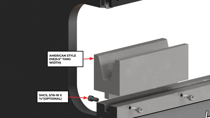

  1. Ensure that the Backgauge is fully set up and powered on before beginning the final squaring process.
  2. Place an American Standard Die in the die slot and slide it all the way to the right side of the Press Break.
  3. Slowly jog the Backgauge and adjust the position of the Backgauge Fingers until the right finger is barely touching the back side of the die, as shown.

  1. Slide the die to the far left side of the table.
  2. Unplug the X1 X-Axis Motor on the Backgauge and rotate the X-Axis Lead Screw by hand, or by turning the ¼-20 locknut, until the left finger is barely touching the side of the die.
  3. Plug back in the X1 X-Axis Motor on the Backgauge.
  4. Tighten the 8, 10-24 Flat Head Screws securing the Gantry.

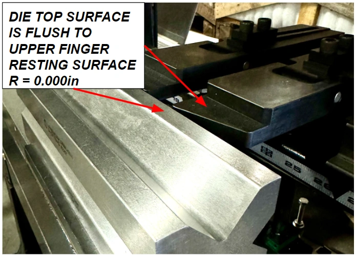

  1. Jog the Backgauge so both Backgauge Fingers are above the top of the table.
  2. Using the Hand Brakes, adjust the Backgauge Fingers to their furthest left and right positions.
  3. Jog the Backgauge forward until both fingers sit above the die table.
  4. Slowly step the Backgauge down until at least one finger makes light contact with the die table.
  5. If only one finger made contact with the die table. Unplug the R-Axis Motor nearest to the finger that is not contacting the die table and rotate the R-Axis Lead Screw by hand, or by turing the ¼-20 locknut, until it is lightly contacting the table.
  6. Plug the R-Axis Motor cable back in.

  1. Jog the Backgauge back until the R-Axis Lead Nut Mount Tabs are within ⅛” of the X-Axis Motor mounts.
  2. Loosen the fasteners securing the X-Axis Limit Switch Tabs and slide them forward, until both X-Axis Limit Switches are just barely triggered on both sides. At the trigger point on the limit switches, there should be an audible click. Tighten the fasteners securing the X-Axis Limit Switch Tabs. Note: It is very important that the X-Axis Limit Switch Tabs are secured in the exact location that triggers the limit switch. If this is not done accurately, it will reduce the positioning accuracy of the back gauge.
  3. Jog the Backgauge forward such that both X-Axis Limit Switches are no longer triggered.

  1. Jog the Backgauge down until the R-Axis Linear Bearing Blocks are within ⅛” of the Gantry Tube nuts or the end of the linear rail.
  2. Loosen the jam nuts securing the R-Axis Limit Switch screws and thread them up until both R-Axis Limit Switches are just barely triggered on both sides. At the trigger point on the limit switches, there should be an audible click. Tighten the jam nuts to secure the R-Axis Limit Switch screws. Note: It is very important that the screws are secured in the exact location that triggers the limit switch. If this is not done accurately, it will reduce the positioning accuracy of the back gauge.
  3. Jog the Backgauge up such that both R-Axis Limit Switches are no longer triggered.

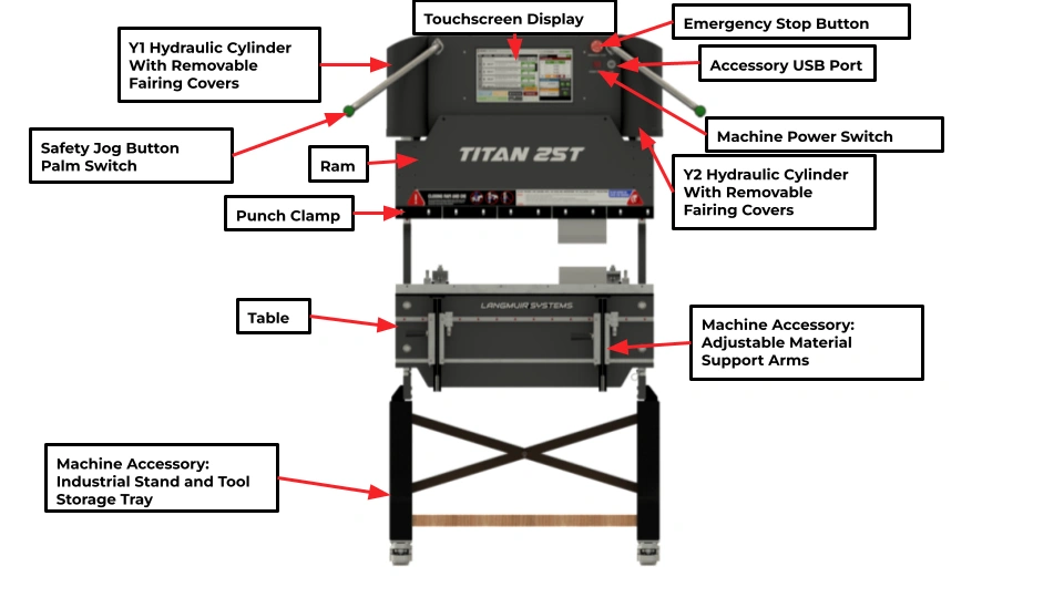

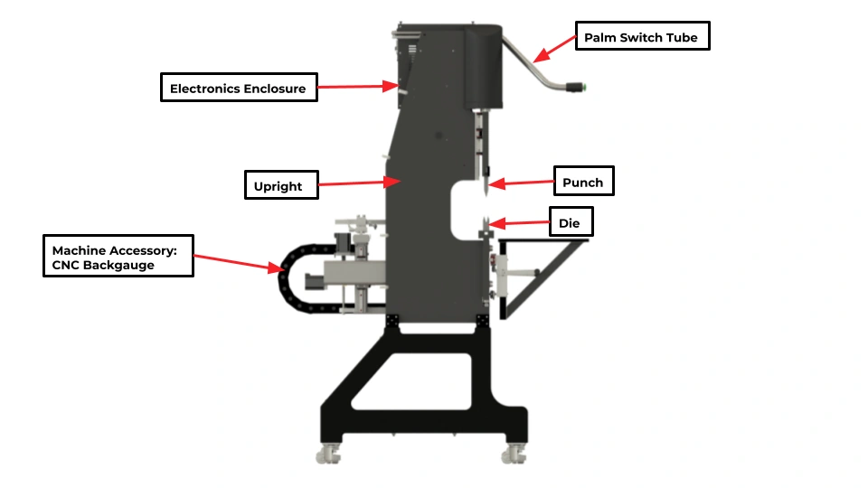

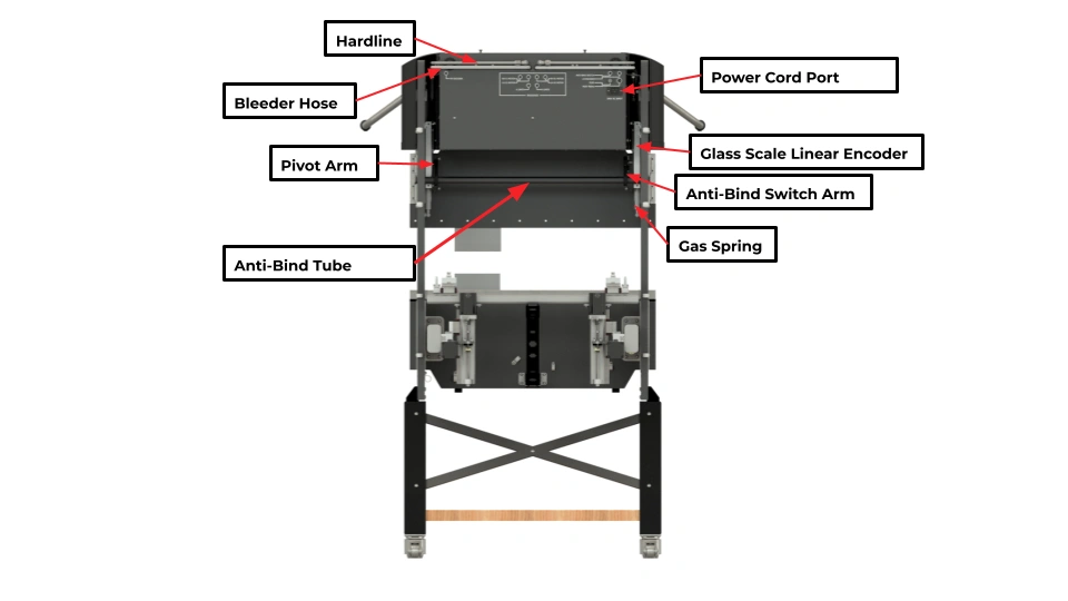

IV. Machine Overview
Front
Side
Back
ELECTRONICS PANEL

1. Power Requirements and Wiring
A. Input Power Requirements:
The Titan 25T CNC Press Brake requires a stable and sufficient power source to operate correctly. Ensure that your power source meets the following specifications. If you have any doubts or require further assistance, consult a qualified electrician.
  • Supply Voltage: 208 to 240 VAC
  • Supply Voltage Frequency: 50/60Hz
  • Supply Breaker: Minimum 15A
B. Power Cord
The Titan 25T comes equipped with a 3-prong power cord featuring a NEMA 6-50P plug. Ensure that your facility's power outlet is compatible with this plug type
C. Steps for Proper Wiring
  1. Inspect the Power Cord: Ensure the power cord is in good condition with no visible damage.
  2. Verify Outlet Compatibility: Confirm that the outlet matches the NEMA 6-50R configuration.
  3. Insert the rectangular end of the NEMA 6-50P power cord into the socket at the back of the machine labeled 240V AC Input. Insert the power cord's plug end into the outlet firmly to ensure a secure connection.

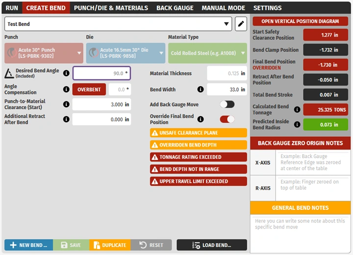

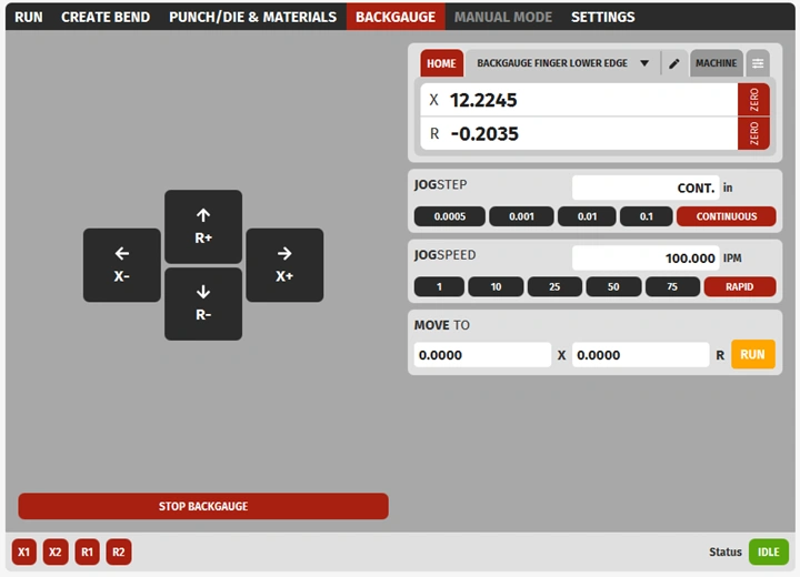

At the top right of the software screen is the connections Menu. If everything is powered up and connected properly, you will find a solid green bar for Machine and Backgauge (optional add-on product) indicating that both of these devices are connected and communicating with the software.

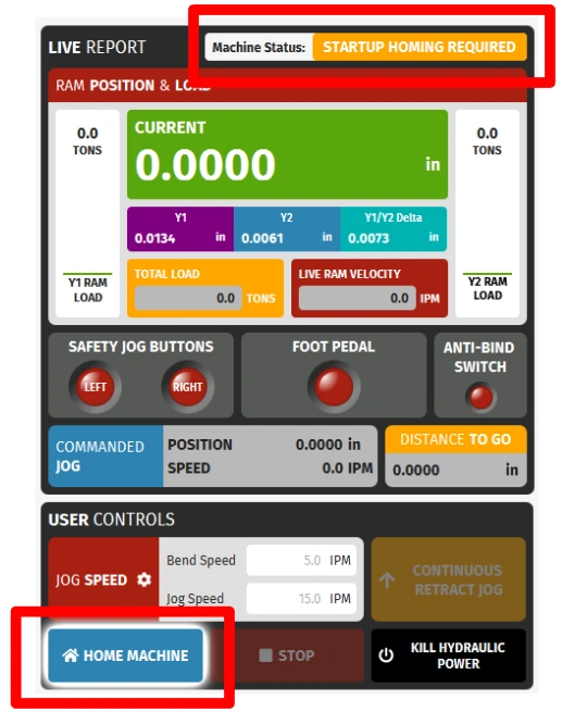

VIII. Homing the Machine
Everytime the machine is first powered up (or reset from an error state), it needs to be Homed in order to properly calibrate the Ram position. You will notice that the Machine Status in the top-right display is set to STARTUP HOMING REQUIRED. You will also notice that the HOME MACHINE button has a white glow around anytime that the machine needs to be homed in order to continue. Click the HOME MACHINE button to initiate the Homing sequence.
If the Homing Operation has been performed successfully, the Machine Status will indicate IDLE. You will also notice that the CURRENT ram position in the DRO is at -0.050”, which is the Home Position of the Titan 25T.
If you are encountering repeated Homing failures, please refer to the latest section of this guide titled Bleed Hydraulics Mode to ensure all the air has been removed from your hydraulic system.

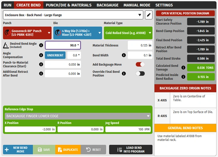

IX. BendControl Software Overview
The below section is a brief overview of the different sections and tabs that make up the BendControl software. For more detailed information about how to use these different sections, please refer to the relevant sections of this Quick Start manual.
Note: The following Overview section is just a brief description of the various parts of the BendControl software. For more detailed information for using the software, please refer to the relevant sections later in the operating manual.

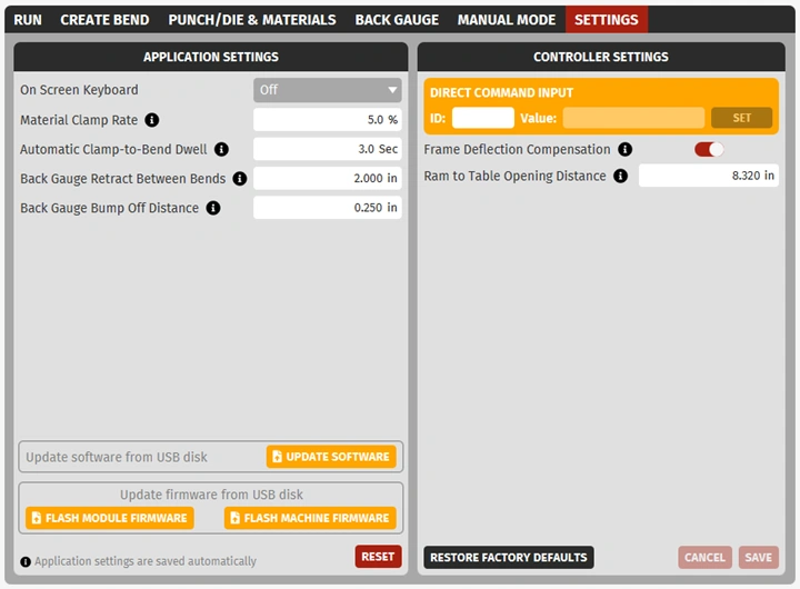

1. Information ‘i’ Icons in BendControl
BendControl features several clickable information icons ('i') next to many settings and parameters, providing users with detailed explanations directly within the software. These icons are designed to offer immediate context and guidance, ensuring that users understand the purpose and correct usage of each value. By clicking these icons, operators can access helpful descriptions, usage tips, and relevant details, enhancing their ability to set up and operate the Titan 25T CNC Press Brake accurately and efficiently. This built-in resource promotes better-informed decisions and smoother operation workflows.

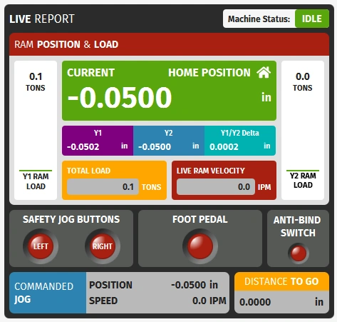

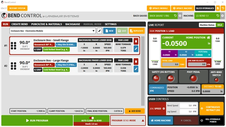

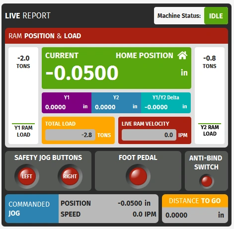

2. Live Report Menu
The Live Report Menu within BendControl provides real-time data and control options essential for monitoring and operating the Titan 25T CNC Press Brake. This panel is divided into several key sections described below.
  • Machine Status: This indicates the live state of the machine controller at any given time.
  • Current Position: Displays the current commanded position of the ram in inches.
  • Home Position: Indicates the default home position, if the current position is at the home position of -0.050in.
  • Y1 and Y2 Positions: Shows the individual live positions of the Y1 and Y2 hydraulic cylinders, expressed as the live readout from the linear glass scales encoders on each side of the ram.
  • Y1/Y2 Delta:Displays the live positional difference between Y1 and Y2 cylinders.
  • Y1 and Y2 RAM Load: Shows the live load in Tons on each Ram. As tonnage increases, the bars will increase in height accordingly, up to a maximum of 12.5 tons for each ram.
  • Total Load:Indicates the combined load being applied by summing up the live Y1 and Y2 loads.
  • Live Ram Velocity: Shows the actual live speed of the ram movement in inches per minute (IPM).
  • Safety Jog Buttons LEDs: Shows the live state of the Safety Jog Button Palm Switches for the left and right sides. When these buttons are depressed, the lights will turn green.
  • Foot Pedal LED: Shows the live state of the foot pedal. When the foot pedal is depressed, the light will turn green.
  • Anti-Bind Switch: Shows the live state of the Anti-Bind Switch. When either of the Anti-Bind limit switches are tripped, the status light will turn green.
  • Commanded Jog: Shows the currently commanded Jog Position and Jog Speed of the machine in inches.
  • Distance to Go: This signifies the linear distance that the ram has to travel from its current position in order to complete the commanded jog move. It is a very useful feature to monitor during bending operations as a sanity check to make sure that the ram is going to move where you expect it to move.

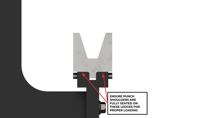

The Titan 25T CNC Press Brake is designed for use with American Style tooling, which has a 0.5” tang centered in the punch/die. Punches are loaded into the channel formed by the Ram and Punch Clamp.
To install a punch, loosen the 5/16-18 Punch Clamp screws on all sections of the punch clamp that will be used to hold the punch. Then, slide the tang of the punch clamp up and into the channel formed by the Ram and Punch Clamp. While applying upward force, tighten the Punch Clamp Screws to secure the punch in place. Pushing up while installing the punch clamp ensures contact at all critical loading points such that both shoulders of the punch are evenly loaded during bending.

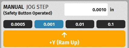

  • Next, set the Manual Jog Step to 0.001” increments. Click the +Y(RAM UP) button. This will move the Ram up by 0.001”. Slide the length standard back and see if it now fits between the Ram and Table. If it doesn’t, keep jogging the machine up 0.001in increments until the length standard just slides in. Note the Current Position in the green box DRO, and write this value down.

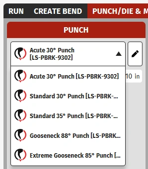

B. Langmuir Systems Pre-loaded Punch Library
In the PUNCH drop-down menu, you may notice that some items are already populated in the software by default. These are the list of Punches that are manufactured and sold by Langmuir Systems for use with the Titan 25T machine. The Punch Height values listed here are nominal; it is highly recommended that you use measurement tools such as calipers or micrometers to accurately measure your Punches and edit any values so that they match what you have on hand.

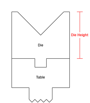

Die Height is the vertical measurement from the bottom of the die (the surface that rests on the table) to the top surface where the material rests (see image below). This parameter is crucial for ensuring accurate bending operations, making it essential that each die is precisely measured for its height. Accurate Die Height measurement ensures consistency and precision in the bending process.

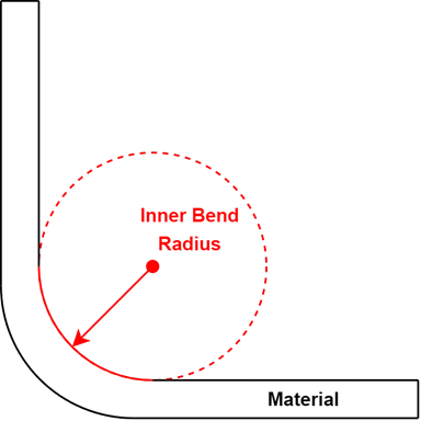

B. Inside Bend Radius Percentage:
In air bending, the inside radius that forms is expressed as a percentage of the die opening and material alloy. Sometimes this is referred to as the "20% rule". Below is a general rule of thumb for common alloy types, but please consult the relevant standards for exact values.
  • Cold Rolled Steel (e.g. A1008): 15-17%
  • Hot Rolled Steel (e.g. A36): 14-16%
  • Stainless Steel (e.g. 304): 20-22%
  • Soft Aluminum (e.g. H-series): 13-15%

5. Creating a Bend:
The next step in our process is to create each bend for our part. Here we specify all the relevant data that defines our bend such as the Punch/Die/Materials that we are going to use, as well as our Desired Bend Angle and our Material Thickness. Since we are also going to use the backgauge to position the material for our bend line, we can specify this information here as well. The following sections provide more detailed information for each parameter on the Create Bend screen.
A. Selecting Punch/Die/Material:
The first step to creating our bend is to select the Punch/Die/Material combo that we want to use for our bend. Simply select the desired item from each drop-down menu as shown below. These selections can be changed at any time, and any changes to these entities on the Punch/Die & Materials tab will propagate back to the Create Bend tab as well.

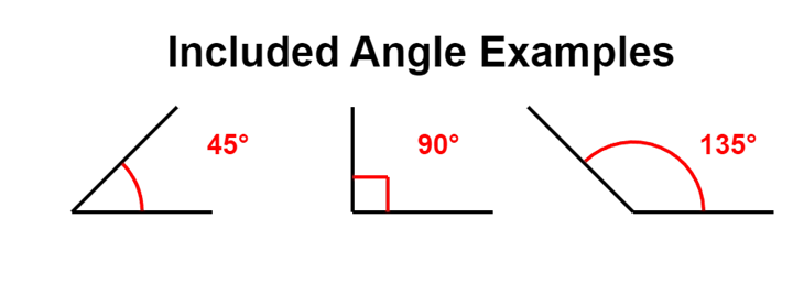

B. Desired Bend Angle (Included):
Next, we enter our Desired Bend Angle in degrees. The Desired Bend Angle is the inside angle formed in the material during the bending process, also referred to as the included angle. The below image provides several examples for how an included angle is specified. It’s important to enter your angle correctly using this method to ensure the desired bend angle is produced.
C. Material Thickness:
This value is the thickness of your material in inches. It is very important to get an accurate measurement of your material thickness, because inaccurate values can lead to large inaccuracies in finished bend angles. We highly recommend using a caliper or micrometer to measure your material thickness when creating a bend. An accurate material thickness measurement becomes even more important when you are bending thin material on a die with a narrow V-die opening.
D. Angle Compensation:
Angle Compensation allows the operator to make an angular correction to a programmed Bend. The user can make a bend, measure the difference when compared to the desired bend angle, then enter this correction value allowing the machine to compensate for the error on the next bend. Angles that are OVERBENT are bent past their desired angle (e.g. desired 90° but bent to 85° is 5° OVERBENT). Angles that are UNDERBENT are not bent enough when compared to their desired angle (e.g. desired 90° but bent to 95° is 5° UNDERBENT). Clicking the OVERBENT/UNDERBENT button will toggle between these two settings.

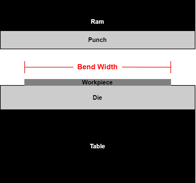

E. Bend Width:
Bend Width is a measurement of the width of the workpiece across the table. The wider the workpiece is, the more tonnage is required to make the bend. BendControl uses the bending parameters for each bend to make a calculated estimate of the needed Tonnage for each bend, so it’s important that you accurately measure your bend width to get a more accurate Calculated Bend Tonnage value in BendControl for each bend.
F. Punch-to-Material Clearance (Start):
Punch-to-Material Clearance is the vertical distance between the Safety Jog Plane and the top surface of the material before clamping or making a bend. This distance must be large enough to freely adjust the workpiece between the Punch and Die, but small enough to ensure a finger could not fit between the Punch and the material for safety reasons. BendControl will issue a Warning if the Punch-to-Material Clearance value is greater than 0.3 inches.
G. Additional Retract After Bend:
Additional Retract After Bend allows the ram to retract upwards past the original Safety Jog Plane (a.k.a the Punch-to-Material Clearance Position) once a bend is completed. This adds additional retraction enabling the user to remove their workpiece after a bend is complete, if necessary depending on the finished part geometry. The below image depicts a part geometry that would require this additional clearance distance in order to properly remove the material from the front of the machine.

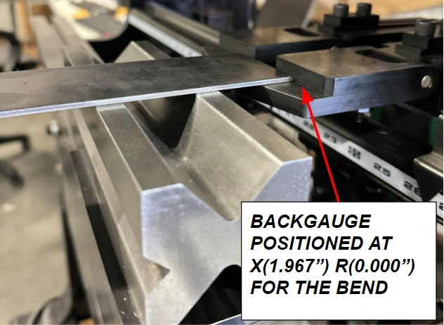

H. Setting up a BACKGAUGE move (Optional):
An optional step when creating a Bend is adding a backgauge move. This requires the operator to have purchased the optional 2-axis CNC backgauge. A backgauge is designed to accurately position a workpiece in place for bending, ensuring precision and consistency in the bend line position. Essentially it is the backgauge's job to automatically move its finger stops into position for each programmed bend so that the operator can use this as a 'backstop' to push the material against before bending.
To enable a backgauge move, toggle the ‘Add Backgauge Move’ to the ON position. You will see the below panel pop-up at the bottom of the Create Bend screen.
The first step to defining a Backgauge move is to specify the Reference Edge Stop that you will be using on the backgauge. Generally this will be either the Finger Lower Edge, or the Finger Upper Edge, but it’s possible that you have replaced your fingers with some other custom feature (such as an angled finger for locating an angled part feature) and this can be selected here if this Reference was defined on the backgauge Tab of BendControl. See OPERATING THE BACKGAUGE section below for more information on how to define reference edges on the backgauge Tab.
Next, you will specify the X and the R backgauge coordinate positions for your required bend. This tells the backgauge where to move before the bend process occurs so that the operator can snub the material up to the Reference edge hard stop for making the required bend. A user can also specify the Jog Speed that they want the backgauge to move during a program.
As a simple example, let’s say that we wanted to create a 2” Flange in ⅛” steel. From our CAD model, we see that given the inside bend radius (which can be taken from the Create Tab in BendControl and substituted into the CAD model for more accurate positioning), the Bend Line Location is 1.967” from the edge of our material. If you don’t have access to 3D modeling software to extract the Bend Line Location, we recommend consulting an online reference or calculator for how to calculate the Bend Deduction for your specific bend in order to position the Bend Line Location for your desired Flange dimensions.
Let’s assume that we are using the backgauge finger Upper Edge as our reference edge to snub the material against. Let’s also assume that we zeroed the Upper Edge stop to the Centerline of our machine in the X Position, and we zeroed the R position so that the finger surface was flush to our top Die surface where the material rests (see pictures of this setup on the Machine below as an example). Then, we would program the backgauge move as shown in the image below. We have also typed in Backguage Zero Origin Notes to save with our bend and remind us next time we run this program how to zero the backgauge finger stops before starting the bend again.

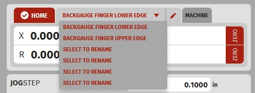

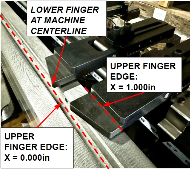

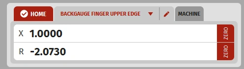

a. Setting our X-axis ZERO Position on the Machine:
In the previous example, we have shown how to enter in this backgauge position for creating a Bend. Now let’s look at how we actually establish these Zero positions for our desired reference edges on the machine itself. Note: You must HOME your backgauge before continuing here (see later section OPERATING THE BACKGAUGE for more information on how to run the backgauge and Home it).
As we saw earlier, we are going to use the Upper Finger Edge for this bend. In addition, we want the Zero position of our X-axis to be located at the Centerline of the machine table. Unfortunately, the backgauge fingers are not able to jog to the Upper Finger Edge all the way to centerline, but we can jog the Lower Finger Edge to the centerline. Since we know that the Upper Edge is exactly 1.000in set back from the Lower Edge in the positive X-axis direction, we can enter this offset when we Zero the X axis.
Now with the Lower Fingers sitting at the Machine Centerline, let’s navigate to the Backgauge tab to set our X-axis zero position. Since we know that the Upper Finger edge is set back in the positive X direction by exactly 1.000”, we can just type in 1.000” into the Digital Read Out (DRO) for the X-axis and we are done. If we had enough clearance and could jog the Upper Edge so that it was in-line with the Machine Centerline, we would find that the position for the X-axis would read 0.000”, just like we want it to. It will look something like below in BendControl when you are finished. Remember to make sure that you have selected BACKGAUGE FINGER UPPER EDGE from the drop-down menu above the Digital Read Out for X and R-axis positions.
b. Setting our R-axis ZERO Position on the Machine:
Next, we are going to do the same thing but this time for the R-axis zero position. To do this, we just need to jog the R-axis until the material resting surface is flush to the top surface of the Die, and then we can just click the ZERO button next to the R-axis DRO position in BendControl. When done correctly, it will look like the image below.
c. Demonstrating Backgauge Positioning During Bending Process:
Now that we have our X and R-axis Zero positions set correctly, and we’ve entered our backgauge bend line coordinate positions into the Create Bend screen for our desired bend, we can take a look at where the machine will move automatically when we actually run the bend process. As shown below, the backgauge is now positioned so that the material can be loaded, snubbed up to the hard stop of the backgauge Upper Reference Edge, and bent to our desired 2” flange. This same procedure can be followed for zeroing and entering backgauge coordinates for any desired bend.
I. Override Final Bend Position (Optional):
BendControl allows the user to override the Final Bend Position, as long as it is between the clamp position and the maximum machine travel distance. Sometimes this can be useful if the calculated values are not producing the desired bend, and you want to use a bend depth value that you have empirically determined works well for the bend that you are making.
PROCEED WITH CAUTION ON ANY OVERRIDDEN BEND TO MAKE SURE THAT YOU DON'T CRASH YOUR PUNCH INTO THE DIE.
We have found that the best way to determine an Overridden Final Bend Position is to run some test pieces using Manual Mode. This will allow you to incrementally creep up on your desired Bend, and then you can use this empirically determined value to create the Bend for running in a program once you have it dialed in. Below is an example of a Bend that has been overridden.
J. Calculated Bend Tonnage:
Calculated Bend Tonnage is the calculated total tonnage required to perform a bend, and it is displayed on the right side of the Create Bend tab. If the Calculated Bend Tonnage is greater than 12.5 tons (the maximum allowable tonnage for each hydraulic cylinder), then the workpiece must be centered to distribute the load between the rams evenly.
K. Predicted Inside Bend Radius:
The Predicted Inside Bend Radius is an estimated calculation of the inner radius formed by a bend, based on the relevant parameters entered into BendControl. This value is particularly useful as it can be directly applied to a part's CAD model, ensuring a more accurate determination of the bend line within the CAD design.
L. Bend Warning Labels:
When creating bends on the Create Bend tab, BendControl will perform checks of the entered parameters to make sure that there are no issues with the bend. BendControl employs two different warning labels to alert operators to potential issues with their bends, ensuring both safety and precision during operations. These warnings are displayed in the Create Bend Tab and are categorized by color to indicate their severity and impact on the bending process.
Yellow Warning Labels: These labels, such as "Unsafe Clearance Plane" and "Overridden Bend Depth," alert the operator to specific issues that require attention but do not prevent the bend from being executed. The yellow warnings serve as advisories, allowing the bend to proceed while highlighting potential risks or deviations from standard parameters. Operators should carefully review these warnings and take appropriate actions to mitigate any identified risks.
Red Warning Labels: These labels, such as "Tonnage Rating Exceeded" and "Upper Travel Limit Exceeded," indicate critical issues that prevent the bend from being executed on the machine. Red warnings highlight problems that pose significant risks to the machine or the bending process, necessitating immediate resolution before the operation can continue. These labels ensure that operations are halted to avoid damage or unsafe conditions, protecting both the equipment and the operator.
By paying close attention to these warning labels, operators can ensure safe and efficient bending operations, addressing potential issues proactively and maintaining the integrity of the bending process. Below is an example of the warning labels issued for a given Bend.
M. Reviewing Bend Positions and Saving:
In the Create Bend tab of BendControl, operators can review the calculated positional information for each bend on the right hand side. This includes several critical parameters displayed in a clear, accessible format:
Start Safety Clearance Position (Machine Coordinate): This is the vertical position where the ram will stop before clamping the material, ensuring enough clearance for positioning the workpiece.
Bend Clamp Position (Machine Coordinate): The position where the ram will clamp the material securely before initiating the bend.
Final Bend Position (Machine Coordinate): The target depth the ram will achieve to form the bend.
Retract After Bend Position (Machine Coordinate): The position to which the ram will retract after the bend is completed, allowing safe removal of the workpiece, and convenient positioning to start the next bend.
Total Bend Stroke: The total vertical movement of the ram during the bending process.
Once all parameters are confirmed, remember to click the icon to continue.

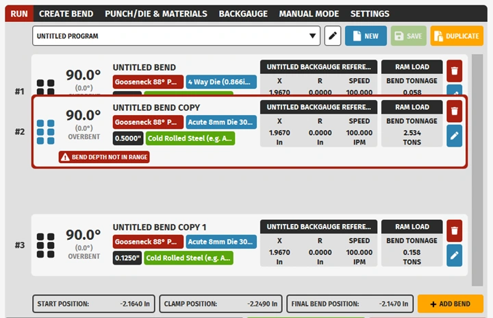

6. Creating a Bend Program:
The RUN tab is the central hub for creating, managing, and executing bend programs in BendControl. This interface allows operators to create and add new bends to a program, review detailed information for each bend, edit or delete bends, and save the program for future use. The intuitive design ensures that all necessary information and controls are easily accessible, facilitating efficient and precise bending operations.
A. Adding a Bend to a New Program:
First click the button to create a new Bend program. Next, to add a bend to a new program, click the button located at the bottom right of the screen. This will open the Add Bend Move window, where you can select any of your created bends from the Create Bend tab.Simply select the Bend you want from the list, and click Add Bend to add it to your program.
B. Rearrange Bends in a Program:
In the RUN tab, operators can quickly change the order of bends within a program using the touch screen interface. To rearrange a bend, touch and hold the six-dot symbol (also known as the handle icon) next to the desired bend, drag it to the new position, and release it. This action updates the program sequence instantly (don’t forget to SAVE), allowing for quick adjustments to the bending process on the fly. Below is an example of a Bend that is in the process of being rearranged.
C. Bend Information Display:
The program display allows a user to verify information for each loaded bend. This is a handy reference to make sure that all of your bends and bend information looks correct before proceeding. Some of this information includes Start Position, Clamp Position, Punch, Die, Material, Thickness, Desired Bend Angle, Angle compensation, Backgauge move information, and expected Bend Tonnage.
D. Editing or Deleting a Loaded Bend:
To delete or edit a bend, use the icons next to each bend entry:
Delete Bend: Click the red trash icon to remove the bend from the program. This action will prompt a confirmation to ensure that the bend is not deleted accidentally.
Edit Bend: Click the blue pencil icon to open the selected bend in the Create Bend tab. This allows for quick modifications to the bend without having to recreate the bend from scratch. Any changes saved here will propagate to the program automatically.
E. Reviewing and Saving:
After configuring all the bends in the program, it is crucial to review the entire sequence to ensure accuracy and safety. Verify that each bend has the correct parameters and that the sequence order is appropriate. Once satisfied, click the "SAVE" button at the top right of the screen to store the program.

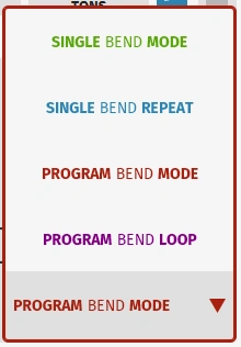

4. Bending Modes
At the bottom right of the RUN tab, the user will find the Bend Mode Drop-down menu. This allows a user to select a desired Mode for a given bend or program (multiple bends). Below is a description of each mode and how it operates when running the program.
A. SINGLE BEND MODE:
In Single Bend Mode, the BendControl software executes the selected bend operation once and then finishes the program. This mode is available when the active program contains only one bend or when a specific bend is highlighted in a multi-bend program. It is ideal for verifying individual bends before proceeding with additional operations.
B. SINGLE BEND REPEAT:
Single Bend Repeat mode allows the operator to continuously repeat the selected bend operation after it has been successfully completed. This mode is also available when the active program contains only one bend or when a specific bend is highlighted in a multi-bend program. The operator is provided with a clear warning in the RUN PROGRAM pop-up indicating that the bend will be repeated, ensuring they are aware of the continuous operation.
C. PROGRAM BEND MODE:
Program Bend Mode enables the execution of a sequence of bends starting from the currently highlighted bend and proceeding to the last bend in the active program. This mode is accessible when the active program has more than one bend. If the selected bend is not the first bend in the program, the RUN PROGRAM pop-up includes a warning to inform the operator that the sequence will start from the highlighted bend and not from the beginning.
D. PROGRAM BEND LOOP:
