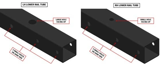

7: Received Identical Lower Rail Tubes (PRO Only)
If you received identical Lower Rail Tubes, you'll need to reach out to Langmuir Systems Support for the correct component. The Lower Rail Tubes are not interchangeable.
The replacement process could be expedited if you inform our team as to whether you need a Right-hand (RH) Lower Rail Tube or a Left-hand (LH) Lower Rail Tube. Using the photo below, identify the Lower Rail Tube you received a duplicate of, and include that information when you reach out to our Support Team.

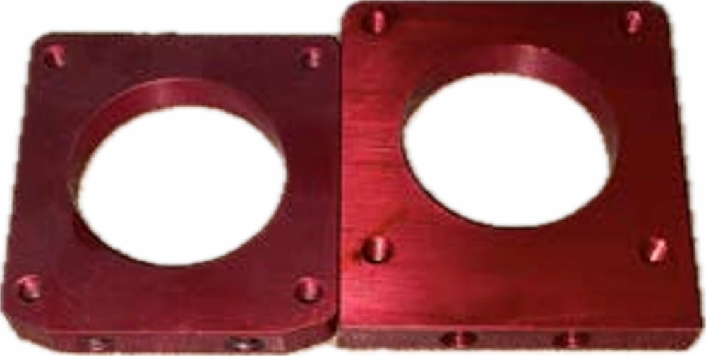

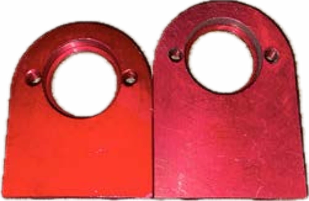

B. An incorrect bearing mount might have been used. The X-axis motor and bearing mounts are shorter than those used by the Y-axis. Measure the bearing mounts on your machine and conrm that the X-axis bearing mount is not the same length as the Y-axis bearing mounts, and that the length of the Y-axis bearing mounts is identical to one another.
C. The motor or bearing mounts may be out of square, causing a slight ex in the lead screw. Visually inspect that the mounts are mounted onto the gantry rails as square as possible, using a protractor if necessary.

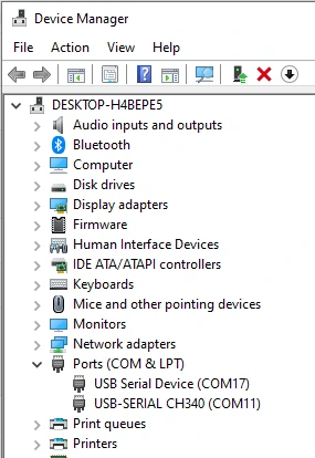

E. Ensure the Motion Control Board is listed in your computer's Device Manager. The expected devices are shown in the image below (COM Port numbers will be different on your computer but the Device Names should be the same). The CrossFire Motion Control Board will be shown as 'USB Serial Device' and the LSTHC module will be shown as 'USB-SERIAL CH340'
If there isn't 'USB Serial Device' or you see a 'Device Descriptor Failed' message on a connected USB Serial Device in Device Manager, try using:

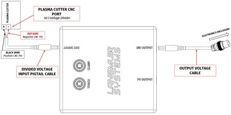

THC Internal Wiring (RAW Voltage):
https://www.langmuirsystems.com/thc/guide#vimB
https://www.langmuirsystems.com/thc/guide#vim-wiring-raw

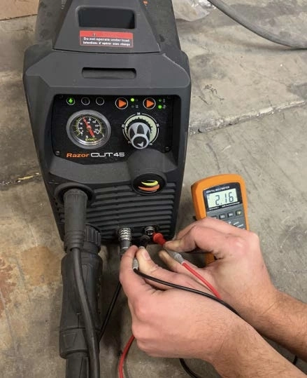

A. The torch firing cable that connects your plasma cutter to the CNC electronics enclosure might be faulty. Will the torch fire if you short the torch firing cable? To test this, you will need the plasma cutter powered on and set in a safe position to fire the torch, and the torch firing cable unplugged from the "torch on/off" port of the control box. Once your plasma cutter is powered on and in a safe firing position, use a paperclip (or other thin piece of conductive metal) to bridge the torch firing cable's inner pin to the outer barrel. Doing so should force the torch to fire.
RAZORWELD 45 PLUG-AND-PLAY UNITS
If you're using a plug-and-play Razorweld 45 purchased from Langmuir Systems, perform Step A with the torch firing cable plugged into both ports on the front of the Razorweld 45 to rule out an issue of the plug-and-play ports being swapped by the manufacturer.
B. The torch firing relay might be faulty or loose. Ensure that the relay is firmly seated into its socket of the motion control board. The relay makes an audible "click" noise when switched from the open position (torch not firing) to the closed position (torch firing) and vice versa. If you power off your plasma cutter and initiate a manual torch fire in FireControl, can you hear the relay “click"?

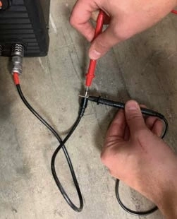

C. Check that the relay is properly passing the signal along to the port. With your multi-meter in continuity mode, place one probe on the outside of the female barrel connector and one probe on the pin inside the barrel connector at the Torch On/Off Port. In FireControl, click Manual Torch Fire. You should have continuity between these two pins when a Manual Torch Fire is initiated. Be sure to click Manual Torch Fire again before plugging your torch back in to disarm it.
D. Next, check for continuity through the torch inlet female barrel connector on the electronics enclosure. Unplug the orange and purple blade connectors from the main wiring harness. With your multi-meter in continuity mode, place one probe on the orange blade connector and touch the other probe to either the outside barrel or the inside pin. You should have continuity to one of these. Next, probe the purple blade connector and probe the barrel connector again (if the orange had continuity to the inside pin, then probe the outside of the barrel connector and vice versa). If you are not getting continuity through both of these blade connectors to the port, you will need to have your inlet port replaced.

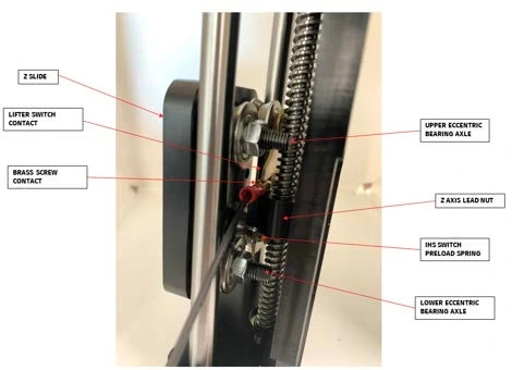

If you have a CrossFire machine that does not have the optional Z-axis + THC Upgrade Kit installed, then you are receiving this error message because your G-code contains Z-axis commands. You will need to generate a new G-code with the Z-axis commands for IHS and THC removed.
A. The first thing you need to verify is that the Z-axis motor is functional. Manually jog the Z-axis motor by either clicking on the "+Z / -Z" buttons in FireControl or by pressing the "Page UP / Page DOWN" keys on your keyboard. Ensure that the Zaxis motor actually jogs, and that it jog the correct direction. If your Z-axis motor does not jog at all, proceed to section B below. If your Z-axis motor jogs the incorrect direction, then the polarity of the Z-axis step driver needs to be reversed. Refer to the Electronics section. If your Z-axis motor jogs the correct direction, proceed to C below.
B. If the Z-axis motor does not jog, you need to verify whether the motor itself is the faulty component. First, disconnect your CrossFire from power and check the Z-axis Motor Cable and Motor Port for signs of arc damage (burn marks, melting, etc). If no damage is present, try plugging the Z-axis motor into the X-axis motor port of the CNC electronics enclosure, then jogging it using X-axis commands. If the Z-axis motor is able to jog using X-axis commands, then the Z-axis step driver wiring should be inspected, or the Z-axis step driver should be replaced. If the Zaxis motor is not able to jog using X-axis commands, then the Z-axis motor should be replaced.
C. . It is possible that the brass switch components of the Z-axis assembly are separating from one another before the tip of the torch touches the metal sheet, as the IHS sequence intends. While watching the brass IHS contact switch components closely, manually jog the Z-axis motor by either clicking on the "+Z / -Z" buttons in FireControl or by pressing the "Page UP / Page DOWN" keys on your keyboard. If the brass switch components of the Z-axis assembly only separate from one another when the tip of the torch touches the metal sheet, proceed to step D; otherwise, continue with this step.
D. It is possible that the torch lead does not have enough slack coming from the cable support tube. If the torch lead—which runs between the top of the Cable Support Tube and the Torch Mount—is very taut, the IHS switch may be triggered before the torch contacts the workpiece. To resolve this. pull more of the Torch Lead up the Cable Support Tube, and try positioning the Torch Mount lower on the carriage so that the torch's neural position is closer to the workpiece.
E. It is possible that the Z-axis bearing preload might be too tight. Looking at the Z-axis assembly from the front of the machine; the bearing axles on the right hand side are adjustable. They are eccentric bolts, which can be turned with a 5mm wrench to adjust how much pressure is between the bearings and the rail. After backing the adjustable bearings off of the linear rails, but before tightening them again, rotate the bearings by hand to check for any that are "sticky" or “notchy" - if this is the case, lubricate the sidewall of the affected bearing with WD-40. You will need to use care when dialing in the preload; turn the eccentric bolt just enough to not have lash, and no more so that the Z slide moves up and down freely. While you are working on the bearing preload, also check the Z-axis linear rails for any bumps, protrusions, buildup of debris, or rust that would cause the Z-axis to not move up and down smoothly
F. It's possible that the IHS cable is not properly connecting the IHS contact switch system to the CNC electronics enclosure, or that the connection between the motion control board and the IHS port is faulty. All connections between the Z-axis IHS contact switch system and the motion control board are outlined in F1 through F5 below:

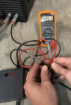

F1. Start by checking the set of two blade connectors that connect to the brass contact switches at the back of the Z-axis assembly. Ensure that the blades are properly mated between the Z-axis assembly and the IHS cable; disconnect the blades and reconnect them if necessary. Also, inspect that the other ends of the female blade cables are attached securely to the brass contacts.
F2. Next, open the electronics enclosure and check the set of three blade connectors at the backside of the IHS port. Note that these wires are color-coded black, red, and white; and make sure that the colors match up appropriately. Ensure that the blades are properly mated between the IHS port and the main wiring harness, disconnect the blades and reconnect them if necessary.

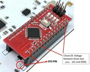

F3. Next, trace the black and red color-coded wires from the IHS port to the motion control board (MCB). The black wire should correspond to the MCB position labeled '5v' and the red wire should correspond to the MCB position labeled 'IHS'. Gently tug the red and black wires individually to check for a loose connection to the MCB.
F4. Next, trace the white color-coded wire from the IHS port to the MCB. The white wire should correspond to the MCB position labeled 'GND'. Gently tug the white wire to check for a loose connection to the MCB.
F5. IHS essentially functions by monitoring the continuity, and therefore the physical contact, between the brass contact switches located in the Z-axis assembly. The continuity is monitored via a 5v signal supplied to the black IHS wire (5v on the MCB), which leads to one of the brass contacts; and while the brass switches are in contact with one another, this 5v travels through the white IHS wire to the ground (GND on the MCB). If the motion control board does not read this 5v signal going into GND on the MCB, then it assumes the brass IHS contact switches are not in contact with one another.

It is possible that the voltage output from the plasma cutter is not reaching the Voltage Input Module (VIM), or that the VIM is not outputting voltage to the CNC electronics enclosure. If your THC feature is wired to your plasma cutter via 50:1 divided voltage, proceed to the Divided Voltage section below; if your THC feature is wired to your plasma cutter via RAW voltage, proceed to the RAW Voltage section below.
Divided Voltage
Follow the steps below to verify that (A) the CNC port on your plasma cutter is working properly, (B) you have wired correctly into this port, and (C) that your VIM is wired correctly and generating the correct output voltage. Ensuring that your THC port is being fed a known-good voltage from your plasma cutter is essential to troubleshooting the THC system.
VIM wiring for Divided Voltage
A. Verify that your plasma cutter's 50:1 voltage divider port is functioning properly while cutting. If your plasma cutter is equipped with a 50:1 voltage divider in the CNC port, you'll use your DMM to measure the DC Voltage across the two pins of this port while the plasma cutter is cutting.
HYPERTHERM: PORT NOMANCLATURE
On Hypertherm plasma cutters, the CNC port is referred to the the CPC port.
Place the black electrode of the DMM on the negative pin (torch) of your voltage divider port, and the red electrode on the positive pin (work clamp). You may need to check your plasma cutter documentation to verify which pin is which on your CNC port. Next, using the STRAIGHT CUT feature in FireControl, perform a straight line cut with your machine with the THC panel toggled off in the control panel and measure the DC voltage across these two pins. Depending on your plasma cutter, the typical arc voltage while cutting will range between 60-150V; since the voltage divider is 50:1, you should see an output voltage of around +1.2 - 3V. If your voltage value is within range but is a negative reading, you have your two pins switched (positive and negative are reversed). If you are not getting the expected voltage here, contact your plasma cutter manufacturer to remedy the issue.
ADJUSTABLE VOLTAGE DIVIDER
Some plasma cutters have an adjustable internal voltage divider. You will need to make sure that your voltage divider is configured to 50:1 to work with our system. Most modern plasma cutters have the CNC port configured to 50:1 for THC by default.
B. Next, you will need to use the provided Divided Voltage Input Pigtail Cable for wiring to the divided voltage port that you tested in step A.
HYPERTHERM AND RAZORWELD: PLUG-AND-PLAY UNITS
These units will utilize the Hypertherm CPC cable or Razorweld 45 plug-and-play THC cable instead of the Divided Voltage Pigtail Cable.
Per the LS-THC user guide, the red wire should be connected to the negative pin, and the black wire should be connected to the positive pin. Once you've fashioned a suitable plug onto this pigtail end for connecting to your voltage divider port, use your DMM to verify that your wiring is correct. Touch the red electrode of the DMM to the inside of the barrel connector and the black electrode to the outside of the barrel connector. The DC voltage that you measure here should be identical to the value measured in step A. If you are getting a negative voltage here but the magnitude of this value is correct, you need to switch the polarity of your wiring on the plug to the 50:1 voltage
DO NOT TOUCH THE EXPOSED LEADS OF
YOUR DMM WHILE PERFORMING THIS TEST
C. Verify that your VIM Box is wired and operating properly by plugging the barrel jack end of your Divided Voltage Input Pigtail Cable into the DIV INPUT socket on the VIM Box, then plug in the supplied Output Voltage Cable into the DIV OUTPUT socket on the VIM Box. Next, locate the free end of the Output Voltage Cable and note the pins labeled 1 and 2 on the front face of this connector. Using your DMM, touch the Red DMM lead to pin 1 and the black lead to pin 2.
Perform the same straight line cut as before with the THC Control panel toggled off in FireControl, and measure the DC voltage between these two pins as shown in the pictures below. Again, this voltage value should be positive. Your test setup should look exactly like the pictures below: you will notice that the DC voltage that is coming out of the VIM will be less than the input voltage that you measured in steps A and B.
This is because the VIM further divides the voltage for an effective total voltage division of 73:1. To figure out the ballpark voltage that you should be getting, multiply the voltage you found in steps A and B by 0.685 to get the value you should expect in this step.
For example: in step B we measured +2.16V, which multiplied by 0.685 gives us an expected voltage of +1.47V; this is very close to the +1.45V we measured in the photo. If you are getting good voltage values in steps A and B, but measure no voltage or an unexpected voltage coming out of the VIM box, double check the continuity of the two wires in the Output Voltage Cable. Verify that your Output Voltage Cable is plugged into the DIV OUTPUT socket on the VIM, and not the PV OUTPUT socket. If everything else checks out with the cable and you are getting a good input voltage in step A and B, you more than likely require a replacement VIM. Otherwise, proceed to the THC Module section.

A. In this step, we need to verify that you have successfully connected to RAW voltage inside your plasma cutter and that the polarity of this wiring is correct.
RAW VOLTAGE WIRING THROUGH CPC PORT
While the majority of raw voltage wiring is done internally, raw voltage can also be wired through your plasma cutter's CPC port in some cases
Using a DMM, connect your black DMM lead to the black RAW voltage banana connector and connect your red DMM lead to the red RAW voltage banana connector (as shown below).
Next, using the STRAIGHT CUT feature in FireControl, perform a straight line cut with your machine with the THC panel toggled off in FireControl and measure the DC voltage across these two connectors. Depending on your plasma cutter, the typical arc voltage while cutting will range between 60-150V. If you are getting a negative voltage reading here, you need to switch the connection points inside your plasma cutter or FireControl will read 0V (FireControl can only read a positive voltage). If you are getting no voltage reading at all, you will need to contact your plasma cutter manufacturer or a qualied electrician for better guidance on how to hook up to RAW voltage inside your plasma cutter.
B. Plug the banana connector ends of the RAW Voltage Pigtail Cables into the corresponding color sockets on the top of the VIM. Next, plug in the supplied Output Voltage Cable into the PV OUTPUT socket on the VIM. Then, locate the free end of the Output Voltage Cable; note the pins labeled 1 and 2. Using the DMM, touch the red DMM lead to pin 1 and the black lead to pin 2. Perform the same straight line cut as before and measure the DC voltage between these two pins as shown in the pictures below.
Again, this voltage value should be a positive voltage. You will notice that the DC voltage that is coming out of the VIM will be much less than what you measured in step A. This is because the VIM divides the RAW voltage input for an effective voltage division of 73:1. To figure out the ballpark voltage that you should be getting, divide the voltage you found in step A by 73. For example: in step A if you measured 110V, divide this by 73 and you should expect roughly 1.5V DC across the plug pins. If you are getting a good voltage value in step A, but measure no voltage or an unexpected voltage from the VIM box, double check the continuity in the Output Voltage Cable and that your Output Voltage Cable is plugged into the socket labelled PV OUTPUT. If everything looks good with the cable, you are more than likely experiencing a VIM module failure. If you are getting the expected positive voltage values in this step, but still showing no voltage in FireControl, proceed the THC Module section.
THC Module
A. It is possible that the voltage from the Output Voltage Cable is not reaching the LS-THC module. Using a DMM, check DC voltage between the A1 pin and the GND pin on the THC module while FireControl is performing a straight cut. The reading between A1 and GND should match what you read from the Output Voltage Cable.
B. It is possible that the resting voltage on the LSTHC module is incorrect. While the USB cable is disconnected from the Motion Control Board, check DC voltage between the A1 pin and the GND pin on the THC unit using your DMM. You should be measuring close to 0V here. If you are getting a voltage reading that is greater than 100mV while the plasma cutter is off, your motion control board could be malfunctioning. If you are reading more than 0V, continue with this step; otherwise, move on to step C.
If you are reading more than 0v between A1 and GND while the plasma cutter is idle, unplug the IHS cable from the IHS port of the CNC electronics enclosure. If doing so causes the resting voltage to drop to 0v, then the IHS contact switch system is charging the frame of the machine with a low voltage that is being picked up by the LS-THC module. Use compressed air to blow any dirt/water from between the brass switch contact and the lead screw. Apply dielectric grease to the brass contact switches to prevent the issue from recurring.
C. Verify that reference voltage to the LS-THC module is correct. With the THC plugged into the white motion control board and the CNC electronics box plugged into your computer, you should see LEDs illuminate on both boards. Using a DMM, check DC voltage between the REF pin and the GND pin on the THC module. You should be measuring around 4.0v to 4.2v.
If the measurement is off, you'll want to determine if the issue is the LS-THC module itself, or whether the motion control board is not properly communicating the voltage signal to the LS-THC module. Unplug your USB cable from the CNC electronics enclosure and remove the LS-THC module from the motion control board socket by firmly pulling straight out. Find a suitable paperclip or small wire and stick one end down into the socket that would line up to the A1 pin on the LS-THC module if it were still plugged into the socket. Do the same for the GND socket. Make sure these wires are firmly seated down fully into the socket and are not touching each other. Plug back in your USB cable to the CNC electronics enclosure and measure the voltage between these two wires. If you do not read voltage between REF and GND on the LS-THC module, but you do read voltage between REF and GND on the motion control board, then your LS-THC module will need to be replaced. If you do not read voltage between REF and GND on the LS-THC module, and you also do not read voltage between REF and GND on the motion control board, then your motion control board will need to be replaced.
