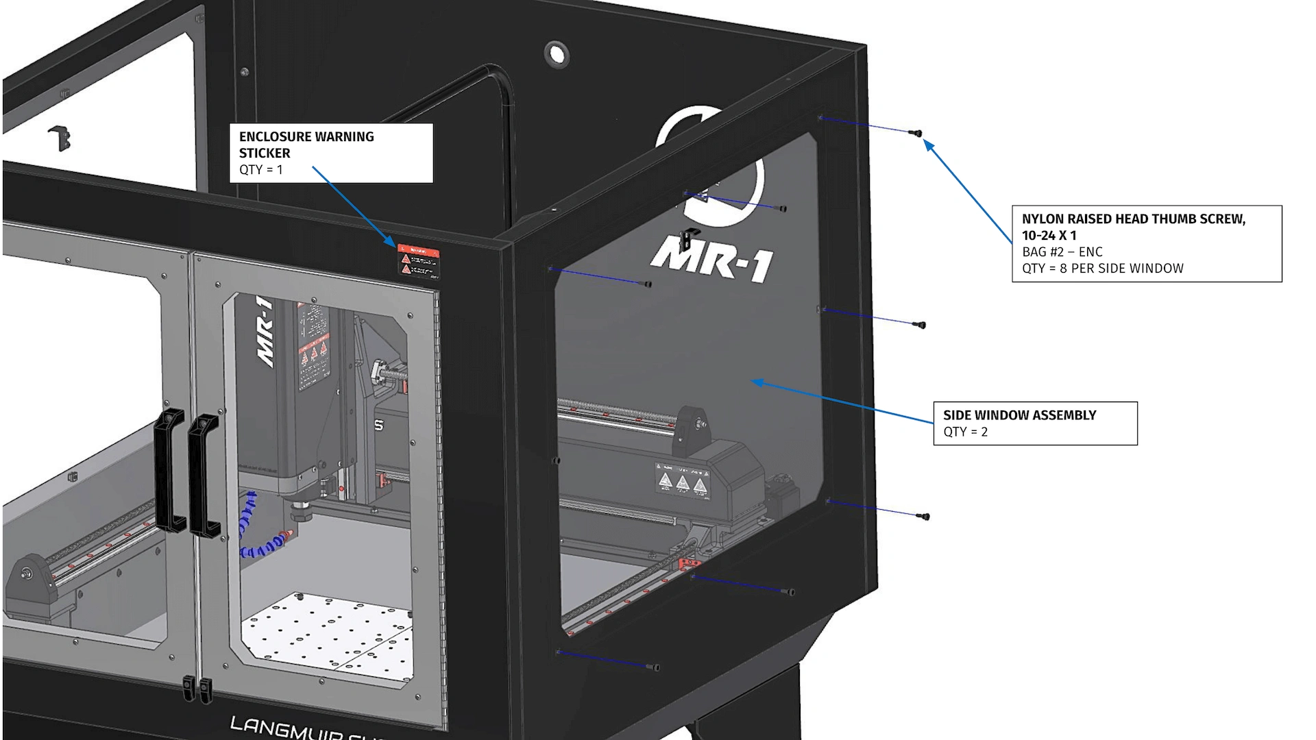

MR-1 CNC Mill Assembly
The Langmuir Systems MR-1 ships partially assembled. Therefore, this section serves to provide all of the pertinent information and instructions needed to fully assemble your new machine.
Images in this Guide
The assembly drawings and pictures included in this guide can be expanded to full-screen and zoomed to provide more detail on a given step.

Materials
Parts
  • (2) Side Window Assembly
  • (1) Enclosure Warning Sticker
Hardware
  • (16) BAG #2—ENC NYLON RAISED HEAD THUMB SCREW, 10-24 X 1
Tools
  • None
Instructions
  1. Re-route and secure all machine cables through the grommet in the rear panel.
  2. Attach the Enclosure Warning Sticker to the front panel where shown.
  3. Install the Side Window Assemblies using the thumb screws shown.
