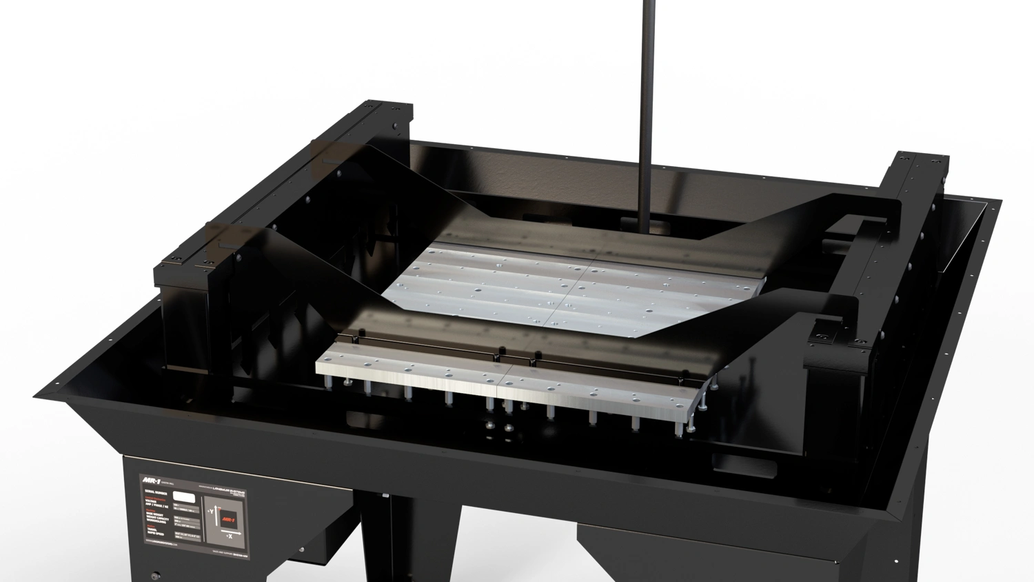

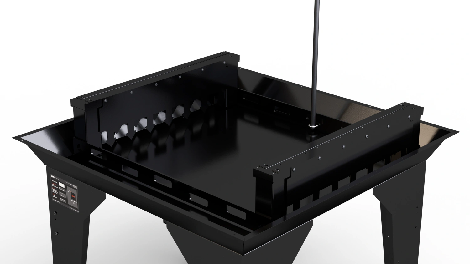

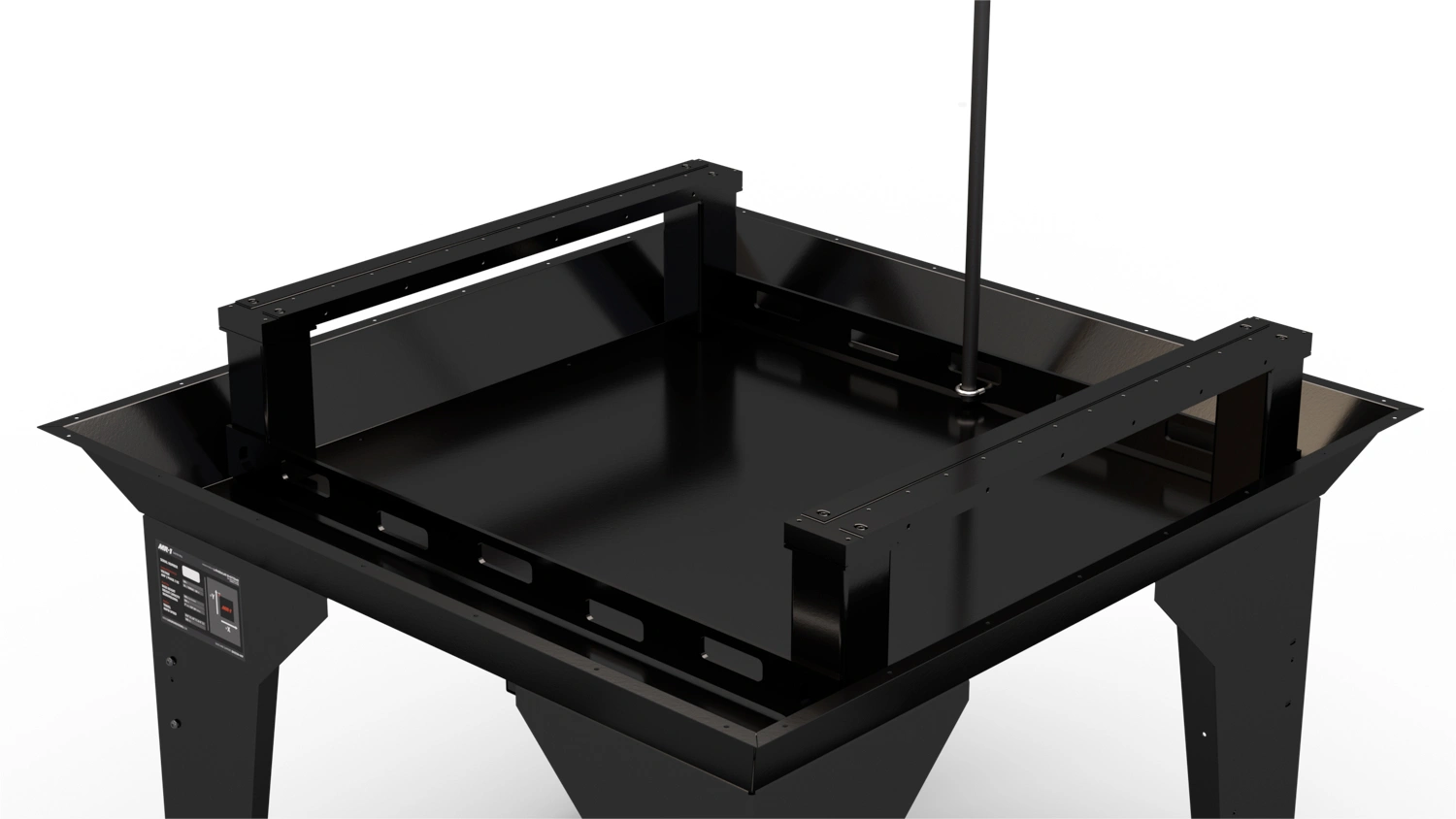

Let's take a closer look at how the MR-1 base is created. Prior to pouring the concrete, the Y Axis Rails are supported by the Front and Rear Y Axis Rail Mounts. The mating surfaces of these components are precision machined to guarantee a high degree of coplanarity between the Y Rails once assembled. The Rail Mounts are supported by three points of contact on the bottom so that the precise coplanarity between the rails is not compromised by its own weight when resting on the relatively uneven surface of the Chip Tray during assembly. The large square rectangular pass through holes in the Rail Mounts are to guarantee good mechanical interlocking between the concrete and the Rail Mounts.
Stabilizer plates attach to the inner and outer edges of the 1” thick steel Y Axis Rails. The downward arrowhead geometry of the stabilizers ensure a strong and stable connection to the concrete once cured. The job of these plates is to transfer the stiffness and mass damping properties of the concrete base to the Y Axis Rails.

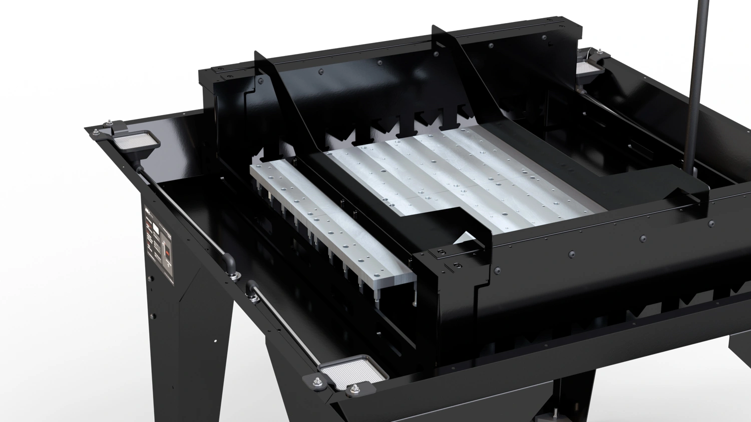

The base plate assembly consists of two 10”x10” billet aluminum plates that are .700” thick. In addition, a total of 52 steel anchors protrude from the underside of the base plates to ensure a stiff and intimate connection to the concrete base structure. Concrete completely encapsulates the base plate assembly on 5 sides to ensure maximum vibration damping performance.The steel anchors were designed so that the base plates could be replaced if needed, even after the concrete has cured.

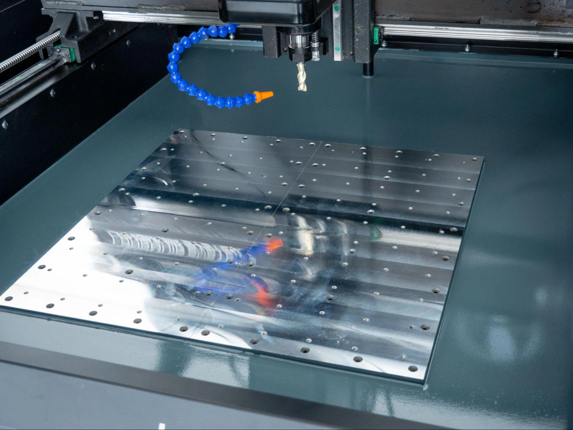

The two base plates are positioned relative to the Y Axis Rails using the supplied Base Plate Positioners. These tools suspend the base plates at the correct height during pouring of the concrete to guarantee excellent planarity (within 0.030” once cured) to the XY machine plane. Once the machine is commissioned after assembly and alignment, the base plates are skim cut by the machine in order to achieve parallelism to the XY plane of 0.002” or better across the entire travel envelope.

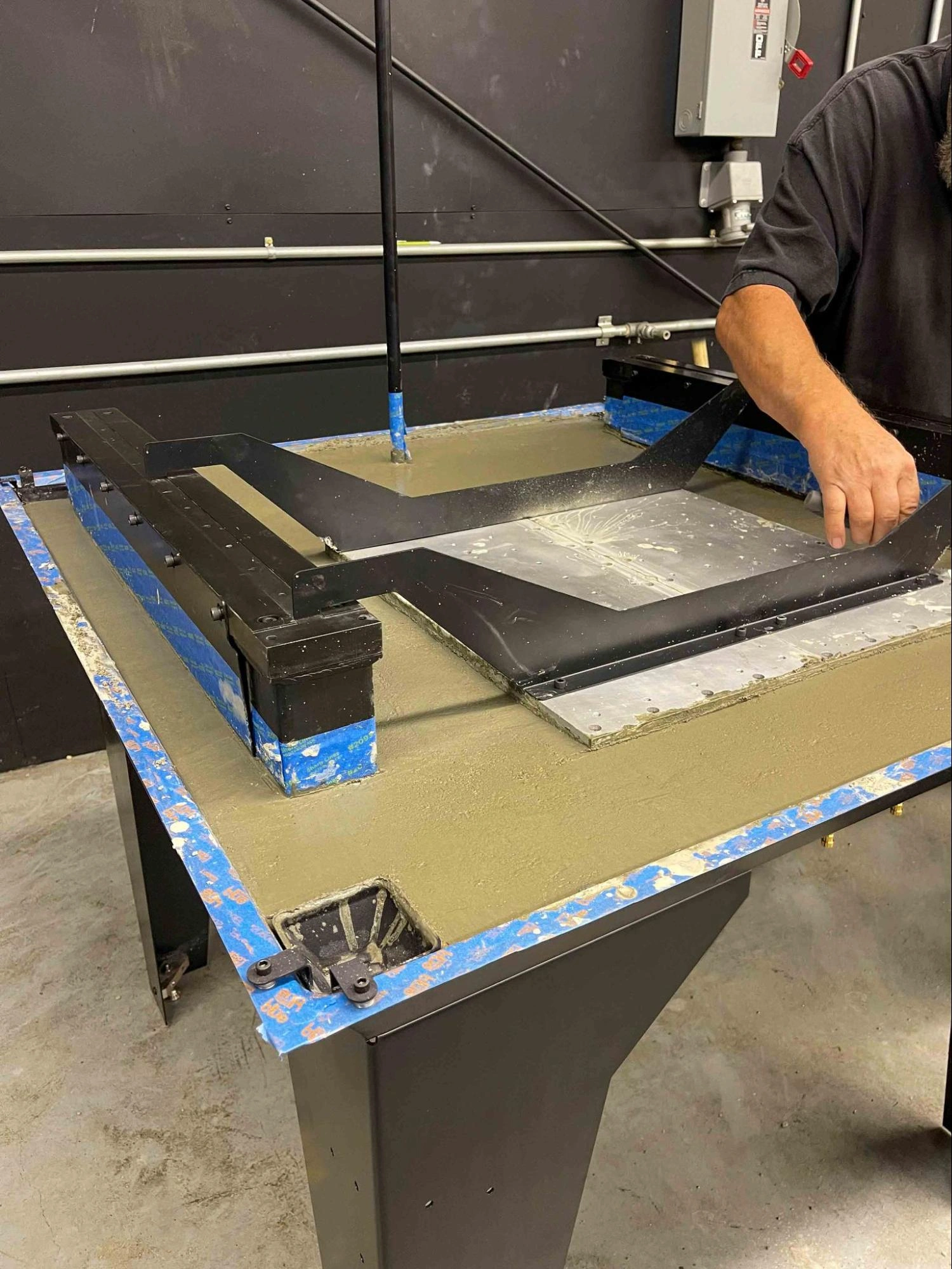

Adding the concrete is as simple as mixing (7) 50 pound bags of concrete according to the manufacturers recommendations and then filling the chip tray until roughly half of the baseplate edges are exposed. It takes the average user about 1 hour to mix, pour, and smooth the concrete base and the only tools that are required are a bucket and a shovel.

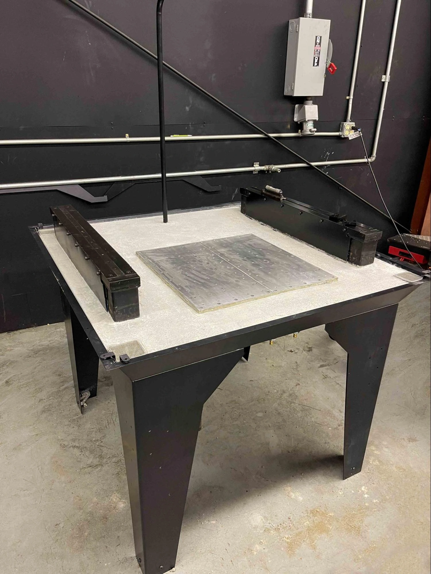

The concrete takes approximately 5 days to cure before it has reached sufficient dimensional stability for use. While it is not required, we always recommend the application of an epoxy topcoat (can be purchased from Langmuir Systems) to seal the surface and to provide a laser flat surface that is exactly level with the corner drains. This will ensure that there are no low spots that puddles can form in. Epoxy also carries the added benefit of being easy to clean since it does not absorb liquid like regular concrete and it also creates a great looking machine base surface.

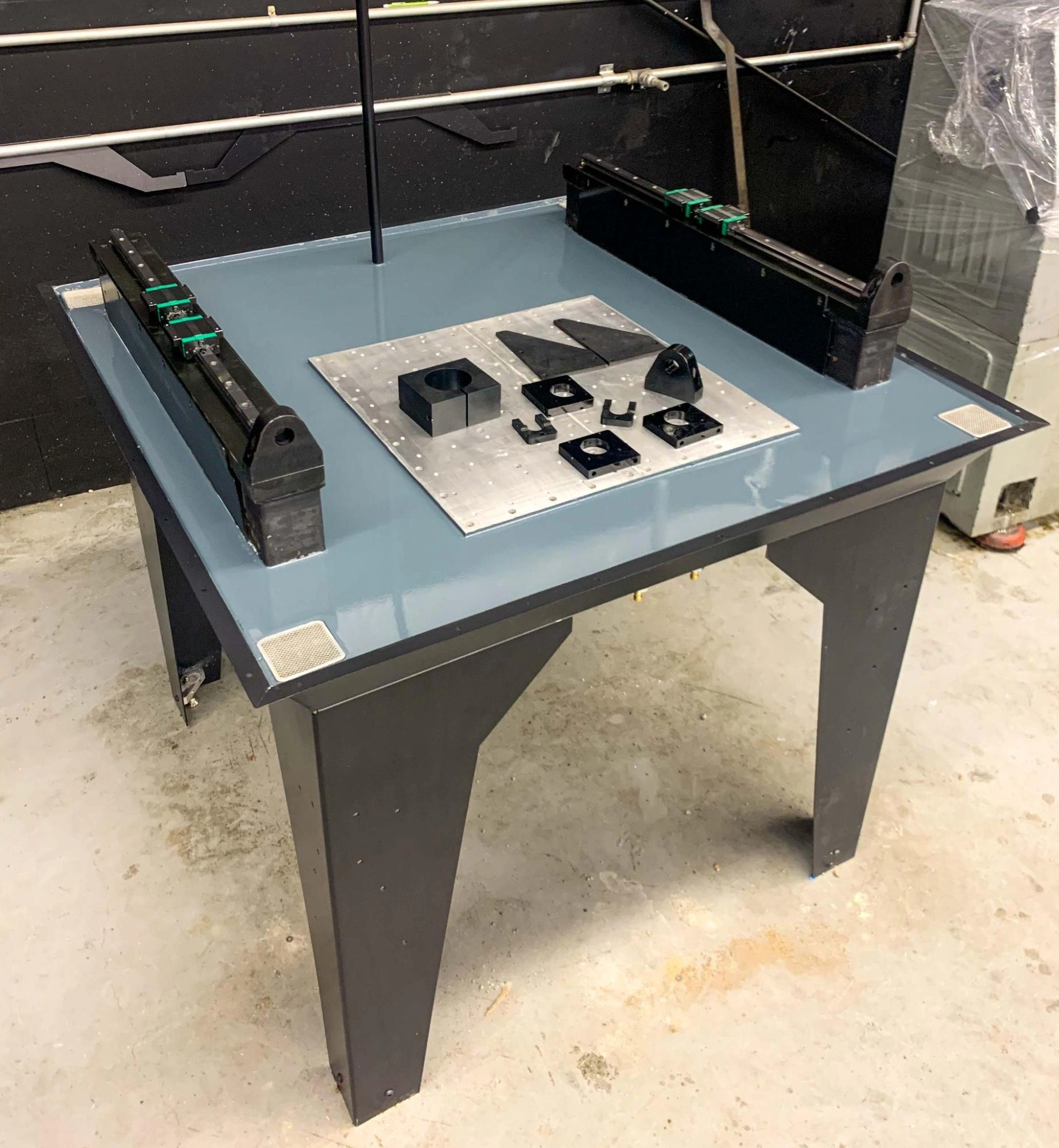

Concrete is poured to fill the Chip Tray
Concrete Base after curing
MR-1 Machine Base after Epoxy Top Coat
MR-1 Machine Base after skim cut with Fly Cutter
